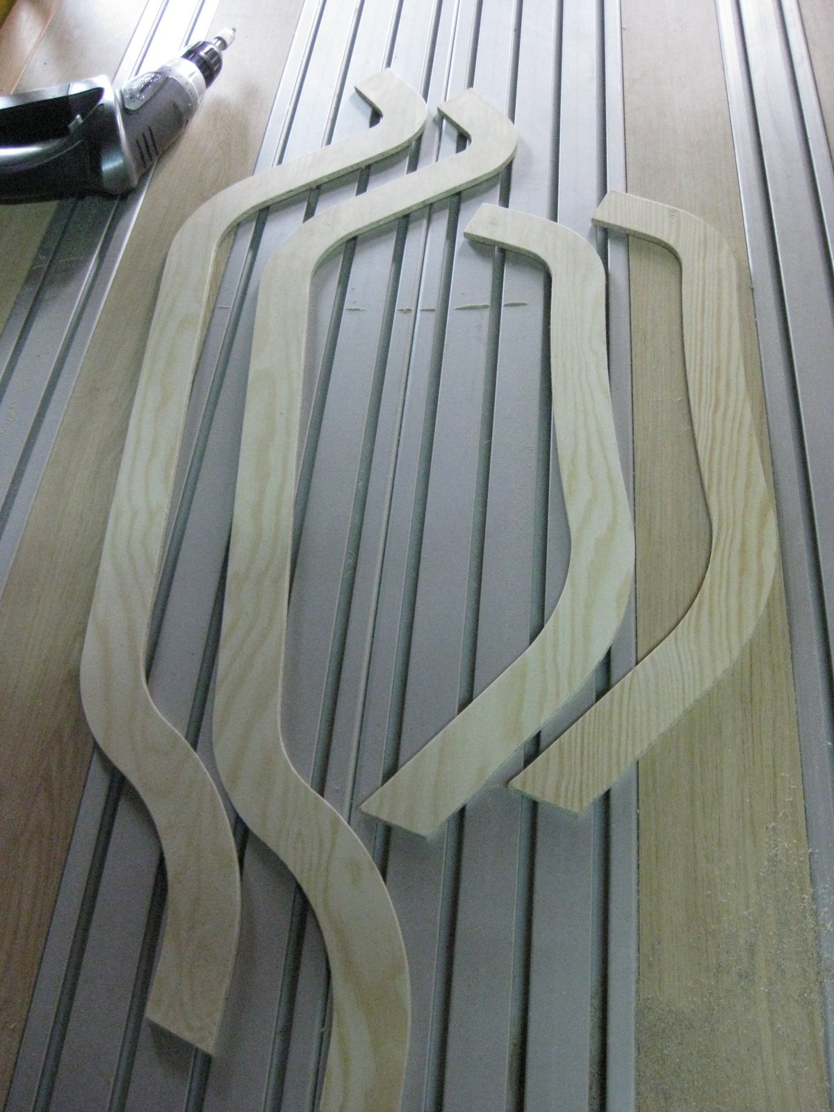

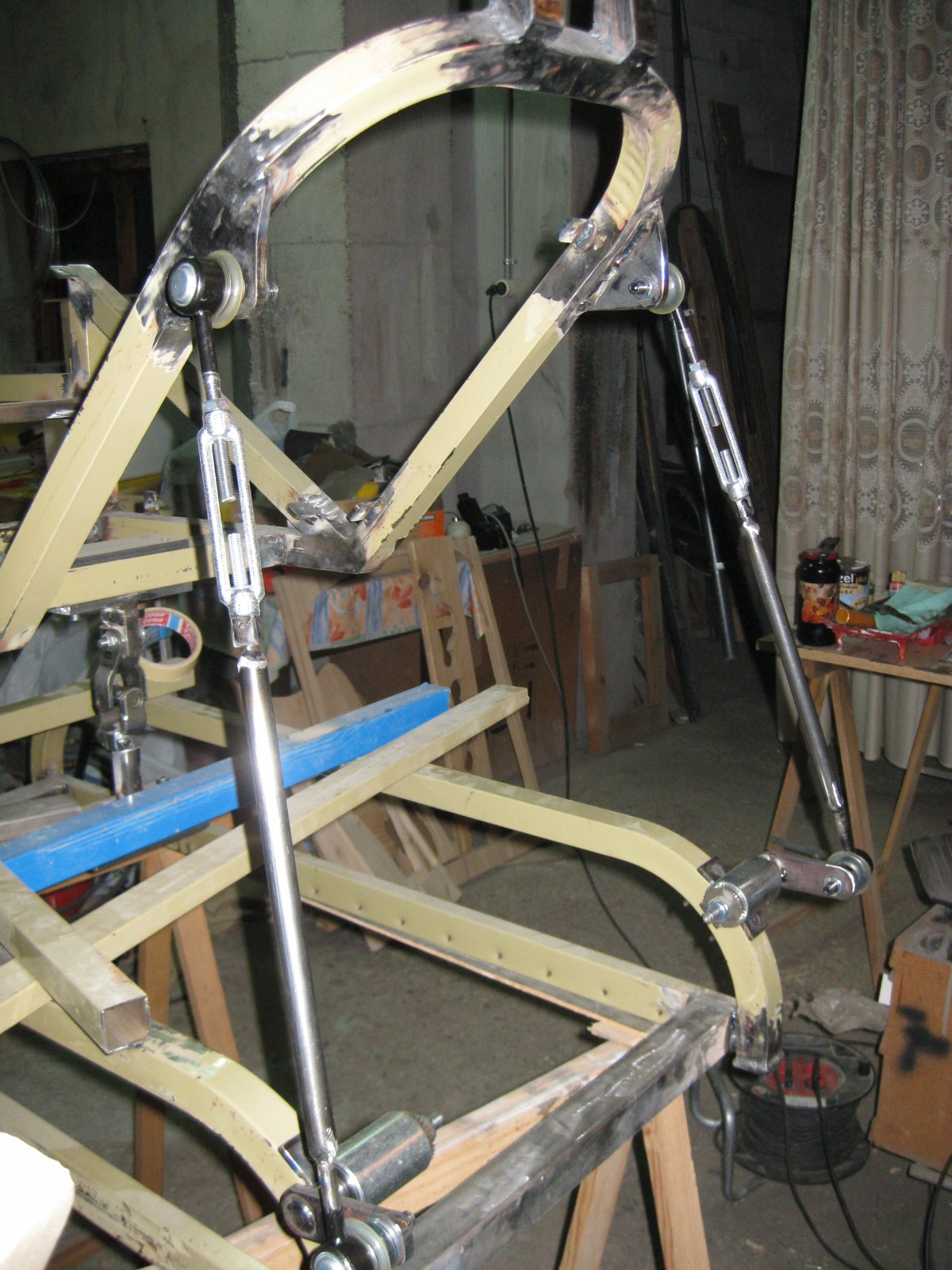

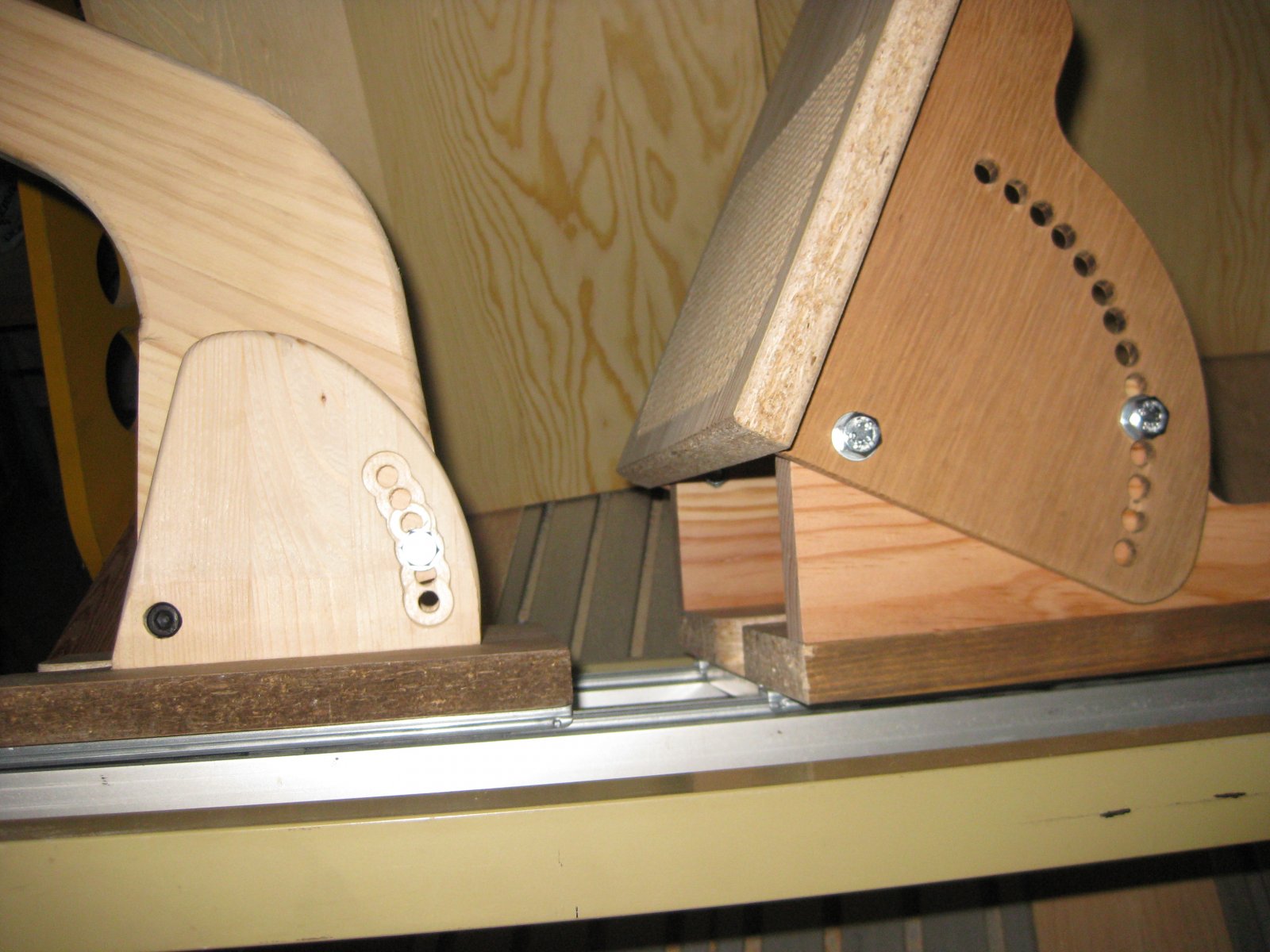

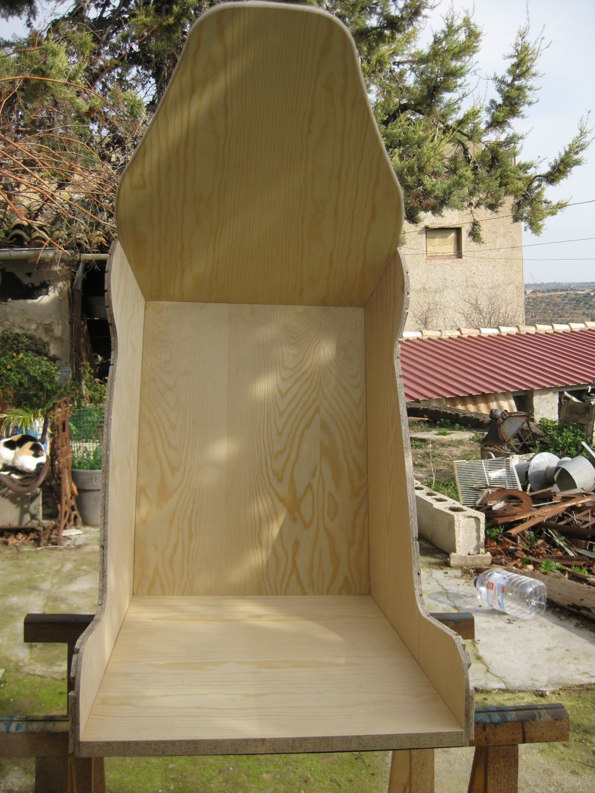

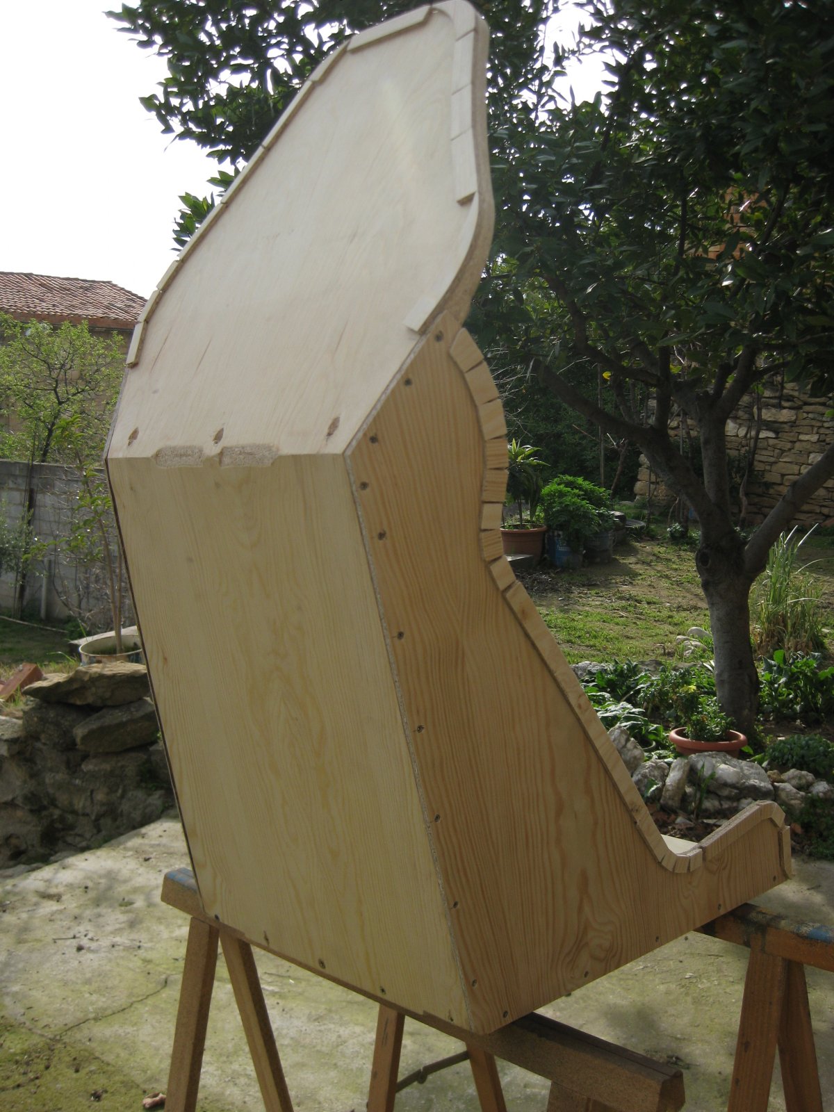

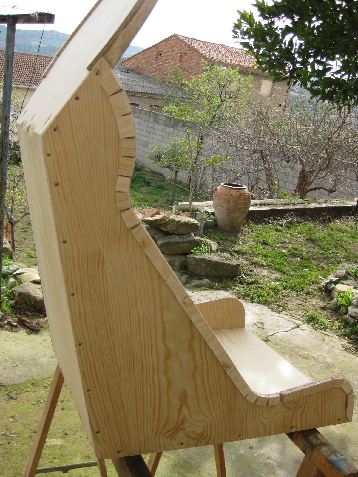

    Hi, I would like to show you my project that I have been working on for a while.
    Now it takes a while to stop but I'm taking it back.
    My idea was that the driving position approximates that used in an F1.
    Something similar to this style

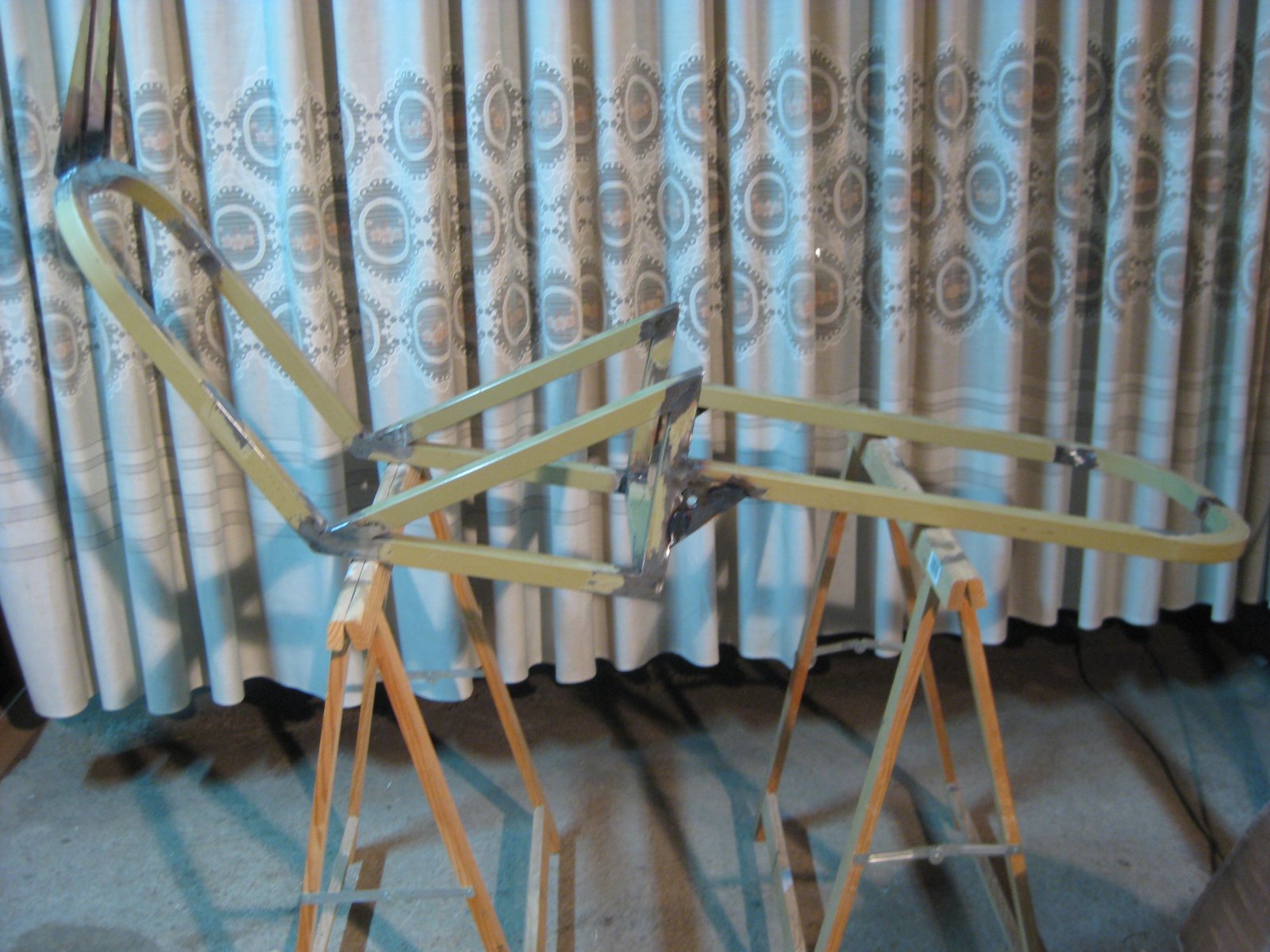

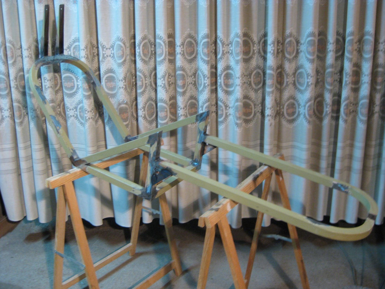

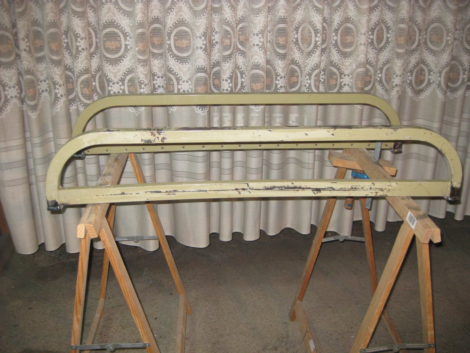

    I started my work doing a basic foundation, and a base where I would place it later.

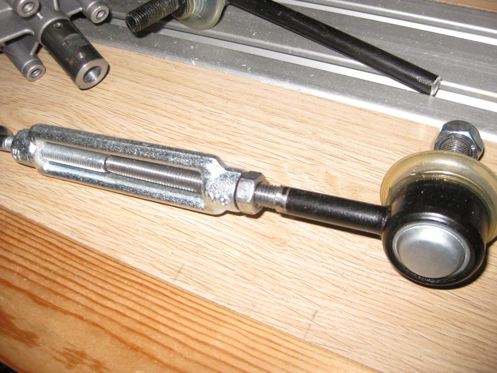

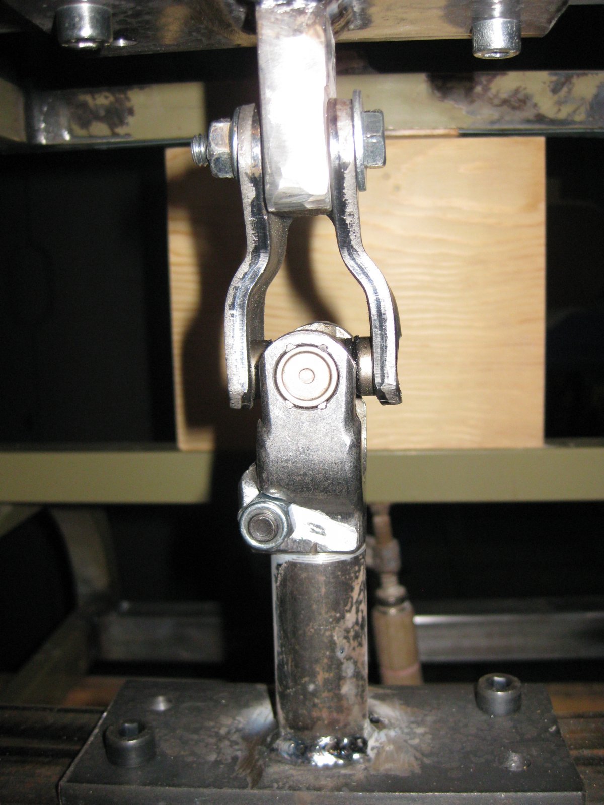

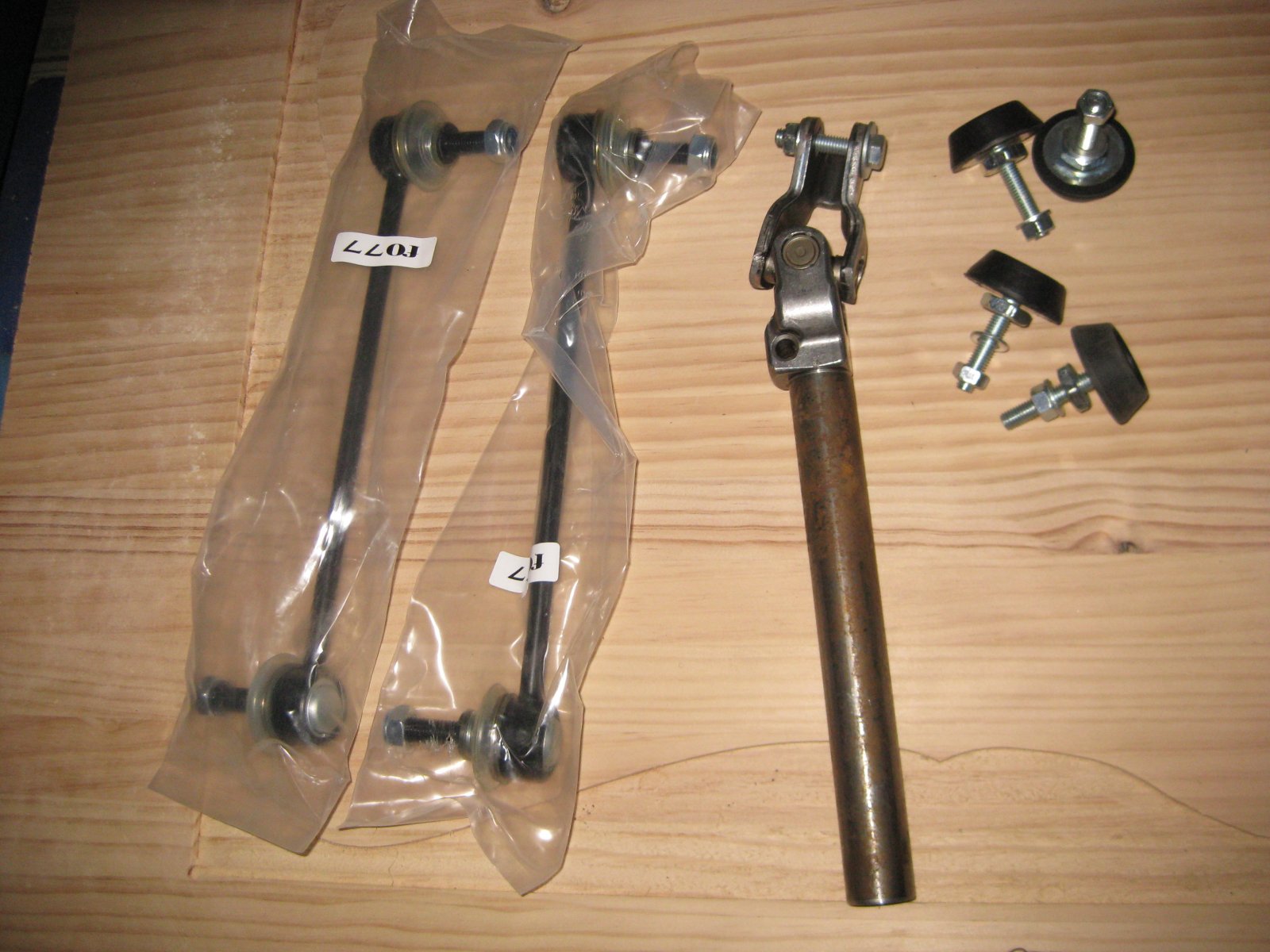

    Little by little I placed the anchors and bars for movement.
    Modifying the kneecaps to make a level adjustment

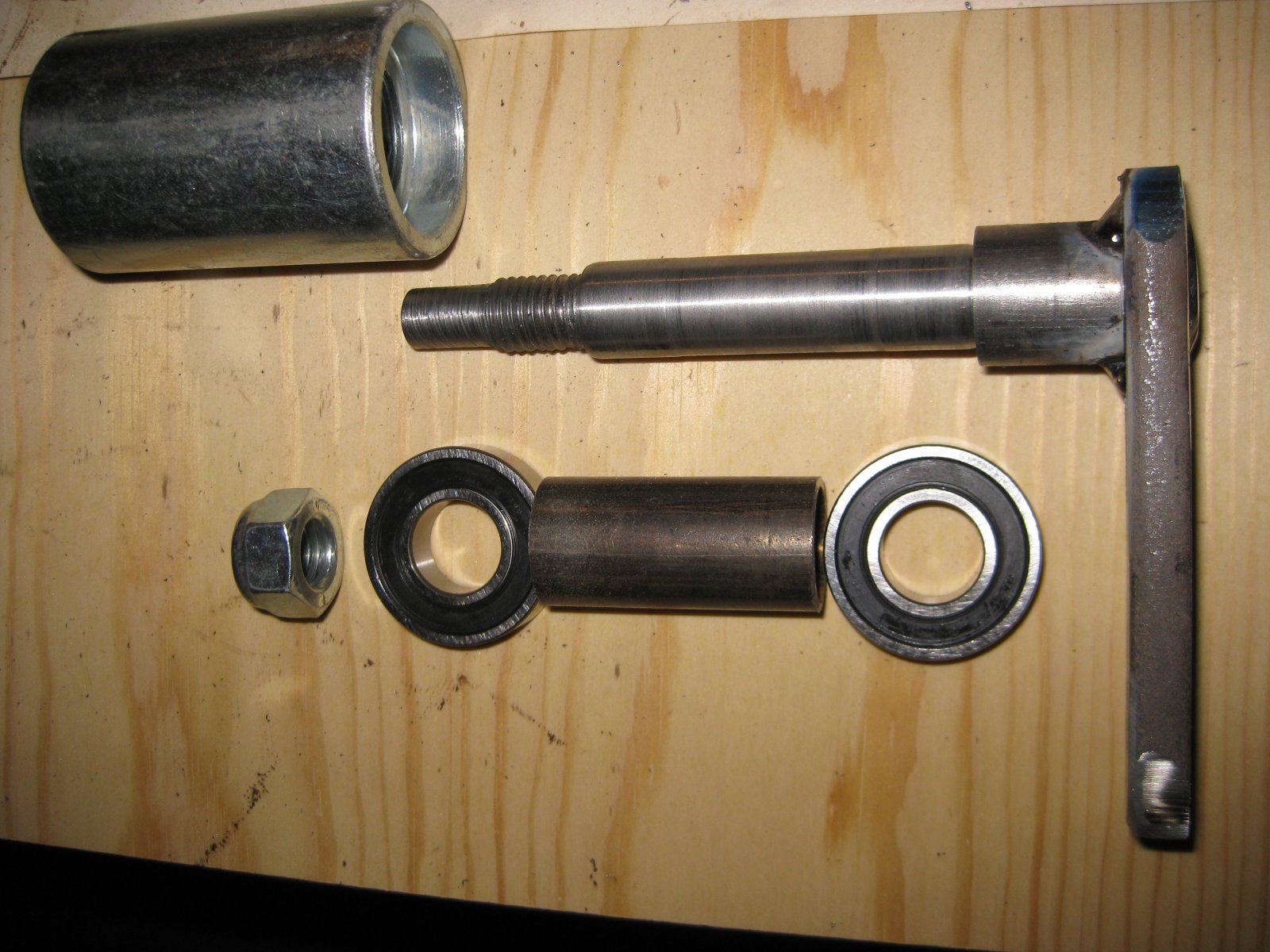

    Reinforcing the connecting rod part with bearings so that the engine does not suffer
    Whole assembly assembled........

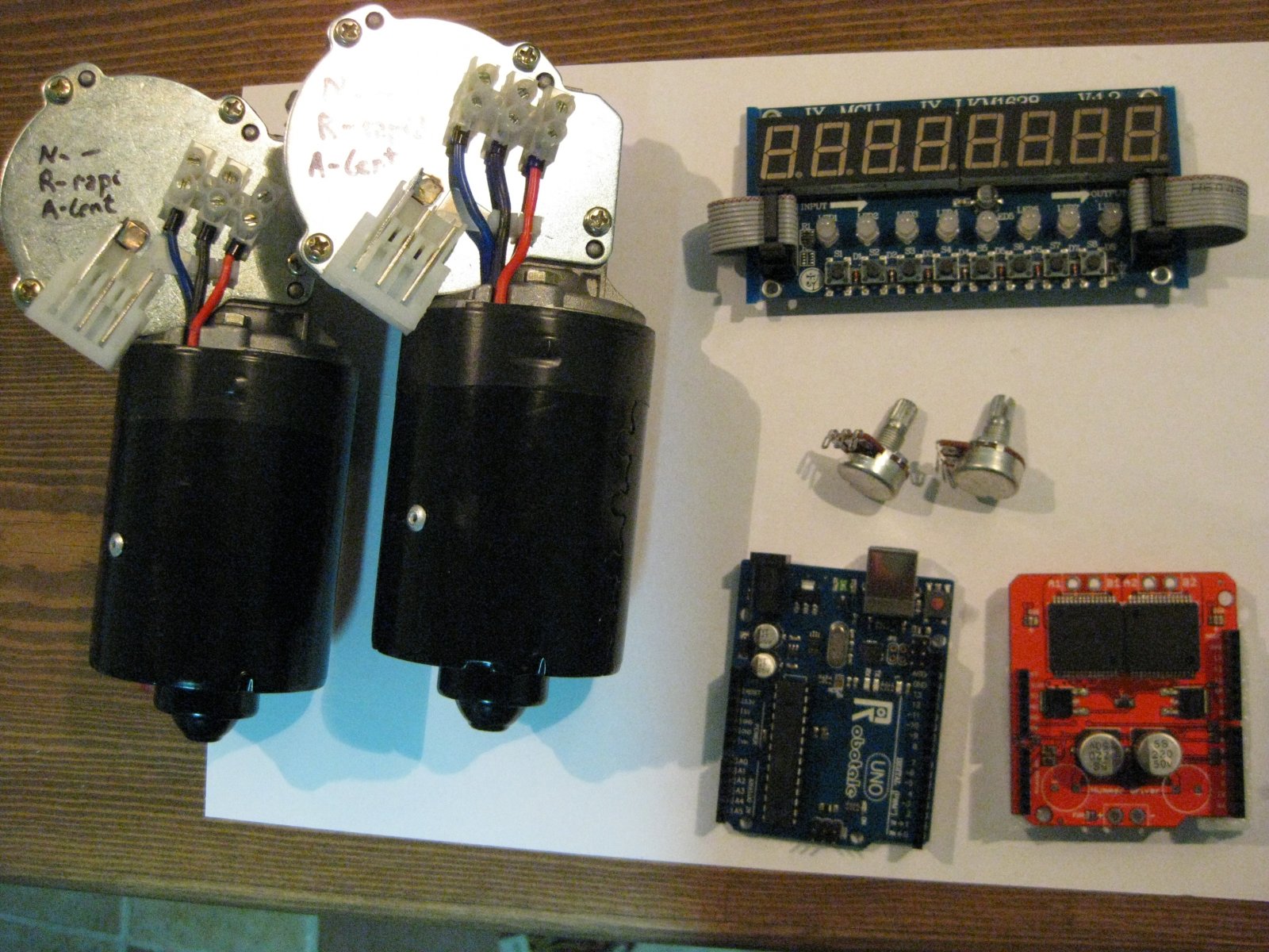

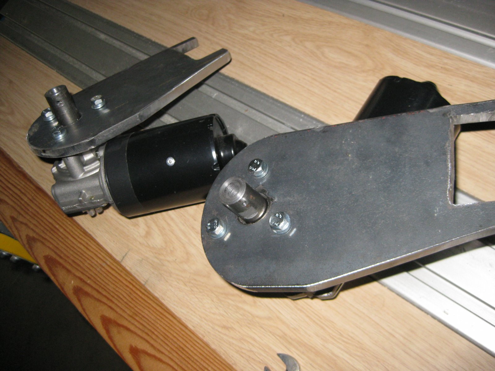

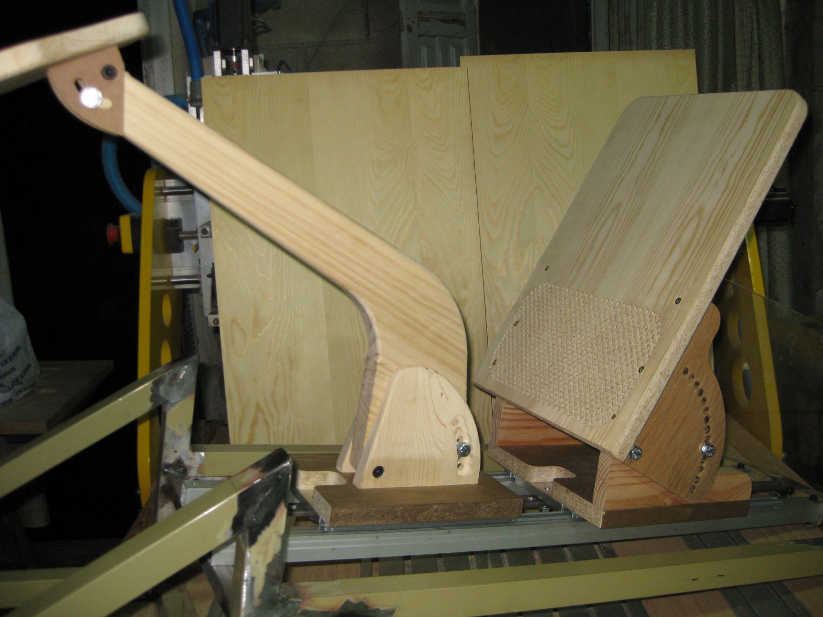

    We continue .....
    Motors and electronics ... part I have not used

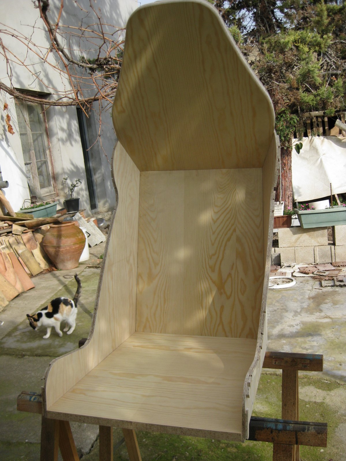

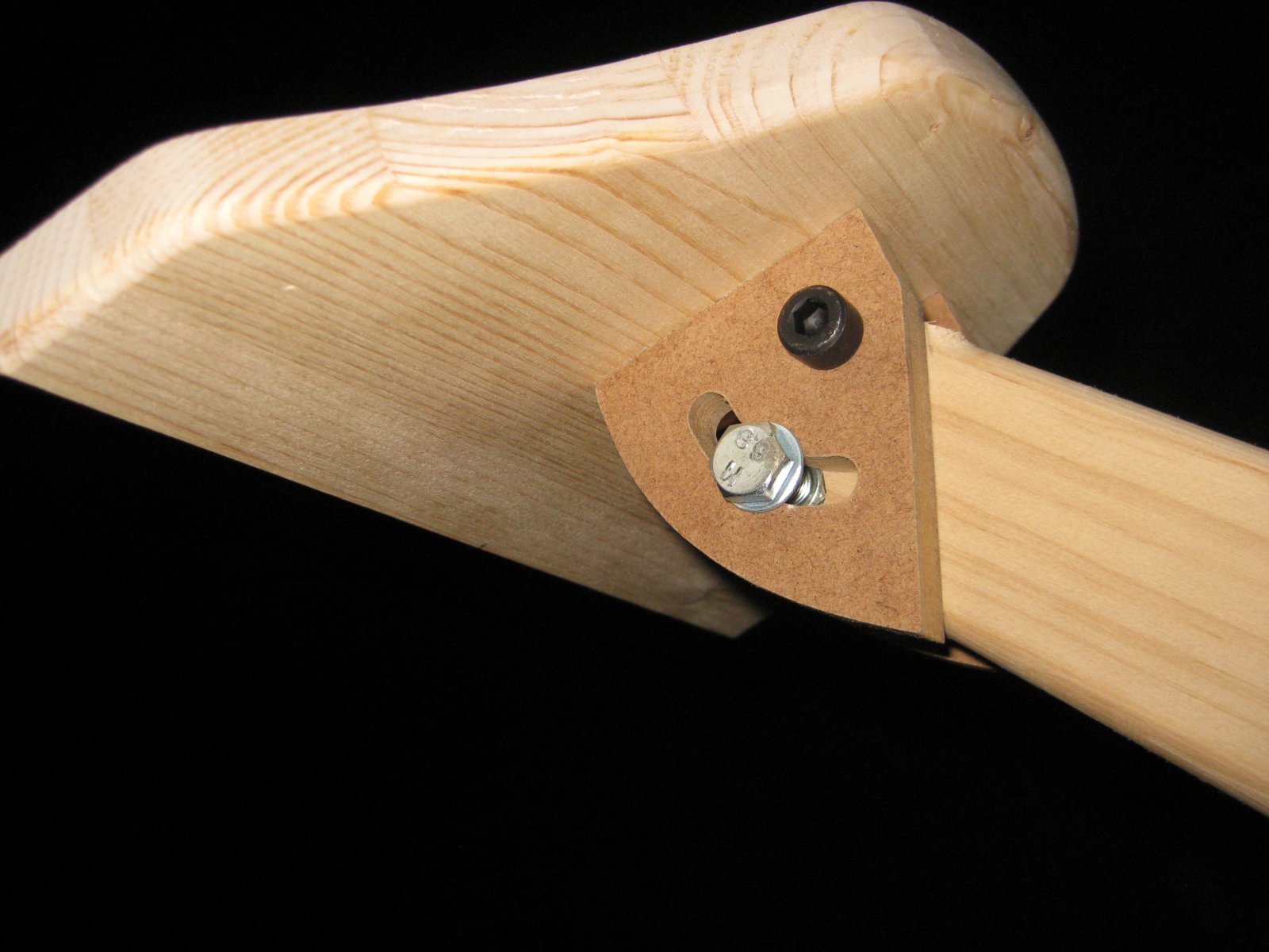

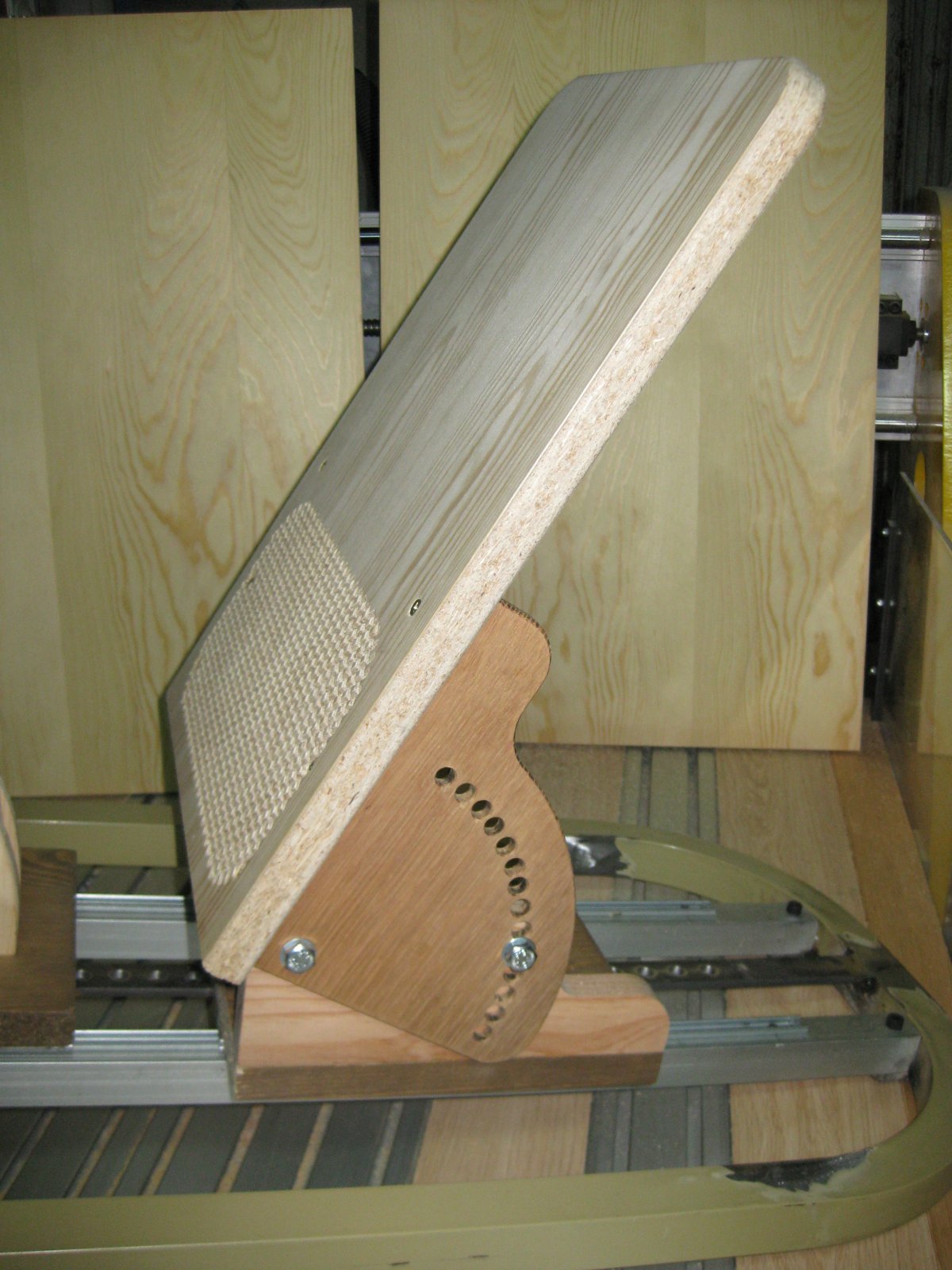

    Fastening the steering wheel and pedals IMG_2445.JPG IMG_2446.JPG IMG_2447.JPG IMG_2448.JPG IMG_2449.JPG
    and my homemade backet jjjjj,

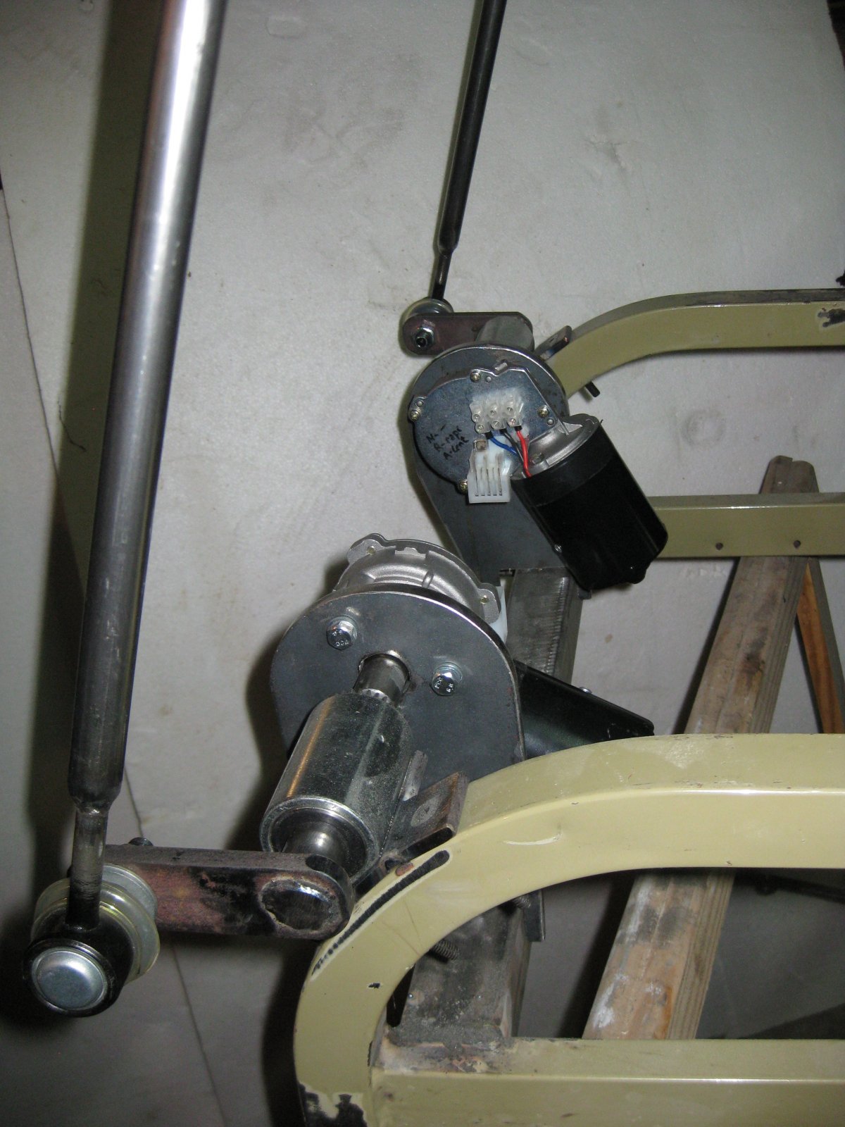

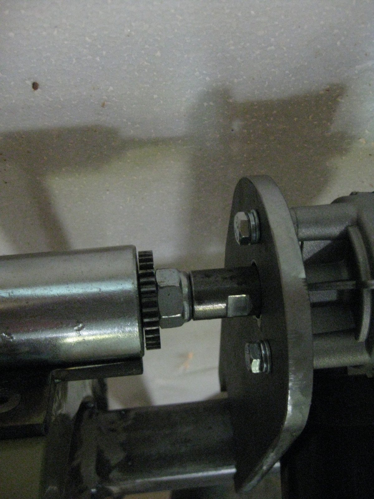

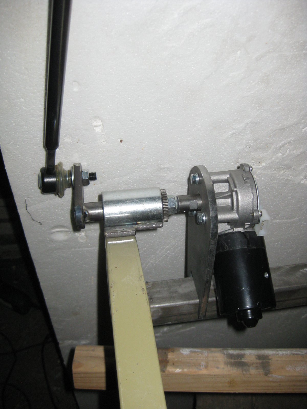

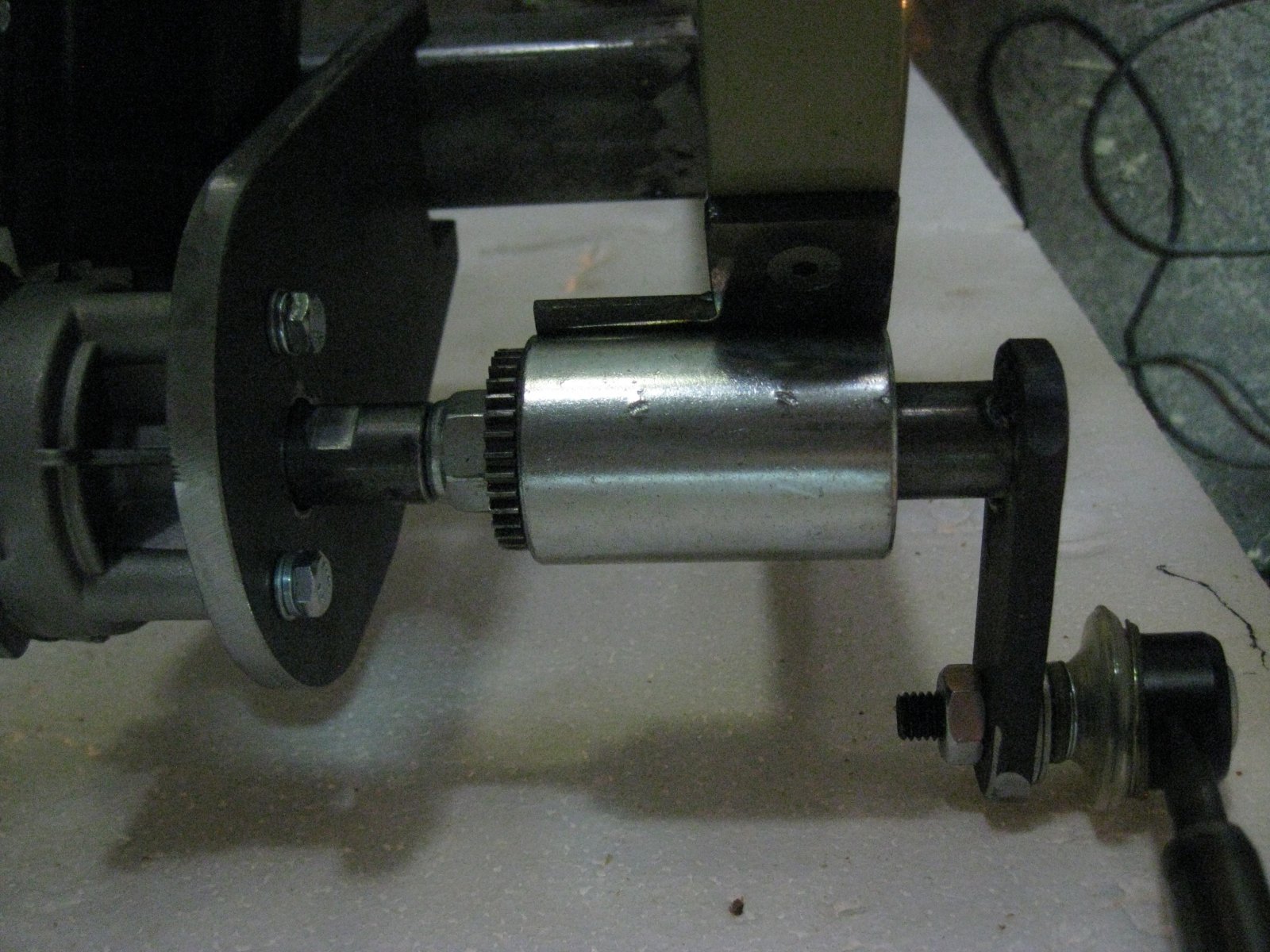

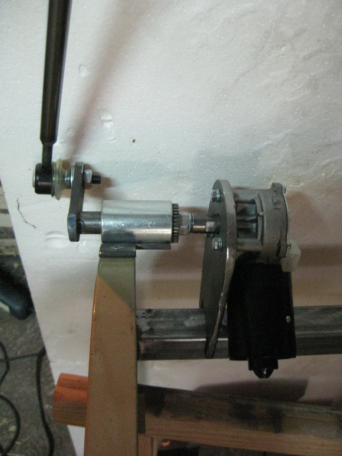

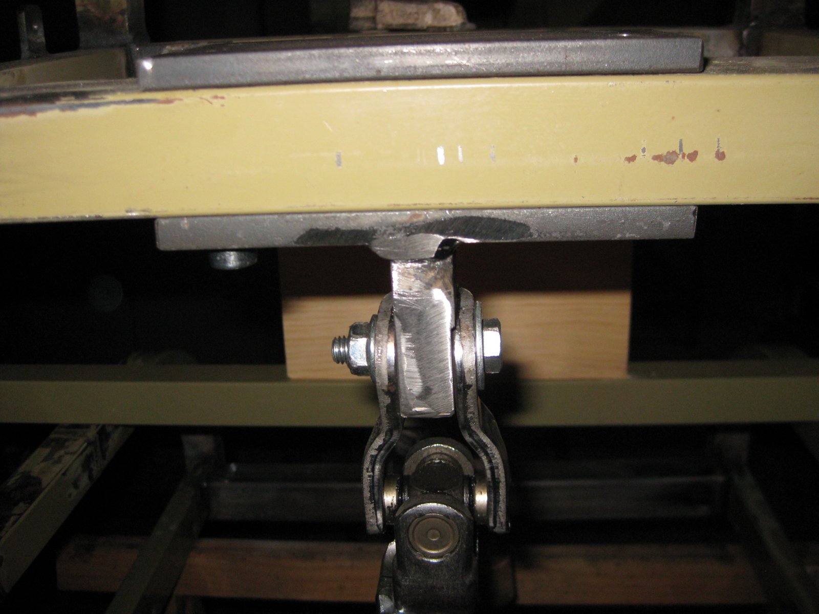

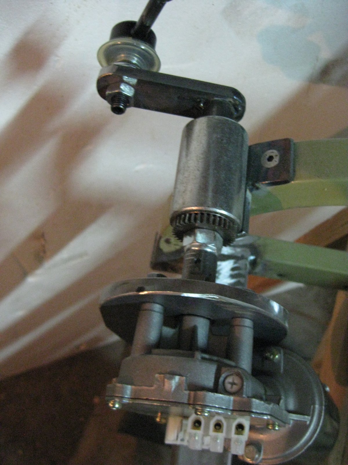

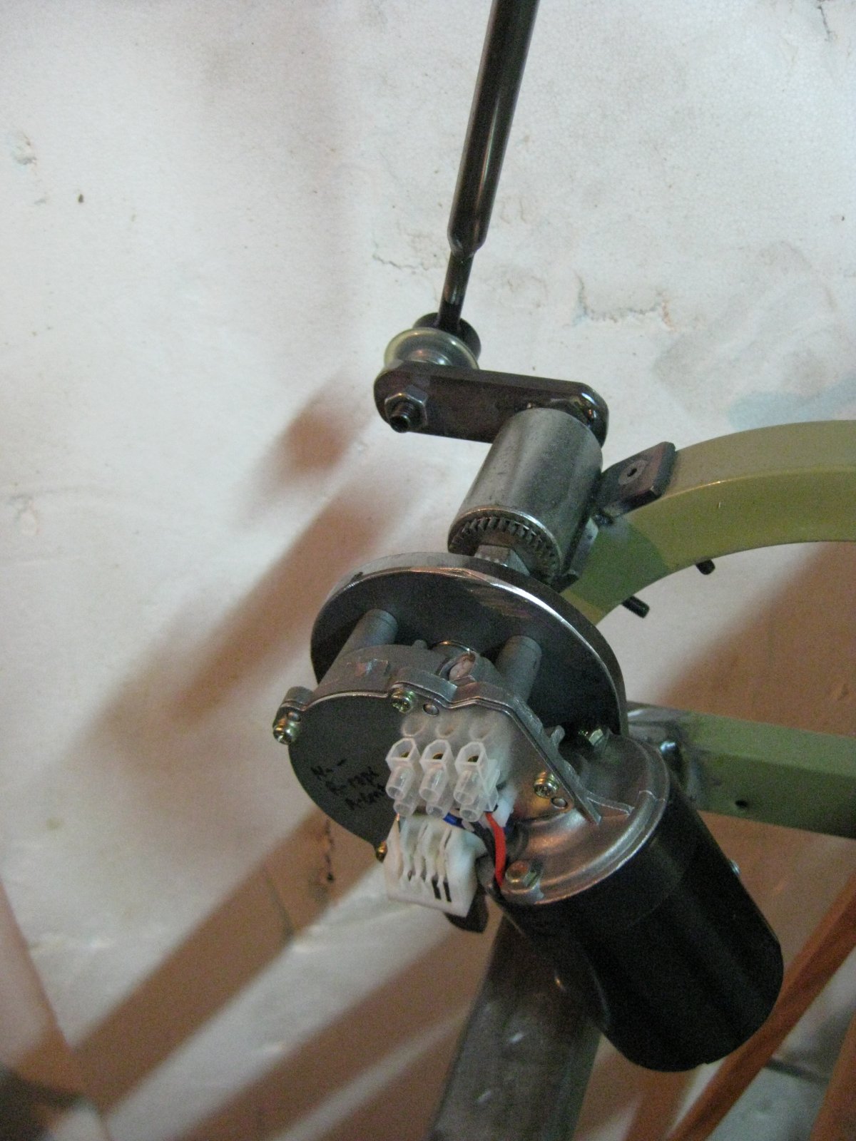

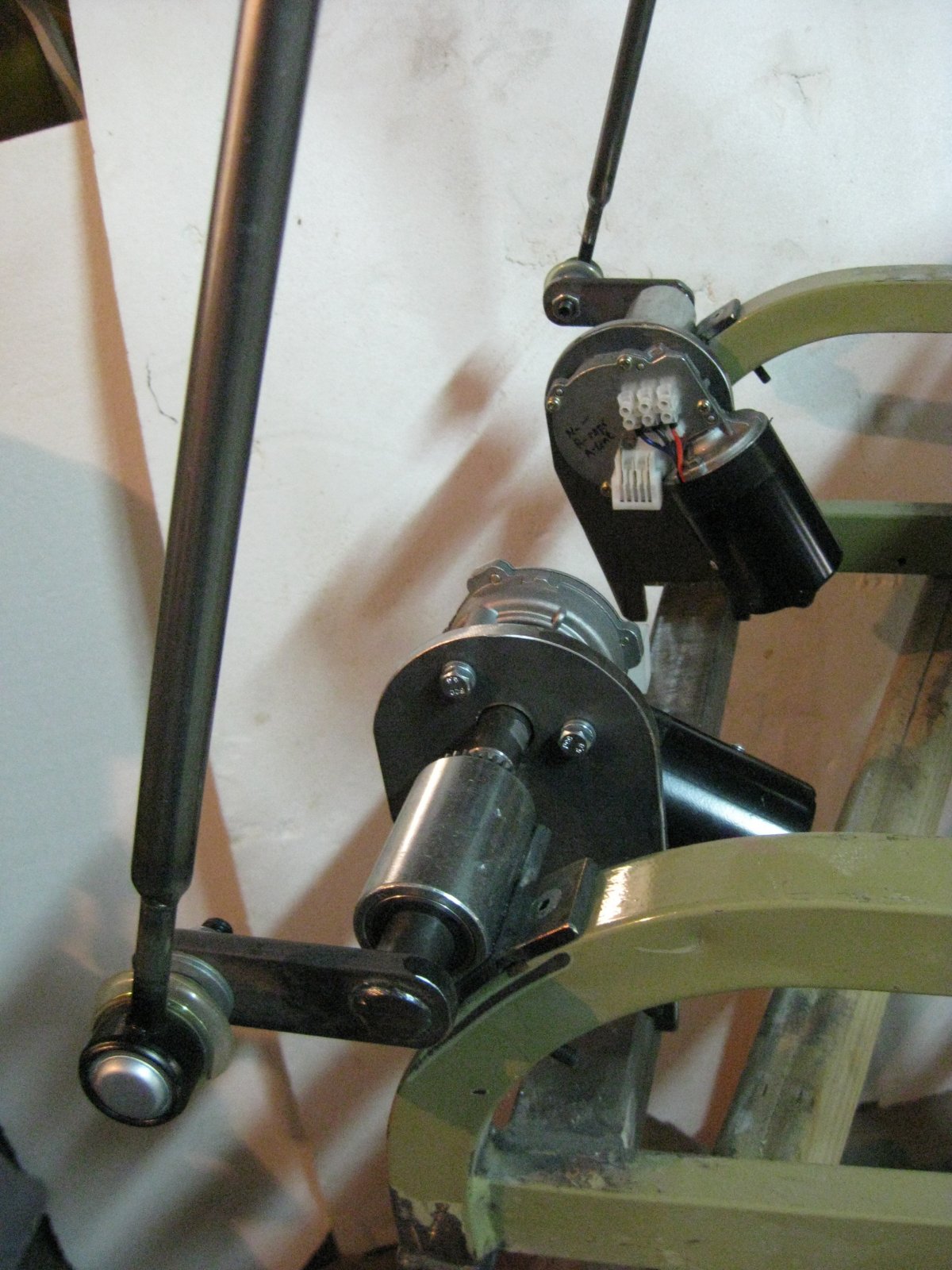

    Good afternoon we continue showing a little more of the project.
    Engine mounts, in the last image you can see the pinion that will move the hall sensor.

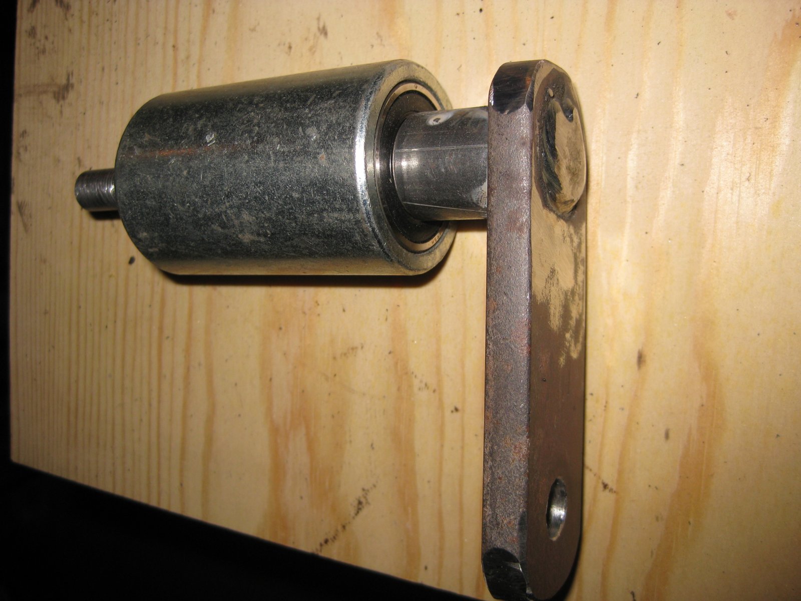

    The coupling of the engine finally did not work well in subsequent publications I will show the modifications I made since it ended up loosening

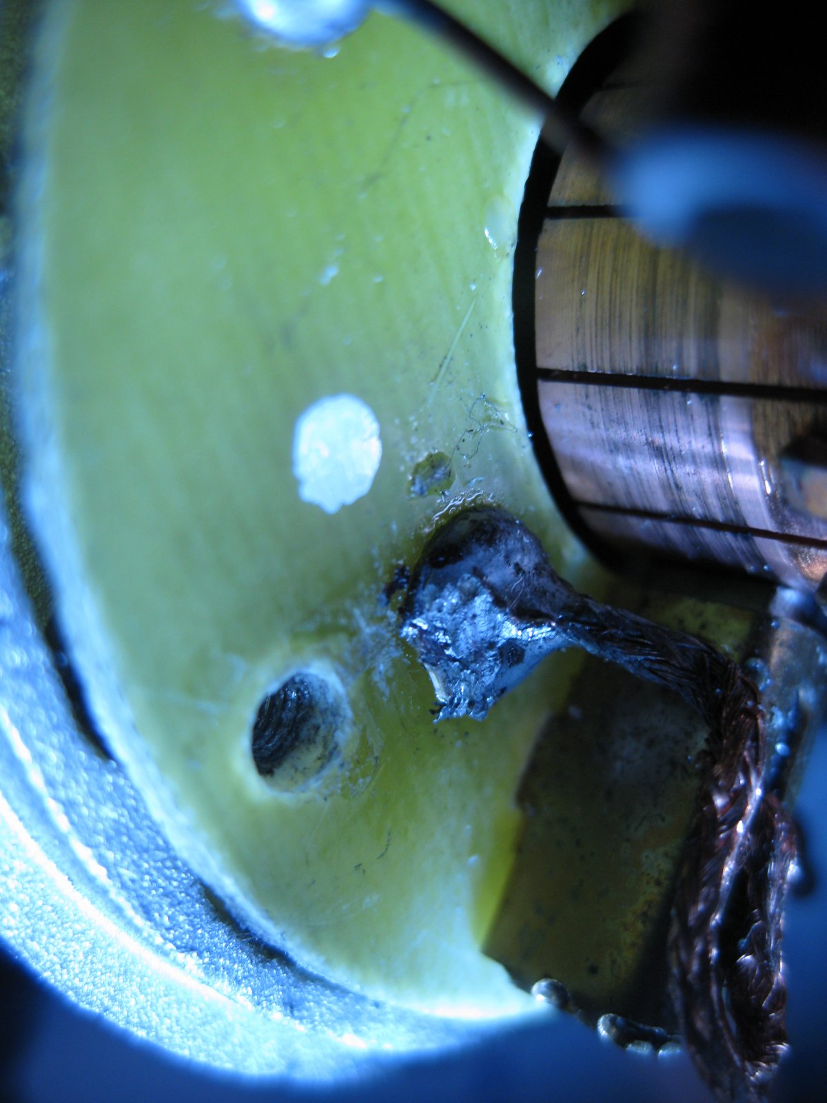

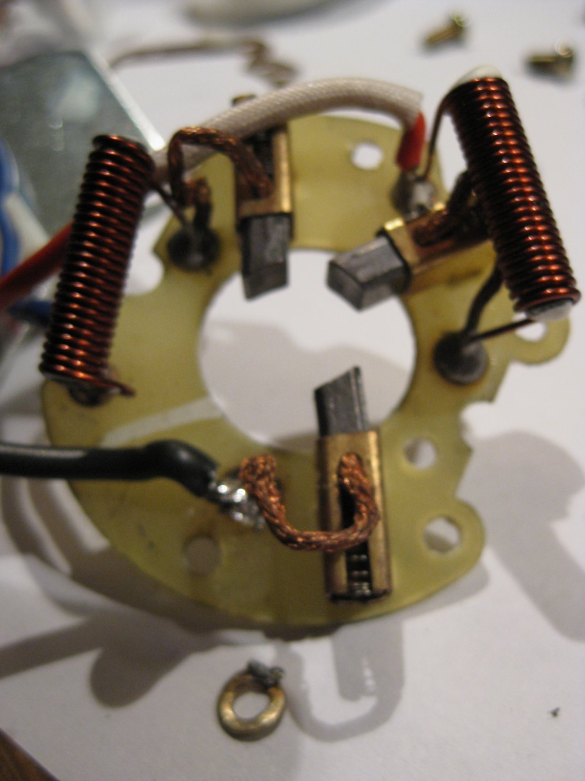

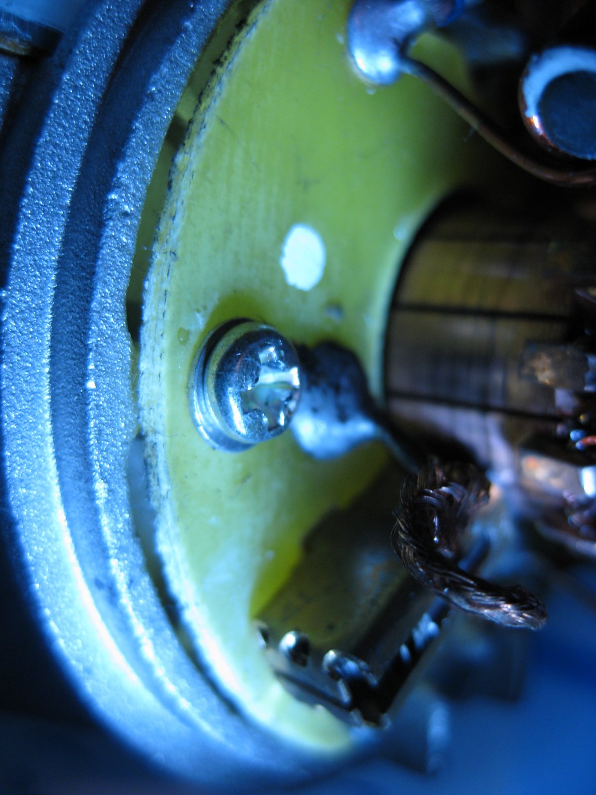

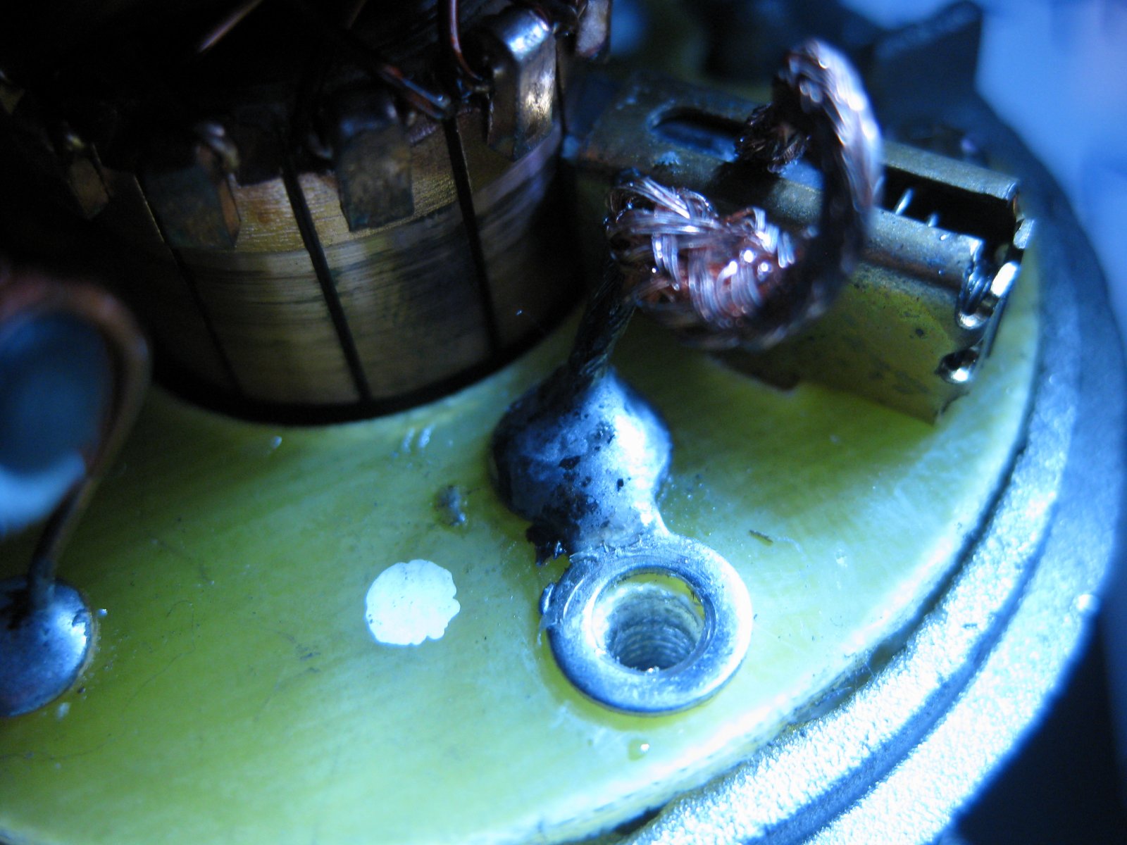

    Modify the motors to isolate the ground .....
