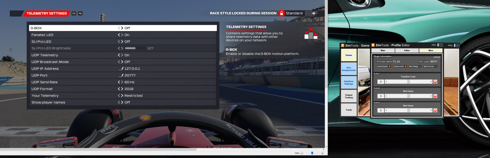

    I do need to ask about udp port numbers too. I'm struggling to understand this somewhat.
    So many different ports are mentioned through the conversation threads that it leaves a newbie a bit lost. If anyone is able to explain simply I would be grateful for that too. For example. F1 22 do I have type 4123, 5123, 20777 or 20778 in the box on simtools? Do I select a different udp within the f1 22 telemetry settings or the same one?
    If I use simhub too, does that need to be on a different port setting than the one used in f1 22?

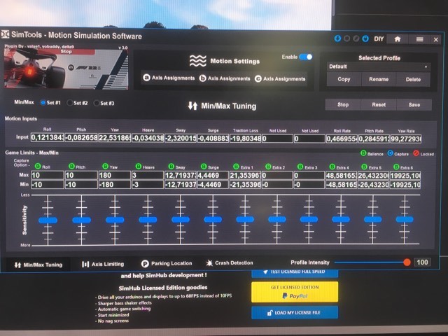

    Can you please post a picture of the Tuning Center while running f1 22.
  9. lacuche
    lacuche New Member
    Dec 6, 2022
    9Coins
    Thank you noorbeast,
    Here it is, hope it's helpfull.
    22,202
    154,675Coins
    +11,209 / 57 / -2
    Thanks, that shows there is roll data, so the plugin is working, rather it is a question of refining your SimTools settings.

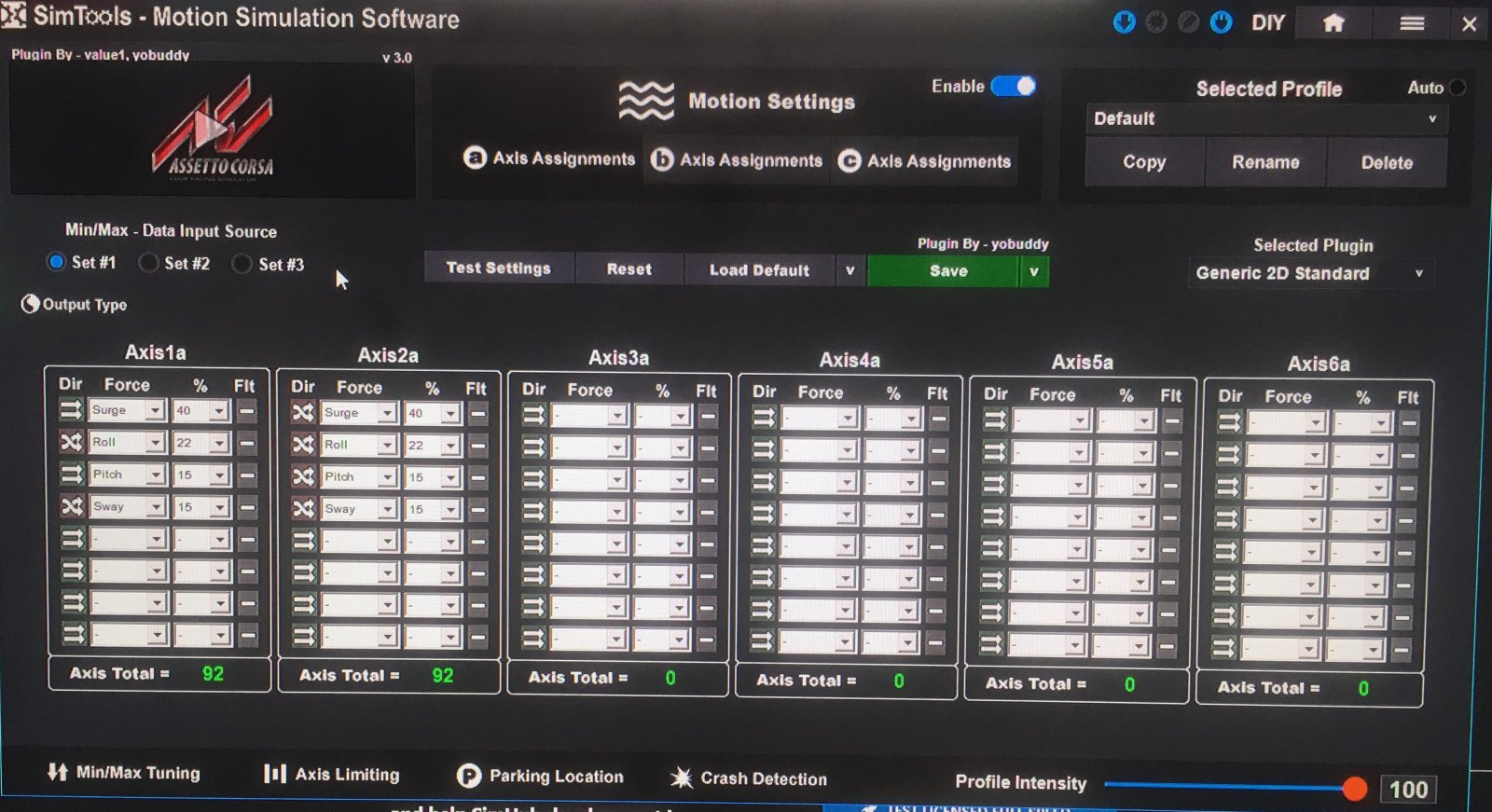

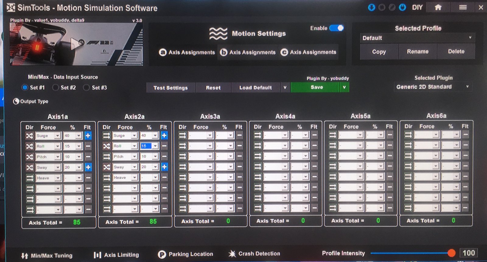

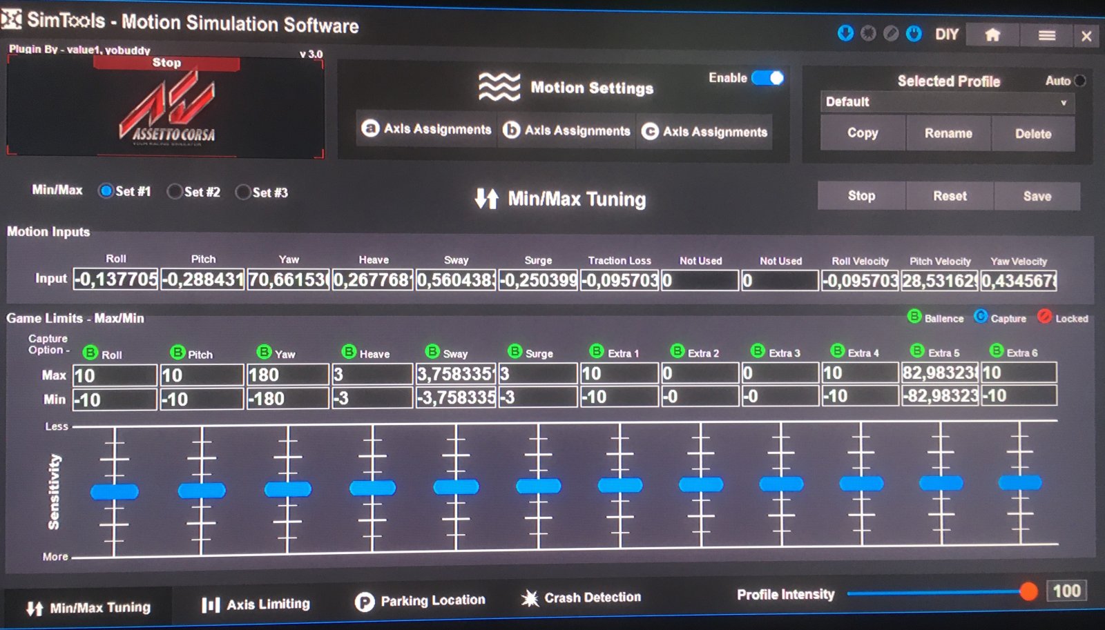

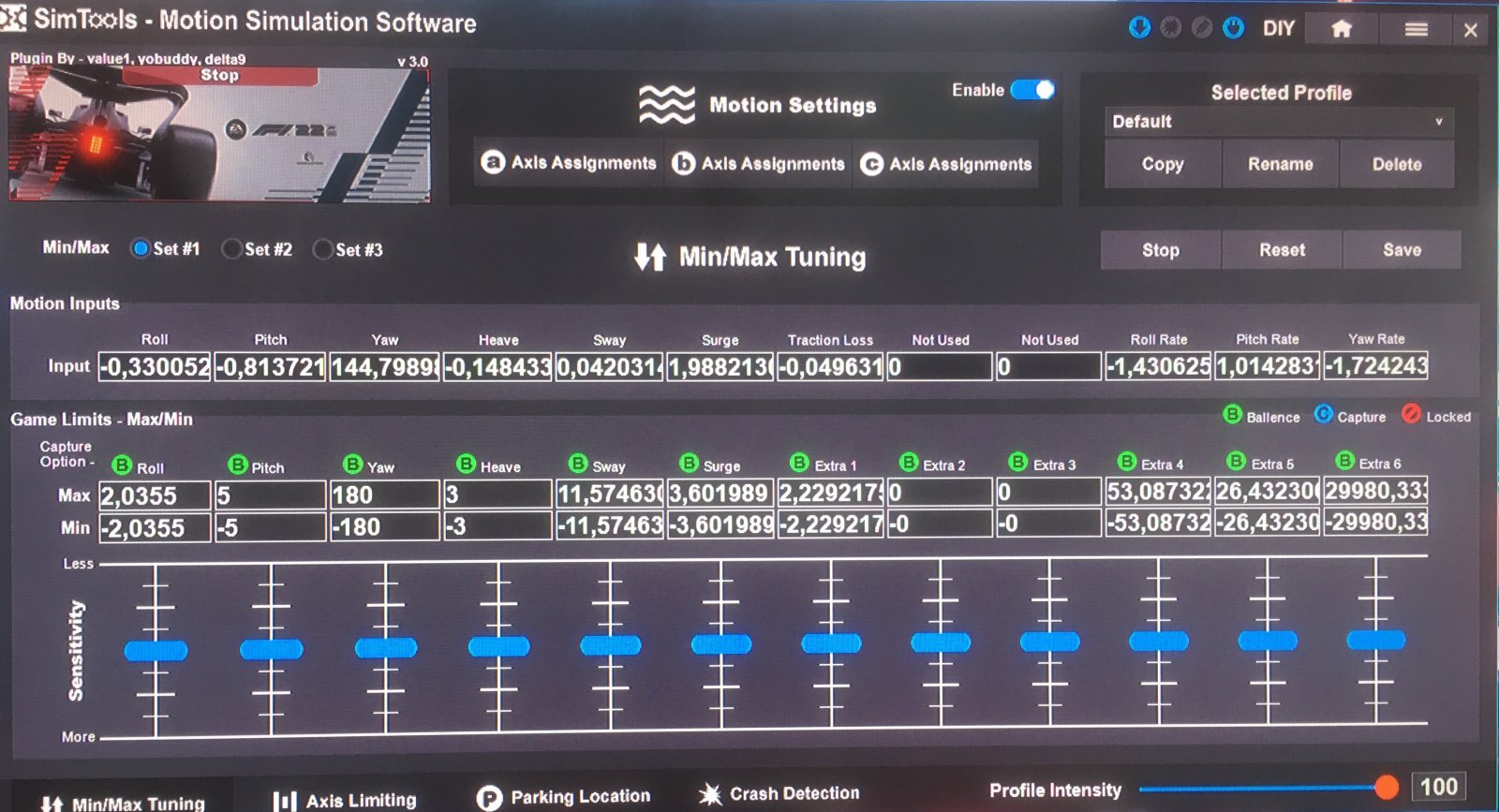

    Alright, here are some screenshots of my current settings for both f122 and AC.
    I captured my inputs in both games (see on the tuning centers screenshots) while doing a lap on silverstone.
    I somehow managed to get a better acceleration/shifting/braking effect closer to the one I have in AC.
    The roll effect is however still unsatisfying as I can't seem to get a good kerb/bump feel without overexagerating the cambers of the track...
    Any advice?
    Thanks already for your time and help.
    22,202
    154,675Coins
    +11,209 / 57 / -2
    A good kerb/bump is not just about roll, it initially involves pitch up mounting the kerb, heave as a kerb often have ripple strips, roll and then pitch down.
    My guess, which may be off, is that for both games try initial axis allocations along the lines of surge 20, roll and pitch 25, sway 30 and heave 10.
    Capture TC Max/Mins, then initially tweak each axis one at a time, then turn them all on and tweak further, see the Tuning tips in the FAQs: https://www.xsimulator.net/community/faq/

    If settings are right, the F22 Plugin does work with F23 for me :)
    UDP Host: 127.0.0.1 with Port 4123, Data Format 2022 works fine :)
