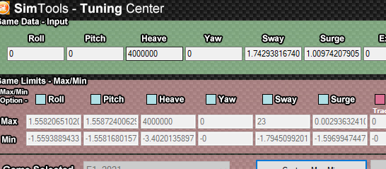

    >Hi Guys
    My Game engine showed me the following error:
    There is no reliable data from the game.
    Numers just flickering arround
    Hope you can help
    Thamks maritn

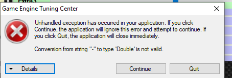

  13. noorbeast
    21,608
    151,305Coins
    +11,033 / 56 / -2
    Expand the Details in the error and copy then paste the full error here.
    Is the game patched to the correct path for your Windows version: https://www.xsimulator.net/communit...-32-bit-install-path-for-motion-patching.260/
    Is your computer set to English Local: https://www.xsimulator.net/community/faq/simtools-language-setting-bug-change-to-english-local.233/

    Hi
    1st yes.
    2nd no
    Were there any changes. in 2020 everything worked fine?
    I´m a bit confused: during the patching is says patch to 2020?! Is this correct?
    I tested both 2020 and 2021 nothing works fine.
    Tuning center gives strange gamedata. there are just fo milliseconds some numers
    Motors flickering arround
    in lfs everything works fine

  16. Martin.Berger
    Martin.Berger Member
    May 6, 2014
    71
    204Coins
    Hello again,
    I got the error again today. Here is te full text:
    System.OverflowException: Arithmetic operation resulted in an overflow.
    at SimTools_GameEngine.frm_GameEngine.tmr_VirtualAxes_Tick(Object sender, EventArgs e)

    I got movement at all after doing one race unpatched and repatch f1 2021.
    BUT: movement ist strange: just on Heacve
    Not on Roll Pitchh and so on.
    Axias jumps arround silly.
    Changing settings in Telemetry-Menue doesnt change anything
    Hope anyone has an idea?
    Thanks Martin
  17. noorbeast
    21,608
    151,305Coins
    +11,033 / 56 / -2
    You have some really strange Tuning Center values, so try clicking capture max/min, reset all, drive for a while without hitting anything, back in Tuning Center save then finally stop capture. That should give you a base Tuning Center configuration, which you can then configure to refine it.

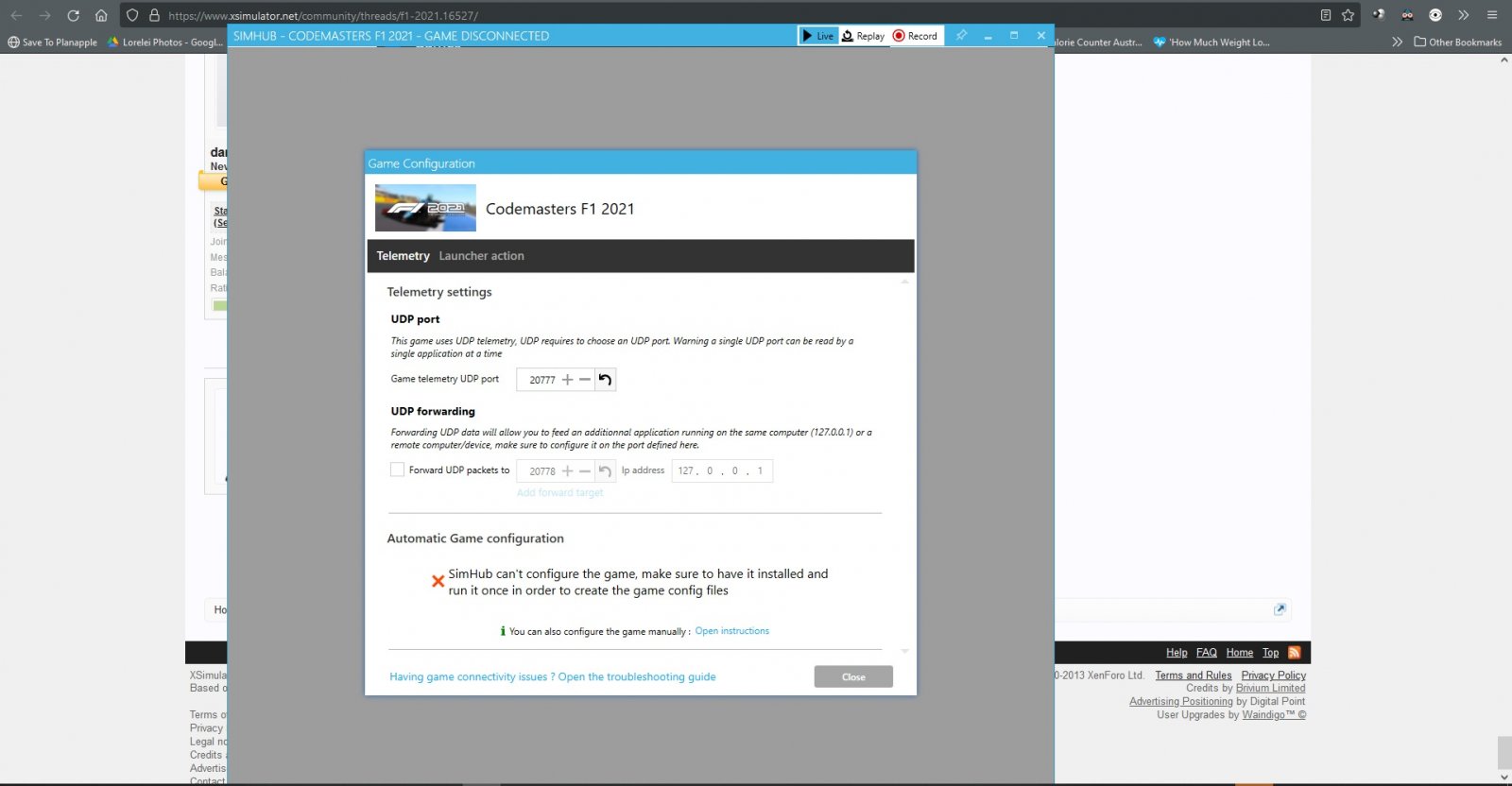

    hello i can't run simtools and simhub at the same time, when i use udp 2018, simtools is ok but not simhub, when i use udp 2021 simhub is ok but not simtools
