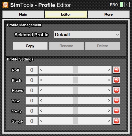

  6. Leandro Kemp
    Leandro Kemp Active Member Gold Contributor
    Oct 14, 2015
    161
    Brasil
    - 10Coins
    +34 / 0 / -0
    Hello.
    I'm having the following problem with this plugin on PS4.
    It works normally, but when stepping on the brake (movement of surge) the platform tilts to one side instead of leaning forward only.
    Anyone with this problem?
    Need some correction in the plugin?
    I await an answer.
    Thank you.

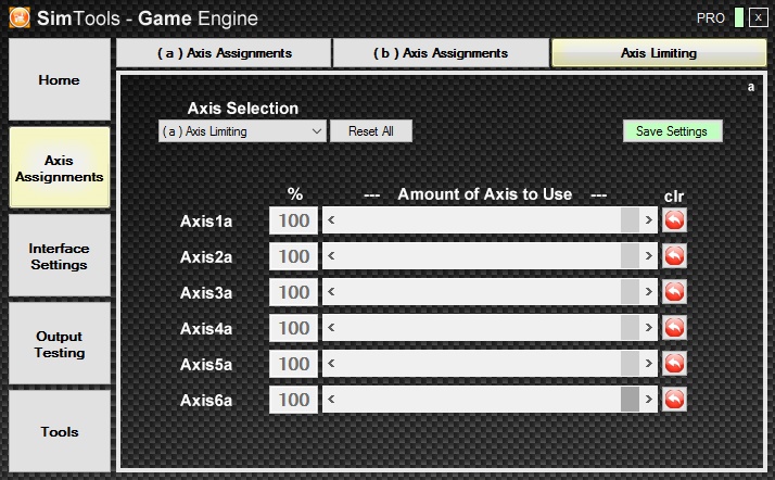

    Are you sure your Dir settings are correct @Leandro Kemp?
    Please post picture of all of your settings.

  9. SeatTime
    2,573
    28,321Coins
    if this is a standard 2DOF seat mover then all your selections for actuator directions are wrong.
  10. Leandro Kemp
    Oct 14, 2015
    161
    Brasil
    - 10Coins
    +34 / 0 / -0
    That´s because my right engine is in an inverted position.
    Maybe the surge is reversed.
    21,557
    150,962Coins
    +11,025 / 56 / -2
    It pays to correct the motor direction and ensure your rig moves as SimTools expects: https://www.xsimulator.net/community/faq/which-way-to-set-simtool-axis-movements.230/
    In addition to the issue with Dir settings the totals for your Axis Allocations are way too high and likely will result in clipping, see here for a guide on creating and refining a motion profile and aim for a total of 100% across all axis, you can go a little over but take it easy: https://www.xsimulator.net/community/faq/steps-to-create-a-motion-profile.228/
  12. Leandro Kemp
    Oct 14, 2015
    161
    Brasil
    - 10Coins
    +34 / 0 / -0
    All the movements are correct including the surge. Both sides lower during braking. It happens that during a braking the right side lowers more than the left.
  13. Leandro Kemp
    Oct 14, 2015
    161
    Brasil
    - 10Coins
    +34 / 0 / -0
    Even refined the problem happens. The fact that an engine is inferred does not mean anything, because all the parameters of axis 2 I leave inverted.

  15. yobuddy
    5,399
    50,579Coins
    +5,159 / 19 / -0
    Your Axis Allocations are way too high and are clipping.
    You read the axes from left to right.
    Add up the total.
    It should total somewhere between 100% to about 125%.
    You don't want the total to be under 100% at all.
    So if your driving a motor with single DOF then set it to 100%.
    If you are mixing 2 DOF's for an axis, then I set it to 120% total.
    (Because the 2 DOF outputs will not both be 100% most of the time.)
    (So the most one DOF can take from the other is 10%.)
    Remember, your physical axis can only do 100%, so all the extra gets ignored.
    Personally I would put Roll and Pitch to 10%.
    Heave to 20%.
    And Sway and Surge to 40%.
    This makes it 110% total.
  16. Leandro Kemp
    Oct 14, 2015
    161
    Brasil
    - 10Coins
    +34 / 0 / -0
    Okay.
    I did that.
    The problem continues.
  17. yobuddy
    5,399
    50,579Coins
    +5,159 / 19 / -0
    Remove the Roll and the Pitch (or set them to zero) and save.
    The try the sim again.
    Does it still persist?
