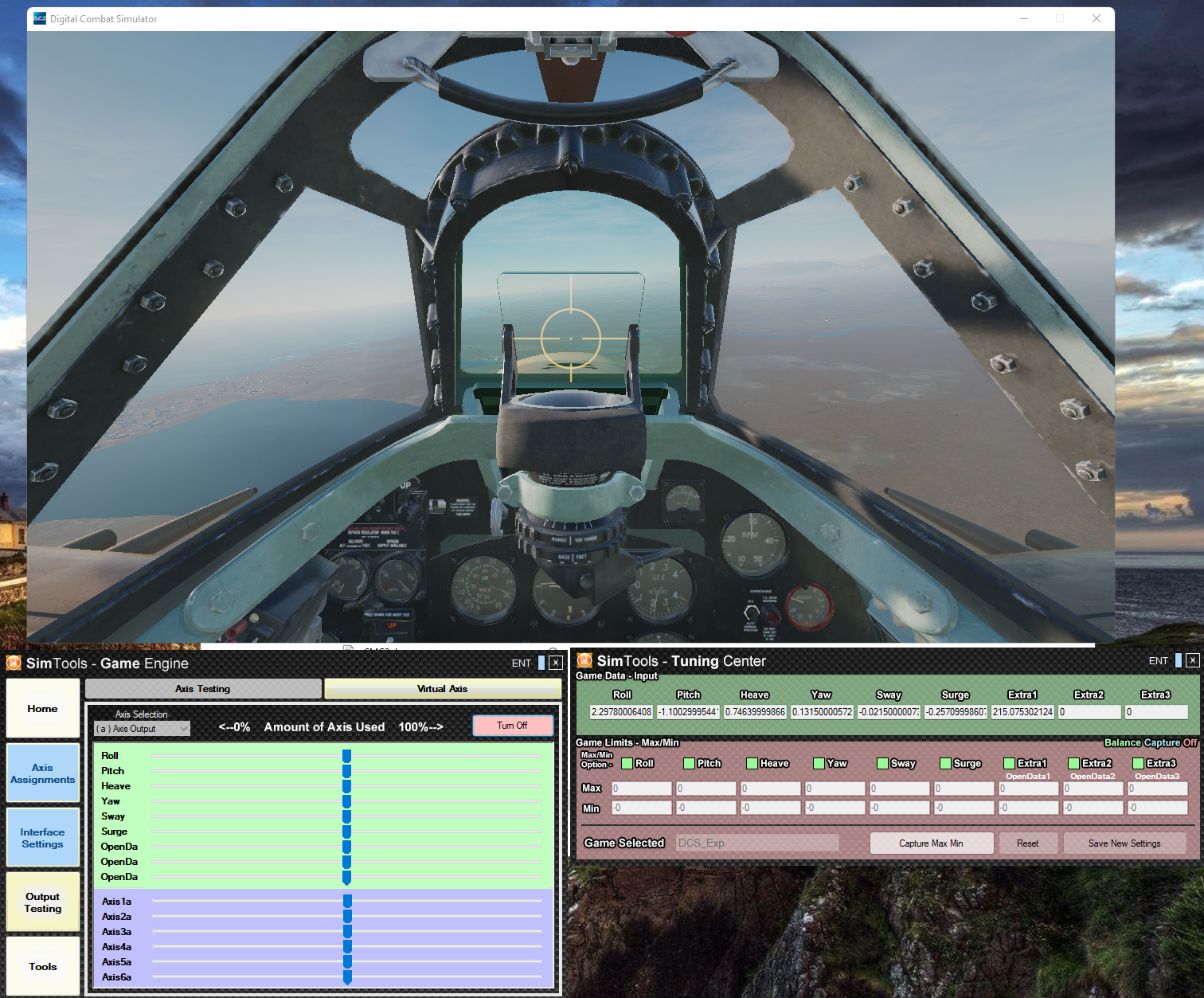

    I just wanted to check if DCS_Exp will operate the Virtual Axis in Game Engine Tools?
    (Using my same axis profile they work fine with MSFS but in DCS there is no movement of the Virtual Axis. I do see the values in the Tuning Centre Game Data Input though..)
    This is a screenshot where you can see the values in the tuning centre but nothing in virtual axis:

    Looks like you have zero for all Tuning Center values, try capturing the Max/Min values then tweak from there, see the motion profile tuning tips in the FAQs: https://www.xsimulator.net/community/faq/steps-to-create-a-motion-profile.228/

    Many thanks @noorbeast ! That worked. I just set some arbitrary values in the game limits (will still do an actual capture) but that was enough to get the virtual axis reacting:

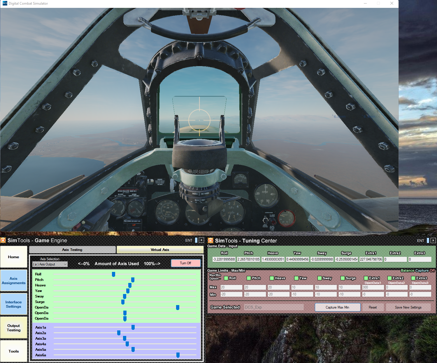

    I will still do a "Windiness" based on RPM and airspeed.
    Here is a screenshot of the values coming through:

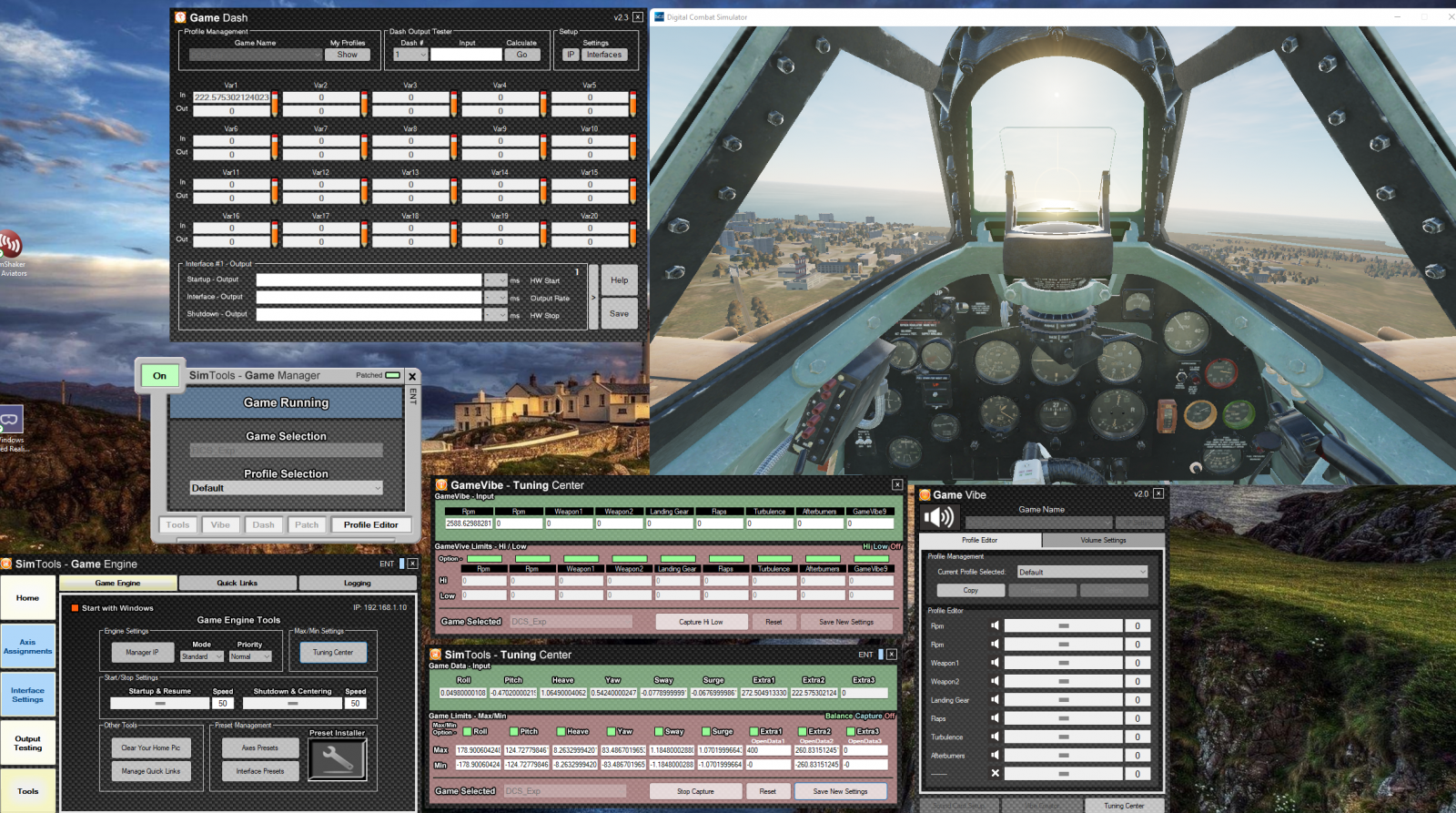

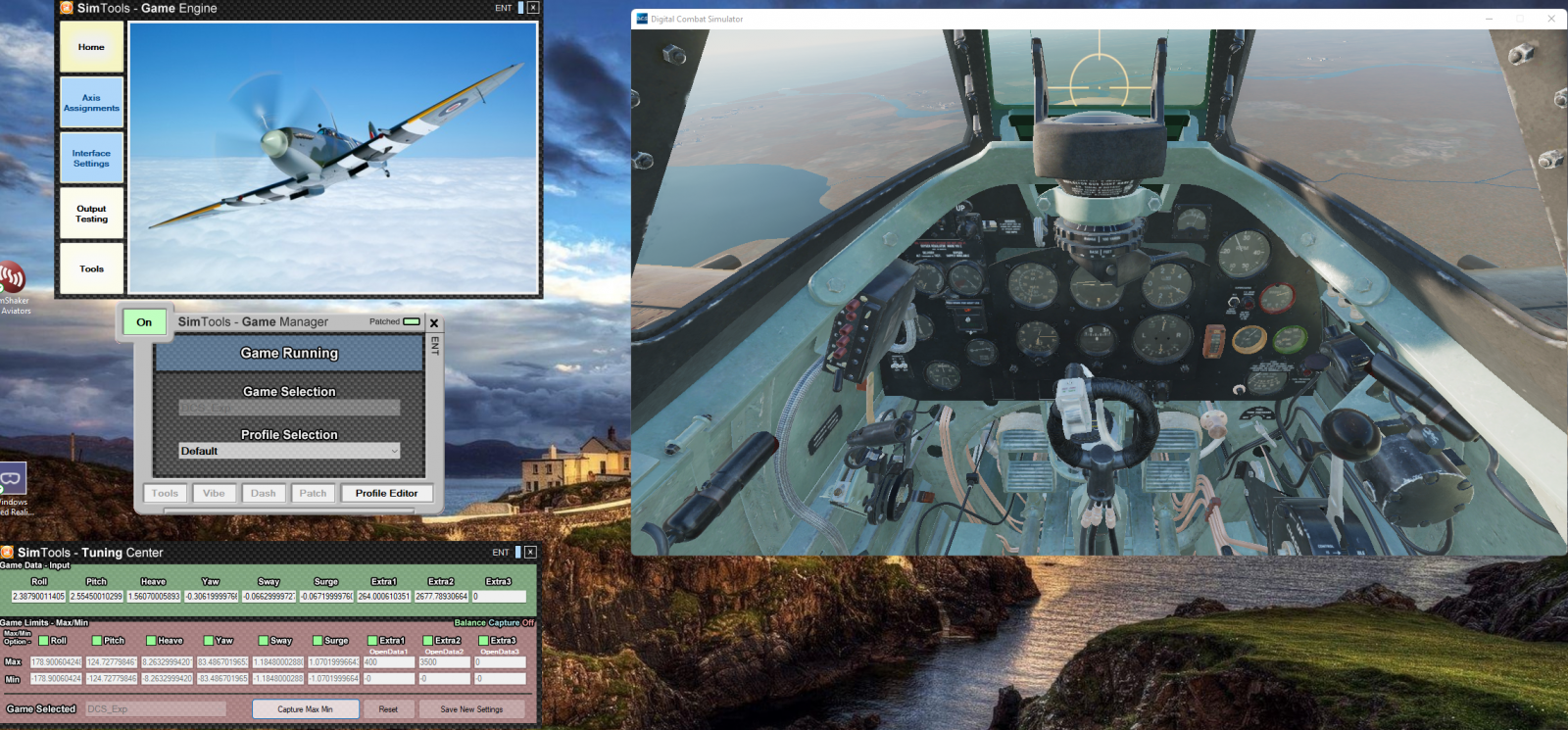

    More progress!
    I have put together a Wind formula and managed to display the Wind in Game Dash and RPM in Game Vibe, they are all working nicely. From here it's just a question of populating all the required fields, then seeing what the best way of running everything is with the Arduinos. Probably a combination of SMC3 for the g-force seat and airspeed force feedback (I currently have the latter running off DCSbios), some wind code for the fans to run off Game Dash and to see if I can replace Simshaker with Game Vibe to run the ButtKicker, thus have everything running off SimTools. (Only the 72 odd controls in the HFS Spitfire run off BU's)
    To calculate the Wind I worked on the premise that most of the wind generated will be off the prop and only a little added relatively by the airspeed (200 plus 50 to give 250 max wind). So if the engine stops and you are gliding, you will still get an airspeed wind but much reduced as a result. Just my excperience from my open cockpit flying and stands to reason, the prop has to much out much more wind to generate the thrust required to achieve the airspeed :)
    Here's the latest test showing feed to GameVibe (RPM) and GameDash (Wind) and the supporting code:
