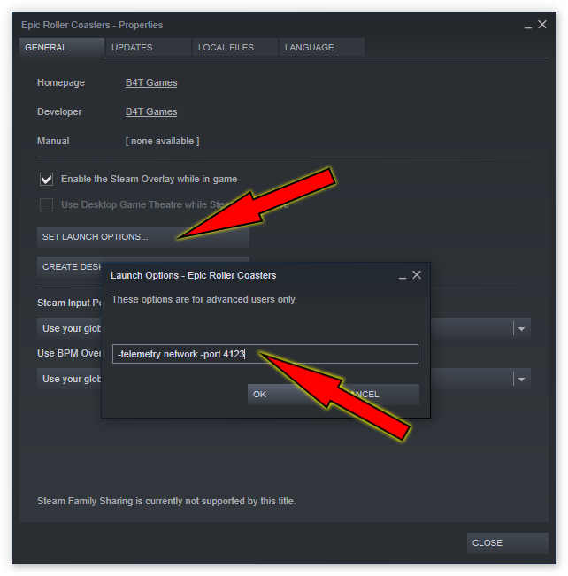

    Hello, for it to work, you must also activate telemetry in the game, in the telemetry option and change the value of 50010 or something like that to 4123 and then click on start. And solved

  7. Larux
    Larux New Member
    Oct 12, 2015
    17
    Argentina
    - 1,235Coins

    if you want it to work, just patch the game, then enter game setting, telemetry, press start and enjoy

    Patched -- IP and Port correct and Telemetry activated
