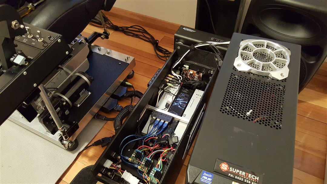

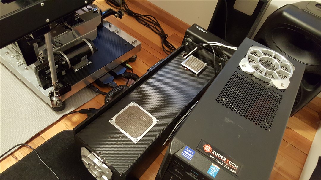

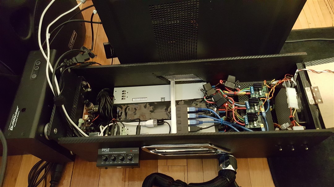

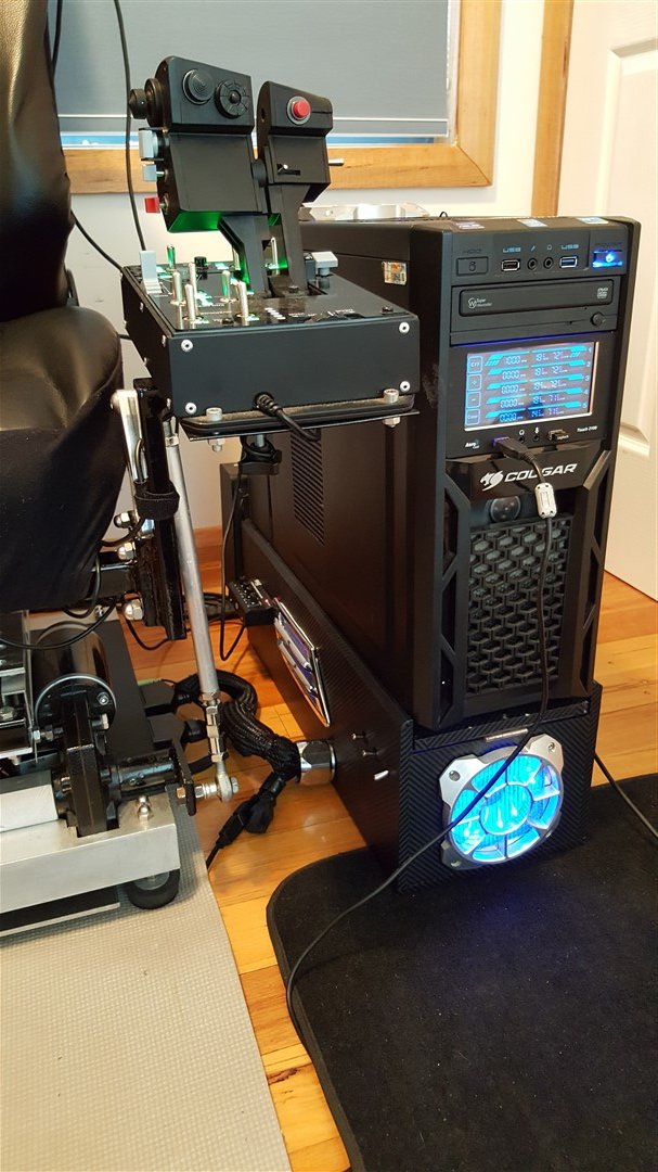

    A bit of an interim update.
    I built a computer dock ages ago anticipating a rewire and additional hardware, particularly for transducer support: https://www.xsimulator.net/community/threads/dx-racer-compact-simulator.5866/page-12#post-81158
    Now that SimTools 2.0 is out and Game Vibe is in the pipeline I have started the transition and rewiring for the computer dock.
    The computer dock currently houses 3 temporary amplifiers, one under the JRK control plate at the front, one at the rear of the box for external PA speakers and the original Buttkicker amp hanging off the back. These will soon be replaced with a 2 channel 300W Class D Audio amplifier board and 2x4 channel 100W Class D amplifier boards, along with an additional 36V PSU.
    I have connected the first of 2 Pyle Pro control amplifiers. They manage the existing on-board and external audio plus existing transducer, but will also allow on the fly adjustment for a bunch of new transducers once Game Vibe is available.
    The dock also houses the 3 HP PSUs and JRKs, which are cooled by 2x120mm fans. One slim 80mm fan is used at the rear of the dock.
    Cables now quick connect to the simulator base using 2x9 pin trailer plugs, a dual USB/3.5 audio plug and 12V plug for on-board power.
    I am still waiting on new USB3 extender cables for the Rift sensors and have yet to run the temperature sensor cables from the front mount touch control fan panel with audio heat alarms to the JRKs.

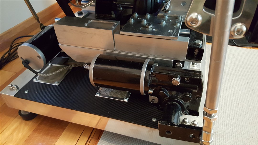

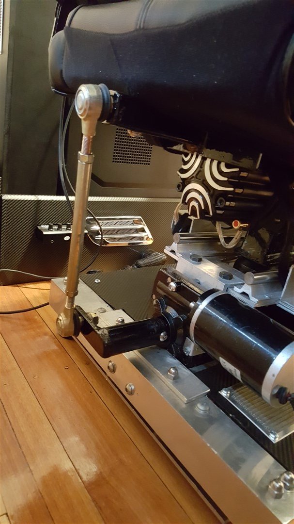

    As I had more room in the compact sim base I have added 3x80mm cooling fans for the motors, they don't even get warm now!
    I also rebuilt the rear motor arm seat connection bracket so it is a lot tidier.
