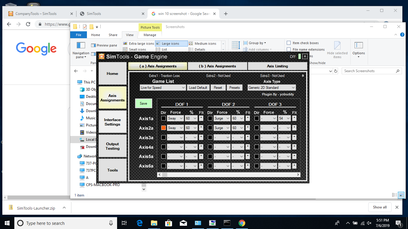

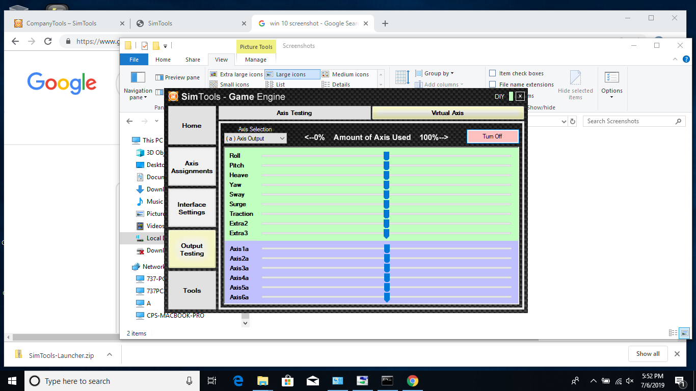

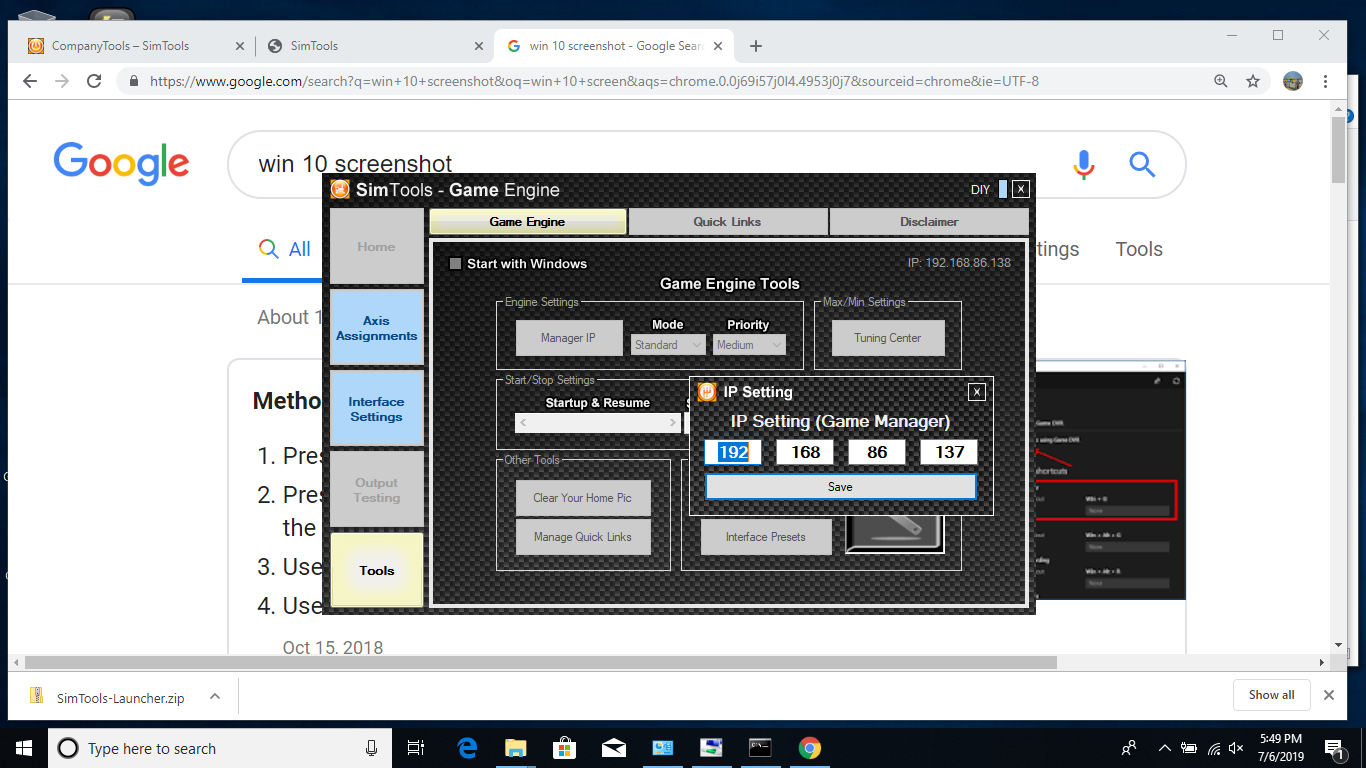

    Ok, here is an update. Here is all the things i tried today. I will also post the setting after this update.
    A) Connected the two PCs through a new switch, No wireless router involved now. Once again all connections are great. GEng and Game Manager turn blue. But no Telemetry.
    B) Based on recommendation above, tried a different computer. Win 7 this time and hence both Manager and Engine are running on Win 7. No Joy. Once again, all connections are made. Turning Mgr ON/OFF turns the Engine ON/OFF - i.e .disables/enables buttons.
    C) Installed LFS directly on both PCs. Individually both PCs work on the Game Engine. Only remote is the issue

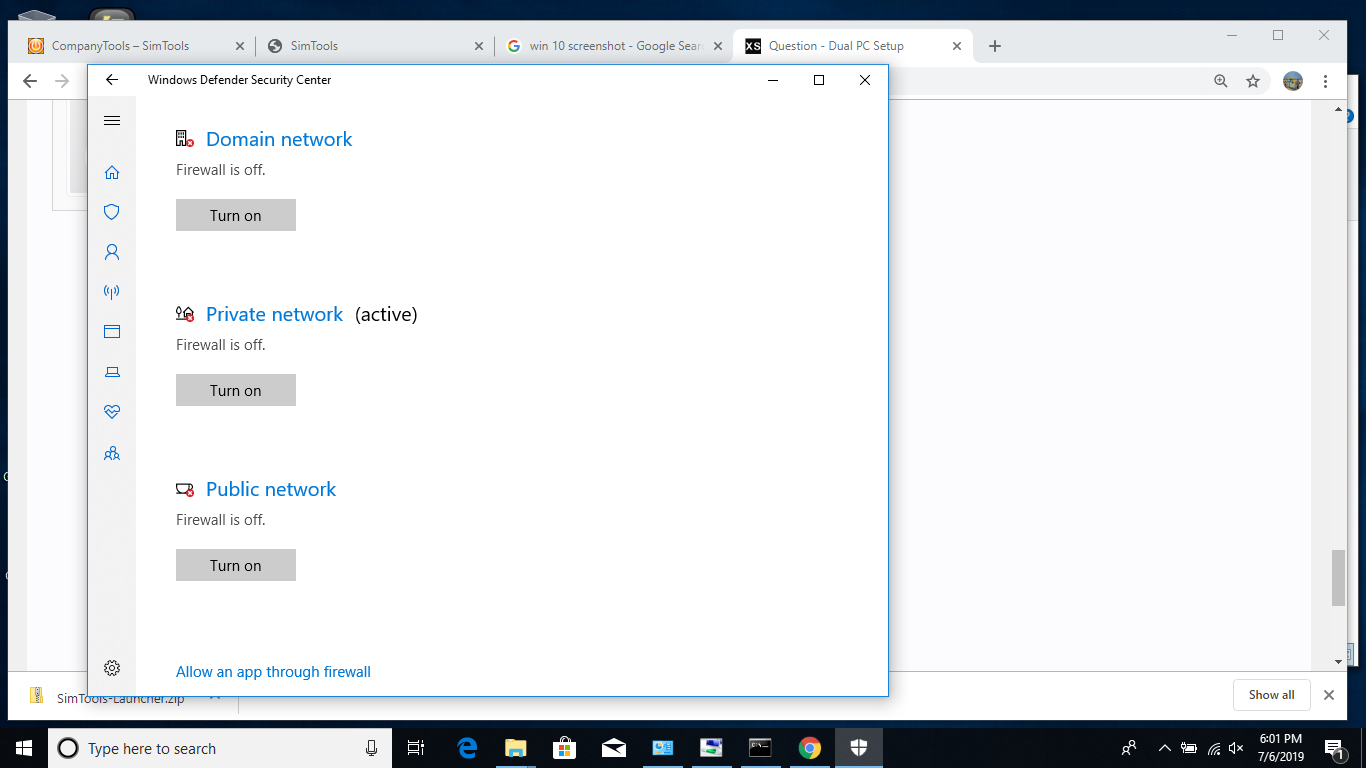

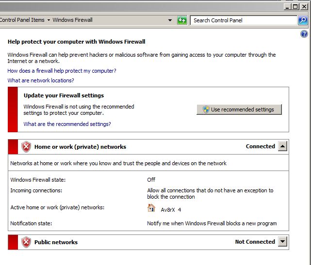

    D) ALL FIREWALLS ARE OFF. One PC has ESET, which is disabled for each of the above sessions.
    Here are teh settings screenshots from the Game Engine PC - Win 10.

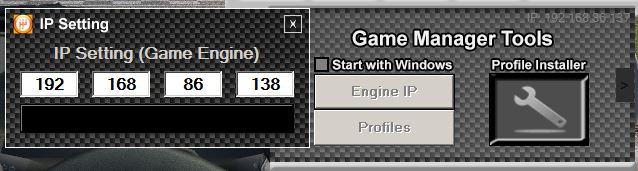

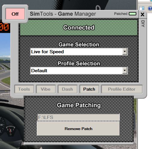

    Game Manager PC settings below

    Game PC Firewall settings

    Are you un-patching and re-patching the game after the Ip change?
    In the LFS folder, look for a file called cfg.txt, open it to see if the game is sending to the correct ip address.
    (Ip addresses at the bottom)

    Can I check that you have run a race in LFS in first person mode prior to patching it for motion, as that generates some required files.
    If not then unpatch, close SimTools, run a race in first person mode, then re-patch LFS for motion.

    All I can think of is that the games port is blocked? 4123?
  18. yobuddy
    5,374
    50,290Coins
    +5,148 / 18 / -0
    The game sends its data directly to the "other" pc.
    So maybe look on the "other" pc windows firewall and see if packets are coming in when the game is running.
