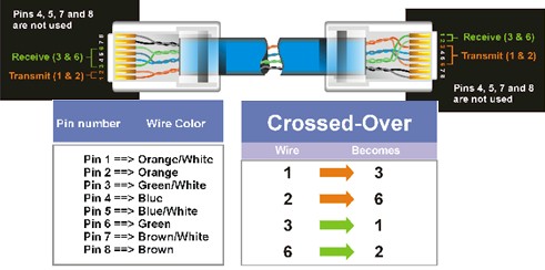

    A little help for using two pc's connected on LAN without Hub or switch.
    ONLY a cross-over cable
  12. yobuddy
    5,399
    50,606Coins
    +5,159 / 19 / -0
    A cross-over cable is the best way to run a 2 PC sim setup for sure!!
    Very fast communication!
    Nice Work @Ceresoli!

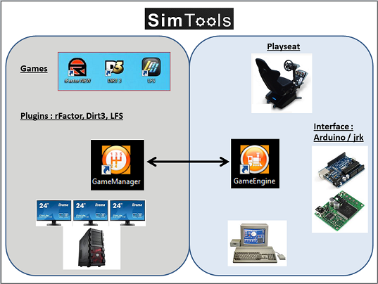

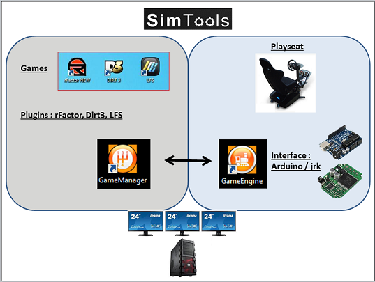

  14. RacingMat
    2,237
    21,031Coins
    hello!
    I have updated the FAQ with these two pictures and @Ceresoli 's instructions
    Here a single computer setup:
    Here a dual computer setup:
    Nota: you have to install plugins on both computers! ;)
