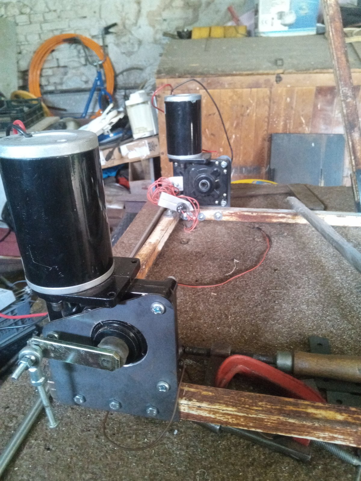

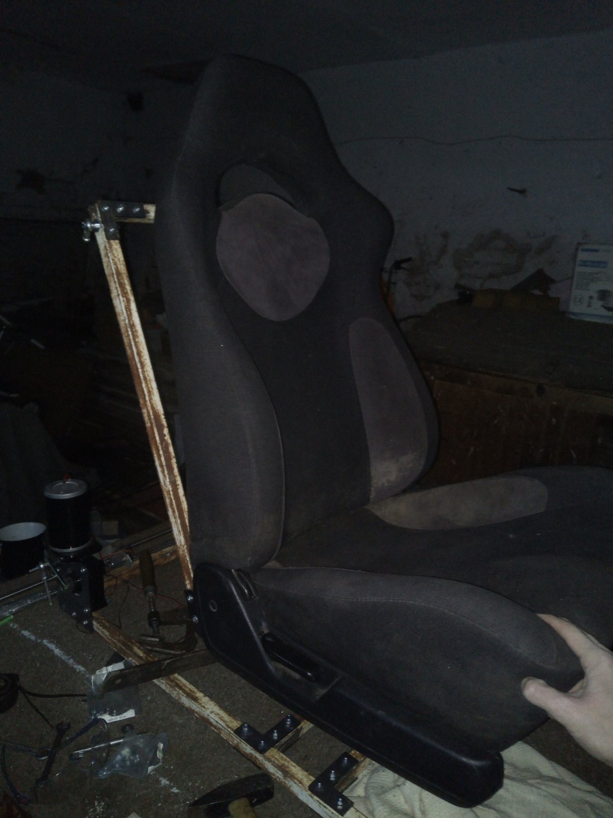

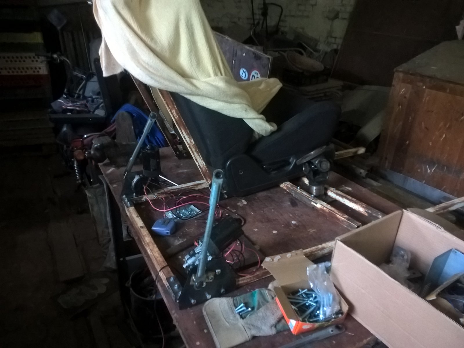

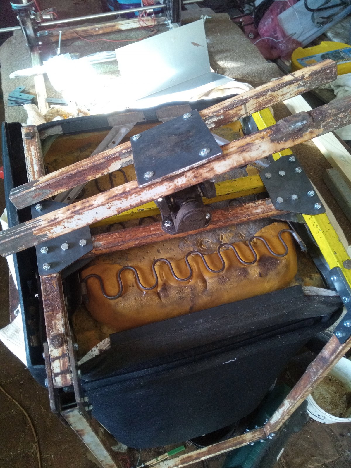

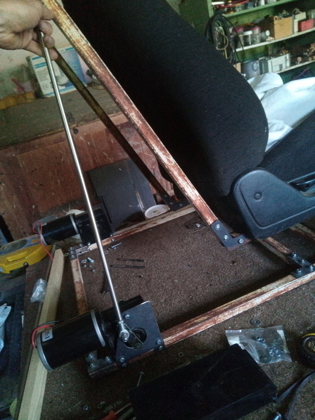

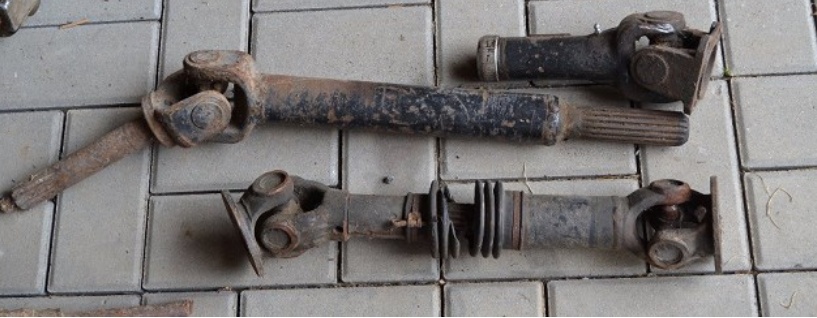

    And the same day even the construction work moved on. Motors attached to the frame. U-joint is impractically large and would required additional material to mount it to the bottom side of the seat so decided to get smaller U-joint (scrapyeard for 10 euro available) so hopefully it will work as well.
    Leading shafts to be replaced by stronger ones most probably connected by Ball Joints.

    Anyway, pots mounted to motors. JRKs waiting to be utilized, can't wait to test them!

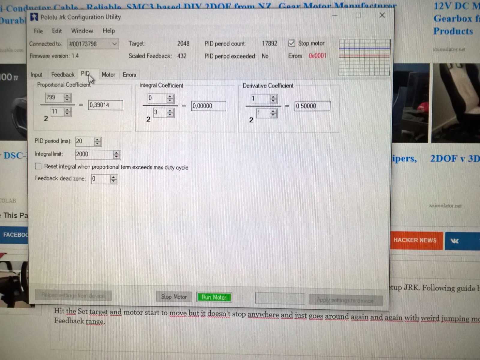

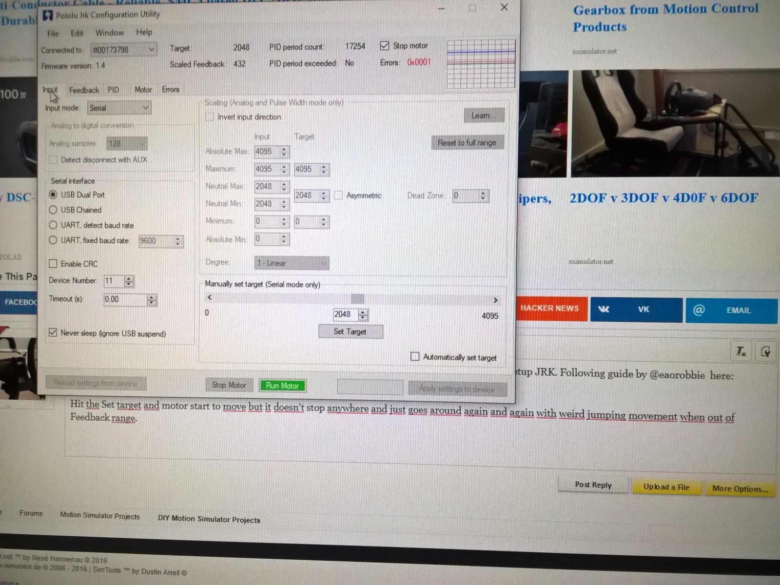

    continue with pictures of JRK settings and video (hopefully):
    any ideas what's wrong guys?
    Thanks for any advise
    21,724
    152,057Coins
    +11,063 / 56 / -2
    Was the pot set to the 50% before running the Learn process in the Feedback tab to set the Max and Min positions, if not then re-position the pot and re-run the Learn process?

    Hi, so I tried to set lever to 50% before clicking "Learn" in feedback section but no change. I decided to do a re-do of soldering/connections between JRK/pot/motor just to be sure. Additionaly I'm going to try swap cables between JRK and Motor- hopefully can't damage anything?
    21,724
    152,057Coins
    +11,063 / 56 / -2
    JRKs also have a reset to defaults option in the menu, you may want to try that and redo all of the settings from scratch, including the Learn step.
    You also need to carefully check that you have the pot wired correctly.

    So after couple of days of trying I was able to move one motor by the Feedback slider in the JRK application - great satisfaction for me:
    great motivation boost for me BUT I was about to add second motor and hasn't been able to replicate it anymore. Looks like some short circuit or bad soldering (which wouldn't be a surprise) so decided to do complete re-solder once I have a free time.

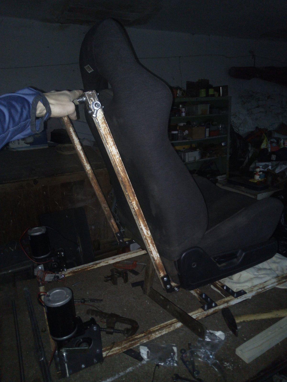

    Little bit of progress again today. Construction complete except levers.
  19. drtikol
    drtikol Member
    May 7, 2016
    73
    Czech Republic
    292Coins
    +32 / 0 / -0
    2DOF, JRK

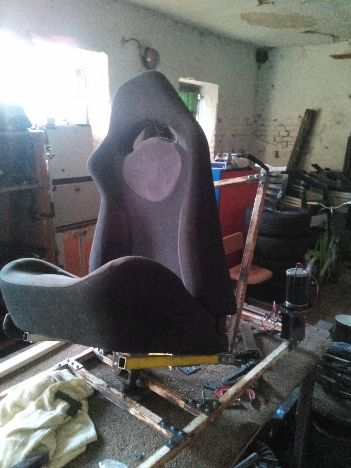

    Doing some progress (huge motivation boost for me actually) as mechanics looks now OK. Had to do some adjustments in terms of motors fastening to the frame, their orientation etc.

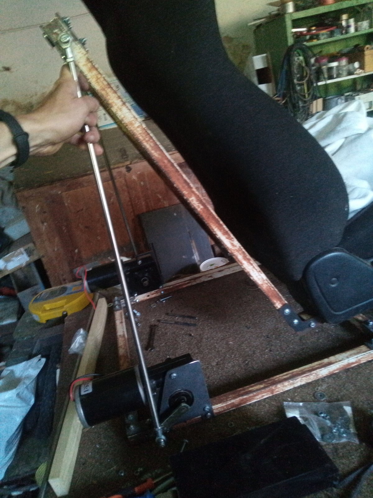

    Closer look at the lever movement.
    Do I understand correctly that the video shows expected movements -up and down ?
  21. drtikol
    drtikol Member
    May 7, 2016
    73
    Czech Republic
    292Coins
    +32 / 0 / -0
    2DOF, JRK

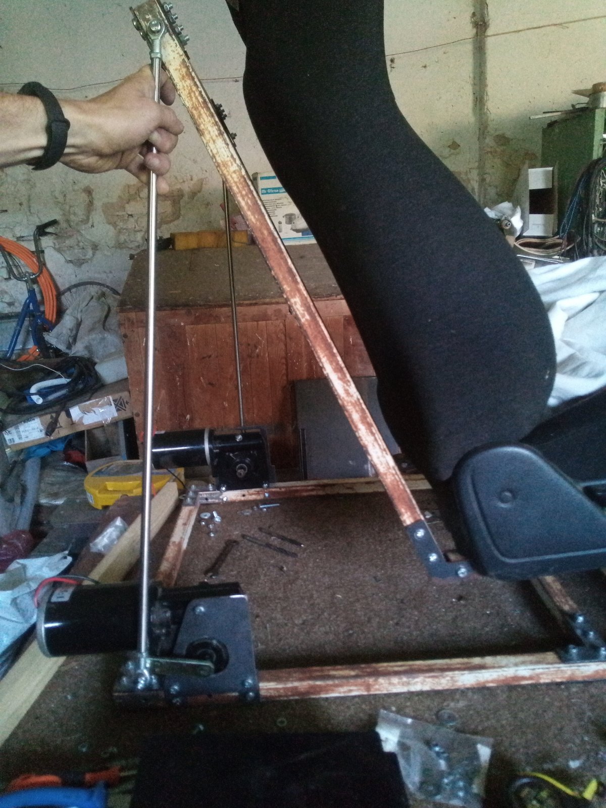

    And some pictures:
    1) center position
    2) Max up
    3) Max down (may be not Max, could be little lower)
