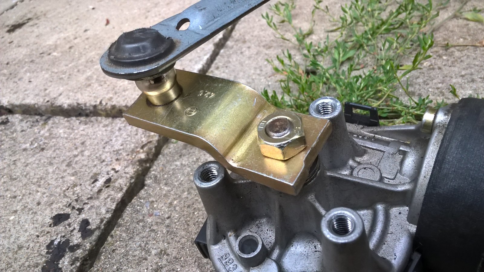

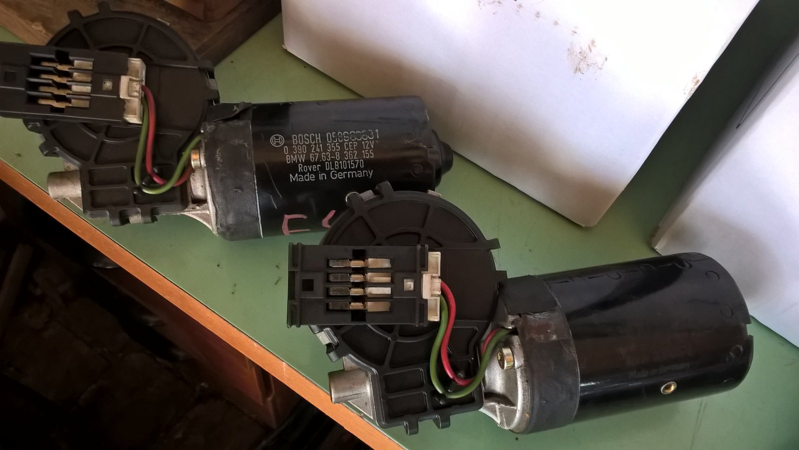

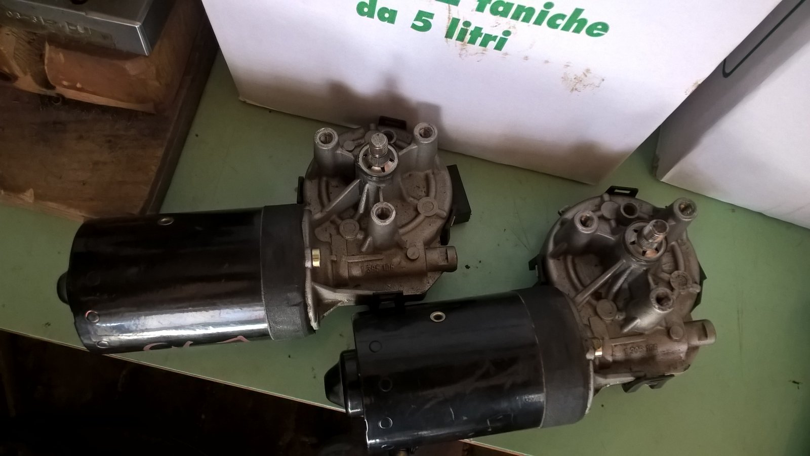

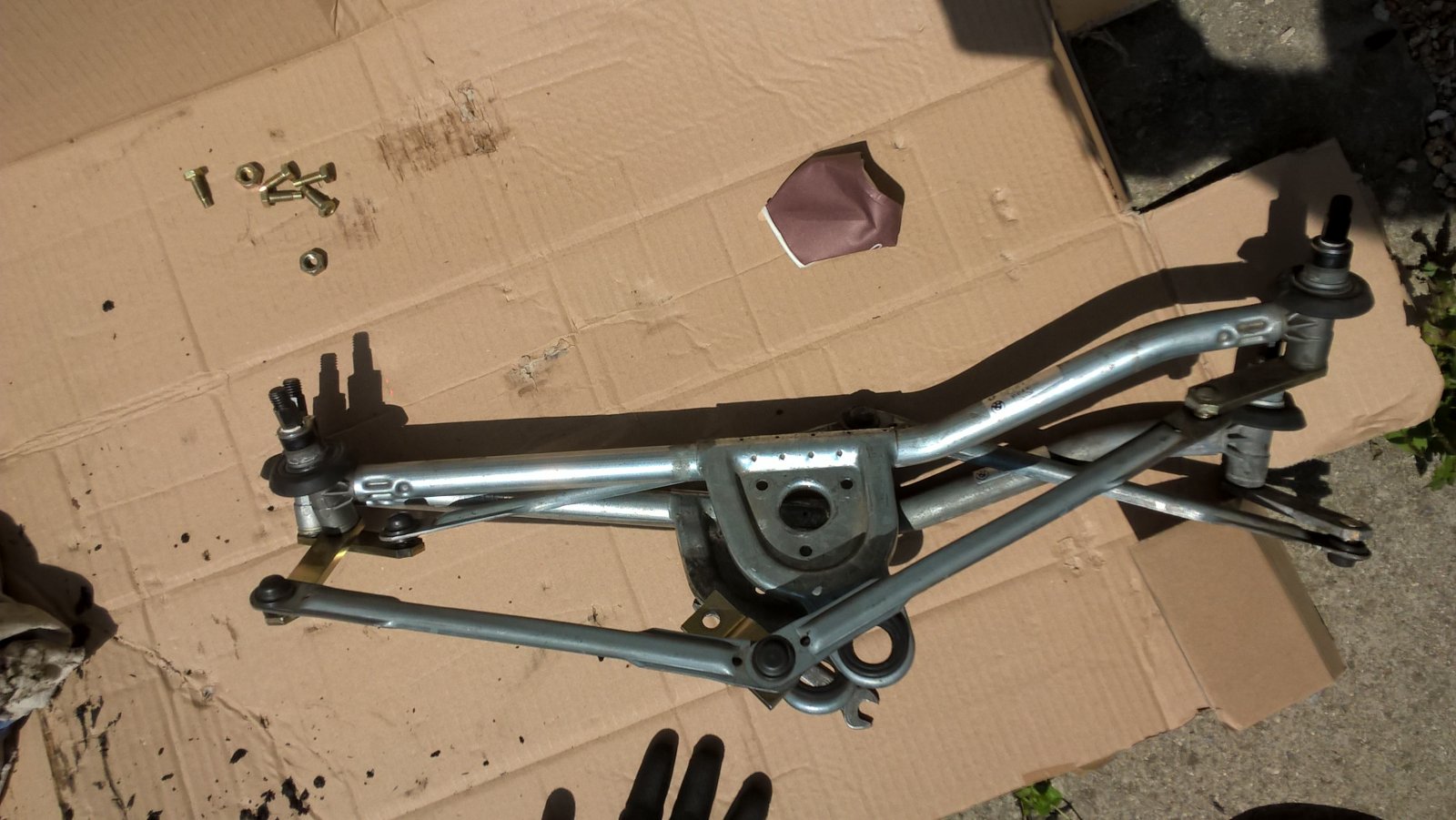

    So couple of pictures to show what I'm working with so far. First day was pretty much disassembling 2x wiper mechanisms I got from second-hand BMWs 3-class model E46(pretty old now I know) but they are made by Bosch in Germany so "should" hold some reliability. I got them for 20$ each and actually they look in mint condition.I opened the plastic back cover to see the transmission and they both look like new inside-full of slightly yellow grease so I guess they are OK.

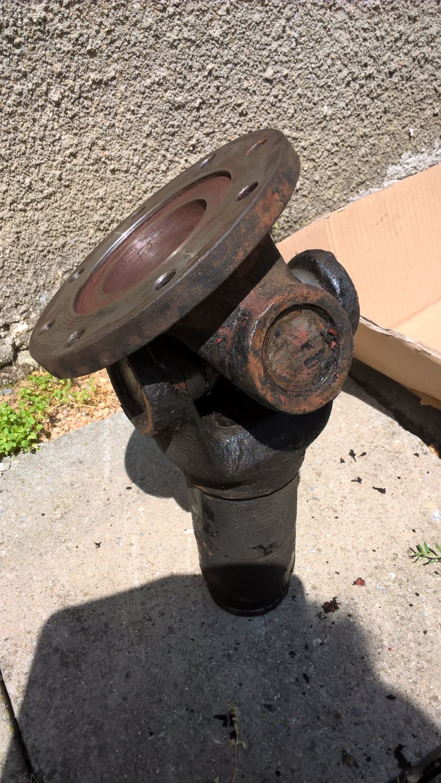

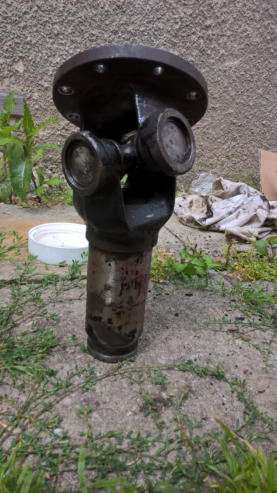

    Next thing was to clean up a bit the joint to be used under the seat. As wipers it is a cardan joint from used truck car (unfortunatelly from BMW as well as it would cost 15$ more than actual one I got for 7bucks). The top part is quite close to axle of turn so it should fit the need (to keep seet as close as possible to the axle of turning) and the bottom part allows some space under the seat for motors, electronics, PSU etc.

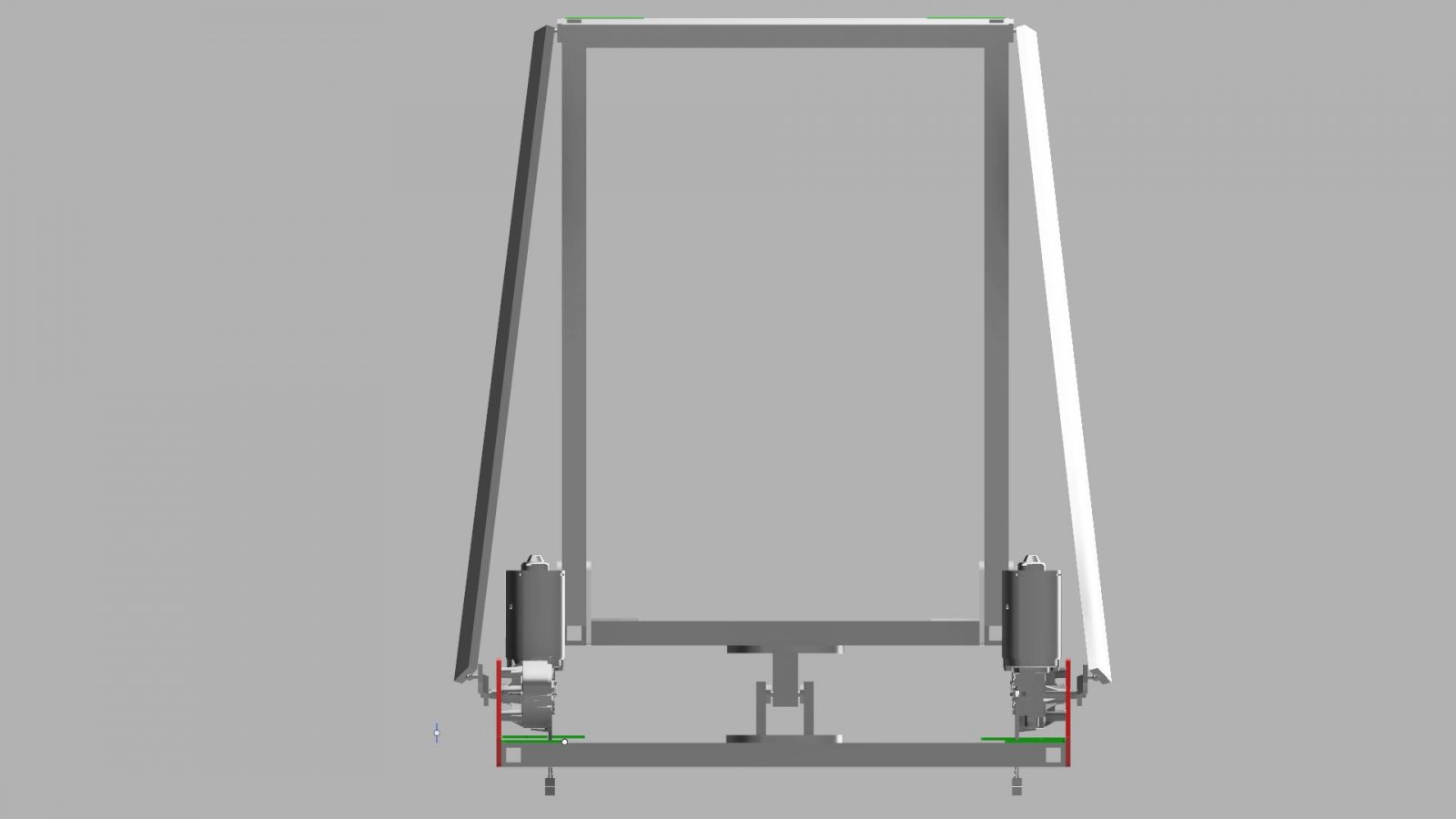

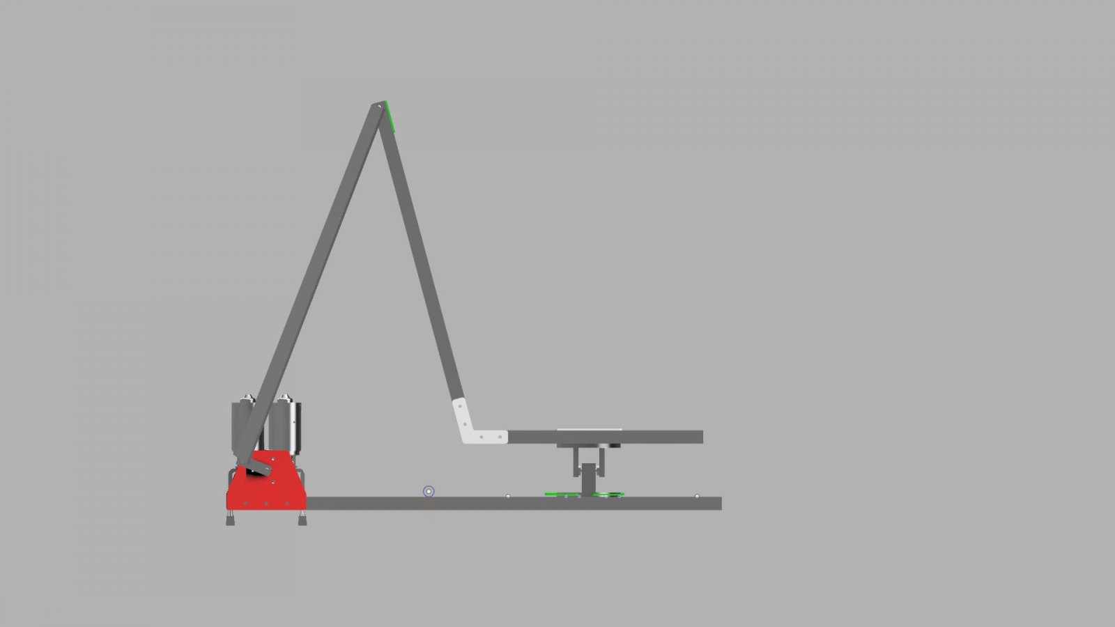

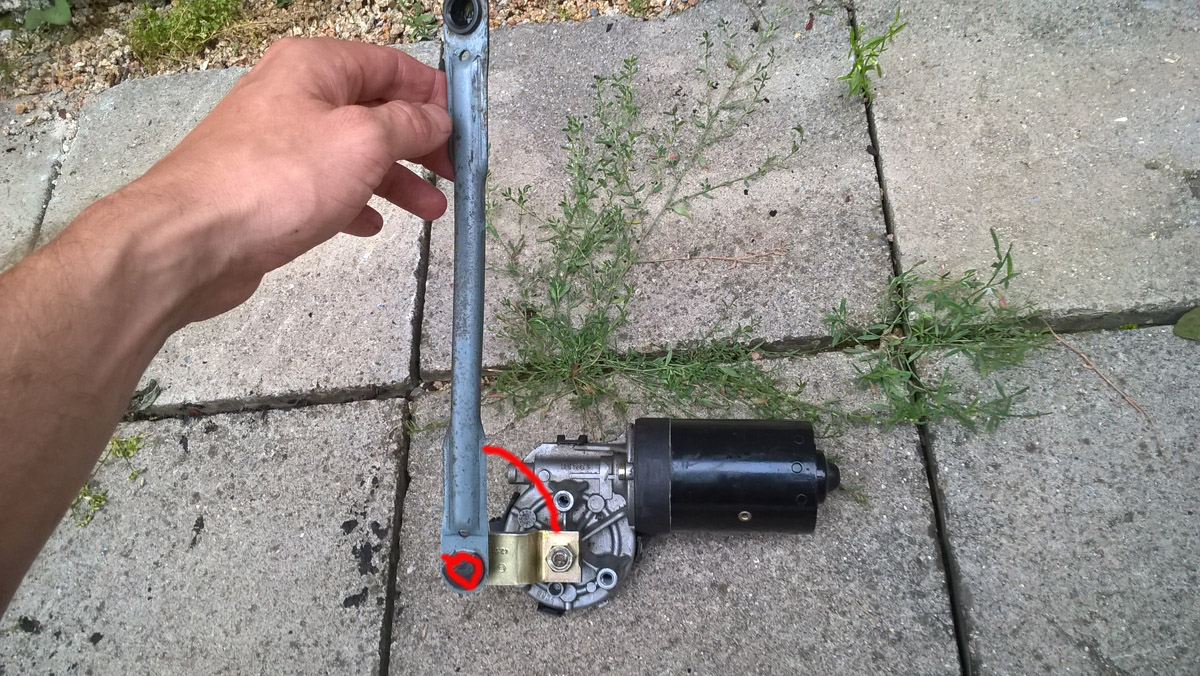

    Just for clearing my head around how the wiper will work with levers I just tried to simulate lever arm with parts from wiper structure.
    In theory, would this work if mounted to shoulder height of the back of the seat?
    Should the angle marked red be perpendicular and fixed or moveble to allow arm to extend?

  8. drtikol
    drtikol Member
    May 7, 2016
    73
    Czech Republic
    292Coins
    +32 / 0 / -0
    2DOF, JRK
    Thanks again. Please disregard my silly question regarding fixed/flexible angle, watched some videos again and needs to be flexibe of course.

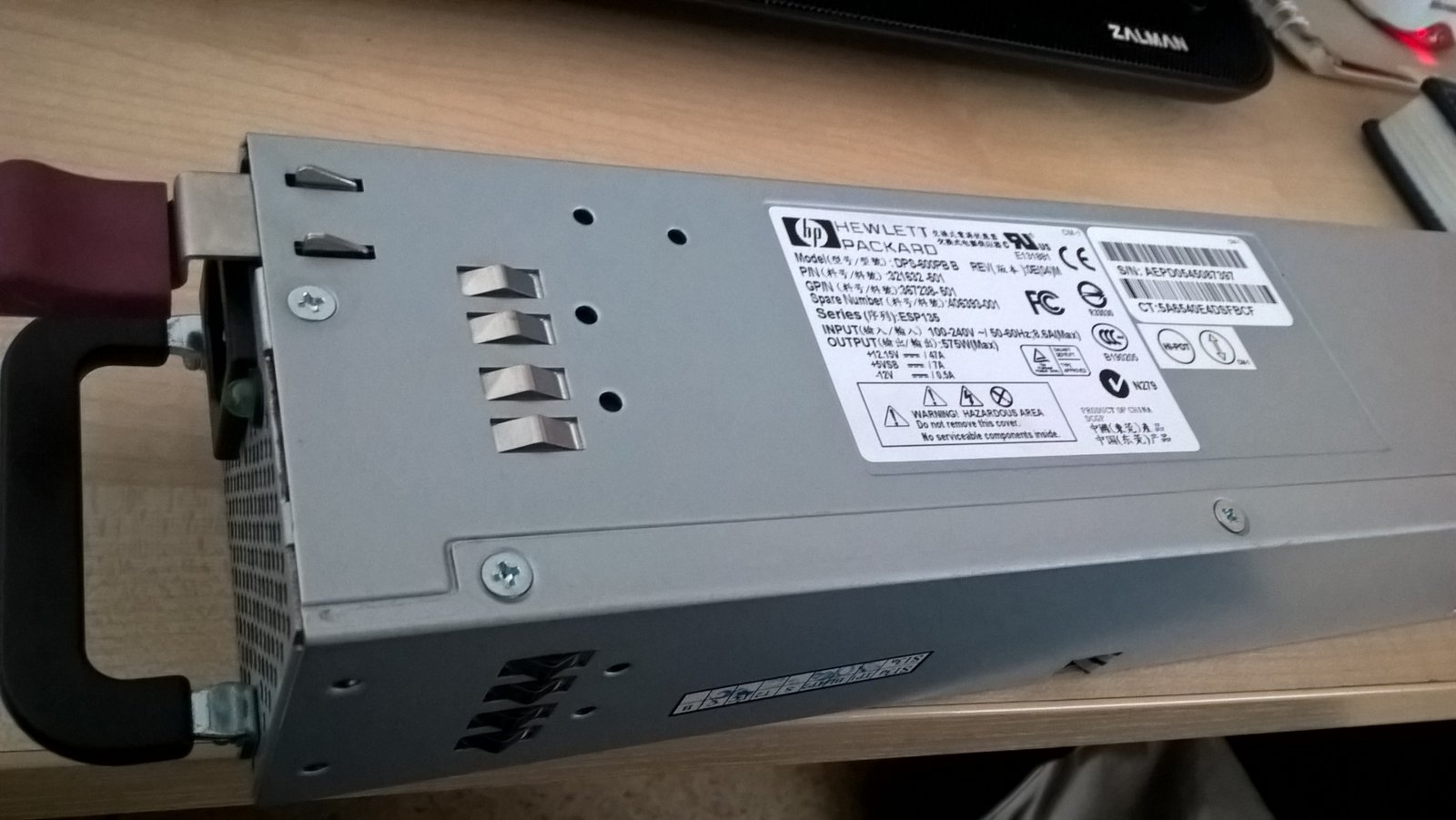

    and few hours later another delivery(I would love to have my job projects go that just in time:thumbs): HP PSU DPS-600 to be modded.
    Got it for 20$ from second-hand market here in Czech.
    So basically what I got now:

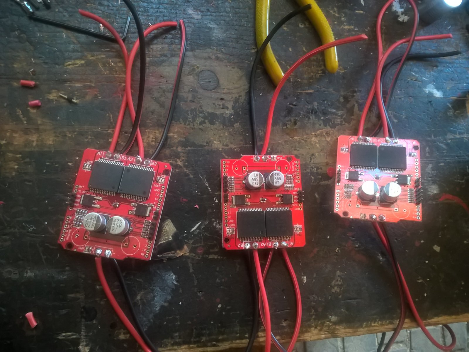

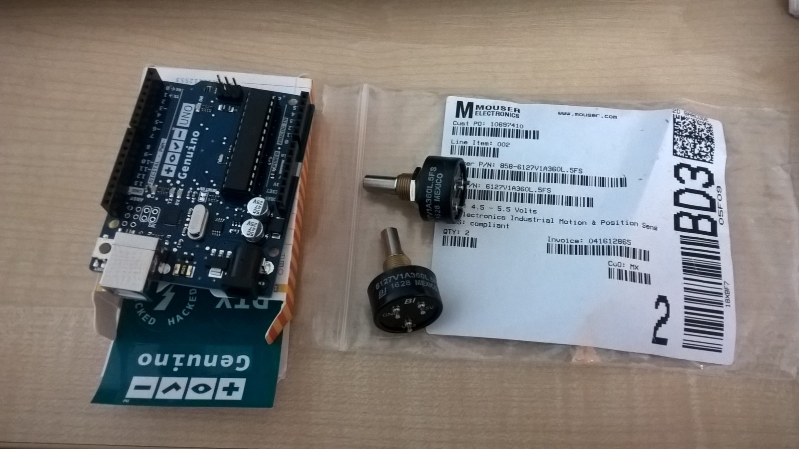

    1x Genuino (and plus 2x dirty cheap chineese clones for 2$/ea which I ordered together with Monster Motos)
    2x Monster Moto shields (bought from chineese seller "verified by @Pit here: https://www.xsimulator.net/community/faq/reputable-monster-moto-suppliers-testing-before-use.158/
    1x HP DPS-600 (as mentioned above)
    2x HAL pots 6127V1A360L.5FS from here for 15$/ea (I stupidly missed free shipping by 2$ and basically wasted 20$ :mad:)
    http://cz.mouser.com/Search/Product...rtualkey57700000virtualkey858-6127V1A360L.5FS
    2x Bosch wiper motors (CEP 12V) from BMW E46 (to be tested and ground isolated if needed)
    1x U-joint from truck (czech made Avia if someone interrested:)) cardan
    https://www.google.cz/url?sa=i&rct=...ZVyPFZCKrGd8o7QkoZo-Hasg&ust=1470825797030347
    So from electronic/motion point of view I've got all I need to start my build, right?

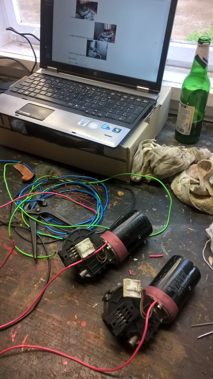

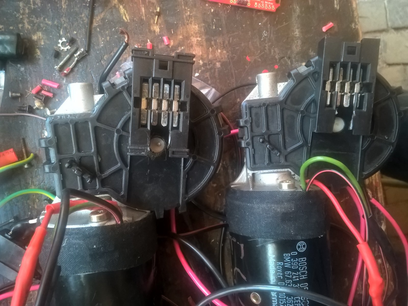

    Motors grounds isolated(hopefully) so if it kills me now it's up to you guys

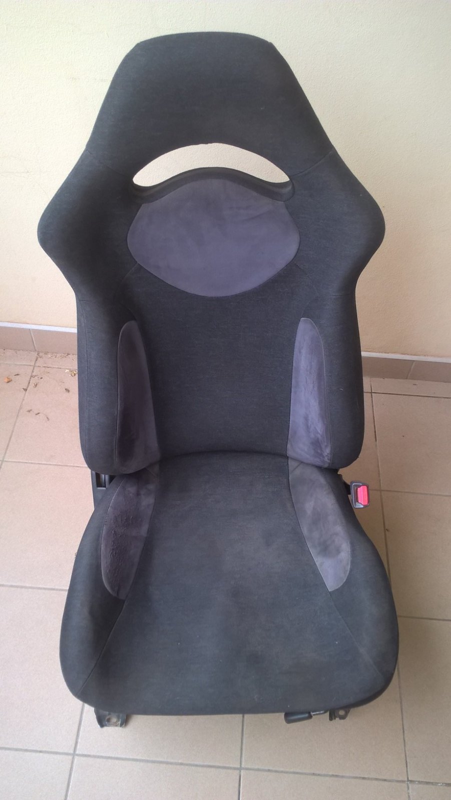

    I got it! The last component for my build - seat from Subaru Impreza GT96. Why not at least sit in it if I could not afford whole car;)

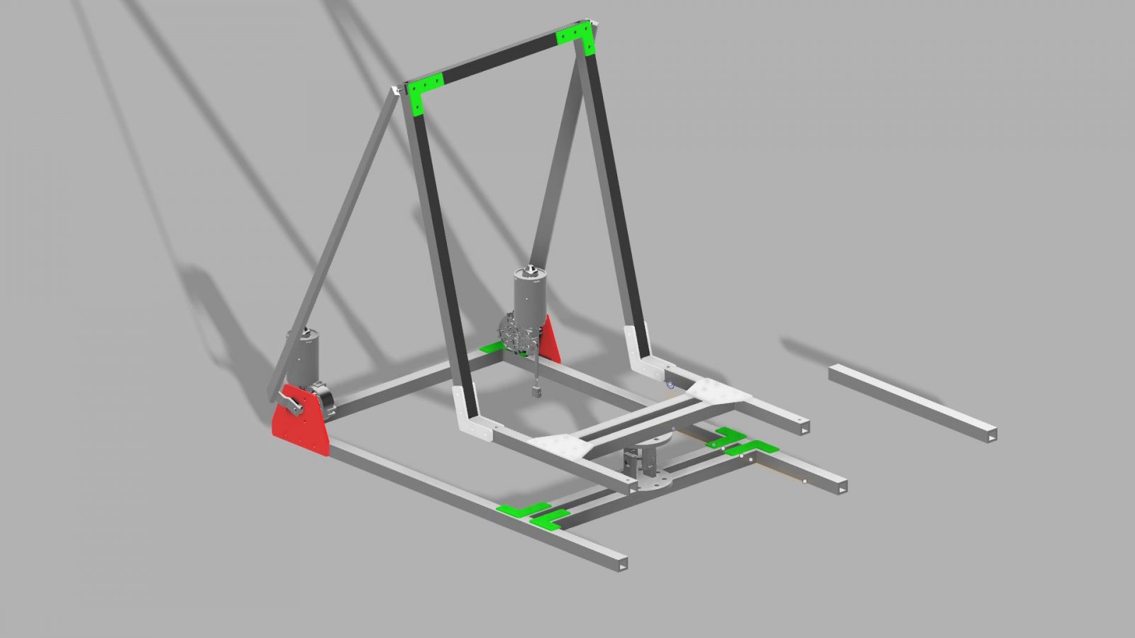

    Thanks @noorbeast so as long as angles are within this range is OK,right? There is not a single "Best angle" ? Because I could adjust measurements of rods and construction to serve the best purpose.
  17. noorbeast
    21,723
    152,051Coins
    +11,063 / 56 / -2
    In terms of best angle the most effective use of torque is under 40 degrees either side of right angle, but other practical design considerations come into play.

    Little bit of progress, my soldering skills improved by huge leap (from actually no skill). Now I'm puzzling how to connect any type of rod between the motor (drilled holes through motor covers and there is some kind of very solid plastic inside) and potentiometer. There should not be a huge friction when potentiometers rotates, correct?

    Thanks @noorbeast but I expressed myself wrong probably. I've got flex mounts bought for rod-to-pot connection but problem..ehh challenge here is how to connect rod itself to the motor. I'm thinking of try to melt plastic part of the motor little and connect it with hard plactis rod that way. i.e. plumbers do the connections of tubes.
