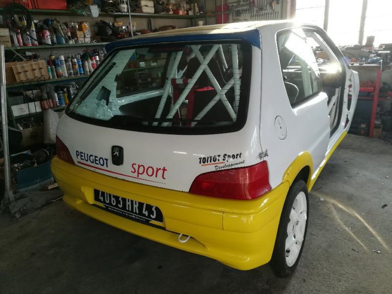

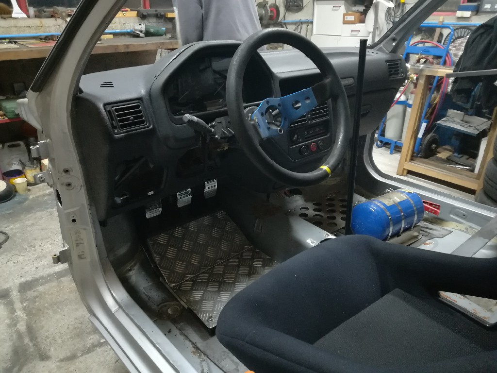

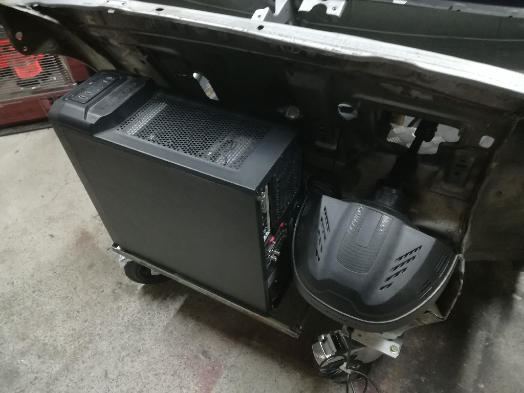

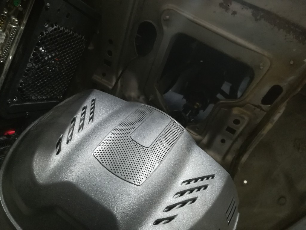

    Hello !
    Here is my new project ( or my dad project because my project is here : https://www.xsimulator.net/community/threads/3dof-with-350w-dc-motors-nicopoche.11699/ )
    I raced for years on a 106 F2000 and now we try to "reproduce" it in simulator ^^

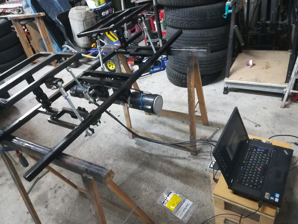

    We want that the 2 seats move at the same time in 2Dof with only 2 motors and here is the solution we found :
    And now we are here :
    New pics are coming because now the car is painted, and we are close to make the first tests :)

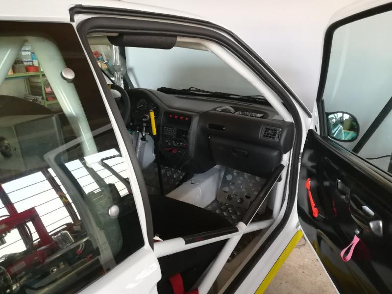

    Here is the first test we made "unmounted" :
    [flash width=425 height=350 loop=false flashvars=]
    And the car I used to drive in real :) :
    The engine is now a computer ^^ : ( don't worry, we didn't cut my rally car... We sold it et bought a crashed 106 rally body to make this simulator ^^ )

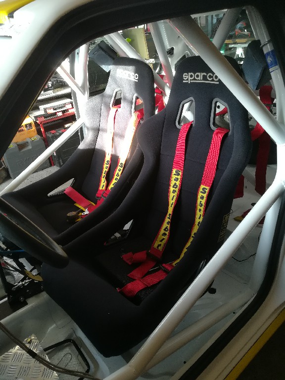

    Have the motors been tested with a 2 person load?
    Design wise the uni joint should be as close to the seat as possible, in particular with a compact design that has limited inherent design leverage.

    Thanks for your reply and tips :)
    You are right, the joints have been modified since the picture, thez are now closer to the seat. We have not tested yet with 2 persons, but the levers are very short so we are confident ( or too optimistic :D )
    At the biginning of the project, we thougt about moving all the car body :grin:grin:grin:grin

    +33 / 0 / -0

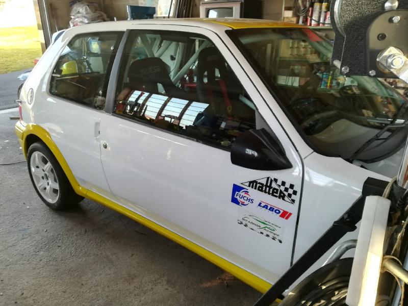

    Hello !!!
    Now we are here !
    First test with a TV. Next, we will make a screen and use a short throw projector.

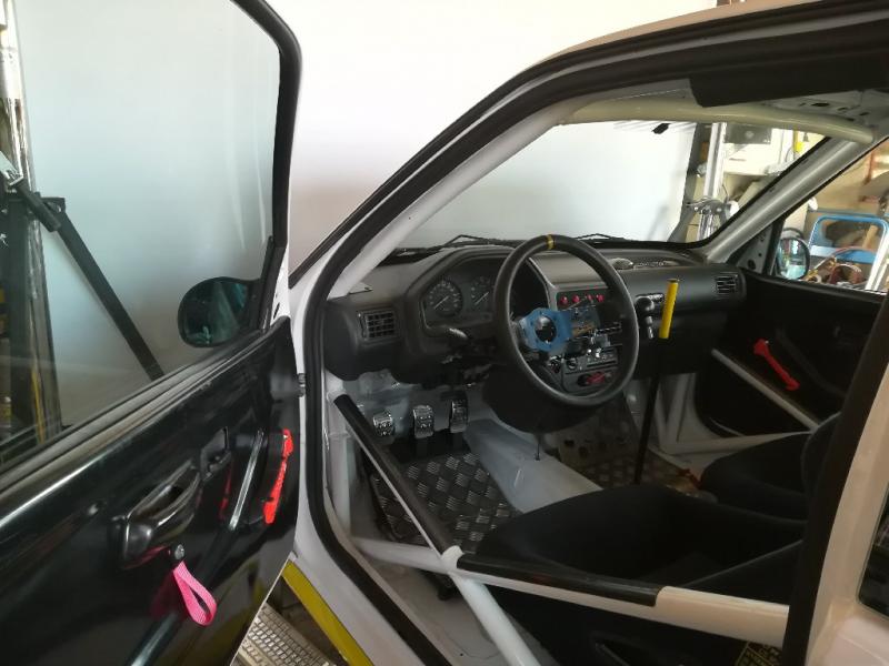

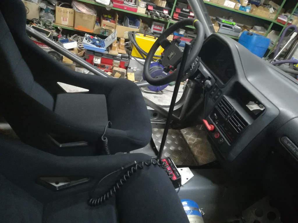

    For the wheel, I found the radical solution. :D
    I opened the wheel base, took off the cable that connects normally to the wheel and passed it at the rear of the base. So now, i can connect directly the wheel button part directly next to its base, and everything is fixed ( no cables turning with wheel ).
    The problem, when I'm in the car, the wheel button are now unaccessible ( outside the car )... Ok, so i soldered 2 cables on each contactor button of the T300 button part ( for the moment only on shift + / - and handbrake but I can do it on each button of the T300 ) and go to the in-car contactors on my handbrake and shifter.
    With the other buttons of the T300, i will be able to make a little button box in the car...

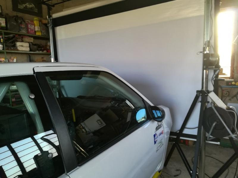

    Hello !
    Some news for this project !
    The car is now in its final place.
    The game will be projected directly on the wall.

    And today i'm finishing the wall with a special projection paint, and also finishing a 7 inch screen dashboard :)
    Pictures are coming soon !!!!
