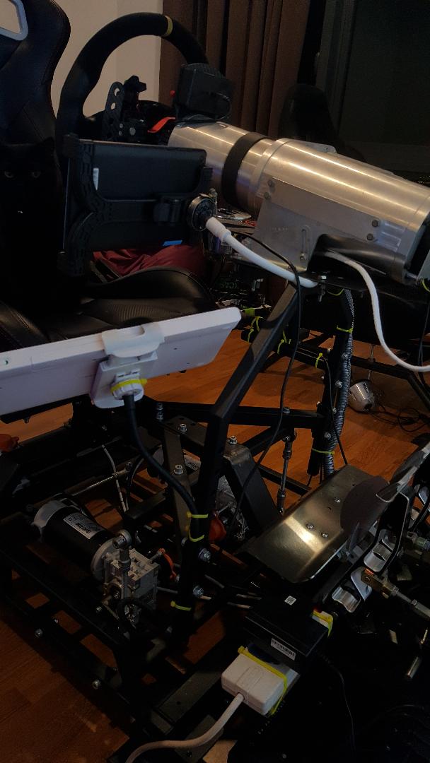

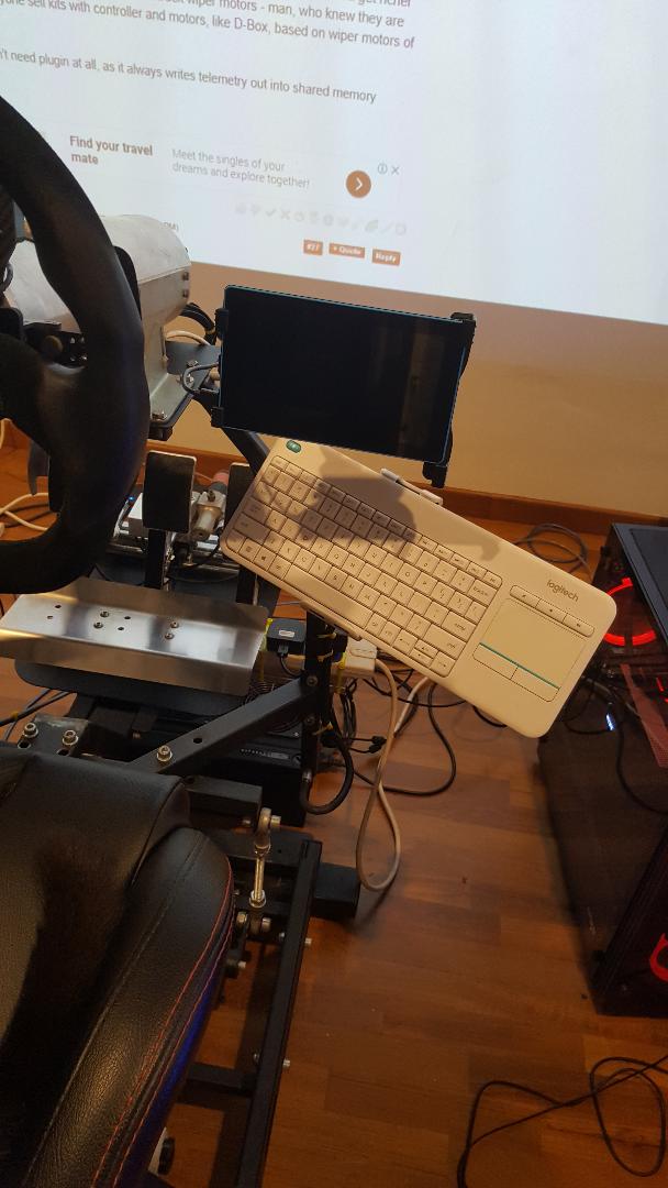

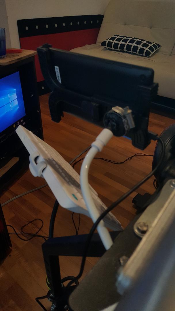

    I use a Logitech wireless keyboard wth trackpad and a smaller digital button box held on flexible tablet mounts.
    See the attached immages
    Keyboard holder is on spring clips so I can just grab the keyboard when I need it. Cant have the things too flexible however because when the rig starts moving, the keyboard and tablet rattle about because they are both mounted to the moving part of the rig.

    Thanks for sharing keyboard mounting pictures. I was thinking of very similar keyboard, just concerned if I will be able to do things without wrist support to keep my hand steady (I am affected by condition that leads to poor motor skills, it helps to have support when doing something precise. That's one of the reasons I am looking for ready solution instead of building my own, as soldering and fine cutting is out of question), but we will see, this all looks very promising.
