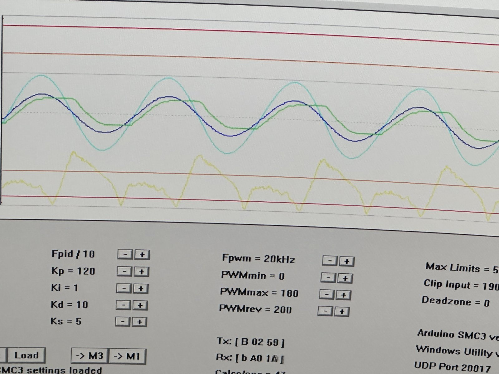

    Hi guys,
    I am building a Motion Simulator with the H3 Platform by DOF-Reality.
    The problem is, that Motor 1 and 2 are stuttering
    https://cdn.discordapp.com/attachments/987095961245450241/1086312401252651070/IMG_4909.mov
    https://cdn.discordapp.com/attachments/987095961245450241/1086312101410246666/IMG_4908.mov
    I tried calibrating the motors multiple times, but that didnt help.
    Does anyone know a solution?
    Cheers

    Can you please post pictures of all of your SMC3 settings.

    Fpid / 10, Kp = 120, Ki = 1, Kd = 10, Ks = 5, PWMmin = 0, PWMmax = 180, PWMrev =200, Max limit = 50, Clip Input = 190, Deadzone = 0 (The default settings)

    Please post a picture of your SMC3 setting running Sine test.
    When following the SMC3 setup instructions at what PWMmax value (Step 9) does the rig start to move: https://www.xsimulator.net/communit...3dof-motor-driver-and-windows-utilities.4957/
    8. Set Kp to about 400
    10. Do the above for each motor

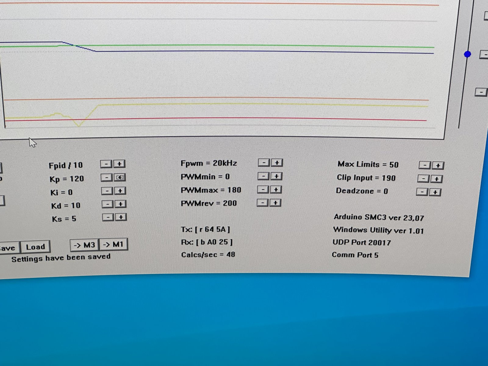

    77A21D3C-582F-4849-A0AB-733DC7C7D049.jpeg 079ACC13-CAAB-45E3-90B9-44AA776B0552.jpeg
    It starts to move at 40.
    I attached are my settings and running sine.

    Try kp at 400, pwmmax and pwmrev at 100 then run Sine.

    Still stuttering.

    Can you please post a picture of SMC# running Sine with those settings.

    Will do in a few days, because the sim is at my local gliding club, and I cant drive there every day unfortunately. If you have anything else that I could try out, please let me know!

    Try kp at 400, that should improve tracking, but I am just guessing, as the whole point of the SMC3 utility and live interface is to allow for tuning settings specifically for your hardware.
