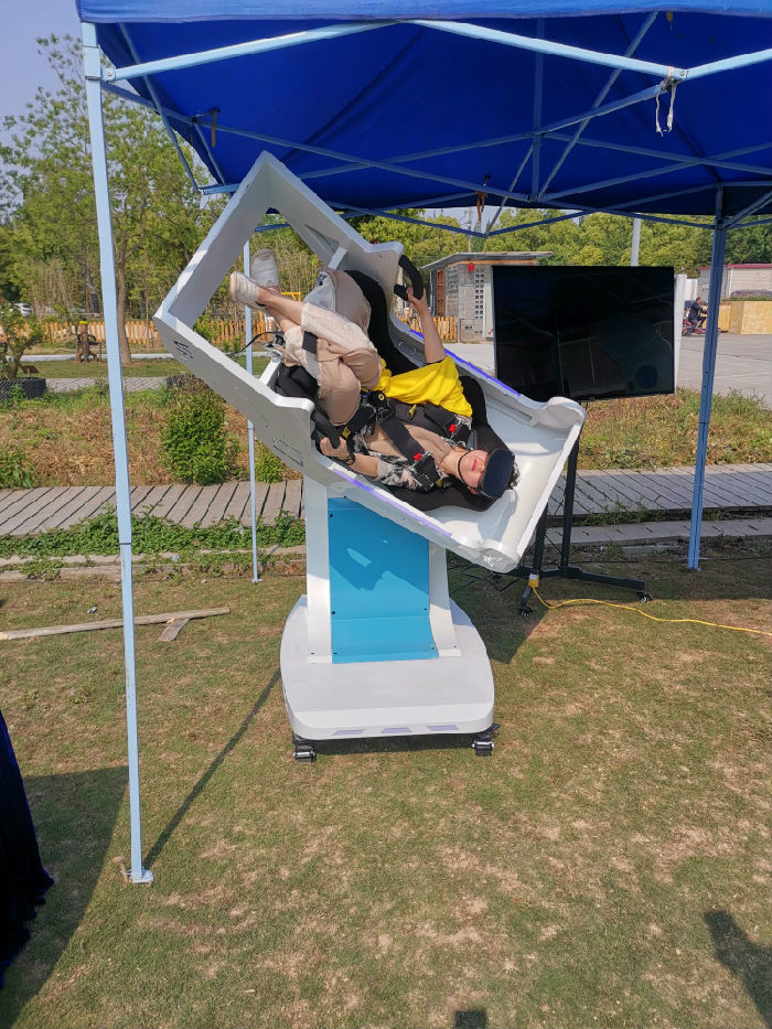

    Hello all, here after example:
    21,921
    153,137Coins
    +11,117 / 56 / -2
    360° simulators are often discussed but only rarely built, because of the complexity/cost Vs the limited benefit compared to other motion simulator options.
    While a 360° simulator can obviously roll and pitch through 360° it can't really generate the associated G-forces, though a robotic arm 360° simulator has more scope than a hamster style 360° simulator. The biggest benefit I can see is sustained inverted flight simulation.

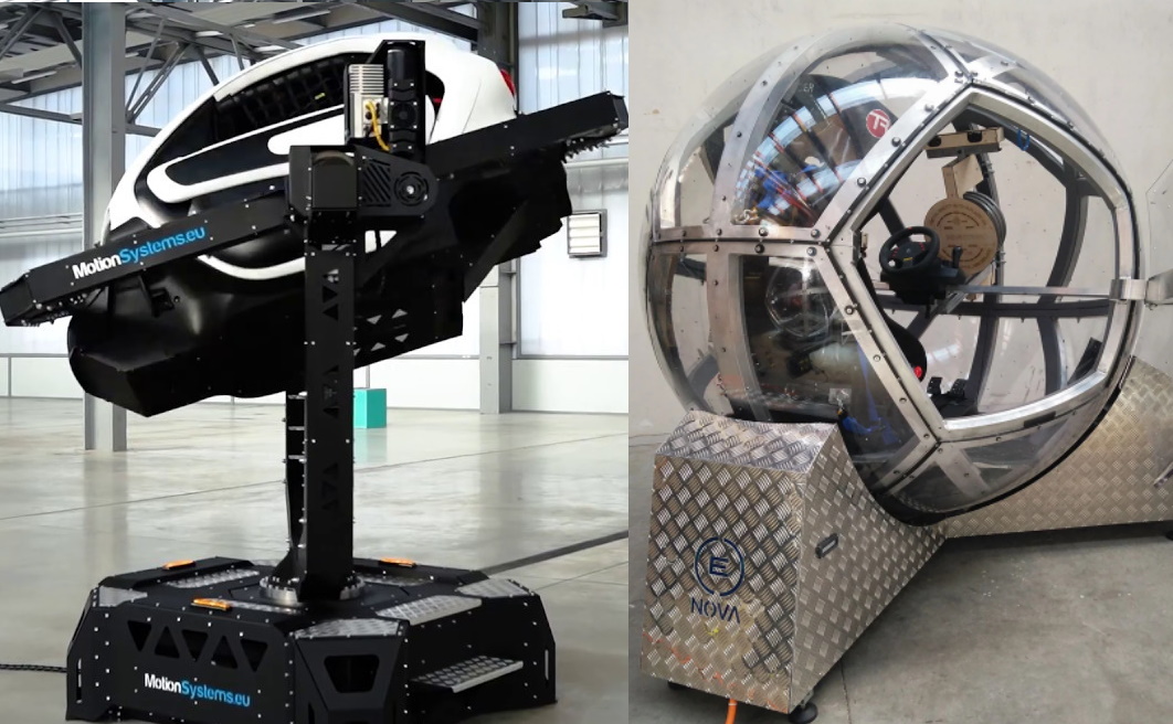

  6. KydDynoMyte
    KydDynoMyte Fool's Gold Contributor
    Sep 5, 2011
    114
    RTP, NC
    40Coins
    +28 / 2 / -0
    That "hamster ball" design is the same thing Yaw VR does except scaled down. There is only half a ball on top so you can only do 360° of yaw. It's a pretty simple design. One of the lowest cost prebuilt ones you can buy. Very smart how it works and makes things way easier than any other motion chair I have seen, just no one is used to doing it that way. Maybe a g-seat could get you some of those missing translation forces in a similar design.
    21,921
    153,137Coins
    +11,117 / 56 / -2
    On the flip side a hamster ball is not very efficient in terms of motion sim design, putting plenty of strain on the motors, nor necessarily precise, and with respect to motion a 360° axis of yaw is only really genuinely realistic when used with a helicopter, and to a lesser extent aircraft, it is not a true traction loss axis with the likes of a car.

    Thanks gzresident&kydynomyte&noorbeast for your advices & examples.
    Where I live (south of France), impossible to find this kind of material (and so more than impossible to second hand one...).
    I think I will probably raise the challenge with a new project I could name "ultimate 6dof 360° pitch&roll". I have some ideas for the compact embedded 4dof part of the motion simulator base on a special quadripode (for relatively low amplitude surge - heave - yaw/traction lost and pseudo sway). I think 4 motors around 200W (ex: continuous 24 or 36Vdc) are enough for this first part. For the 2 last axis, it will not the same ... 2 motors around 1.5kw are I think the minimum (Three-phase motors).
    Full agree with you noorbeast concerning "hamster ball", I see also more drawbacks than advantages (beginning by complexity of manufacturing).

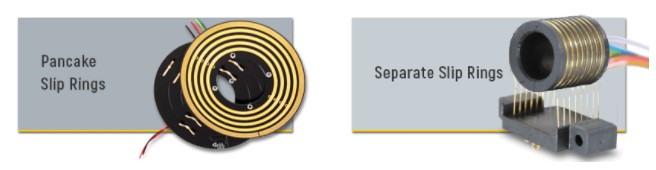

    T
    The only issue I see is the wires twisting when the sim passes one rotation. But like noorbeast said, there is not too much advantage anyways.

    No issue with wires, thanks to slip rigs.

    I’ve never heard of slip rigs. Yes, a 360° pitch/roll axis with a platform below it for the rest of the DOFs would accomplish what you are saying. They have found better ways to do this however with robotic arms that can move anywhere in 3-D space that are a lot simpler to engineer. If you are doing it DIY, though, your only choice would be to use the first method considering how expensive it is to make a full sized robotic arm and the amount of space it would take up.

    by the way, slip rigs:

    Those slip rigs are really cool. I’ve always wondered how it would work getting connections to a rotating object. I think you just need to gauge how much space you have and find out if your tools and materials are up for the job. This would be a pretty big structure that would take a lot of fabrication and welding and I’m not sure if you would be able to do all of that efficiently with the tools you have. If you are able to build the machine, I don’t see any inherent problems with the design you are talking about. Theoretically it will work as you intend. However, all of this is assuming that you are able to build and pay for the machine in the first place.
