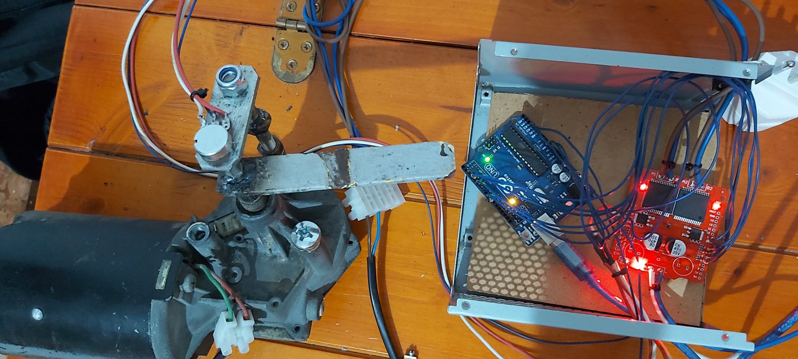

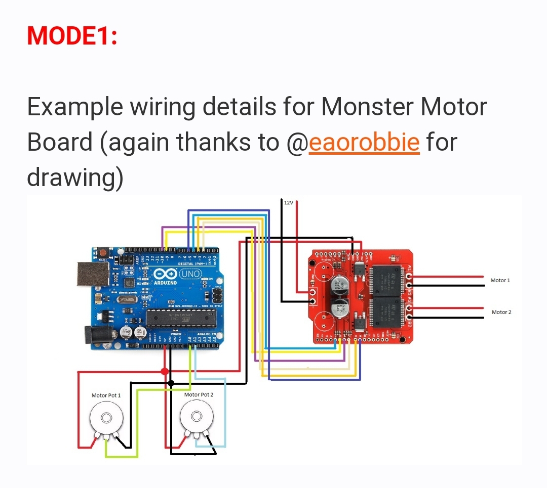

    I followed the scheme for the connection between arduino and motomonster and loaded the arduino code SMC3 now I am trying the utility for setting the engines

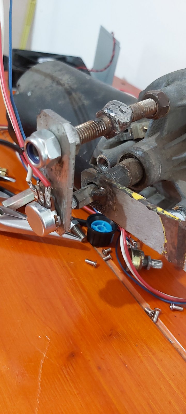

    in the tests that I am doing my difficulty is to connect the potentiometers to the motors as they often move in the tests. do you have any idea?

    I forgot. the potentiometers are 10k, perhaps too sensitive?

    Turn all your K settings to zero except top one. Reduce PWMmin to zero and start again.. motors are always working if they are holding the levers in position..

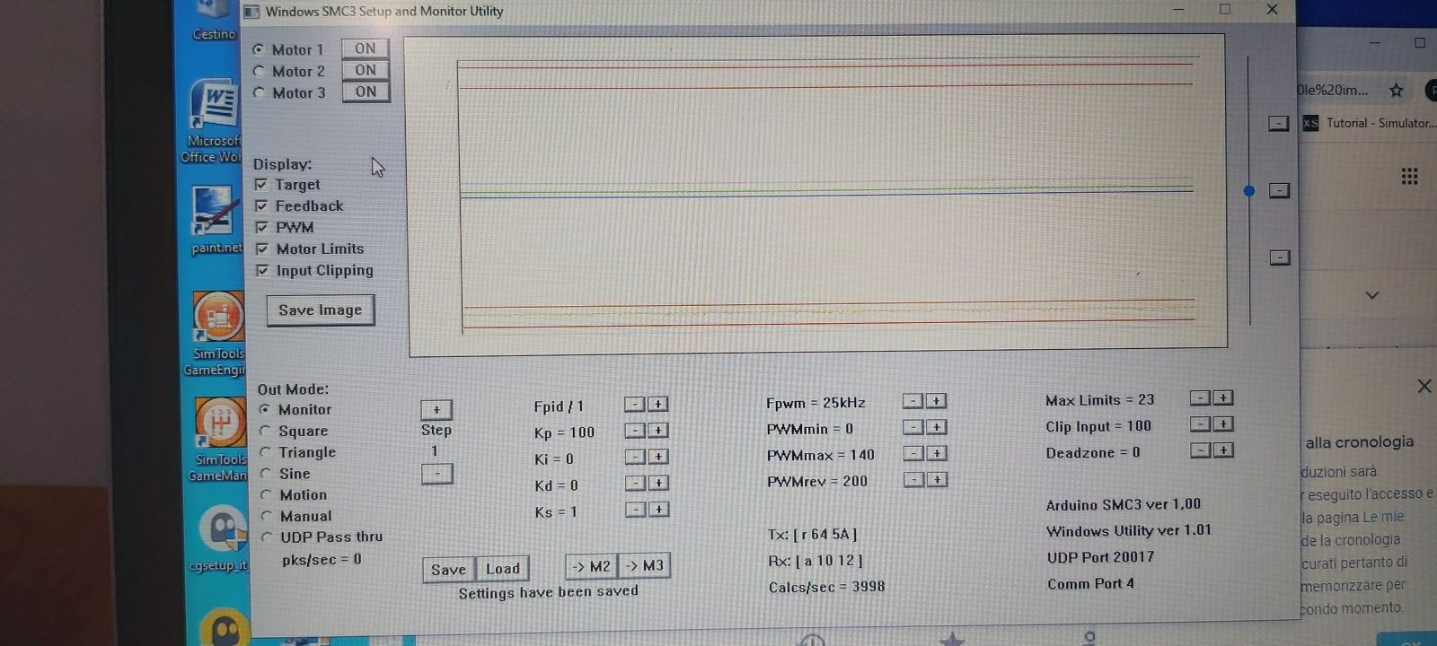

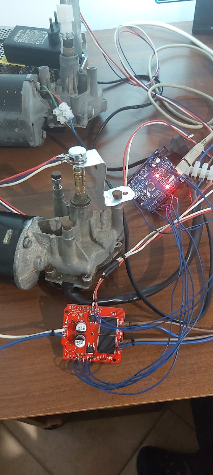

    [QUOTE = "Jrank1, post: 200659, membro: 37341"] Porta tutte le tue impostazioni K a zero tranne quella in alto. Ridurre PWMmin a zero e ricominciare .. i motori funzionano sempre se tengono le leve in posizione .. [/ QUOTE]
    I put all the k settings at 0 as you told me but I can't turn off the motor LEDs. is there no way to enlarge the central dead center of the potentiometer? thank you

    this is a picture of motor and utility

    I ask this because sometimes it doesn't work and I have to open smc3utility first and then I restart everything and then it works

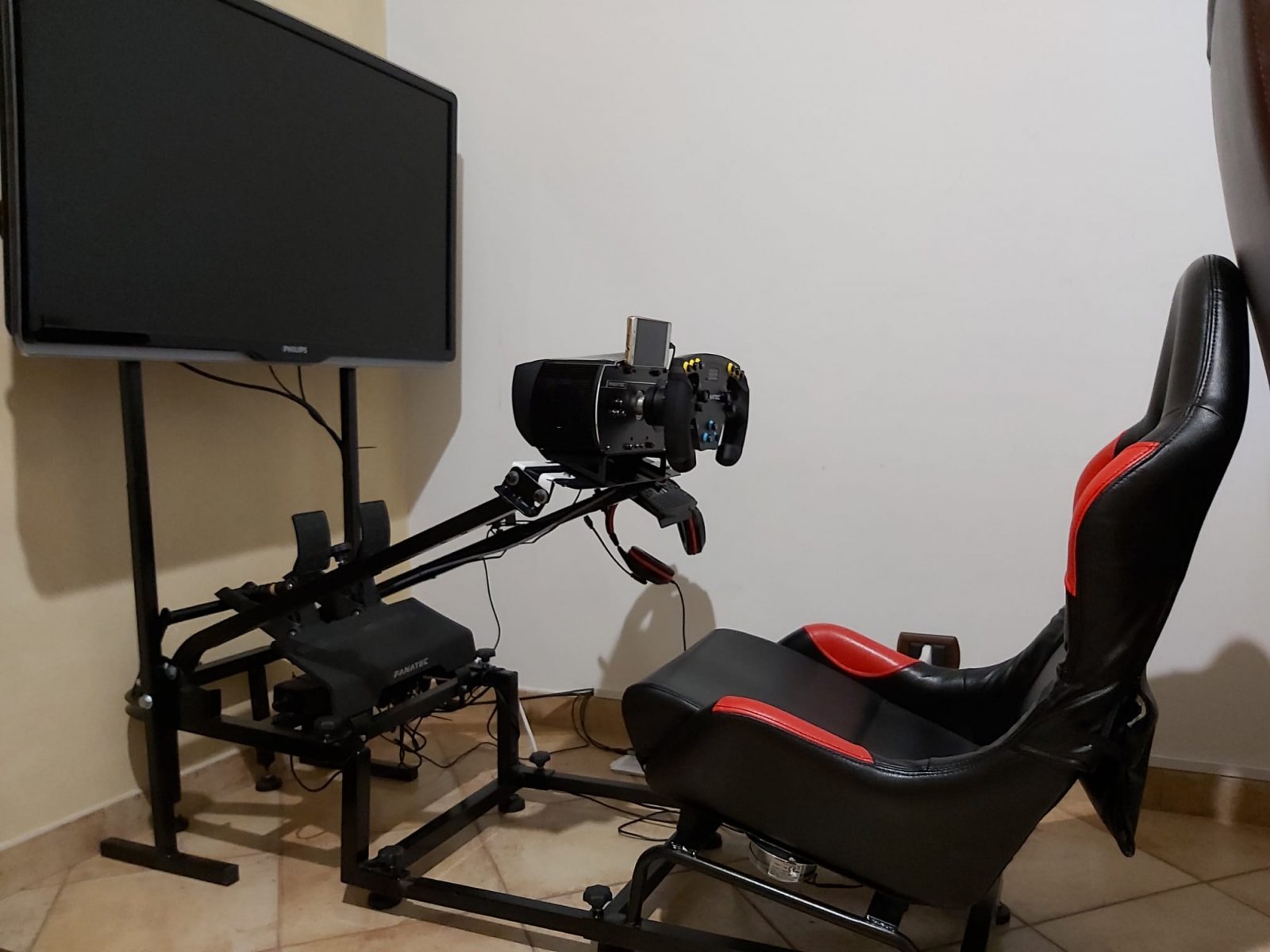

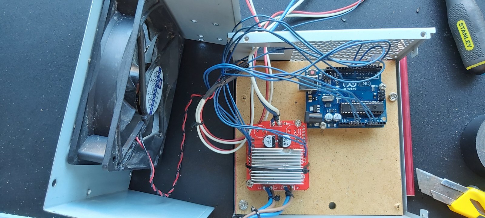

    tihis is my progress.
    thanks to all your advice slowly I'm building my workstation

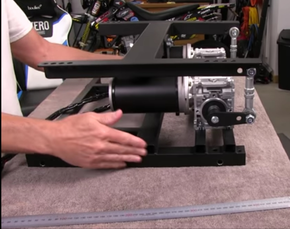

    this is a link with test. for now all right . next step is buiding iron plate to put under the seat.
    I would like to make a platform like this if I can

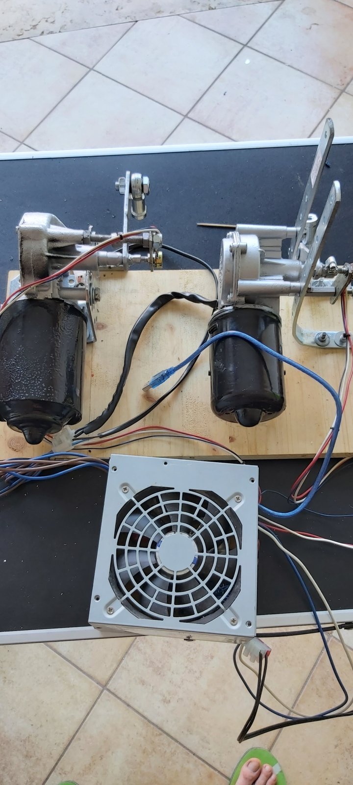

  19. noorbeast
    21,592
    151,215Coins
    It looks like these are not identical motors,is that correct, as the one on the left looks larger than the motor on the right? If so they may well have different speeds and ratios, which would make tuning really difficult.
  20. pfm21
    pfm21 pfm21 build 3dof dinamic
    May 13, 2020
    157
    374Coins
    +34 / 0 / -0
    2DOF, 3DOF, DC motor, Arduino
    yes they are actually different I thought it was possible to change some parameters for the rotation. at this point I have to buy two the same. what do you think of these: https://www.ebay.it/itm/Motor-elett...195446?hash=item420a646df6:g:7JMAAOSwsWddOo7t
