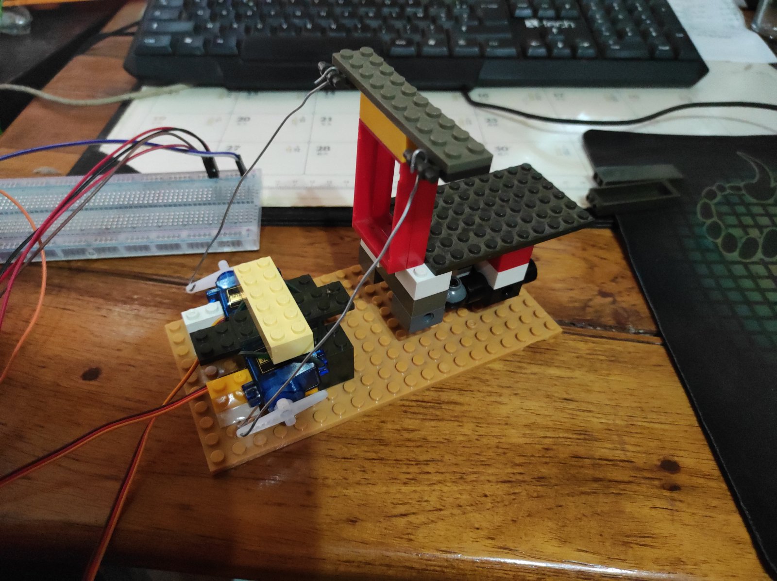

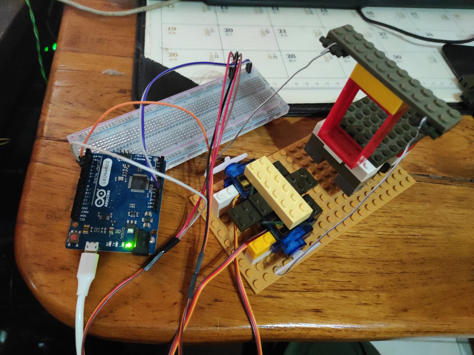

    Hi !
    Before attempting to build a full scale 2DOF seatmover, i wanted to try with the RC version first. I have an Arduino Leonardo Board as well as two small SG90 servomotors. Eventually I will switch to an Arduino Nano or Pro Micro for the big project.

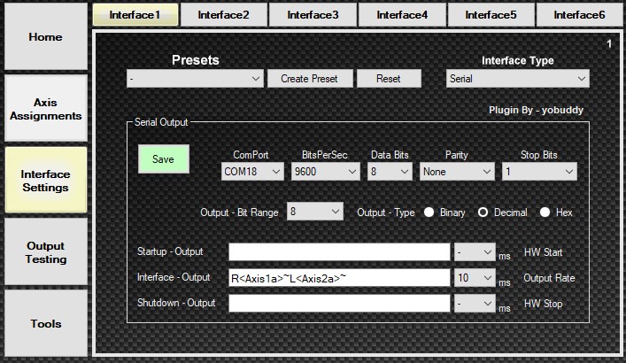

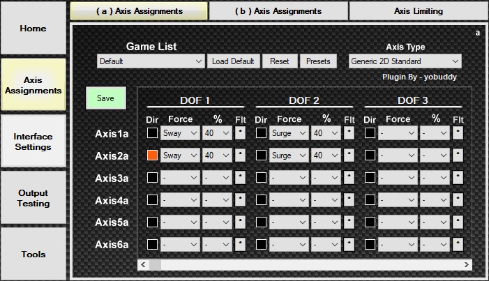

    Simtools connects to LFS and display the virtual axis output but there is no output to the servos
    I then tried with the post's original code and it is now working, well partially, once the servos have to go past around 40% of the axis they start moving erratically to their maximums. I can limit the amount of axis used but if two movement are used, once the sum goes past a certain value it moves erratically again.
    I would like to make full use o the axis instead of having to limit them so if anyone could help me either make the new code work or solve the issue with the old code it would be awesome !
