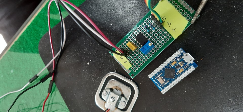

    Good day! Can someone help me with troubleshooting my ina122pa board? Cant seem to get input from the loadcells. Here is my board, could someone please tell if it's correctly built thanks...
    now, i dont have access to a multimeter, but ive tried all configurations of the wires from the load cell. still nothing. this is for the logitech driving force pro. any advice?

    It looks correct to me. I'd suggest you get yourself a cheap multimeter to help troubleshoot.

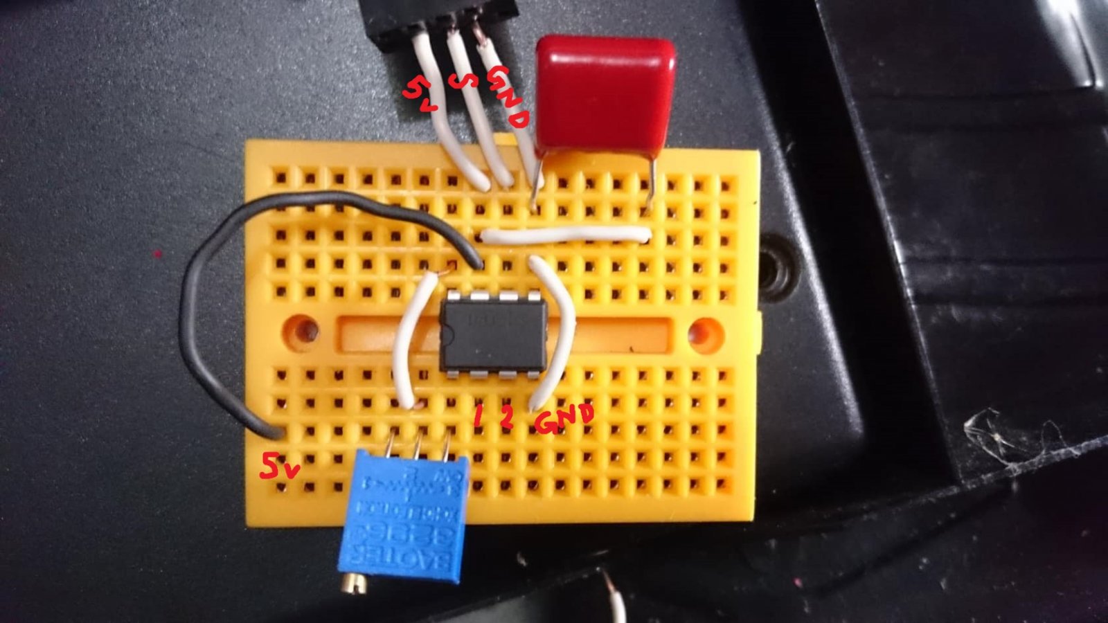

    hi all, i still cant figure out whats wrong with my amp. i did some measuring with a multimeter:
    first the pots on my logitech dfp- when everything is connected each pot shows 3.8v. i measured the throttle pot and it goes 3.8v to 0.5v (0-100%) the brake goes the other way 0.5v to3.8v (0-100%)
    is this why my ina122pa board doesnt work? does it only work with 0v-5v pots?
    other thing is when i replace the pot with the ina122pa board, then i measure the voltages it goes down half 1.9v for each. and the brake is stuck at 100% so im guessing what ever voltage comes in the ina122pa board, same voltage goes out on the output pin??? no response from load cell which i already confirmed the correct pairing of wires. does this have something to do with both pedals sharing same 5v and ground?
    any advice on how i should troubleshoot is greatly appreciated
    btw my components: ina122pa, capacitor cbb22 104j630v, trim pot 3296

    It looks like your circuit is configured to output in the correct direction for the brake if the brake requires low voltage at 0% and high at full brake. I haven't tried the dfp, but with the g27, it calibrates each time you plug the wheel in, you have to push the pedals all the way down for it to set the limits. If the dfp is the same, I'd guess it should be ok with the ina122 output. Assuming you're on pc, you can test this by opening the game controllers window ( search for "Set up USB game controllers" in windows 10), plugging the wheel in and opening the controller properties and don't push any pedals. Then push either pedal slowly until the output shows. If it's self calibrating each time, it should show full output when the pedal gets to about half way if you've only pushed it half way.
    What voltages go down to 1.9V? I'd double check you're connecting the wires correctly to the ina122 circuit. Maybe try just connecting the +ve and -ve, leave the signal disconnected, connect the load cell outputs but not the power to the load cell, then measure signal to ground/-ve and I think it should be zero.
    You could also try measuring the voltage across the load cell outputs with the power and ground connected to load cell. With no load, it should be zero. With the full load if your multimeter is sensitive enough, it should read some small voltage. On mine it was around 8mV.
    I've only got quite limited electronics knowledge myself so it's hard to know what exactly might be wrong. It's possible the chip itself might be faulty.

    Thanks for a quick reply heres a picture of my board
    the voltage on the pedals is 3.8v on the positive and ground, but when i remove the connections from the brake pot, then connect it to my board, voltage goes down 1.9v. I cant figure out why. this happens whether the load cell wires (two 3-wire load cells) are connected to the board or not. if i measure the output signal wire in the middle it shows around the same also 1.9v.
    also i tried connecting the board to a usb 5v power, i get around 4.7v on the output signal wire. also same whether the load cells are connected or not. it seems like whatever voltage comes in the ina122pa, same voltage comes out on the signal pin

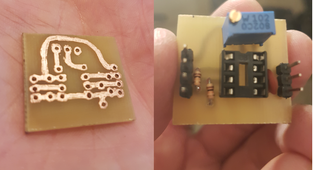

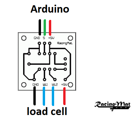

    Hi guys
    I'm completely new to this cicuitry and wiring thing,
    Second time to ever solder anything and now a little lost after building the INA122 amp.
    * How do I wire the thing to the arduino?
    * Which pins on INA122 go where on Arduino?
    Thanks in advance!

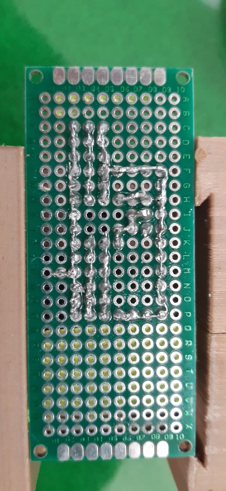

    I'm using this circuit layout which was provided by cteters
    Mine

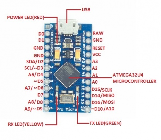

    Here is what I have in front of me:
    Pro Micro reference
  16. RacingMat
    2,233
    21,059Coins
    +2,092 / 21 / -2

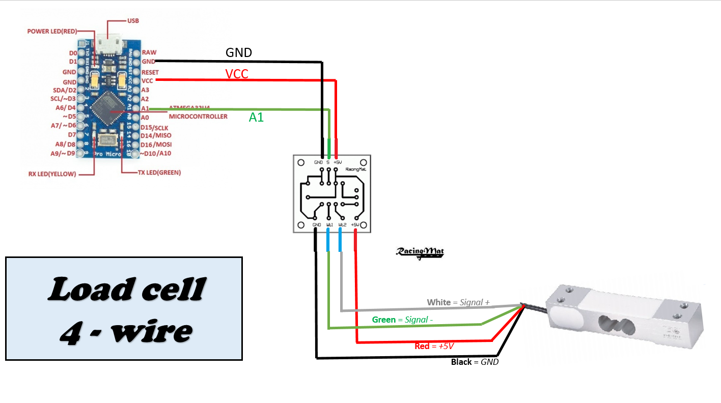

    S is the Signal from the load cell that you need to connect to the arduino pin that will convert the Analog Tension to Digital values (DAC)
    5V is taken from the arduino 5V pin to power the INA
    Ground to Arduino Grond Pin: mandatory
    yours
    Mat

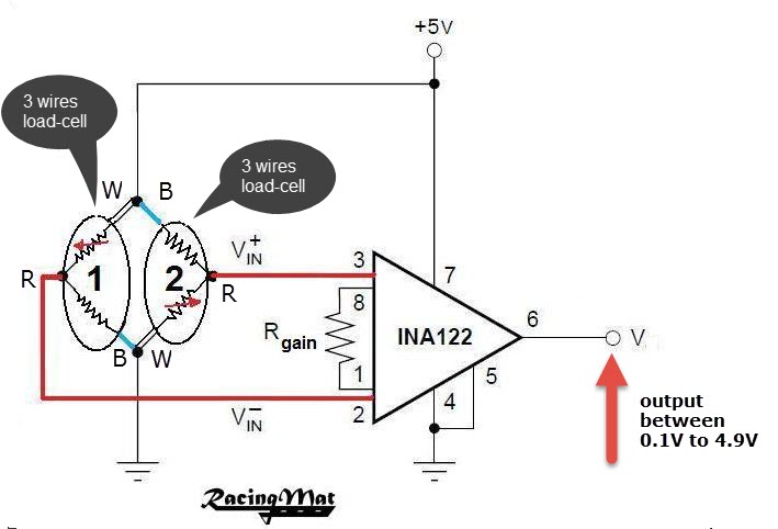

  19. I9k[toro]
    I9k[toro] New Member
    Aug 6, 2020
    6
    engenharia mecanica
    - 23Coins
    3DOF, DC motor, Arduino, SimforceGT
    @RacingMat
    good terde I used the hx711 and it didn't work I intend to use ina122pa according to your post
    * doubt in your post has two 1e2 scheme which one should I use?
    * in the first photo there are two cells to make the wheatstone bridge I have to press both to work or just one of them
    note: my cell load is so three wires
    red + black 1000
    red + white1000
    black + white is not normal?
    imagem 1
