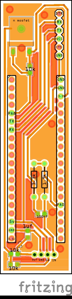

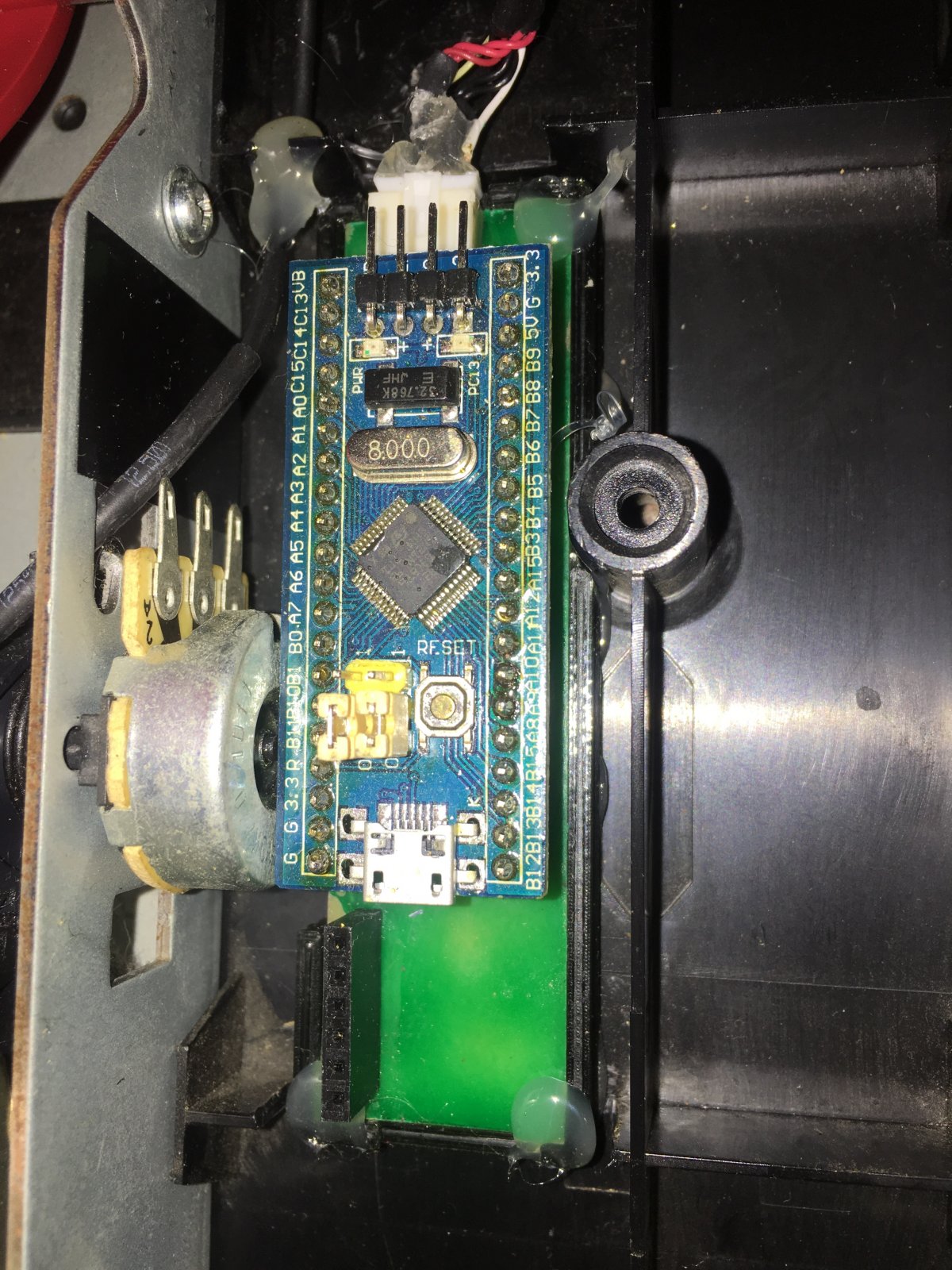

    Hi guys
    just read the previous posts on this load cell problem and thought id offer an opinion. Ive solved this problem for all u guys out there that want to use it and have tested it working on both my pc/laptop. Its probably not the cheapest way to do it or the best way but its the way I did it for my needs.
    I wanted a load cell for my G27 pedals and chose the FC22 25kg loadcell, much the same as supplied with the ricmotech kit and installed it as per there instructions. As many have mentioned the polarity is reversed and wont work at all reversed biased due to internal diodes in the loadcell itself.
    I also wanted 12bit resolution on the brake pedal as most high end pedals use this resolution so what to use
    The ricmotech mod i think uses an op amp in inverting mode to reverse the polarity of the load cell so it will work but I found that being the loadcells voltage is 0-4.5v not 0-5v due to its internal components diodes/ caps etc the effect was the brakes were either left slightly on all the time or wouldn't achieve full brakes. ( one or the other I cant remember now but not ideal). Added to that even if I used a rail to rail op amp I couldn't solve it this way.
    Maybe an Arduino would do the job, well it will but is only 8 bit no good for my needs but were getting there
    I finally settled on the Arduino blue pill STM32F103C8t6. It has a 12 bit ADC as well as a 16 bit DAC, it can be programmed from the Arduino ide, and its a small pcb so it will fit inside the pedal enclosure. the down side is that it is 3.3v but I can deal with that
    So we need to convert load cell signal from 0-4.5v down to 0- 3.3v linear using a voltage divider then input the signal to the Arduino stm32, Write some code to read the signal then invert it and allow for the 0.5v voltage drop on the loadcell and allow for any pre load in the spring of the pedal. Output that signal using pwm and use a logic level converter mosfet to revert the level back up to 0-5v pwm then run that signal through a RC filter to achieve an inverted true analogue signal to use as our output.
    Now I have designed a simple pcb that you can make at home that is single sided and uses 24mil traces so is fairly easy to make if you have some basic pcb making and soldering skills. Ill enclose a picture of it and the etchable pdf to etch it as well as the very simple code for Arduino ide. You could probably make this circuit on a perf board as well if you are not able to etch but I haven't tried.
    Parts needed
    3 x 10k resistors 0805 smd
    1 x 1.9k resistor tht
    1 x 3.3k resistor tht
    1 x 100nf capacitor 0805smd
    1 x 1uf capacitor 0805 smd
    2 x 20 pin 2.54mm female pin header
    1 x 4 pin jst 2mm female header
    1 x 4 pin jst 2mm plug
    4 x 28awg connector pins
    1 x n channel mosfet (d pak case)
    For those that want to build this by other means ill explain how to here in the 3 parts as I cant upload a circuit schematic for some reason buts its a simple circuit
    1 / voltage divider
    Connect loadcell signal wire to a 1.9k resistor then connect the other side to A0 on the blue pill. Then put a 3.3k resistor from A0 on the blue pill to ground. Then put a 100nf capacitor between A0 and ground to smooth the loadcell signal slightly
    2 / logic level converter
    Connect A8 of the blue pill to the source pin of the mosfet then connect a 10k resistor to A8 and the other side to 3.3v
    . Connect the drain pin of the mosfet to a 10k resistor then the other side of the resistor to 5v
    Connect the Gate pin directly to 3.3v
    3 / Rc filter
    Connect the drain pin of the mosfet to a 10k resistor then the other side of the resistor is the output
    Connect a 1uf capacitor between the output and ground
    The output then connects to the white wire on the brake pedal potentiometer
    Connect the red wires on the brake pedal potentiometer and the red loadcell wire to 5v on the blue pill
    Connect the black wires on brake pedal potentiometer and the black load cell wire to ground on the blue pill
    Remove all wires from the brake pedal potentiometer

    you need to tune the max min value of the load cell yourself as all diy setups will be different from mine. Open the serial monitor to get the values and change the values in the code to match then upload . The wheel base should now see it as just another potentiometer so you can plug it into that but will only be 8 bit as that's all the wheel base will allow, I used a Bodnar cable and plugged the pedals directly into the pc via usb and had full 12bit resolution on the brake pedal and 16bit on the acc/clutch. you should be able to use it on ps4 as well but I haven't tested due to not owning one.
    You just need to mount the electronics inside the pedal housing and your finished. I 3d printed a mount and glued it to the pedal base using hot melt glue
    Ive tried to keep everything as simple as I can so anyone can use it but im sure improvements could be made but this worked well for me
