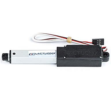

    Sorry for the previous post I could not paste the links of amazon, here I leave the specifications of it
    Specifications
    Peak power point: 175N at 4 mm / s
    Peak efficiency point: 75N to 7 mm / s
    Maximum force (lifted): 200N
    Recoil force: 102N
    Mass: 56 g
    Positional accuracy: 0.3 mm
    Maximum lateral load (extended): 40N
    Feedback potentiometer: 9kΩ ± 30%
    Input voltage: 5-7.4V
    Draft current: 650mA
  15. noorbeast
    22,228
    154,837Coins
    +11,227 / 57 / -2
    These are way too slow for motion simulation, as you want speeds of 150+mm/s: https://www.xsimulator.net/community/faq/speed-needed-for-good-motion.218/
