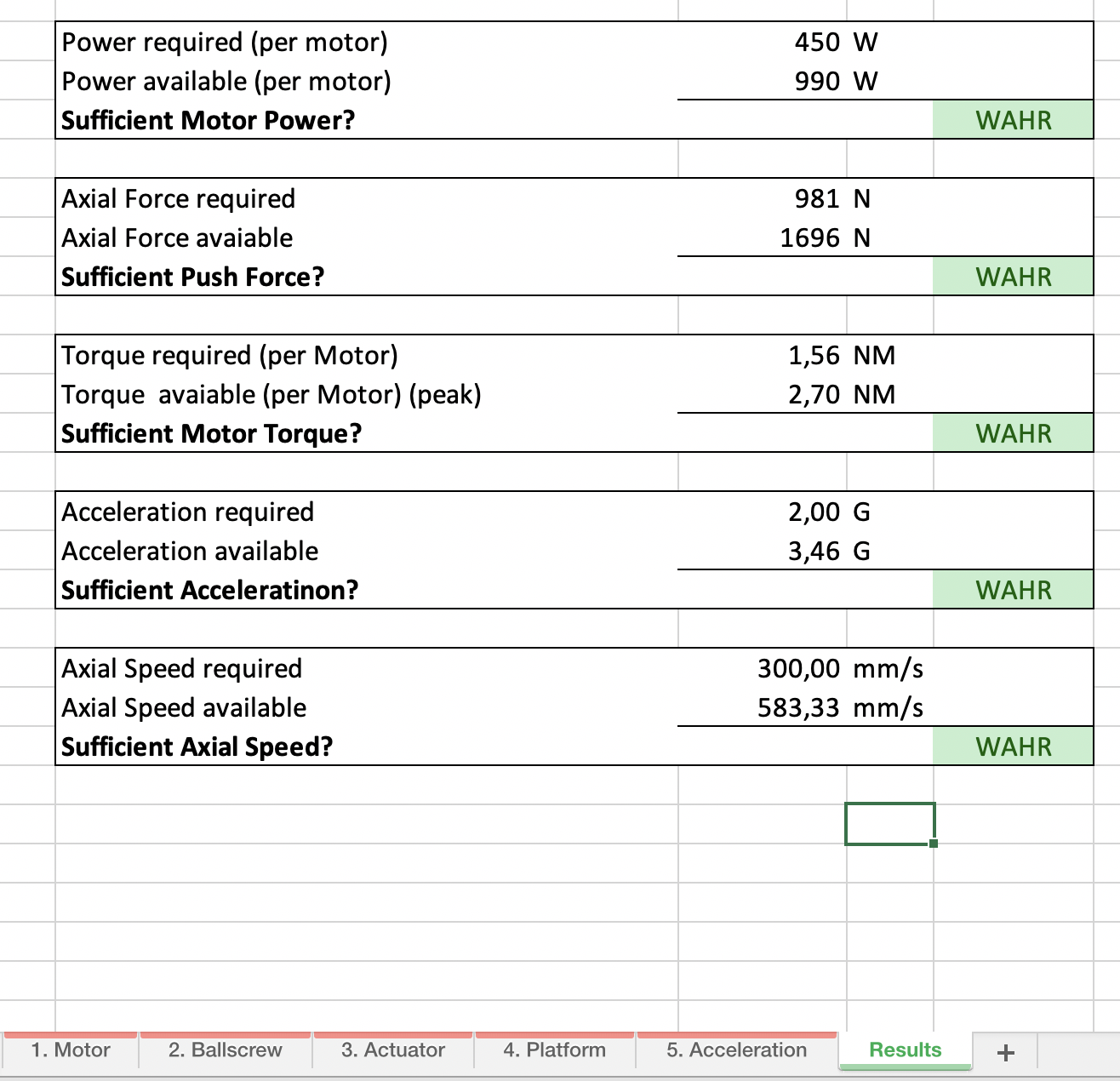

    Hi
    I am thinking of build a 6DOF motion platform mostly to use with racing sim. I'am going to take much inspiration from Hoddems's liner actuator and of coursers from other to. I'am thinking of to going for sfu2005 600mm ball screw and place the motor on the side using a teeth belt. I belie by doing this I can keep the height down and moderate the speed with the teeth belt pulley to get the right speed. I believe most people use 1605 ball screw but using 2005 i may get some more margins and stability. Is this unnecessary? They cost almost twice as much but compare to the total cost it might be worth it?
  10. Dirty
    Oct 15, 2017
    745
    All the way up front.
    7,947Coins
    +880 / 3 / -0

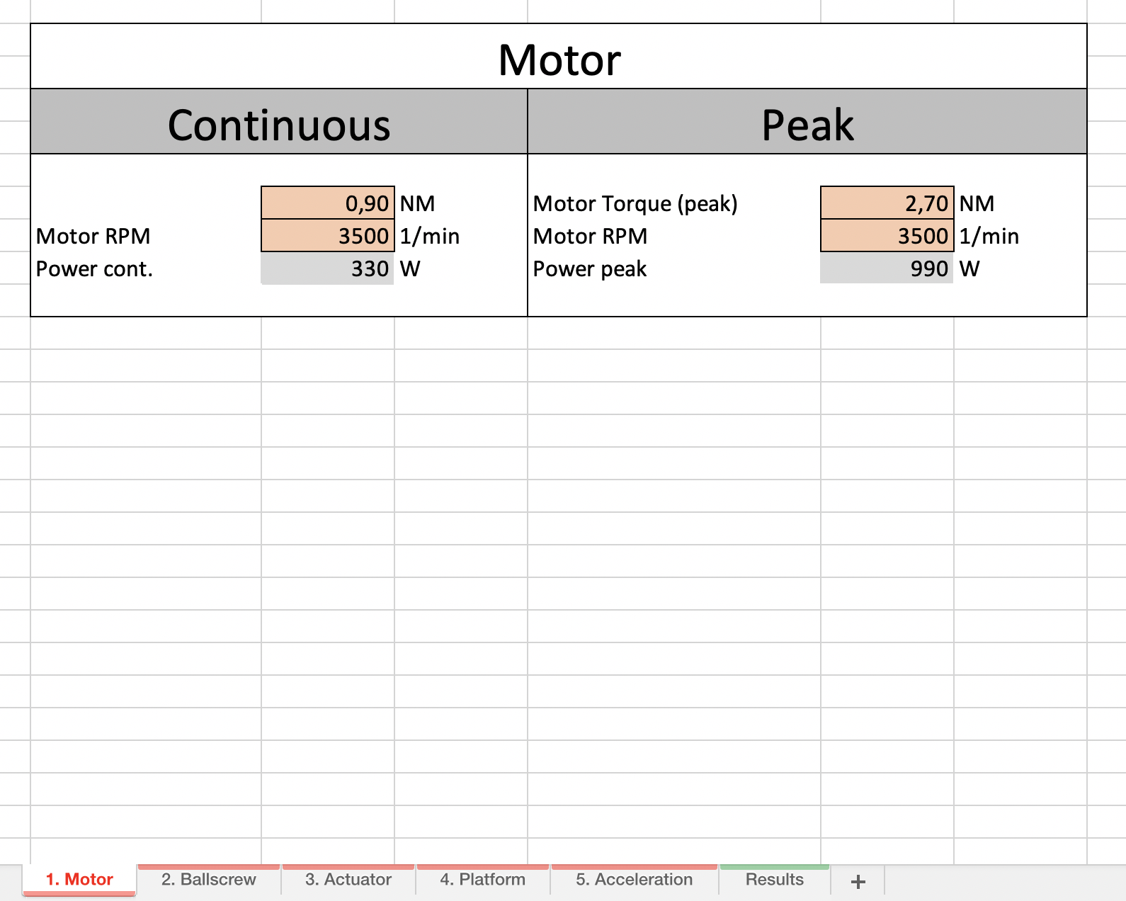

    That looks like a pretty sensible design to me :)

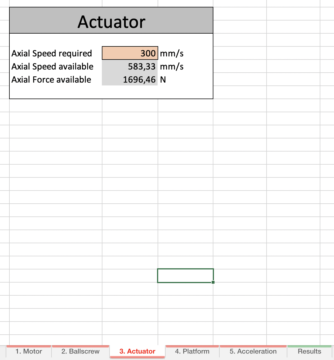

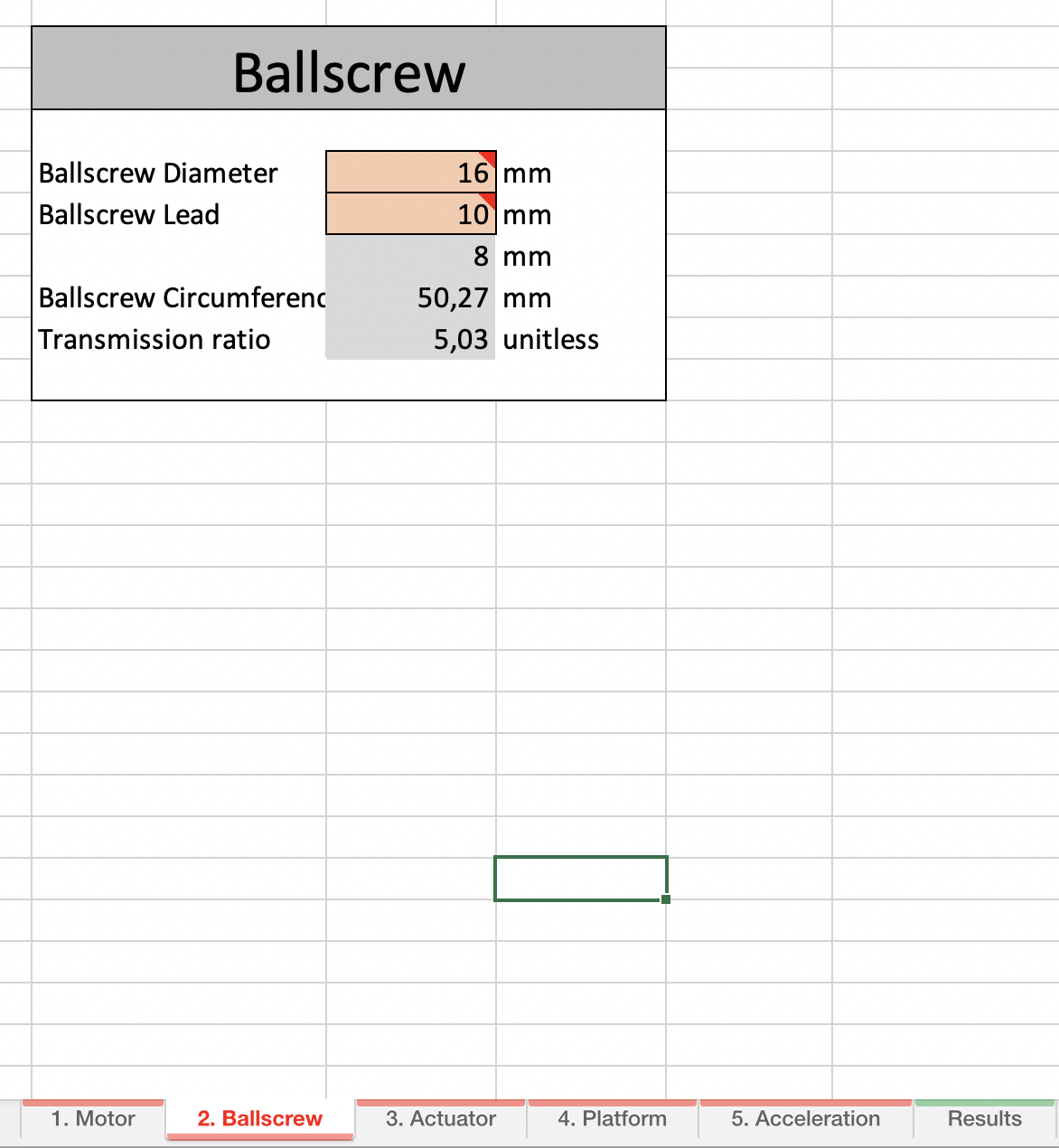

    Your motor will have a torque of 2,7Nm
    Your ballscrew will give you a transmission ratio of ~5 ( 5N of axial force for every N of tangential force applied at the 8mm radius)
    Your actuator will reach an axial Speed of 580mm/s and almost 1700N of axial force.

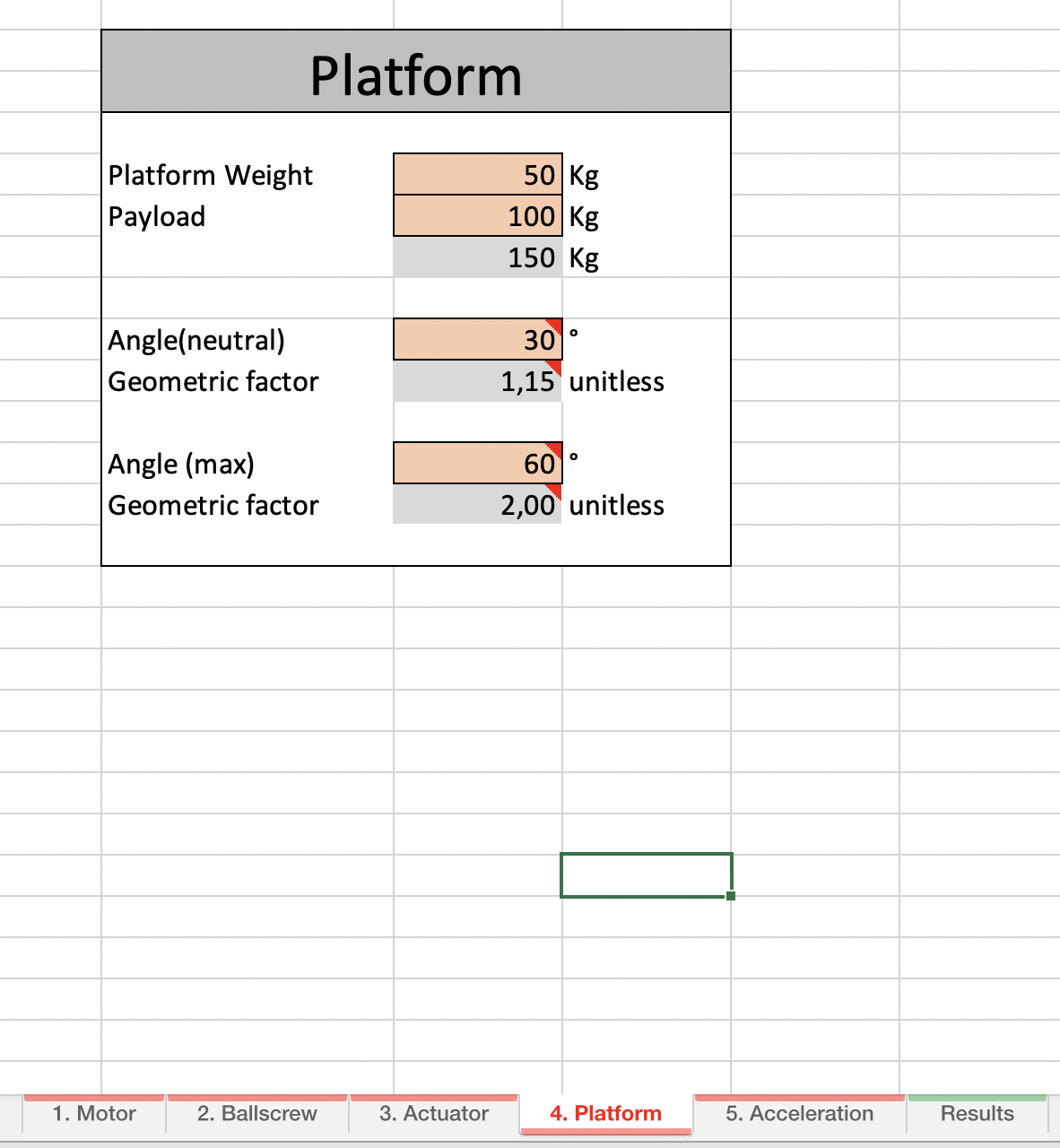

    Your platform...
    (I estimated the weight and geometry!)

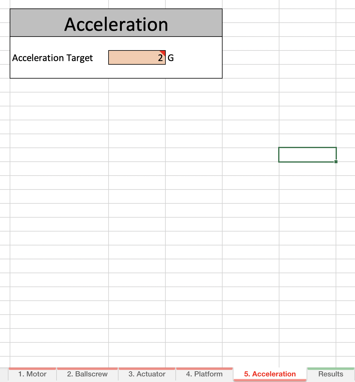

    ...shall be able to accelerate at 2G.
    ...which it does! Easily!!!
    I wouldn't know why not to use those ballscrews & motors.
    Dirty :D
    btw. "WAHR" means "TRUE" in German :)

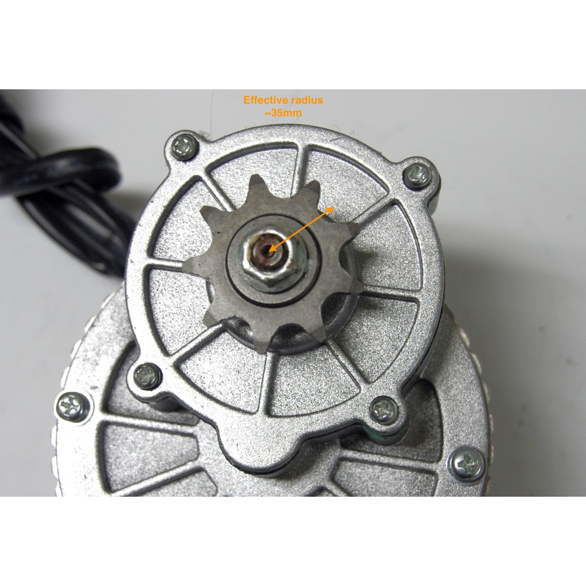

    the chain drive question was looking at using a motor like this to drive a chain up and down
    https://www.motiondynamics.com.au/united-450w-24v-dc-brushed-gear-motor-440-rpm.html
  13. Dirty
    Oct 15, 2017
    745
    7,947Coins
    +880 / 3 / -0
    Ahhh,... you mean something like Roland van Roy's design?
    The specs of your motor say: 8Nm on the output sprocket @440 RPM.
    To get force:
    1. Measure the radius (not diameter!) of the sprocket (where the chain joints are). I use millimeters.
    2. Then divide 1000 by that radius.
    3. Multiply the torque (8Nm) with the quotient from 2 to get the pull force on the chain :)
    To get speed:
    2. Multiply that by 2π (~6.28) to get the effective circumference of the sprocket in mm.
    3. Multiply that by 440 (RPM) to get the speed in mm/minute.
    4. Divide that by 60 to get the speed in mm/second.
    @30mm you can expect...
    ~266N of pull force
    ~1382mm/s speed
    I'd say that's way too fast, and not enough force. At least for a linear actuator used on a Stewart platform.

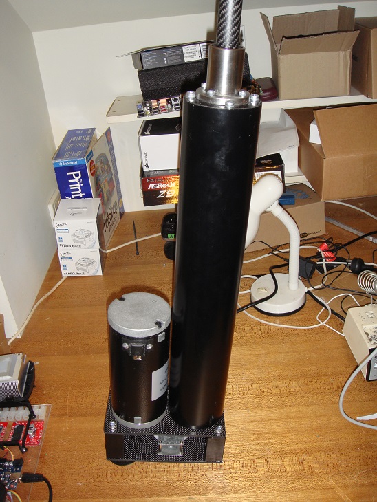

  17. SeatTime
    2,573
    There are a few reason not to do it as well :). I did of course try a belt drive in my actuators design/test phase many years ago.
  18. Gadget999
    1,959
    11,983Coins
    +484 / 10 / -0
    did you find the belts slips ?
  19. SeatTime
    2,573
    I used a toothed belt and wheel, so no slip. It worked, but more noise and unwanted side loads on the motor and ballscrew shaft, as there ends up being allot of force on those belts. The direct drive just worked better for my single support bearing ballscrew actuator setup.
    • Informative Informative x 3
