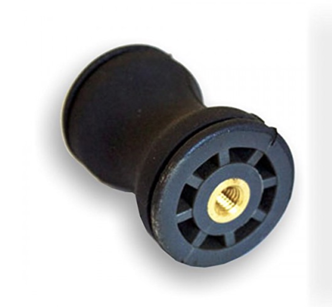

    A question about the universal joints on the bottom: Do you use high quality ones with bearings that run slack-free, or cheaper ones that have a little slack in them. Do you feel any jolt?
    Dirty :D
  2. SeatTime
    2,572
    +2,854 / 40 / -0
    Mine cost around $20 each (is that cheap ?). There is a small amount of slack at the joint, but this does not relate to anything that you can feel/hear when in use.
  3. Dirty
    Oct 15, 2017
    746
    All the way up front.
    7,981Coins
    +890 / 3 / -0
    That's good to hear :thumbs
    Simple U-joints w/o bearings will be my plan B then. Plan A (so far) is using these M10 windsurfing powerjoints:
    About 15€ each, absolutely slack free, meant to take quite a lot of abuse, bend well over 90° in all directions, some dampening and quite forgiving of minor inaccuracies.
    I know, it's a bit of an unorthodox choice. But I'll see how they perform... and can still switch later on.
    Dirty :D

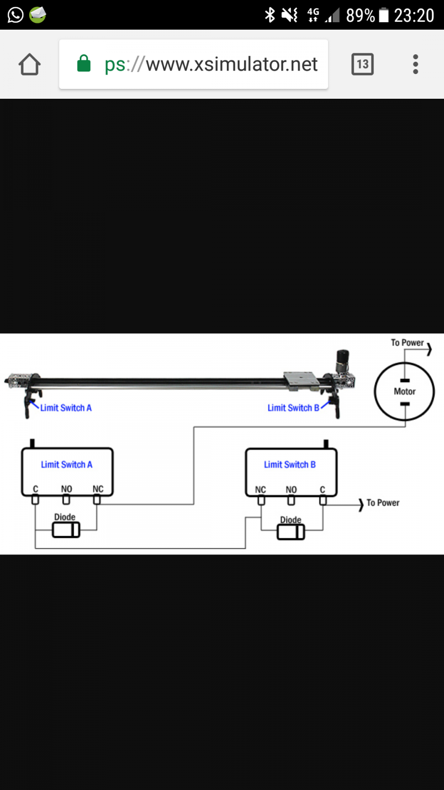

    I found this scheme in the forum okay?

  17. SeatTime
    2,572
    +2,854 / 40 / -0
    No, due to the large currents we are normally running - unless those diodes and limit switches are designed to cope.

    Where should I connect the microswitches? is there a picture of the links in the forum?
