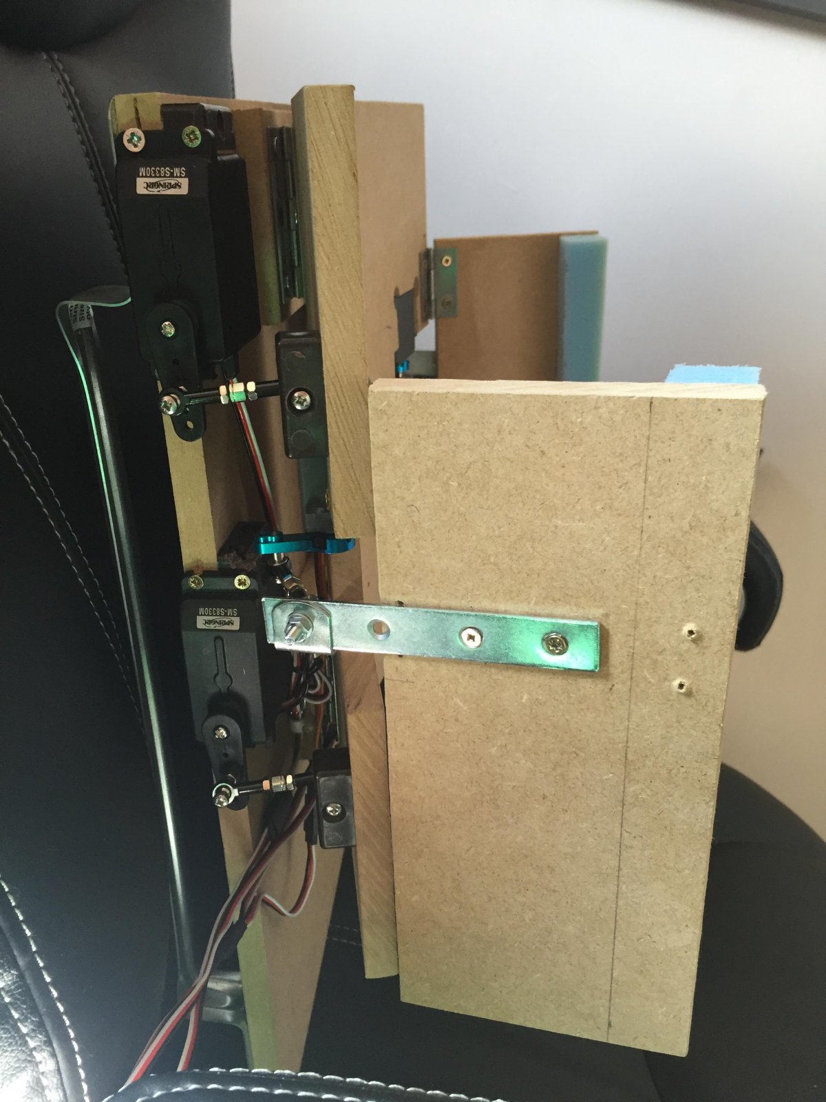

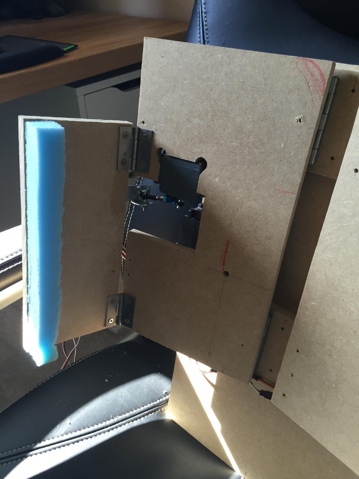

    Finally found the time to build the base and complete this thing!
    Firstly, finalised the back. Moved the side panels out a little to give some extra room (was quite snug) and added foam at the contact point:

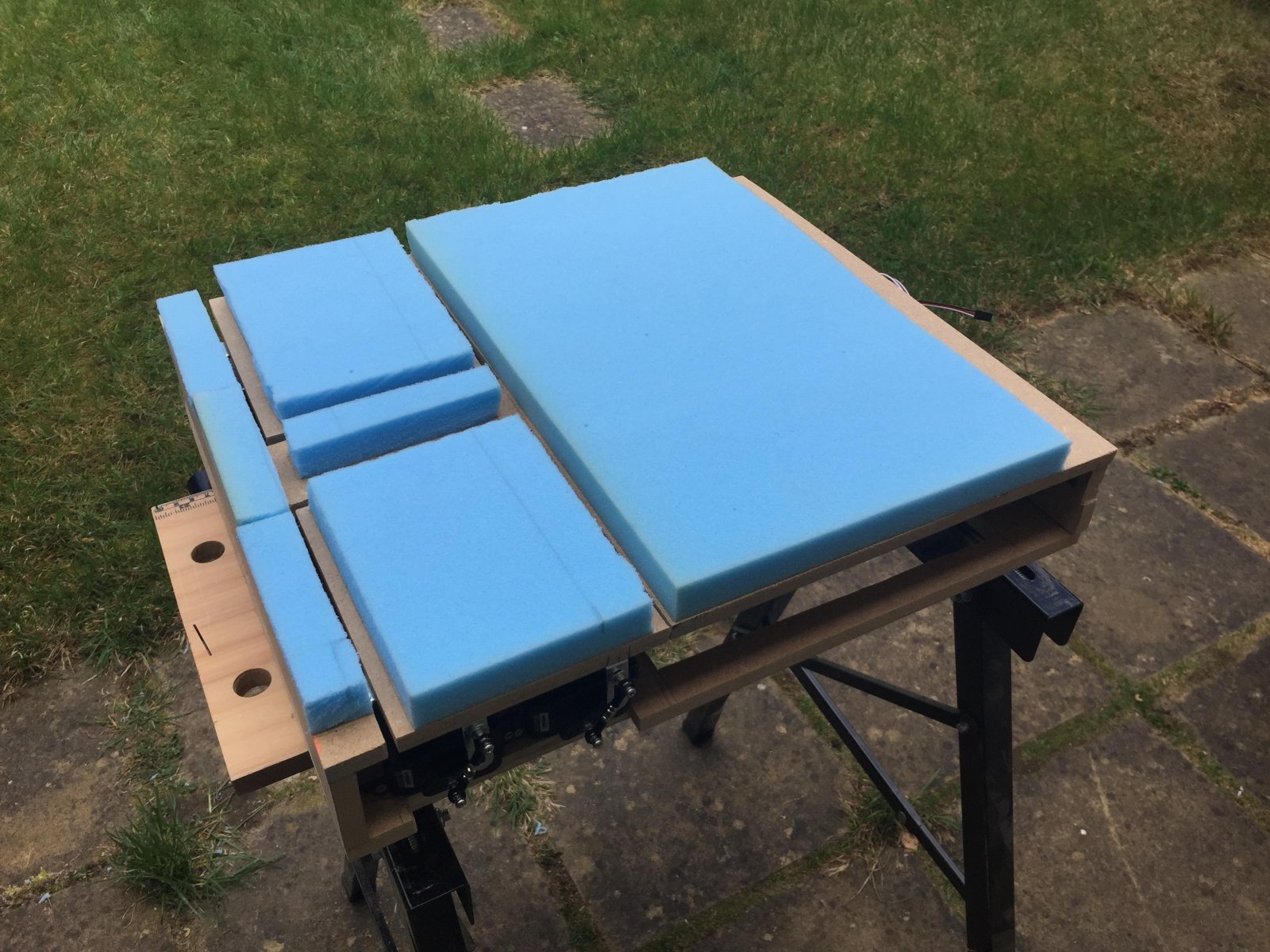

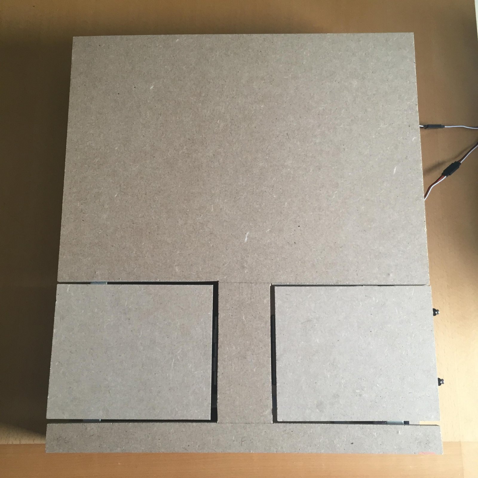

    Then onto the base. Only wanted to use 2 servos each side so I have positioned the paddles under the thighs only. This massively reduces the force on them as most of your weight goes down through your backside:

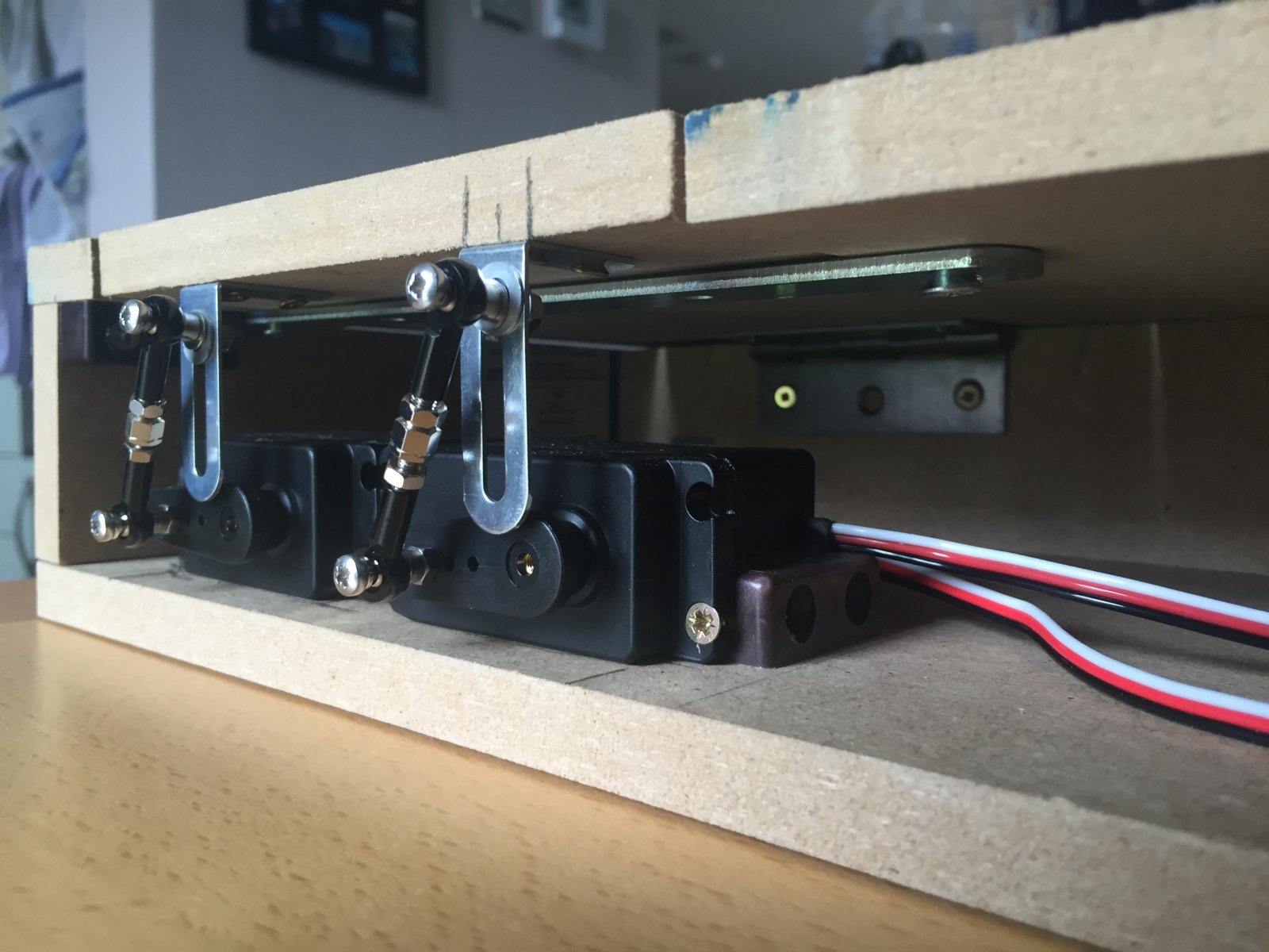

    I also braced under the paddles to stop them going past the horizontal plane. Again, takes unnecessary force off the servos. Note the slotted angle bracket required in order to achieve this:
    Added some 1" foam to make it nice and comfy:

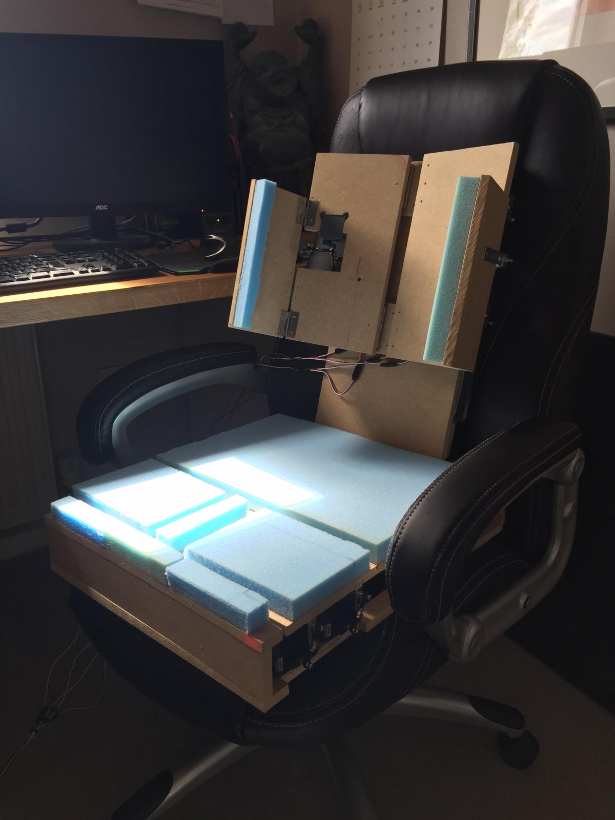

    The finished setup:
    Video of it in action:
    Might smarten it up a little, but apart from that I'll be leaving it there for now as I'm very happy with the way it feels.

    Nice work, @early_m. I like the idea with the slotted angles for connecting the servo motors. It not only eliminates the non-desired half of their movement, but it also decouples them from each other.
