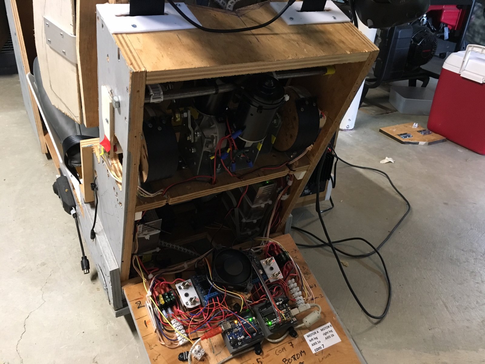

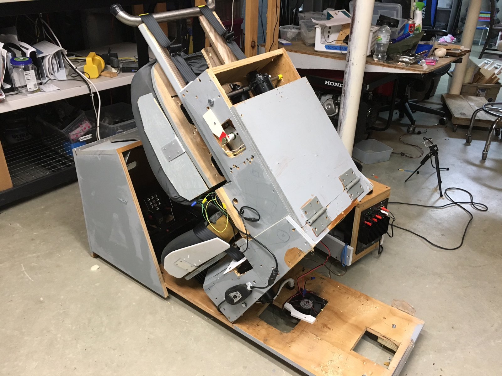

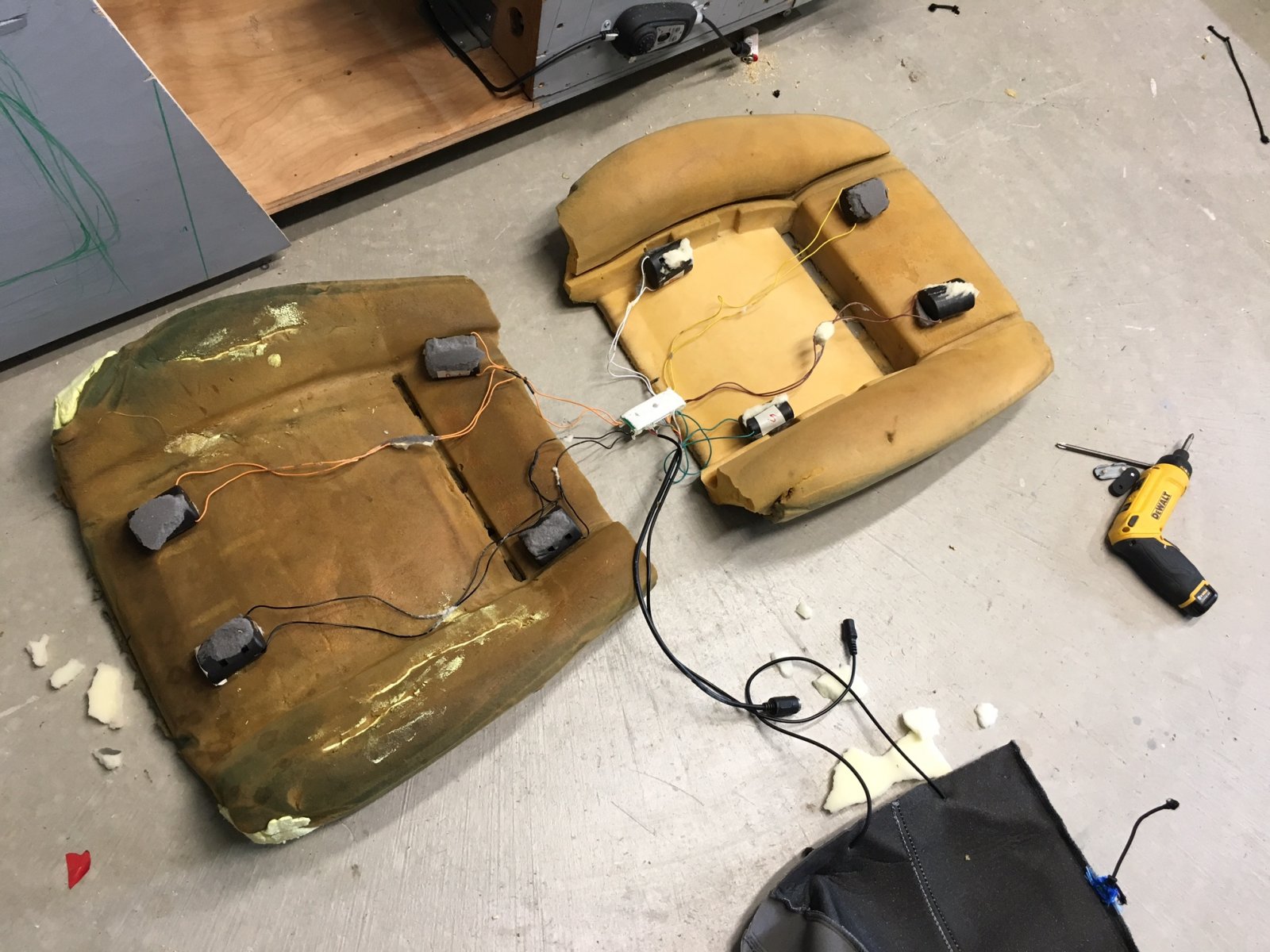

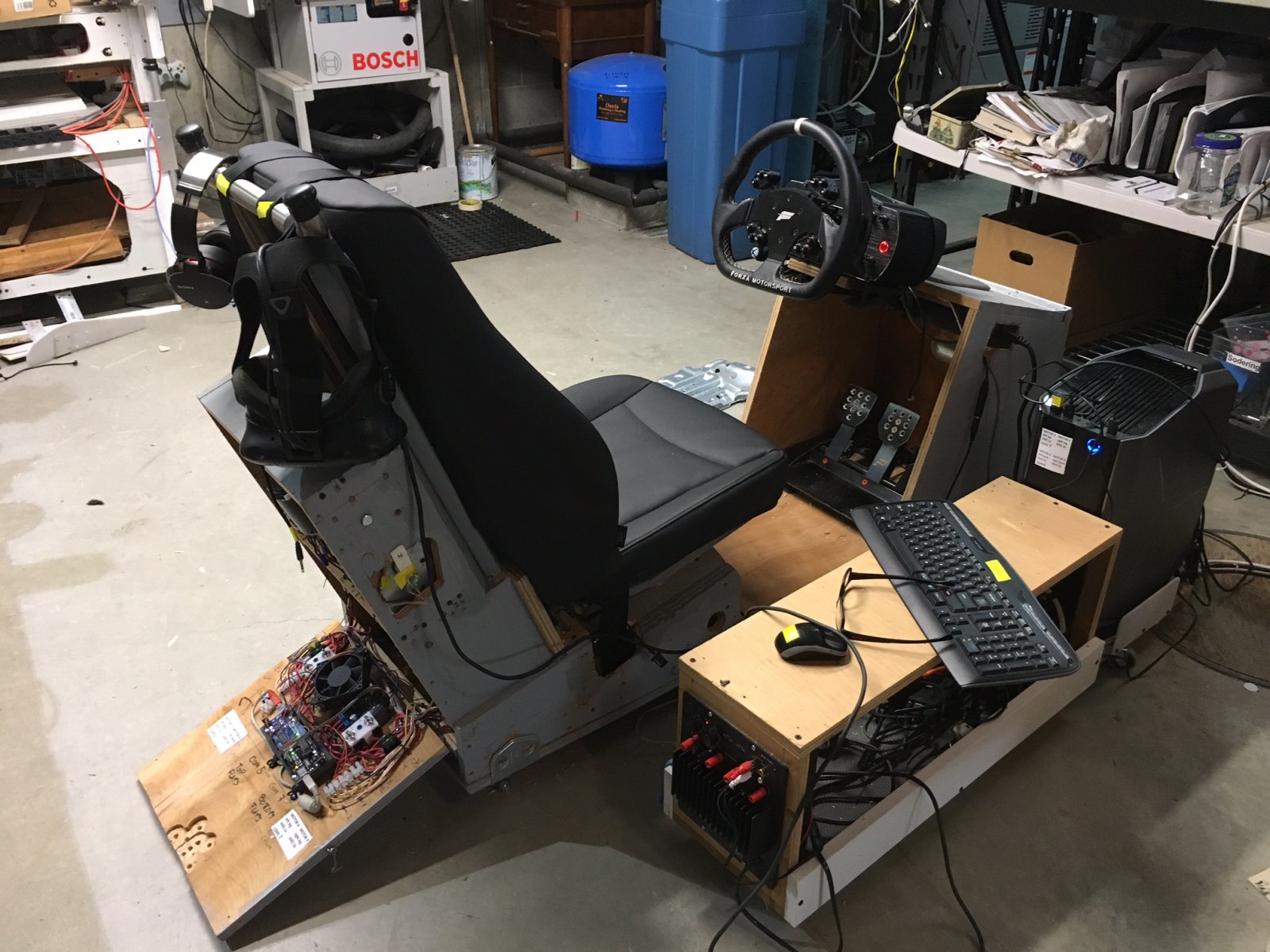

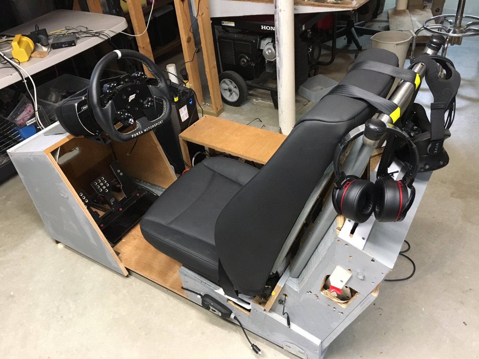

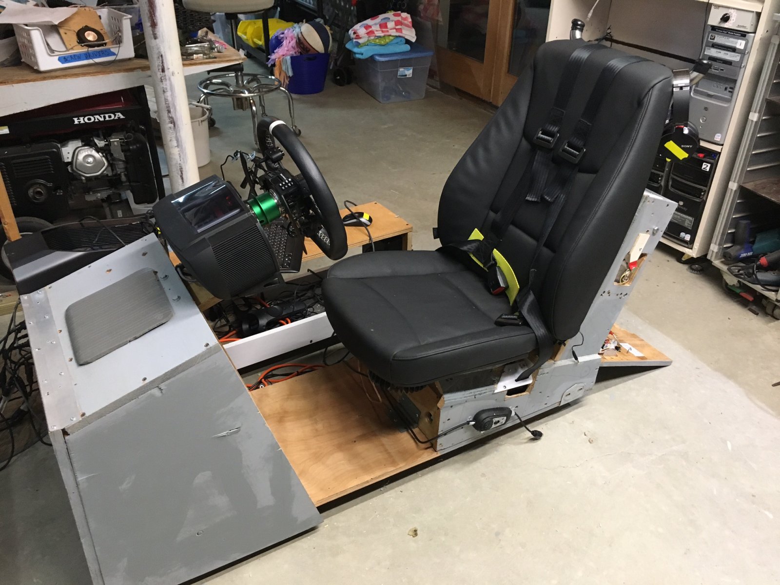

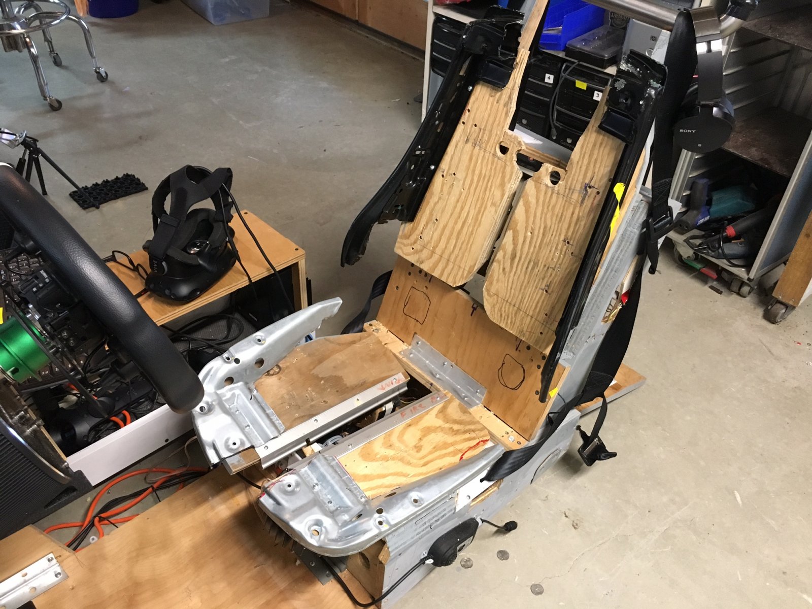

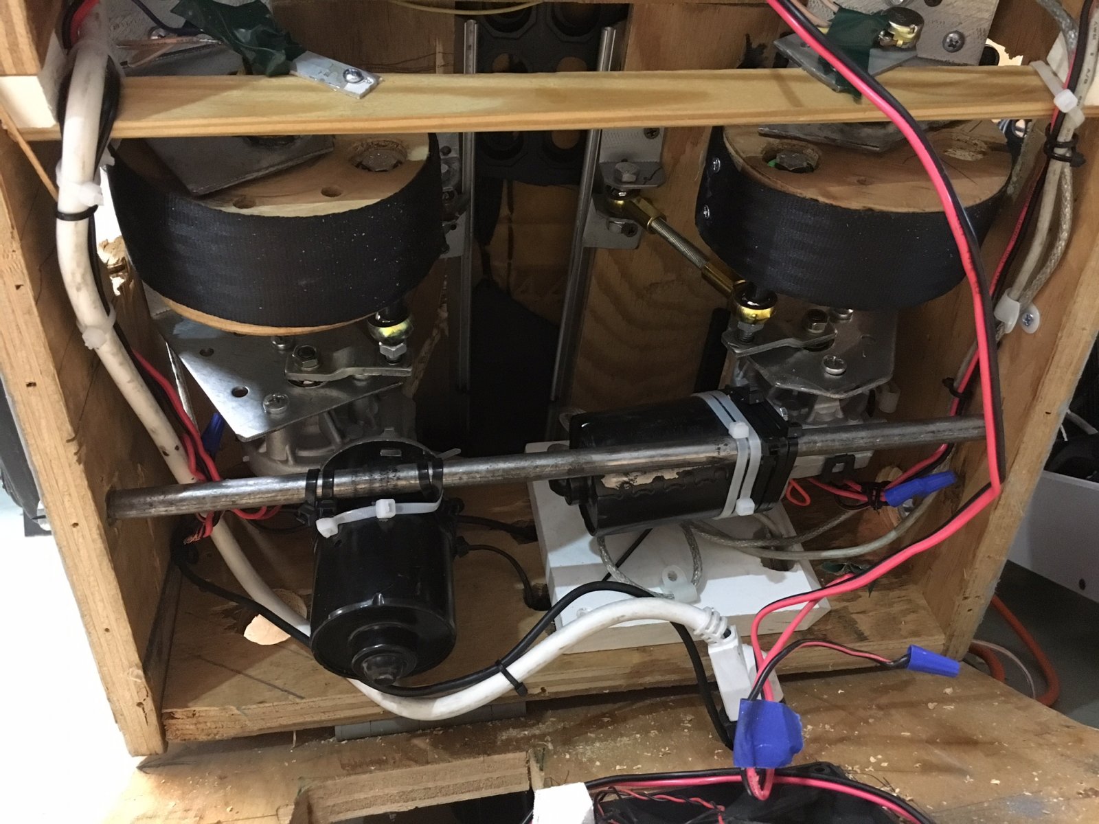

    Based on Begison's G-seat design & the GS-4.
    4 wiper motors
    2 arduinos,
    8 forcefeedback vibration motors
    2 Bass shakers
    Plywood- bmw seat from junkyard
    Simtools SMC3 serial
    Fanatec wheel
    Thrustmaster warthog
    HTC Vive
    Alienware R6

    WOW!!! Excelent So, those small motors are the ones from the Gametrix jeat seat right? I am gonna try it myself. The G seat is owesome!

    The level of integration is great, looks like you were able to keep the comfort and shape of the seat intact and also get lots of heave. Really nice job, roughly how much travel do you have in the plates?
  5. SimPotato
    SimPotato Member
    May 17, 2017
    47
    Designer
    Gardiner, NY USA
    479Coins
    +53 / 0 / -0
    Limongi, 4" to 5" of heave. The seatbelt pulls as the flaps push, so there is body doesn't jump allover the seat. In other words, what you feel is more than what you can see.

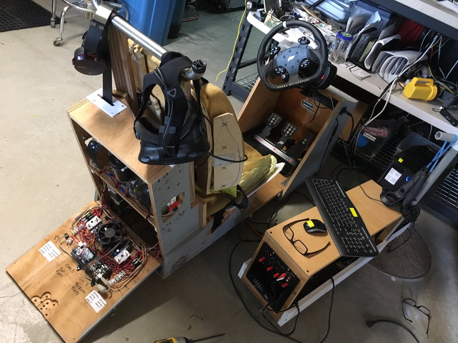

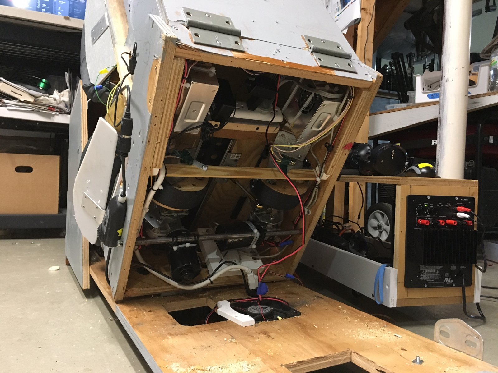

    Here Is an update of the seat:
    Can anybody point me to where I can find how to control stepper motors with simmtools?
    I've seen is a video of a direct drive wheel but what I want is to control a linear actuator 8" travel, sort of a DIY SCN5.

    Very nice work! Very clever idea with the extra heave, and the tilt access to the base motors. (They are always a pain to get to!)

    wanted to give you guys an update..
    Here is a little progress on my build...
