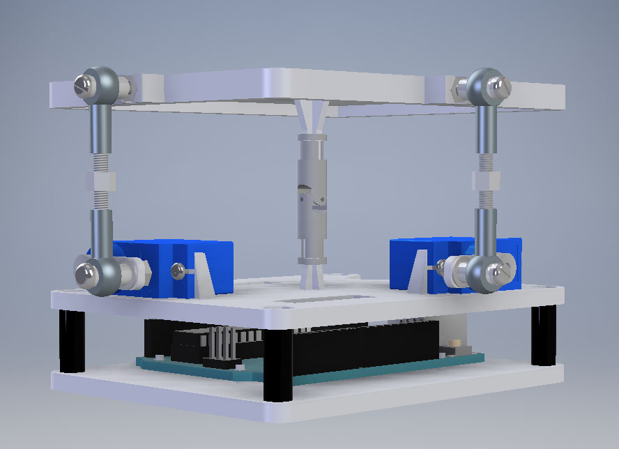

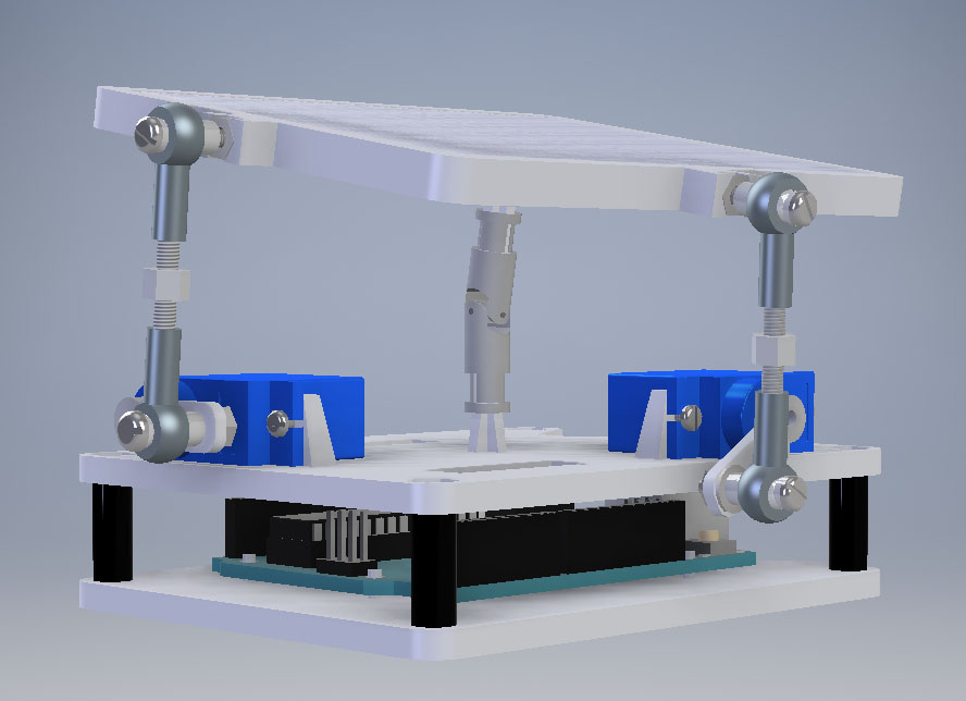

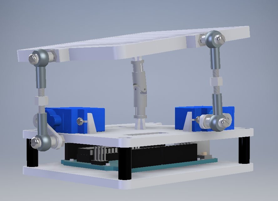

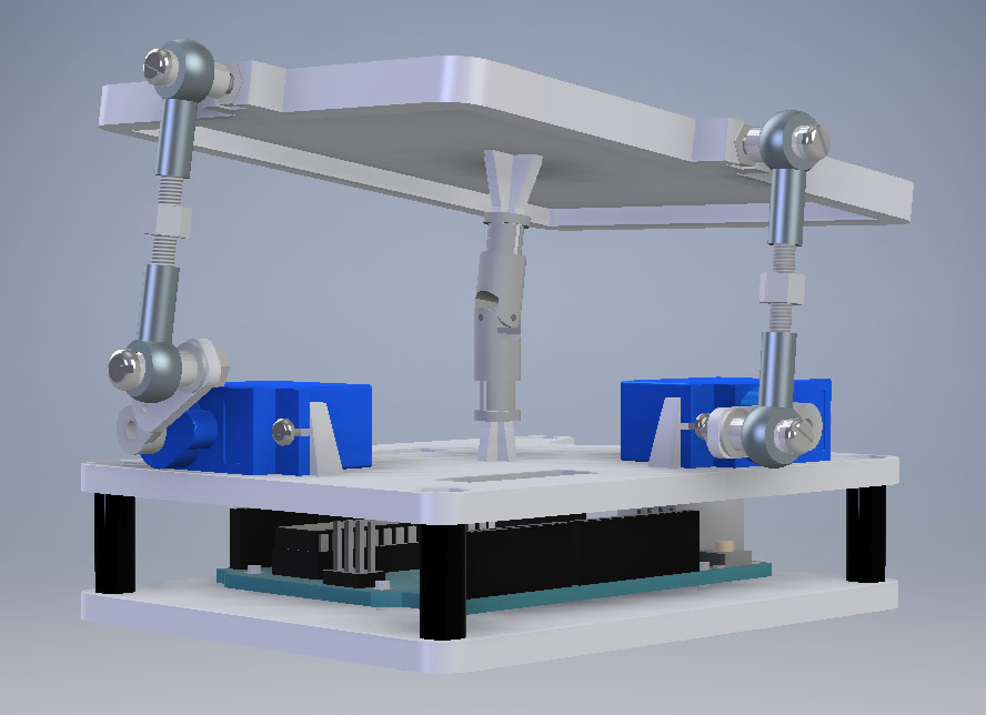

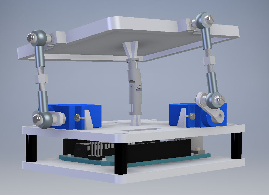

    I've been playing with the idea of making a motion simulator ever since I played Project Cars on the Oculus Rift for the first time. The issue is I don't currently have the space to house one, not even a desk racer.
    So for now, I thought I'd make a mini one to learn the basics. 2DOF using some servos and an Arduino. I thought about keeping it simple, maybe build it out of Lego. Or simple MDF for mounting plates and platform. But in the end I wanted a proper little design project, so created a 3D model so I could get the parts 3D printed (Brother in-law works for Shapeways - free prints!)
    I've chosen the configuration shown in the video as it would appear that you achieve a better degree of movement of 'roll'. I notice many designs have the motors attached to the front corners, so the roll is achieved with some front pitch. Is there a disadvantage to my design by doing it the way I have when I scale up?
    I'm sure I'll require some assistance along the way. I've already found the forum incredibly helpful. Especially the posts from @eaorobbie.
    While I wait for my 3D prints to arrive I would like to hook my servos up to the Arduino and try out simtools. Learn out how to configure it using my design and get it working with PCars. Just need a pesky licence... 2DOF_0004_Flat.jpg 2DOF_0003_Pitch Forward.jpg 2DOF_0002_Pitch Backward.jpg 2DOF_0001_Roll Right.jpg 2DOF_0000_Roll Left.jpg

    With your design, only the power of one motor is available to push/pull the platform for pitch and one for roll.
    If you add the motors to the "shoulders", you have the power of both motors to push forward (pitch) or roll sidewards (one pushing, one pulling).
    For your small scale modle, this is irrelevant I assume.

  13. noorbeast
    20,557
    145,160Coins
    +10,780 / 52 / -2
    Two motors at the front or rear would be a more efficient full size design.

  16. value1
    Jan 9, 2011
    2,184
    Zug, Switzerland
    14,509Coins
    +3,319 / 11 / -1
    Even for roll and sway, both motors are engaged.
    Look at your fourth and fifth picture in post #1. To come from picture 4 to horizontal position one motor would push your body against gravity and the other motor would pull against gravity until you reach horizontal position. From there to picture 5 both motors have to break so that you stay in position 5 and don't fall too quickly or deeper.
