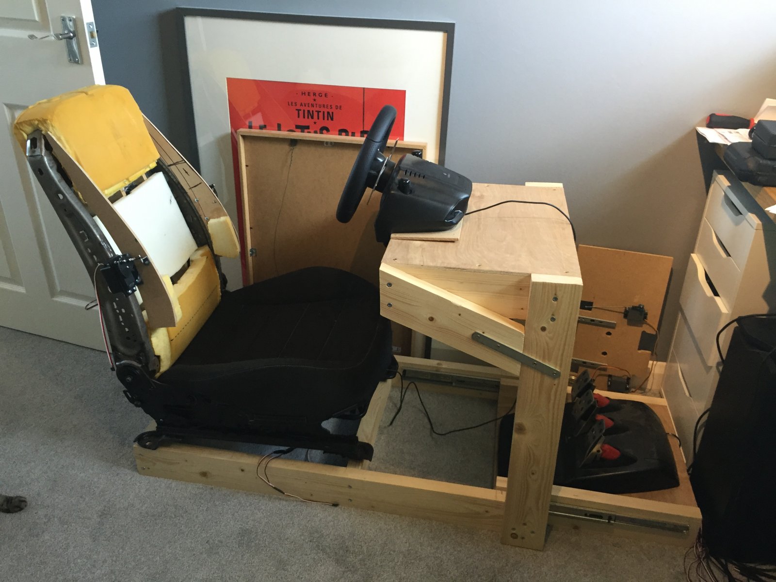

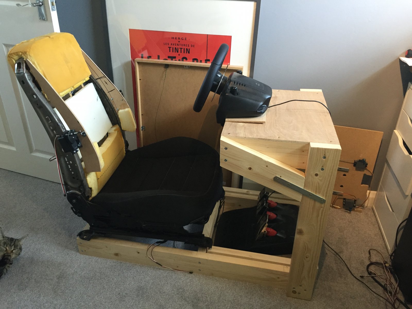

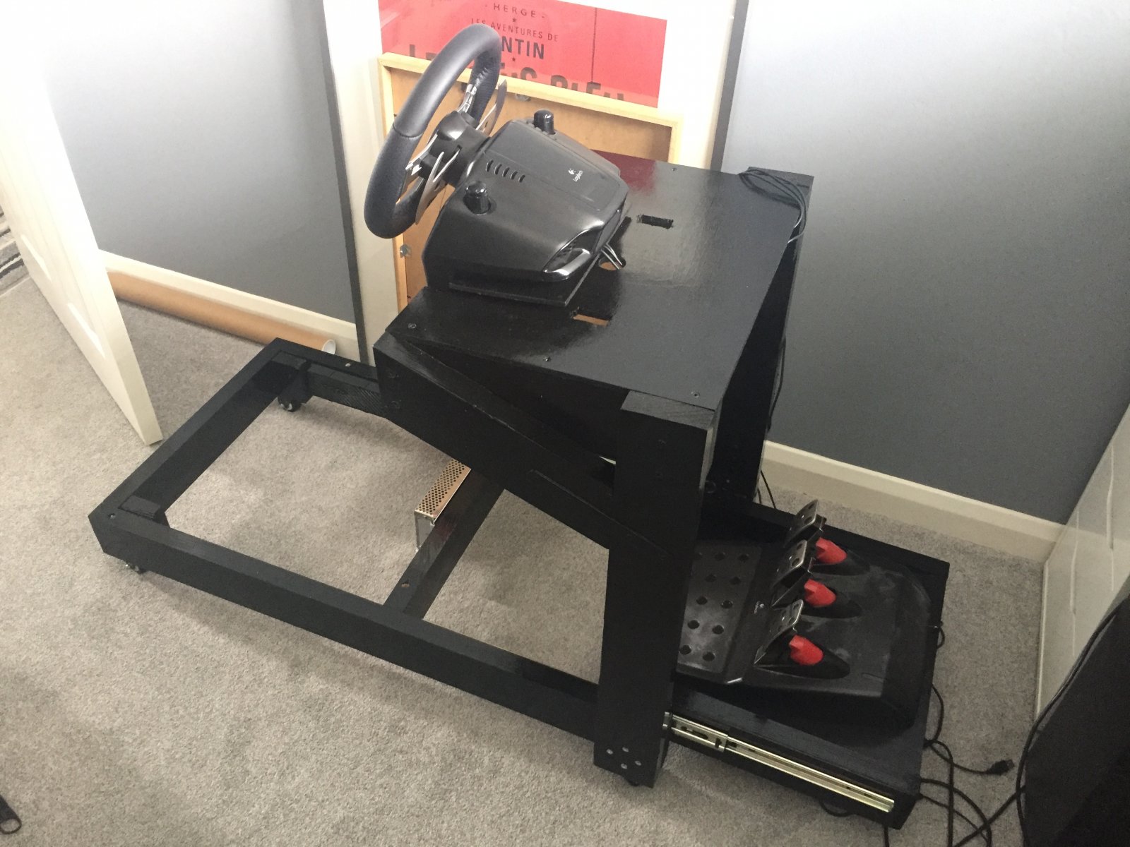

    Slow process but the frame is done
    The peddles retract in and out so only takes up 1 metre of room making it fit in a specific spot in my office

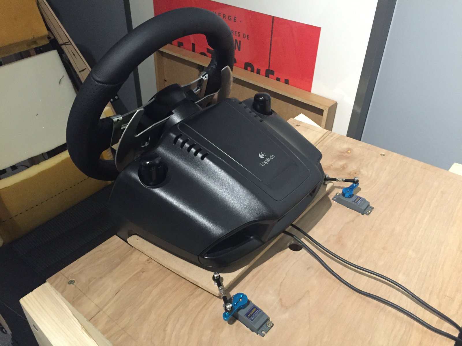

    Next step will be to incorporate the wheel braking g force system

  4. Sebj
    Sebj Active Member
    Nov 13, 2014
    287
    Canada
    492Coins
    +165 / 1 / -0
    Very innovative side panel design, good stuff.
    I wonder if you beat the gs5 to it!

    Thanks, to be honest I'm surprised that there isn't something similar already, very simple.
  6. yobuddy
    51,589Coins
    +5,204 / 19 / -0
    Great Work @early_m !
    Really like the pedal pull-out design!
    Have you ridden it yet?

  7. early_m
    early_m Active Member
    Jul 28, 2016
    336
    Chelmsford
    845Coins
    +357 / 5 / -0
    Thanks very much, I'm hoping to take it for its first test ride tomorrow as its now complete with the final piece of the puzzle in place - the wheel braking g force setup

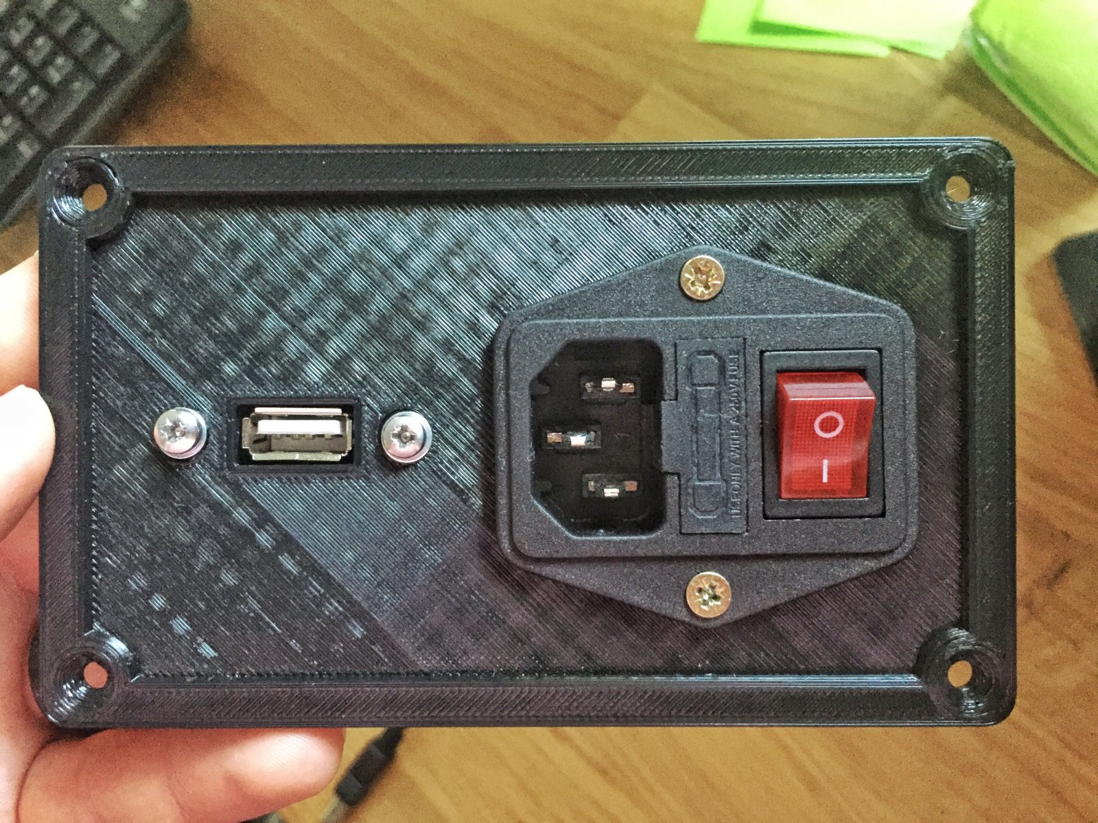

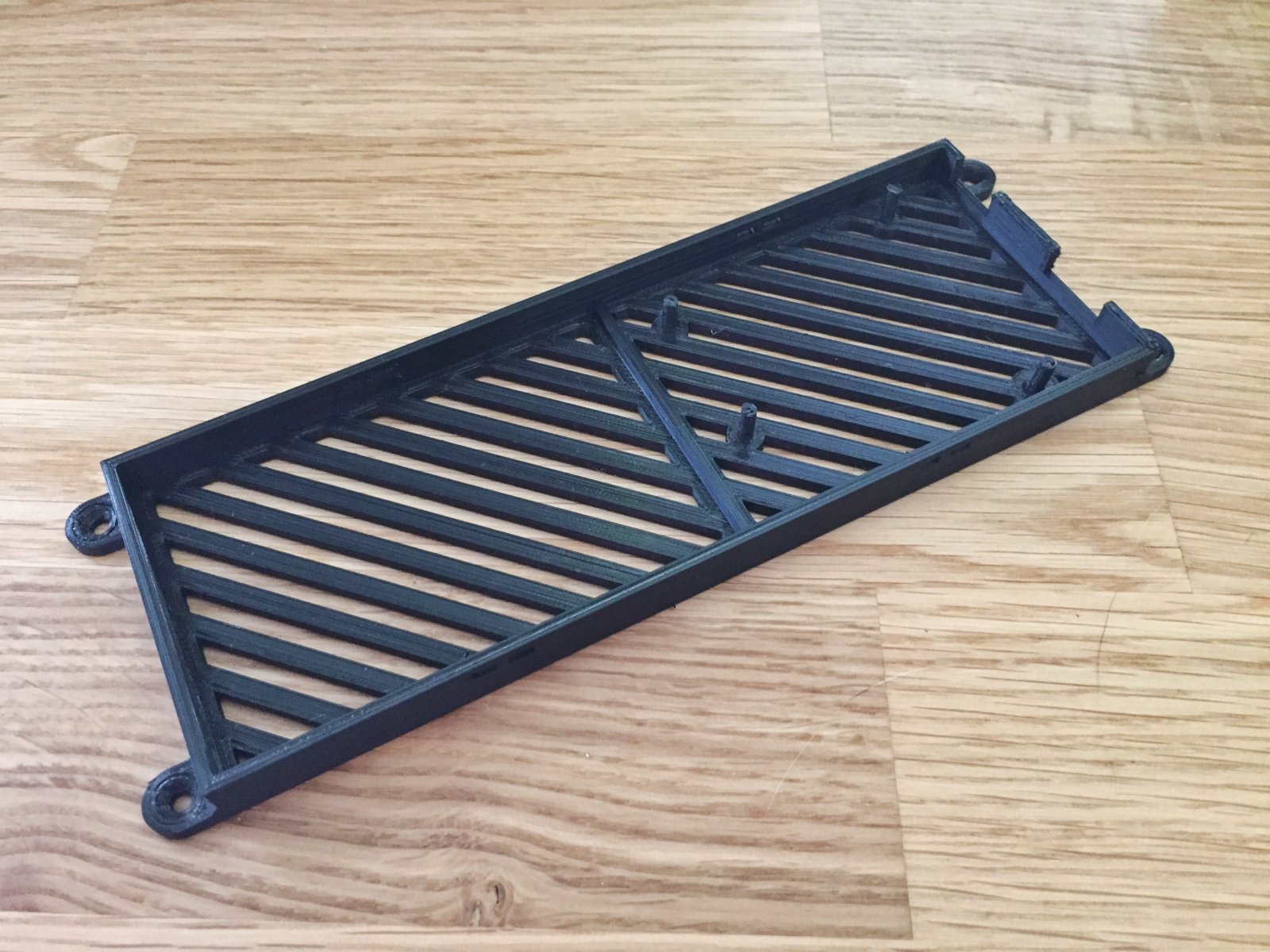

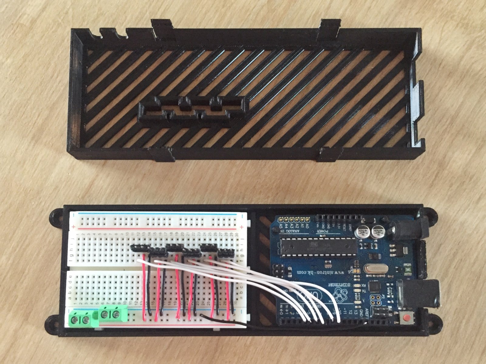

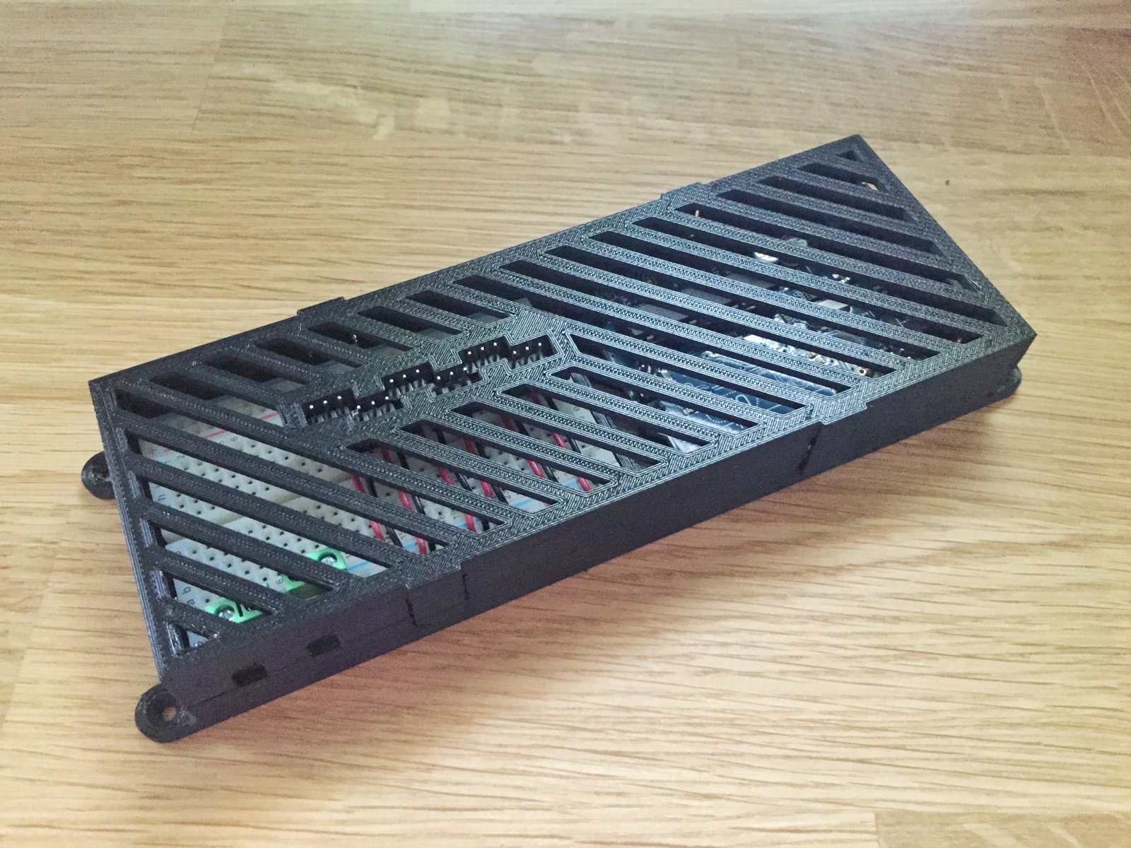

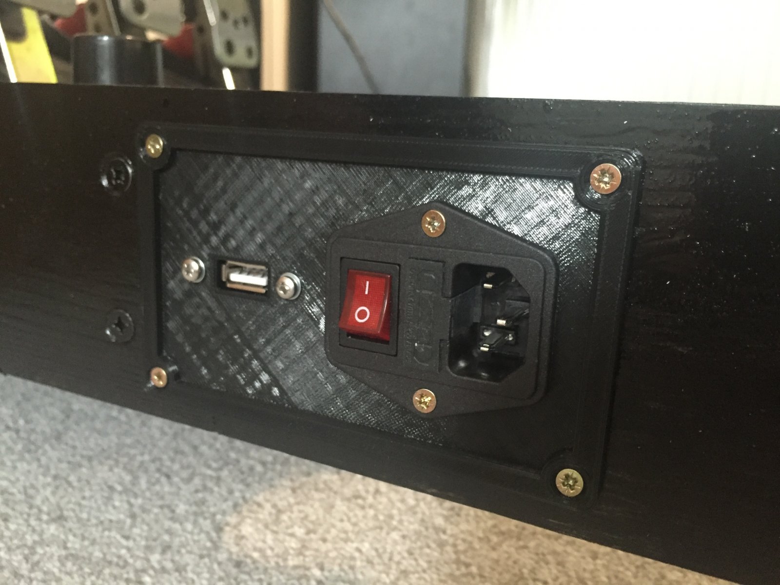

    Small amount of time today to start tidying up the electronics.
    Starting with a simple cover plate for the power and data sockets
    I originally sliced the ends off some servo cable extension leads to connect everything up, but always thought it was a bit messy. So I put together a little breadboard circuit that allows me to plug my servo connectors straight in, kind of like a servo shield. Made a little housing unit to keep it all tidy and protected
    Lower case
    Uno and breadboard installed
    Full assembly

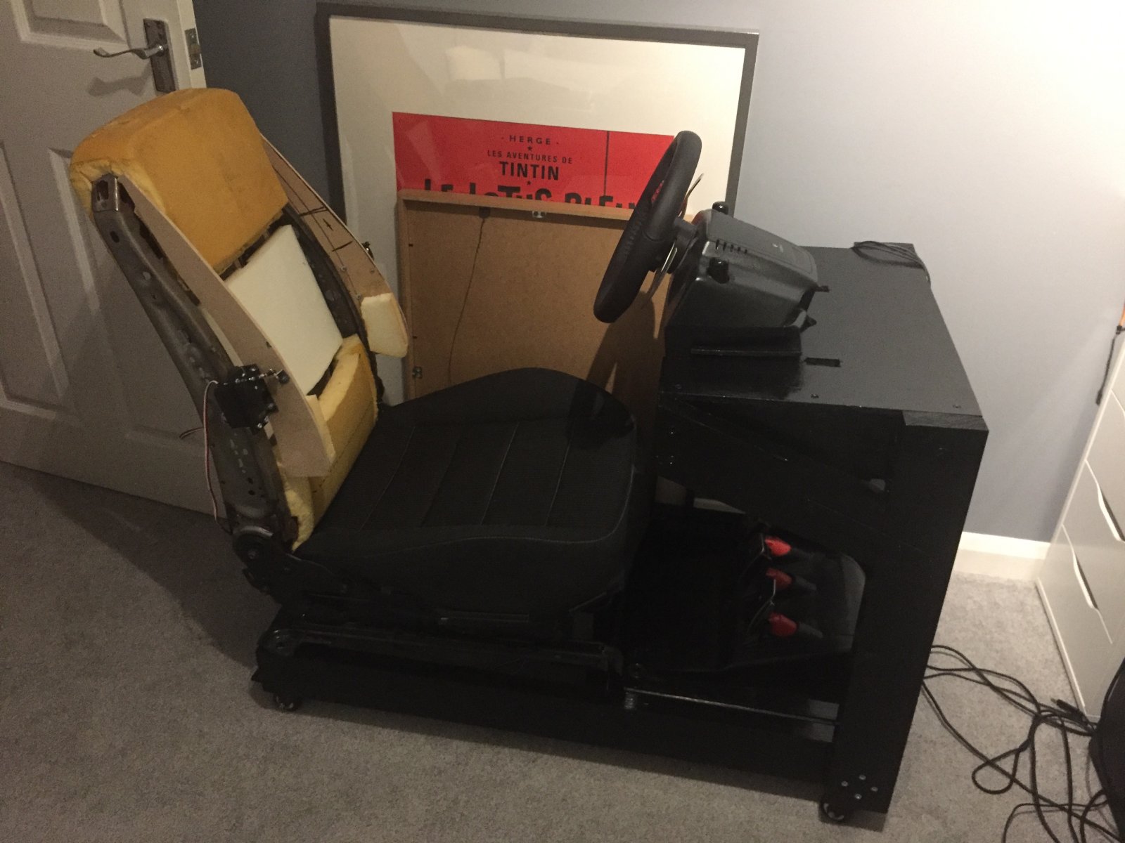

    Onto the final straight now. Have painted the frame a gloss black and now looks a bit less 'red neck"

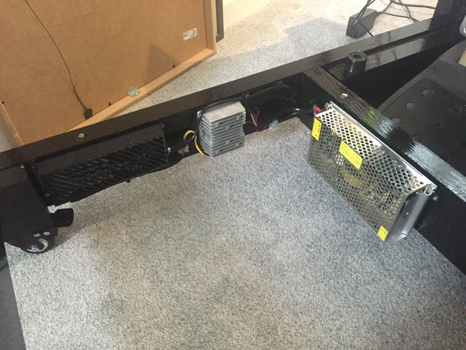

    Installed the electrics to the inside of the frame under the seat:
    220v AC to 12v 10A DC PSU
    6V DC/DC Buck converter
    Arduino and breadboard unit
    Power and data in sockets and mount

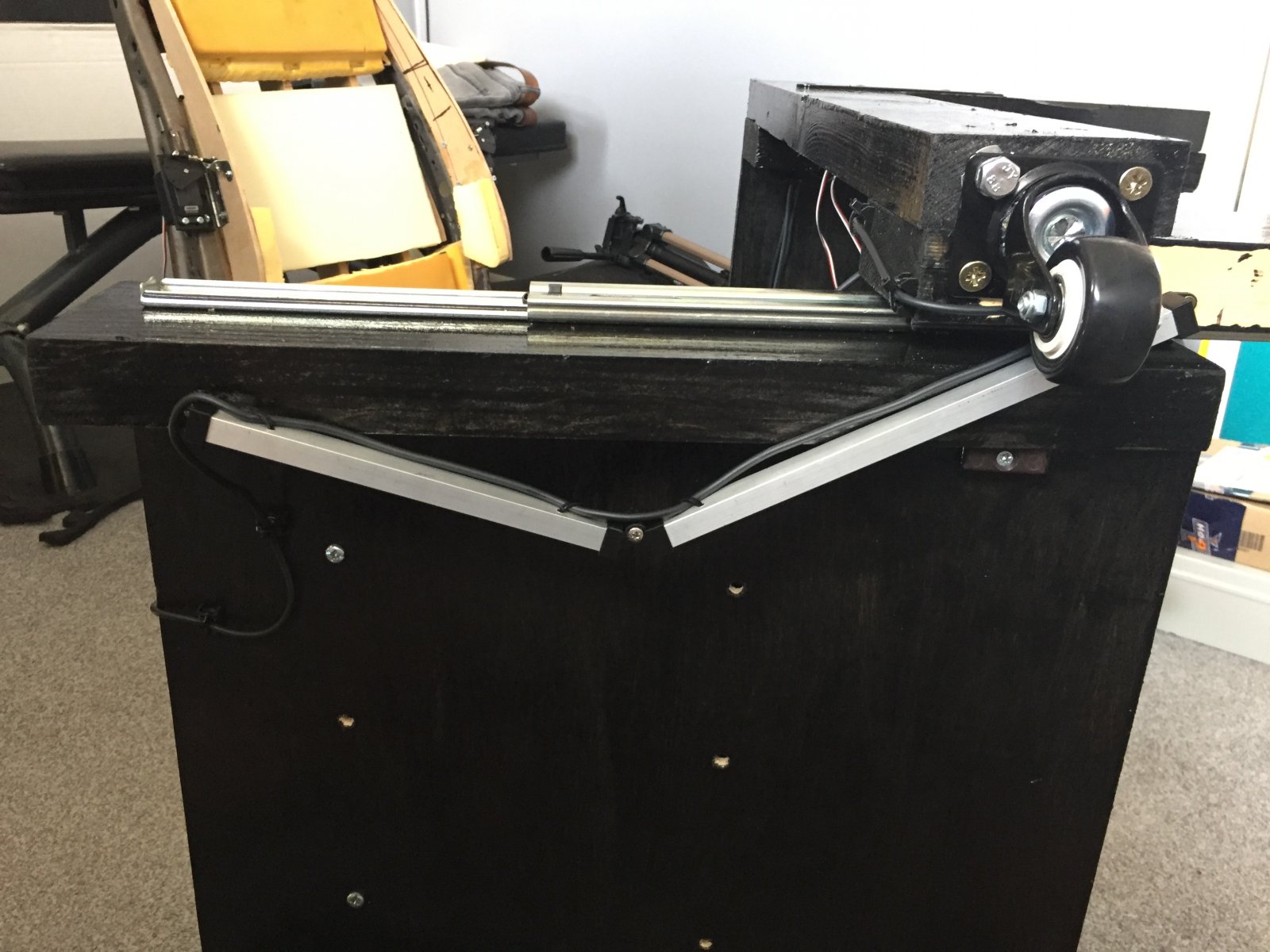

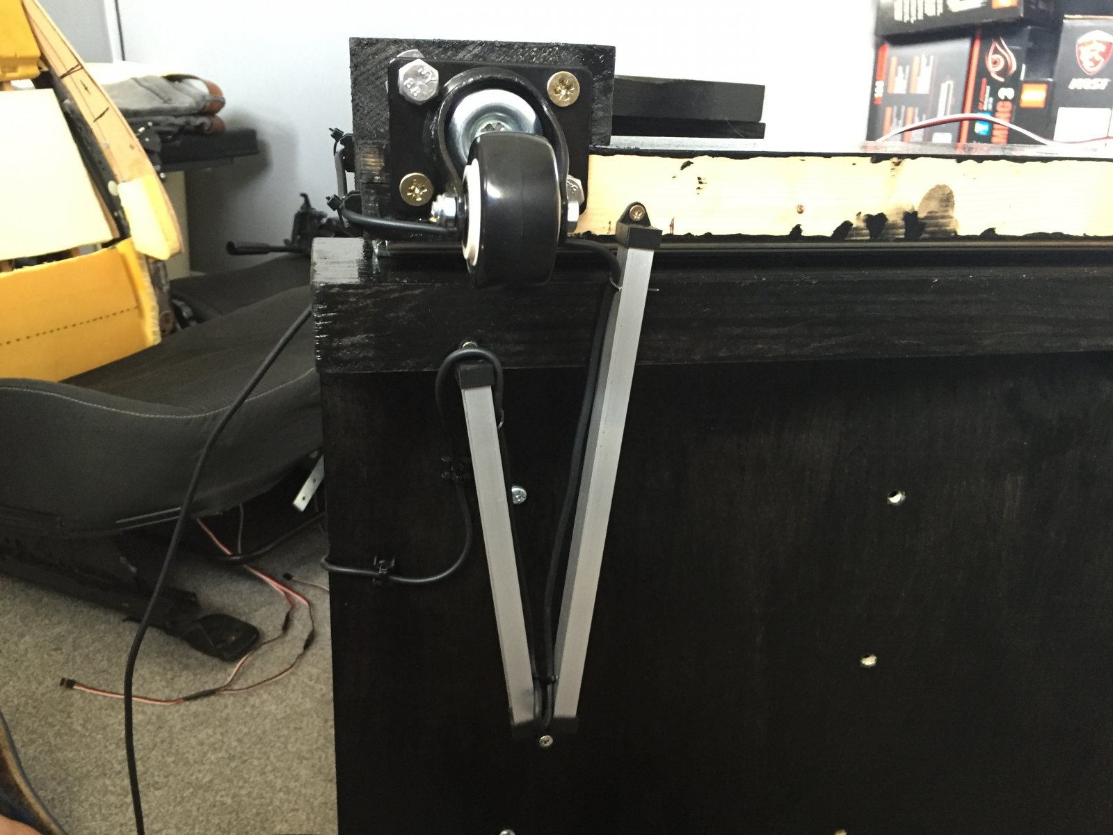

    Made a little mechanism to handle the cable slack under the pull out pedal section
    Closed
    Open
  13. noorbeast
    22,086
    154,124Coins
    +11,170 / 57 / -2
    Congrats on the detailed thought and work that has gone into your rig, right down to the really neat switch panel and cable management system.
