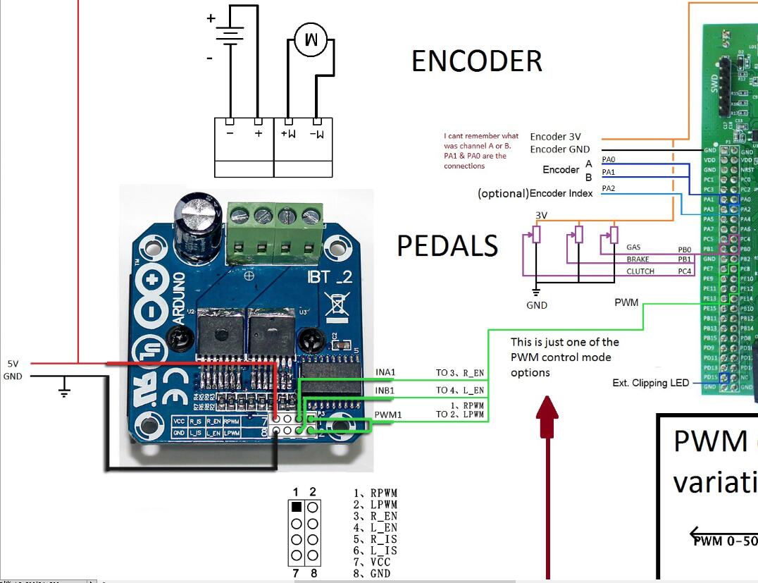

    Hi there,
    I've detailed how to do this half way down this page:
    https://www.xsimulator.net/community/threads/diy-ffb-steering-wheel-mmosffb-in-progress.7769/page-16

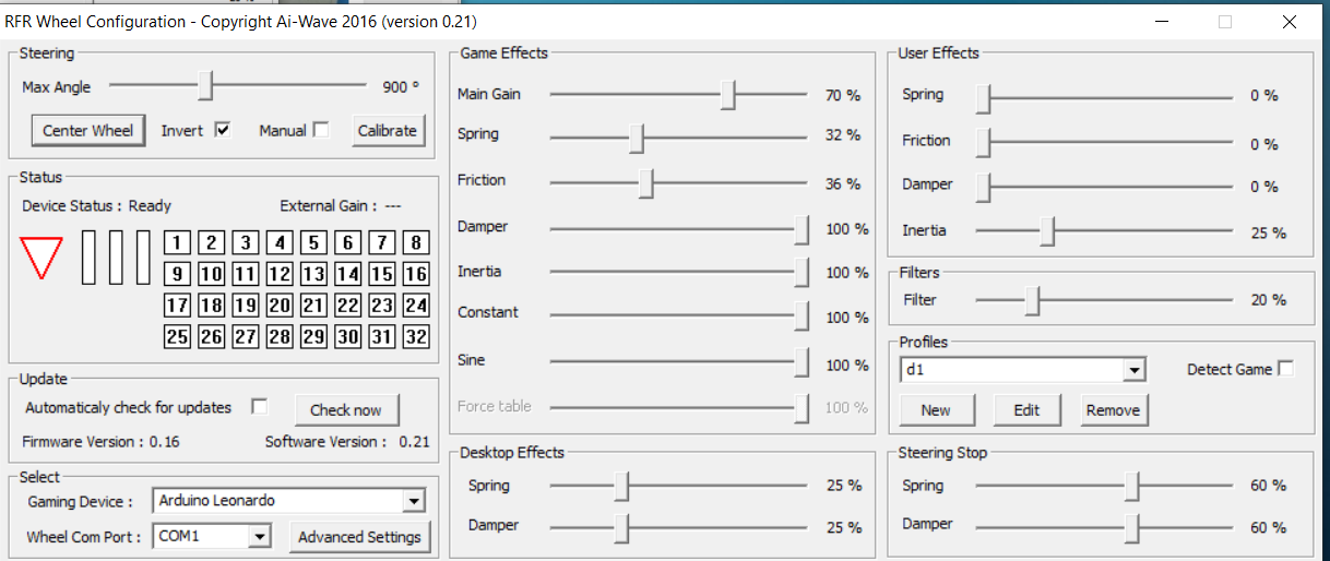

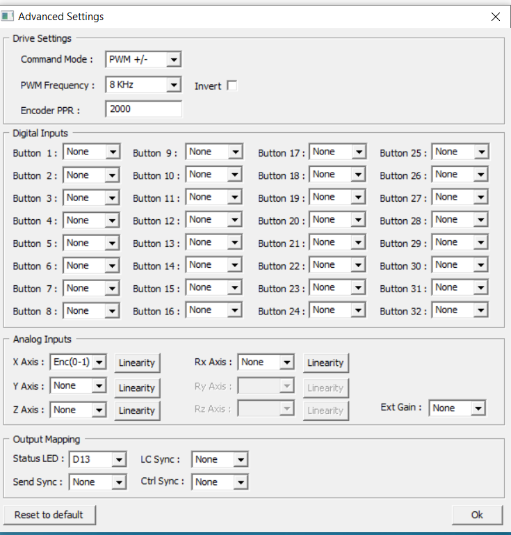

  10. Llewelyn
    Llewelyn Member
    Nov 10, 2017
    69
    IT consultant
    south africa
    108Coins
    +18 / 0 / -0
    These are my settings below,but they only work with the R/L EN AT 5v .The sim I use is LFS.
  11. elnino
    elnino Active Member
    Apr 1, 2010
    246
    Computer Geek
    Adelaide, Australia
    1,557Coins
    +139 / 1 / -0
    Based on the instructions from @doddynco, pretty sure you need to set the command mode to PWM + DIR, not PWM +/-
    Based on my understanding, this works because each side is 50% on and 50% off. Therefore it imitates a freewheel situation. Then it is biased to one side or the other to create force.
    I had a look at the signals from the other 2 complimentary pins in H Bridge mode and it does not seem like it will do what we want either.
  12. Llewelyn
    Llewelyn Member
    Nov 10, 2017
    69
    IT consultant
    south africa
    108Coins
    +18 / 0 / -0
    Okay will try it in the PWM + DIR mode,think I did try it but will make sure.Thanks.

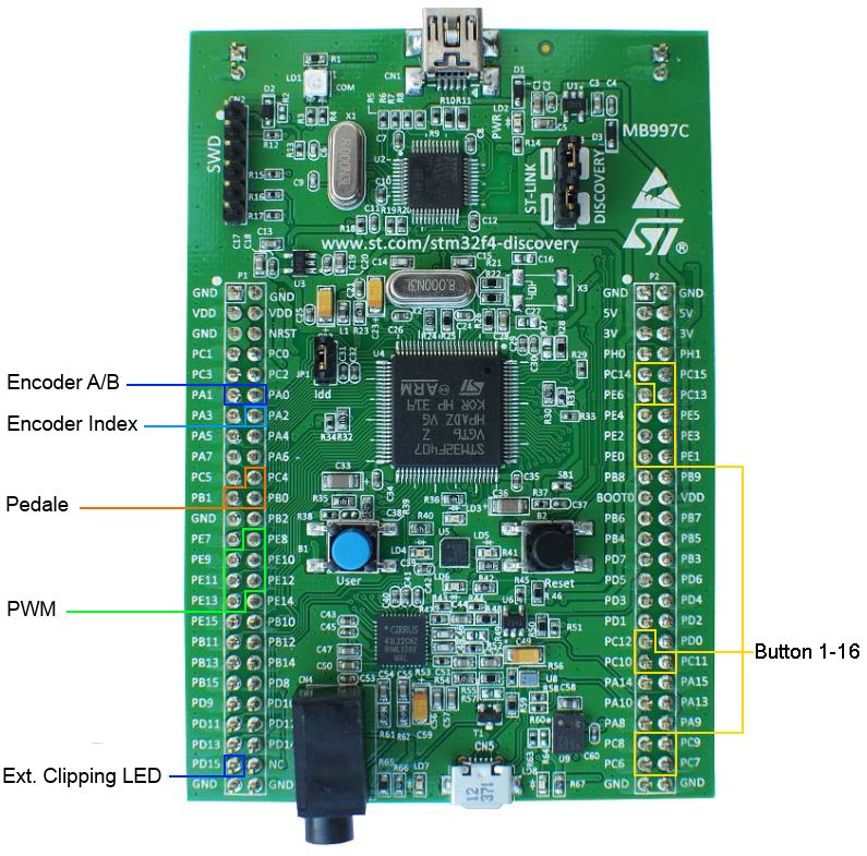

    This is the discover board Pwm pin out section. It works both in the 'old way' H-bridge and the frictionless way 'PWM_DIR' .
    Using the IBT_2, you can only get frictionless feedback if you use PWM_DIR mode. This is because when DIR is on, DIR Complementary (reversed DIR) is off, and vice versa. This means the h-bridge is completely open (not acting as a generator) when there is no PWM input, allowing the wheel to rotate freely.
    I'm not very familar with the arduino as it was a while ago I used it - I realsied the code missed out some important elements of the FFB (not sure if they're fixed with the most recent EMC) and moved to a discovery board.
    If there's a way on the Arduino to output DIR and a reversed DIR at the same time, you can do frictionless FFB. Otherwise you should get the discovery board
