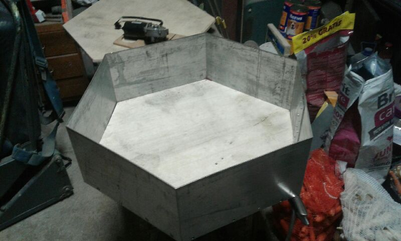

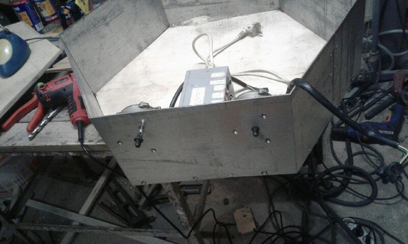

    First step bootom floor

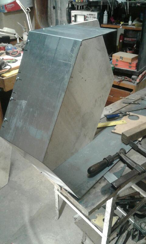

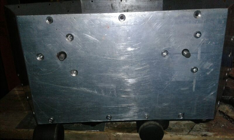

  2. tadeusz
    tadeusz New Member
    Nov 4, 2025
    34Coins
    Side wall Sheet metal 2.5 mm

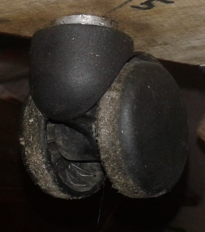

  9. tadeusz
    tadeusz New Member
    Nov 4, 2025
    34Coins

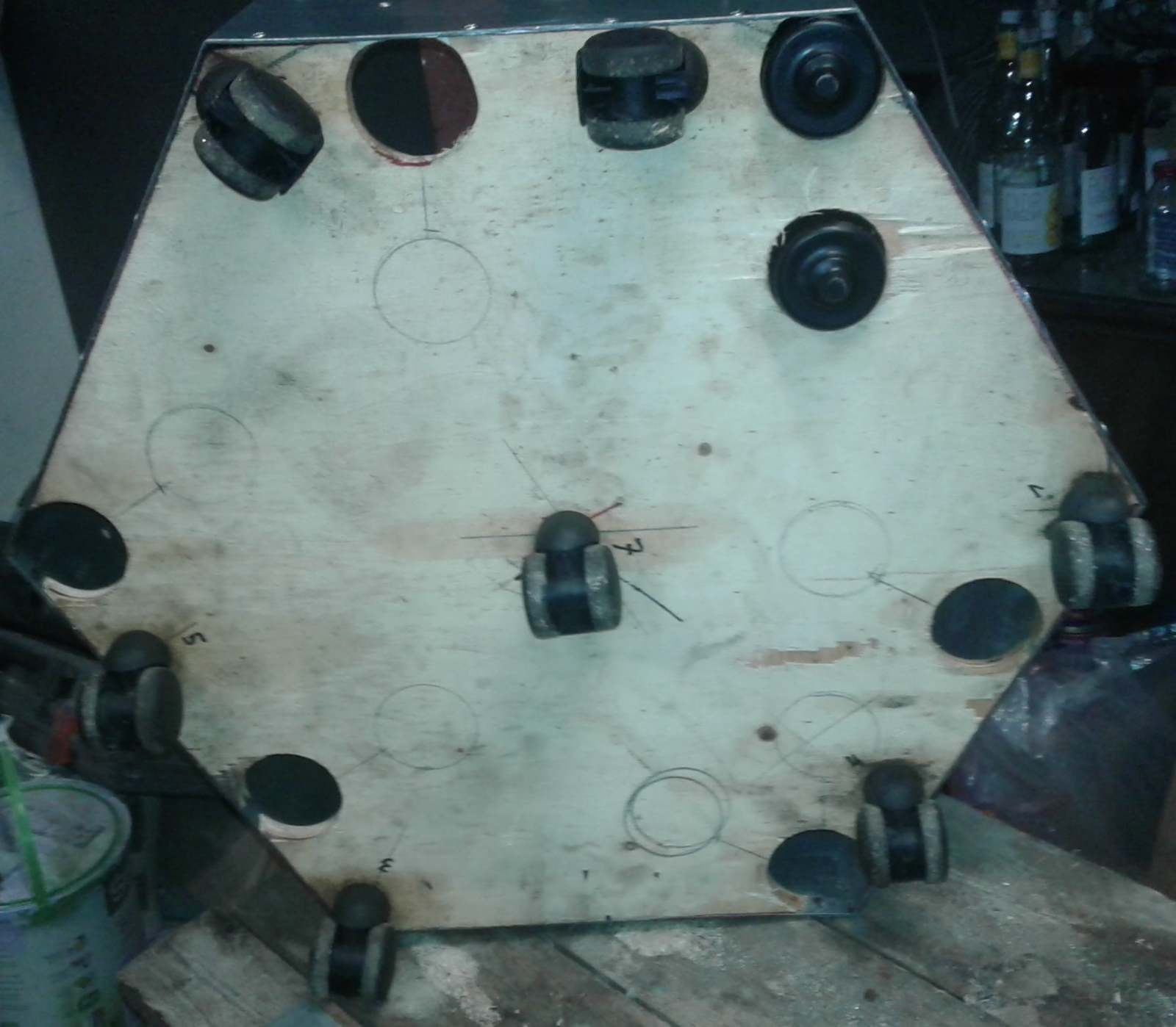

    7 wheels for the seat as a chassis
  10. tadeusz
    tadeusz New Member
    Nov 4, 2025
    34Coins
    wheel fastening

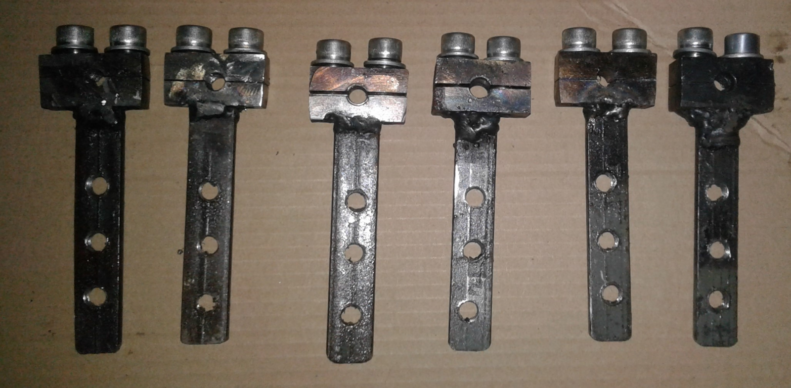

  11. tadeusz
    tadeusz New Member
    Nov 4, 2025
    34Coins
    Hi
    I looking for
    Potentiometer with magnetic sensor
    to the wiper motor?
    how best to fasten?

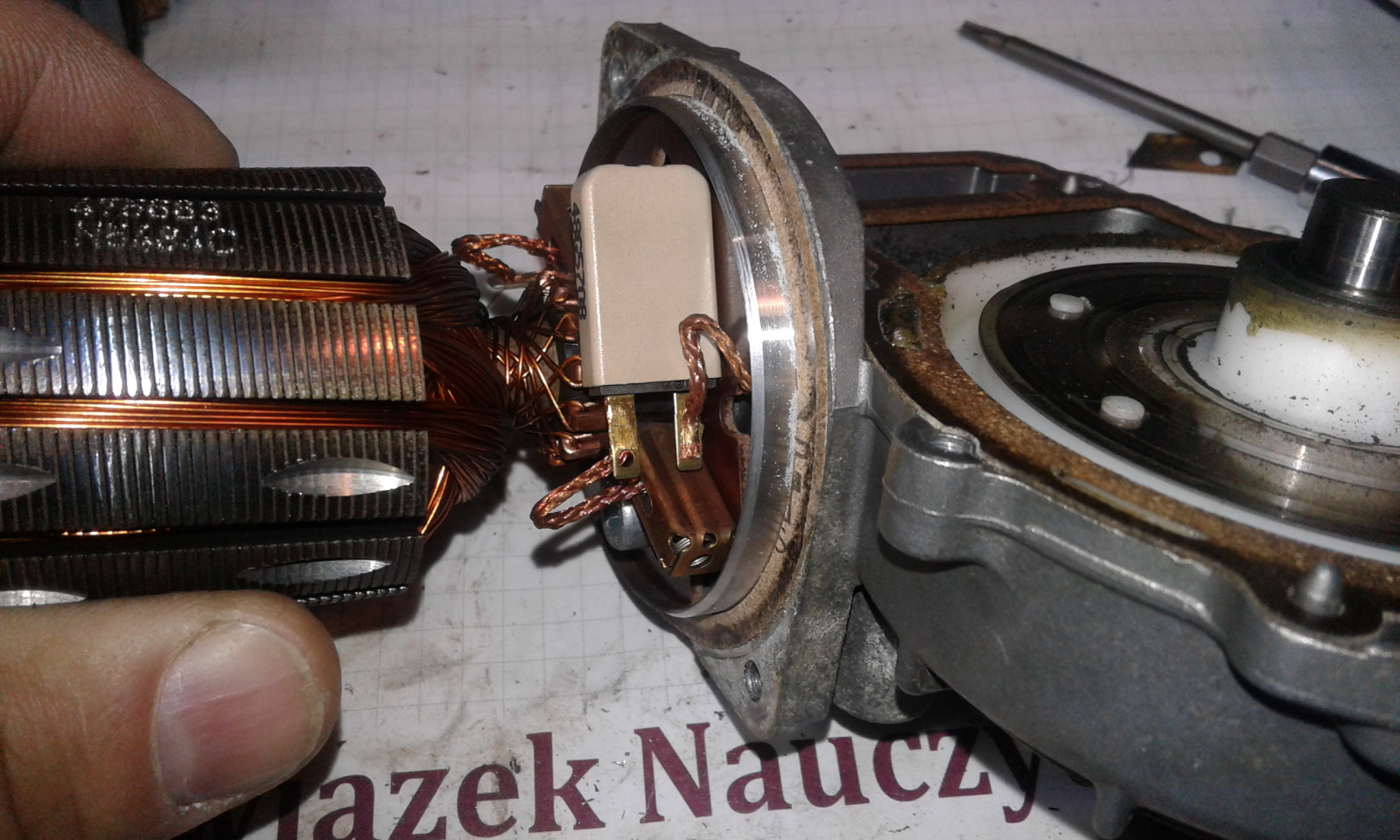

  14. tadeusz
    tadeusz New Member
    Nov 4, 2025
    34Coins
    it is good idea?

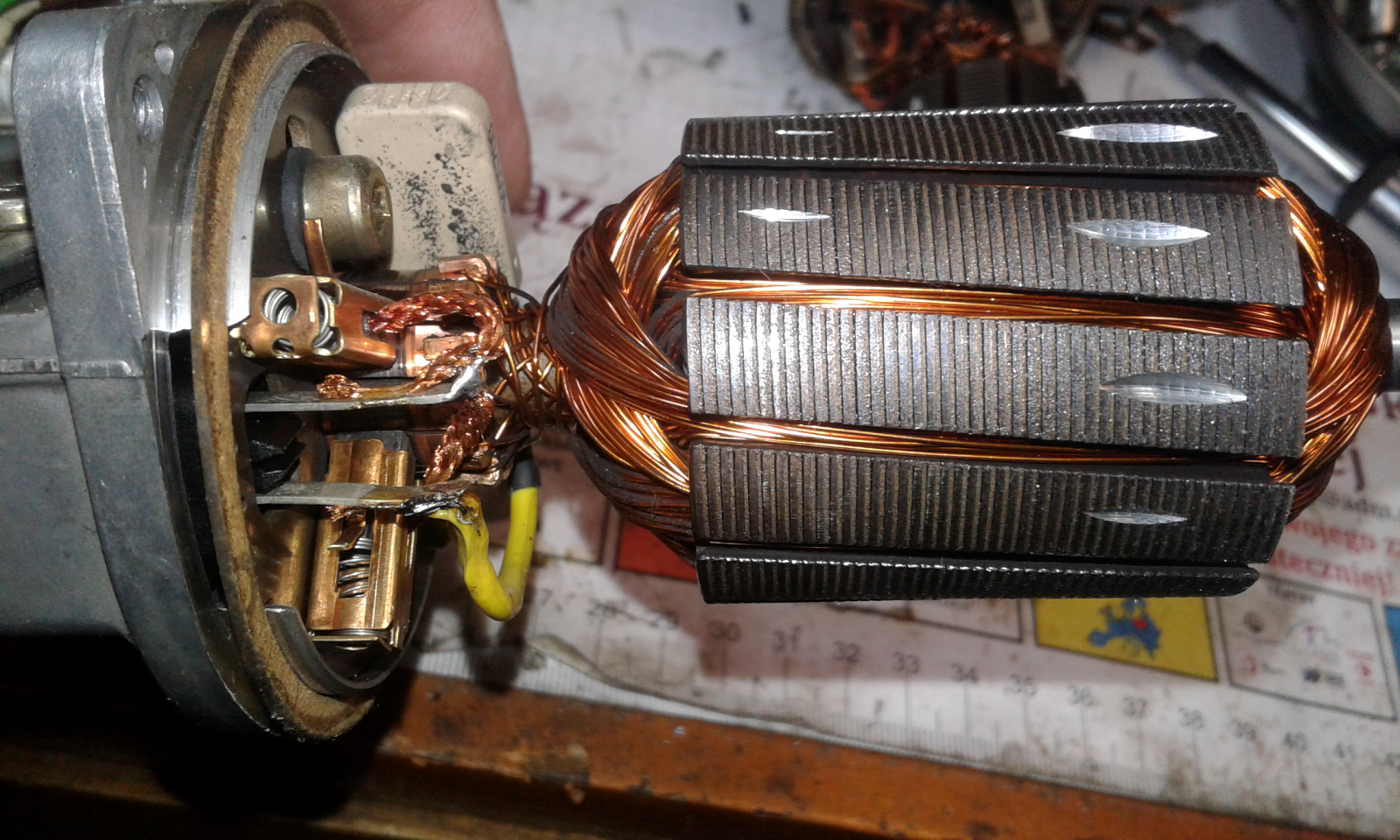

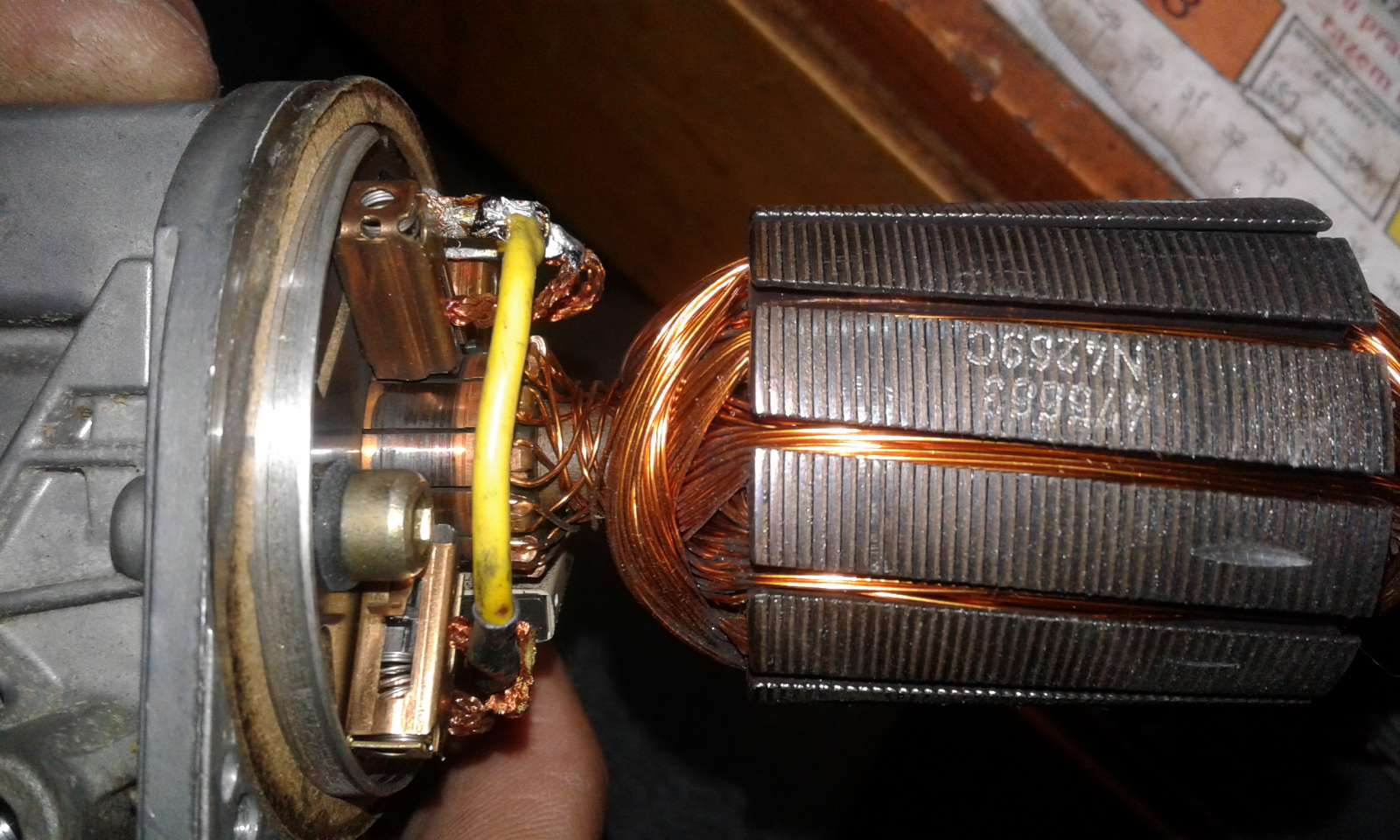

  16. tadeusz
    tadeusz New Member
    Nov 4, 2025
    34Coins

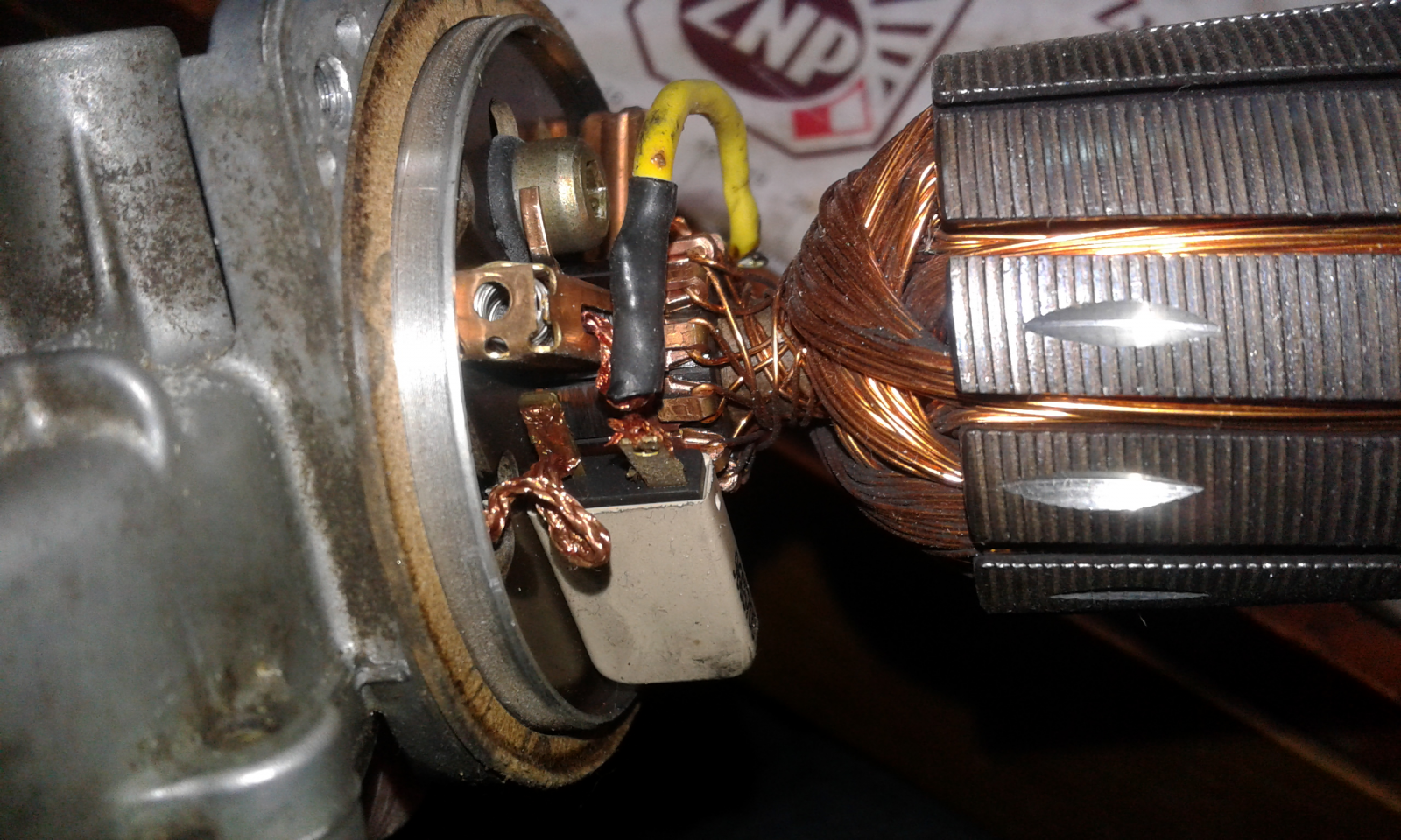

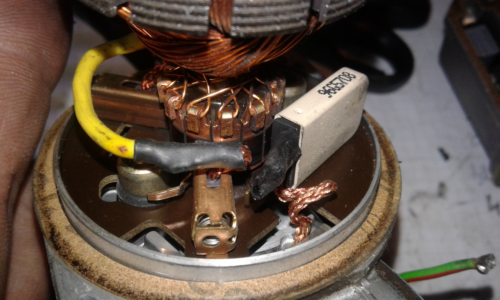

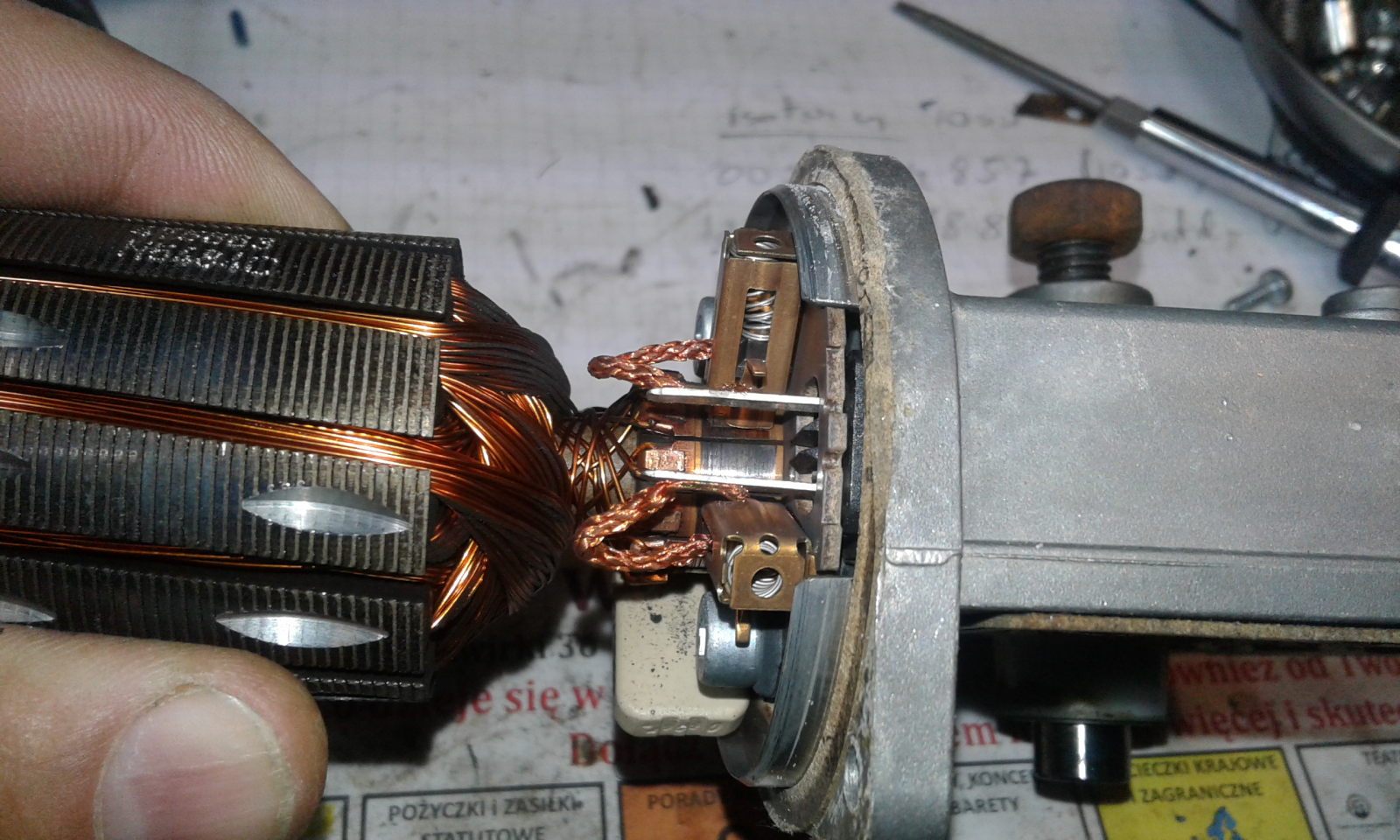

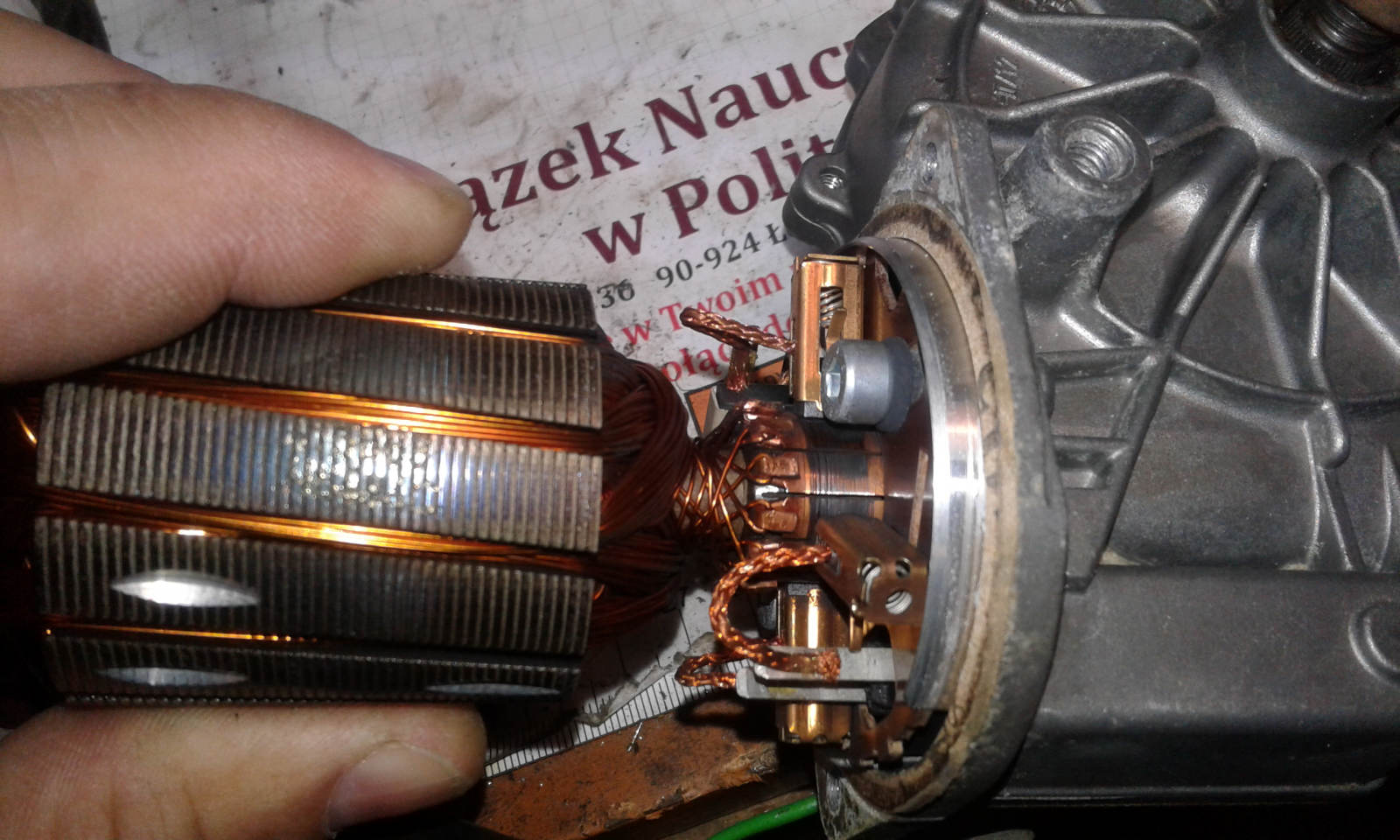

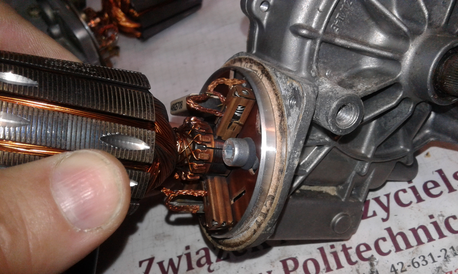

    wiperservo modification
    and cut off the mass
    before:
  17. tadeusz
    tadeusz New Member
    Nov 4, 2025
    34Coins
  18. ahoenksiluman
    ahoenksiluman Member
    Nov 13, 2017
    91
    indonesia
    89Coins
    +47 / 0 / -0
    thats my video...for dof i use different config, just a cylinder (3dprinted) with 2 magnet glued on the big gear...and the hall sensor, i make the mount using acrylic, just glued permanently...and the sensor mount, attached using spacer in the back of gearbox...

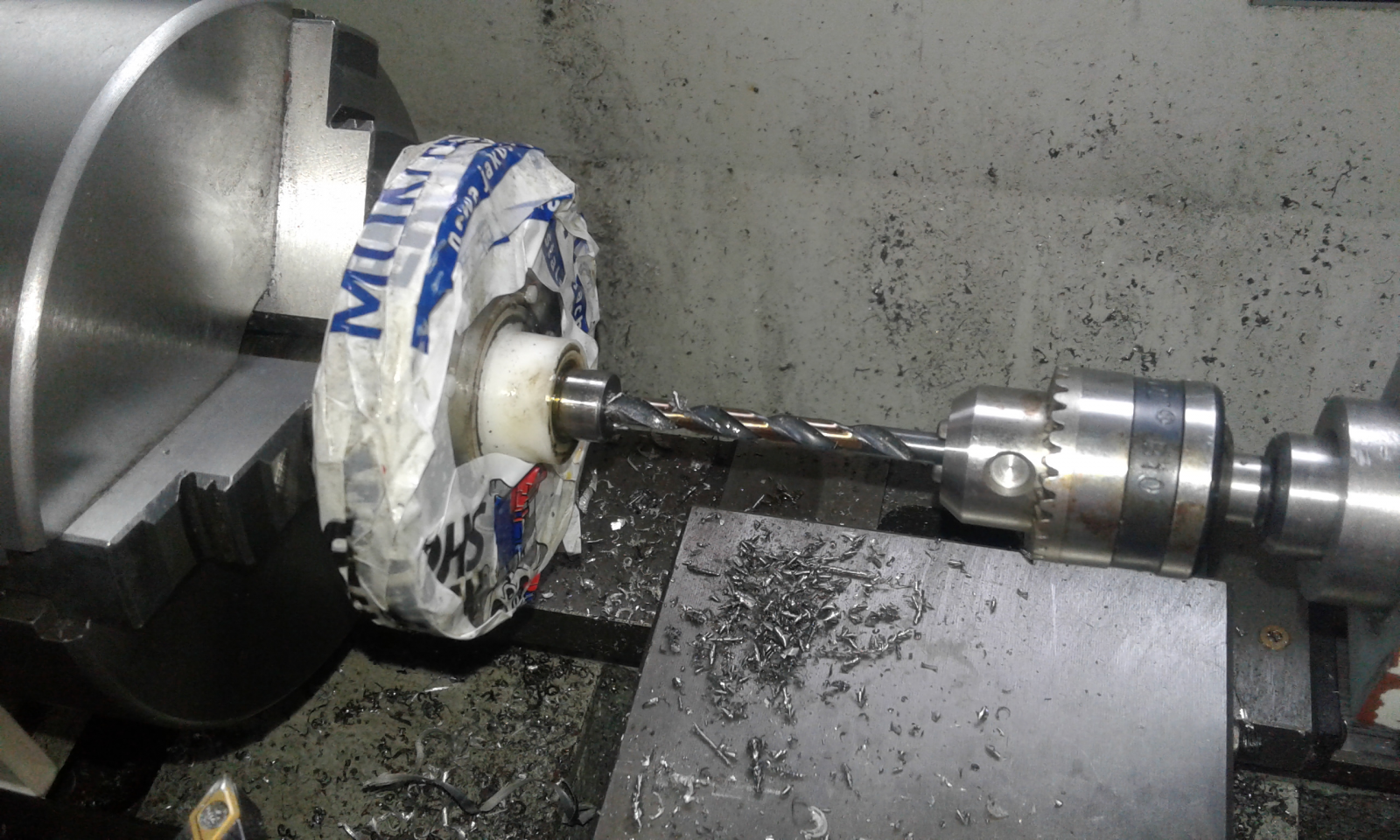

    fixing the potentiometer:
    drilling a hole
  20. tadeusz
    tadeusz New Member
    Nov 4, 2025
    34Coins
    threading
