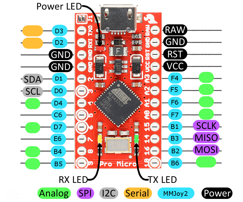

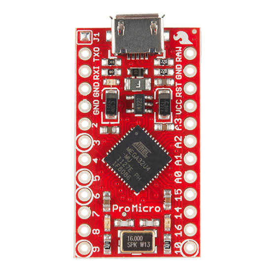

    Buddy I use an Arduino Pro Micro where I connect the 3 potentiometer pins? And another thing when I compiled your programming, my computer mouse got out of control and the arduino became a mouse.

    He Danilo,
    The Potentiometer will come on Ground, 5 Volt (VCC) and A10.
    Indeed, There is a mouse also in the sketch. I put a joystick in the steering wheel for controlling the menu in Assetto Corsa.

    I've been looking around this site in awe & with some trepidation, as I am keen to build a 6DoF platform but not sure where to start, still working out what I need to know and most importantly learning what I didn't know I needed to know.... :blush
    I came across this thread and thought I might be able to contribute something
    for those of you who are not as electronically savvy or arduino coders.... (as I am not on both accounts)
    you may find this simple solution effective for DIY button boxes
    I am a flight sim enthusiast, not a racer, but a button box is a button box.
    https://avimator.net/229wiki/index.php?title=Shift_Register
    Rather than trying to work out a switch matrix, try using a shift register.
    It will allow you to increase your button/switch count exponentially without additional pin consumption of the controller board. In this case a arduino clone pro-micro
    @Mattx38 this solution would allow you to use a simple arduino mini and only need 5 pins.
    all the inputs to the switches run from the shift register (up to 32) and increase by dasiy-chaining more shift registers via the same 5 pins only.
    https://www.aliexpress.com/item/32818968146.html
    They are readily available from such sites as AliExpress, and cheap as chips.
    https://www.aliexpress.com/item/32861811972.html?spm=2114.12010612/itm2home-1.0.0.6e4c7e80QWiob1
    You can flash the firmware using MMJoy2 and then have a handy interface for configuring your controller.
    https://github.com/MMjoy/mmjoy_en/wiki
    Please Note: the pins labels may differ in the MMJoy2 interface to whatever is written on the PCB

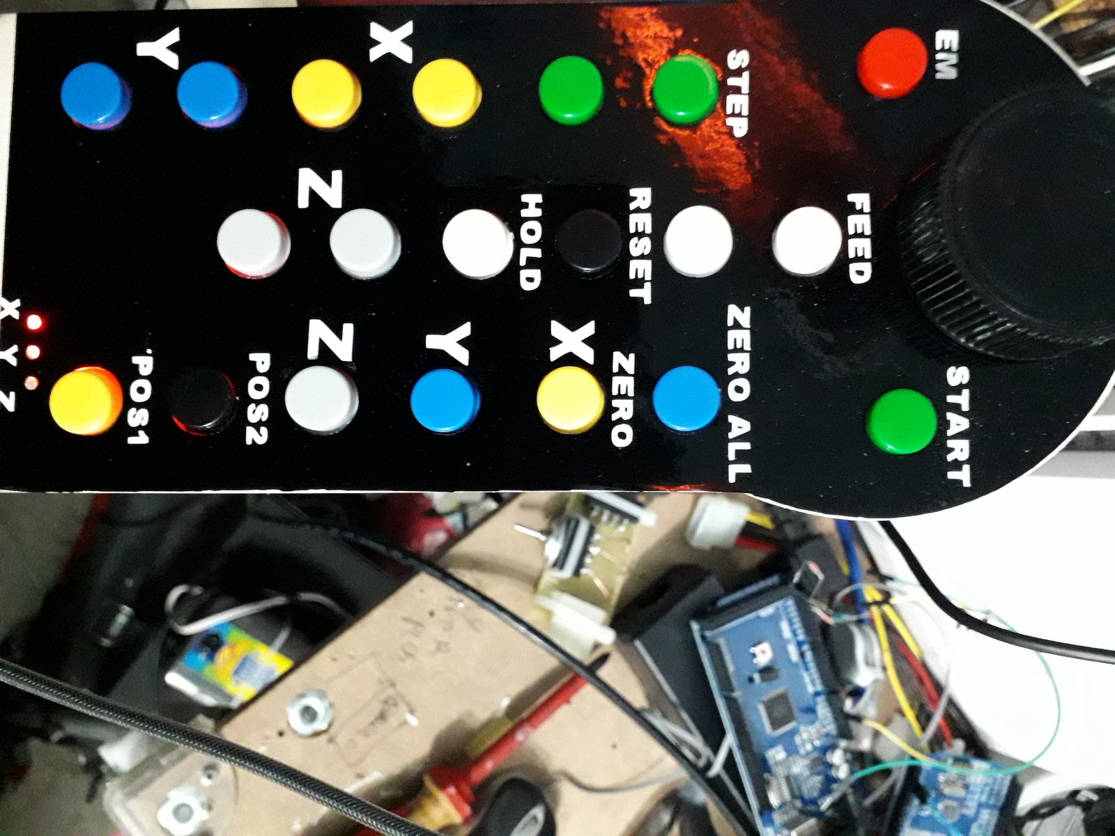

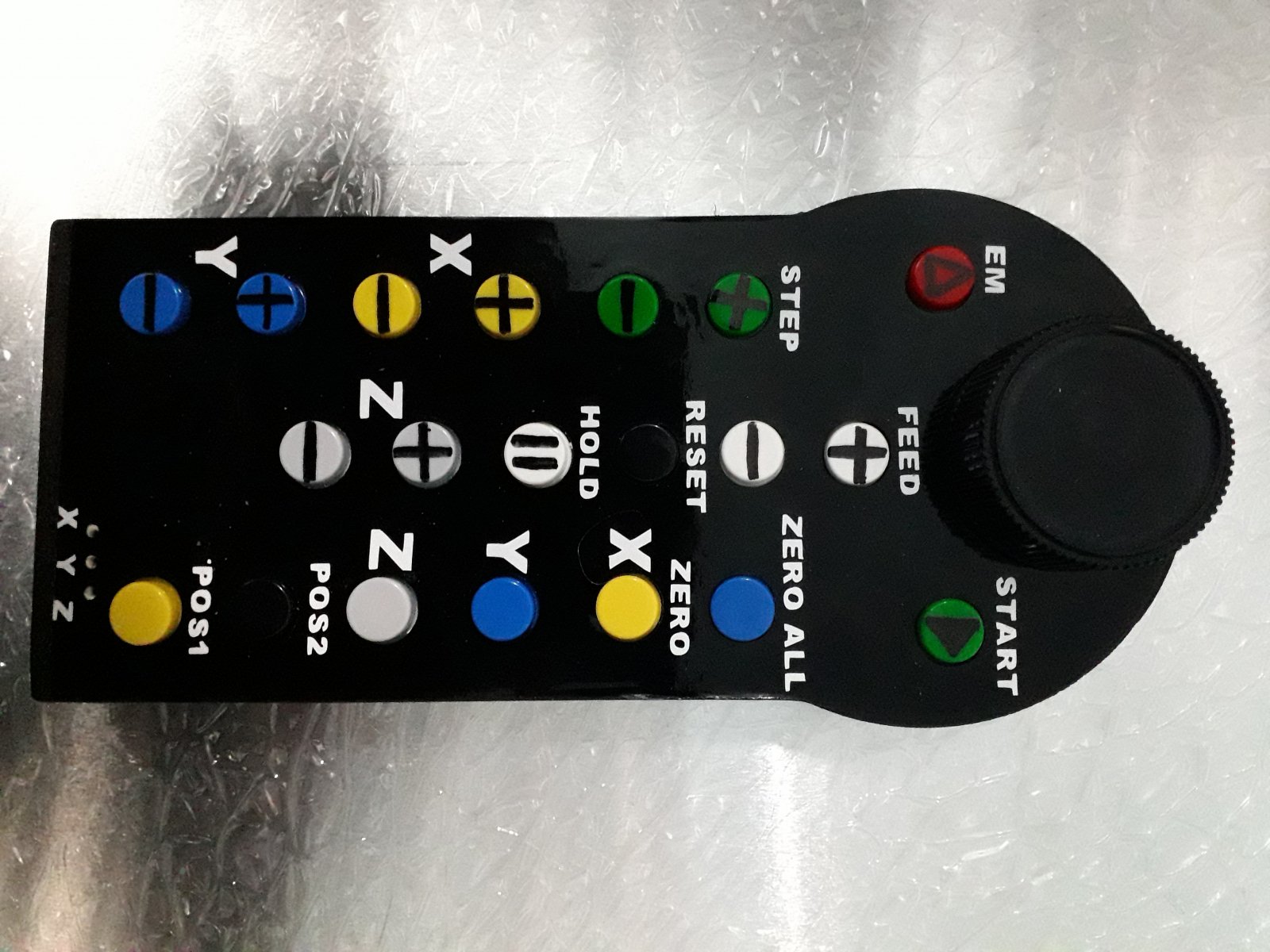

    I have changed the code to use one encoder for 3 cnc axis, inserted a button to select the axis with LED, the only thing is not being able to select the code, example:
    rotariesdef rotaries [NUMROTARIES] {
    for x axis {6,7, KEY_RIGHT_ARROW, KEY_LEFT_ARROW, 0},
    for y axis {6,7, KEY_DOWN_ARROW, KEY_UP_ARROW, 0},
    for z axis {6,7, KEY_PAGE_UP, KEY_PAGE_DOWN, 0},
    complete code:

    G'day again guys
    thought I'd update with something I've been tinkering with, with a couple of my flight sim cohorts...
    https://forums.mudspike.com/t/mmjoy-pcb-design/9705
    This board has been designed to simplify the creation and connectivity for novice electronics users.
    hence some of the flexibility has been removed from a standard pro-micro/arduino clone/teensy board
    however it works with MMjoy2 & we hope will allow for many users, whom might have previously borked at their first attempt
    to potentially return and have another go at making their own peripherals.
    cheers
