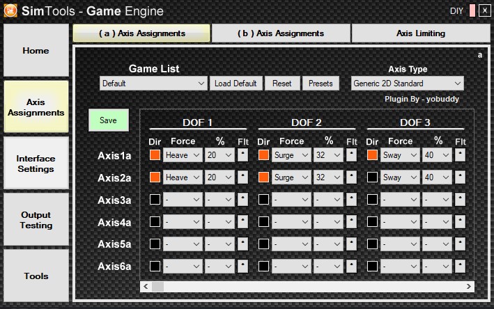

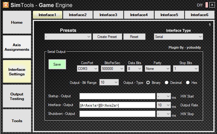

    After a longish break from the sim I reinstalled everything and am presented with the current issue:

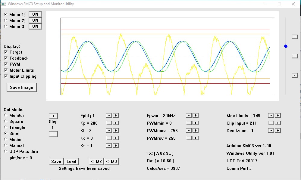

    - SMC3 control works flawlessly, meaning manual control from -limit to +limit is smooth.
    - Axis assignments are the same as they were before the reinstall. (regular [A<Axis1a>][B<Axis2a....)
    - GameEngine output testing does work BUT...
    - When output testing, both Axis1a and Axis2a don't respond to input from the values of -1 to -25.
    Beyond -25 the motor jumps to the correct position, while if i drag the slider above -25 it doesn't jump back until it hits +1. The rest of the range works with no problem.
    - If i limit the axis to 50% from within "Axis limiting", the deadzone increases from {0,-25} to {0,-50}, if i limit the axis to 25% the deadzone goes all the way from 0 to -100.
    What do i do? The arduino is working fine since SMC can control it with no issue.
    Thanks a lot!

    Update : rolling back to 2.4.0 fixed the issue!
