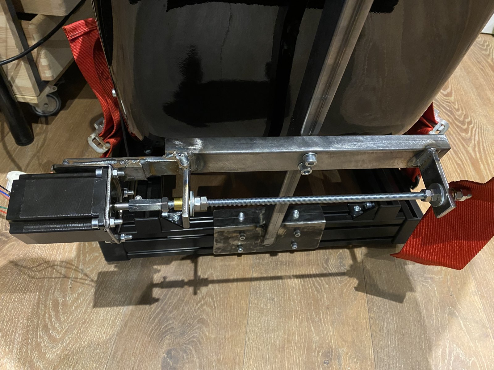

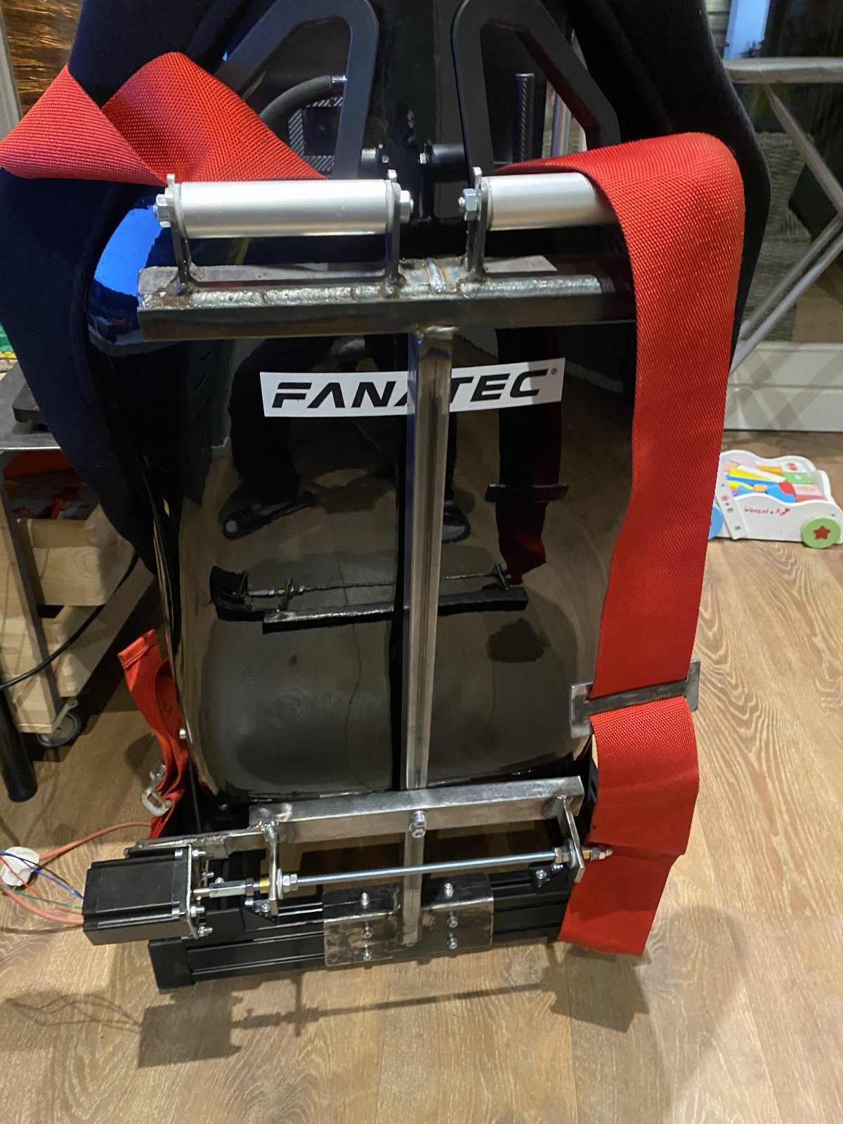

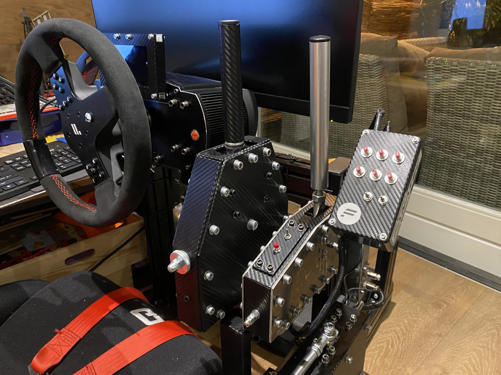

    Hi all,
    I'm Paul from the Netherlands.
    After selling my playseat with t500 rs 2 years ago i got back into simracing with a new rig see further for the details.
    I'm building an active seatbelt tensioner and motion for the first time its a project to start and when its working fine and i know how to program it i will start building a 3dof.
    The mechanics are finished i start with one steppermotor nema 23 i can alwas upgrade to two of bigger motors.
    I have for electronics:
    Arduino uno
    Tb 6600 microstep driver
    nema 23 stepper motor 3,5A
    LRS 50 powersupply 12v max 4,5A
    I run the simtools software
    Now i only need a code for the arduino to start with and i have no idea where to start is there anyone that can help i'm good in mechanical work but programming is another thing.
    For my rig i run:
    -80-20 simlab gt
    -lcd seat
    -sabelt 6point harnes
    -Fanatec csw 2.5
    -Fanatec csl elite pedals with loadcell
    -Fanatec p1 rim
    -home made seq shifter (feels really good and mechanical i wil make a thread from the build)
    -home made handbrake (button operated for now but wil update to loadcell in the future after i learned to program)
    -home made 7 and reverse Hshifter (feels really good and mechanical i wil make a thread from the build) its based on the Frex h shifter design)
    -home made dash from old sony phone running dashpanel and build a nice case around it

    IMG_6566.jpeg IMG_6564.jpeg IMG_6561.jpeg IMG_6560.jpeg IMG_6559.jpeg IMG_6562.jpeg IMG_6563.jpeg IMG_6565.jpeg

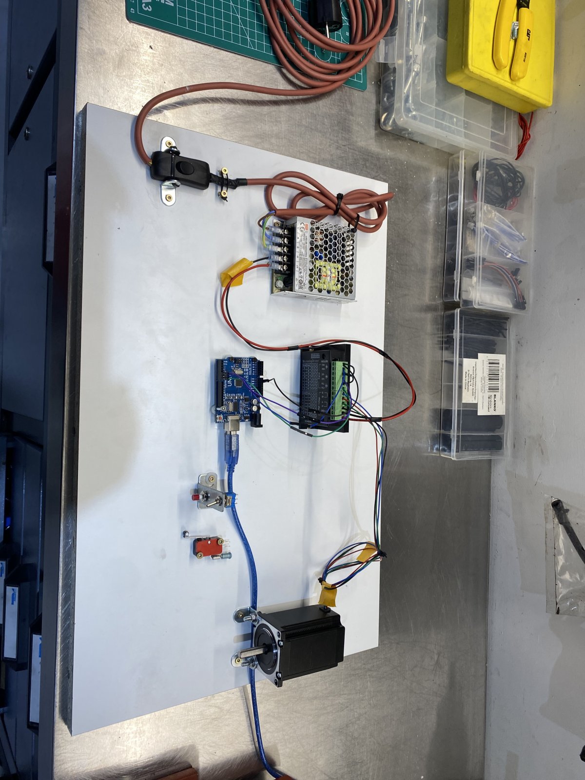

    I had al lot of these Parts i had already so thats why is try steppermotor.
    made a test board this evening so i can start testing
    @Krzysztof Dej what problems do you encounter? 6E8FDC22-C51C-44C6-8728-1860A949C4D1.jpeg 53ABA6D3-C946-4247-8E96-298AA186B2B7.jpeg

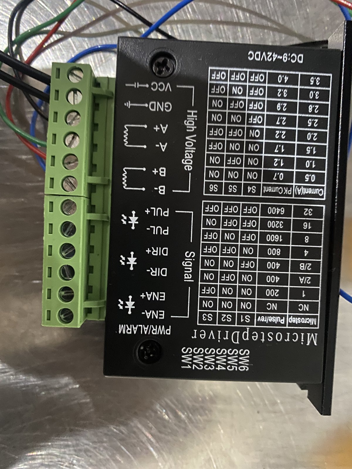

    Wow. Can u show whot is this controller and how u wire it from motor to arduino? Why these switches is for? My problem was that motor caused a short circuit when I mount it on rig somehow. Now I'm waiting for 3d printing part to separate it from rig. But I see now I have another problem with Smc3Utils config. My 2dof motors config doesn't work with this small motor. So I see i will have a lots of play with it

    The controller is a bt6600
    the Wiring is not ready yet i’m going to figure it out today and try To write a code I Made the switches because i can do Some testing (basics) i never wrote a code before the black switch on the left is for cutting powersupply with one toutch just in case.
    Wen i figured out wiring i write it here

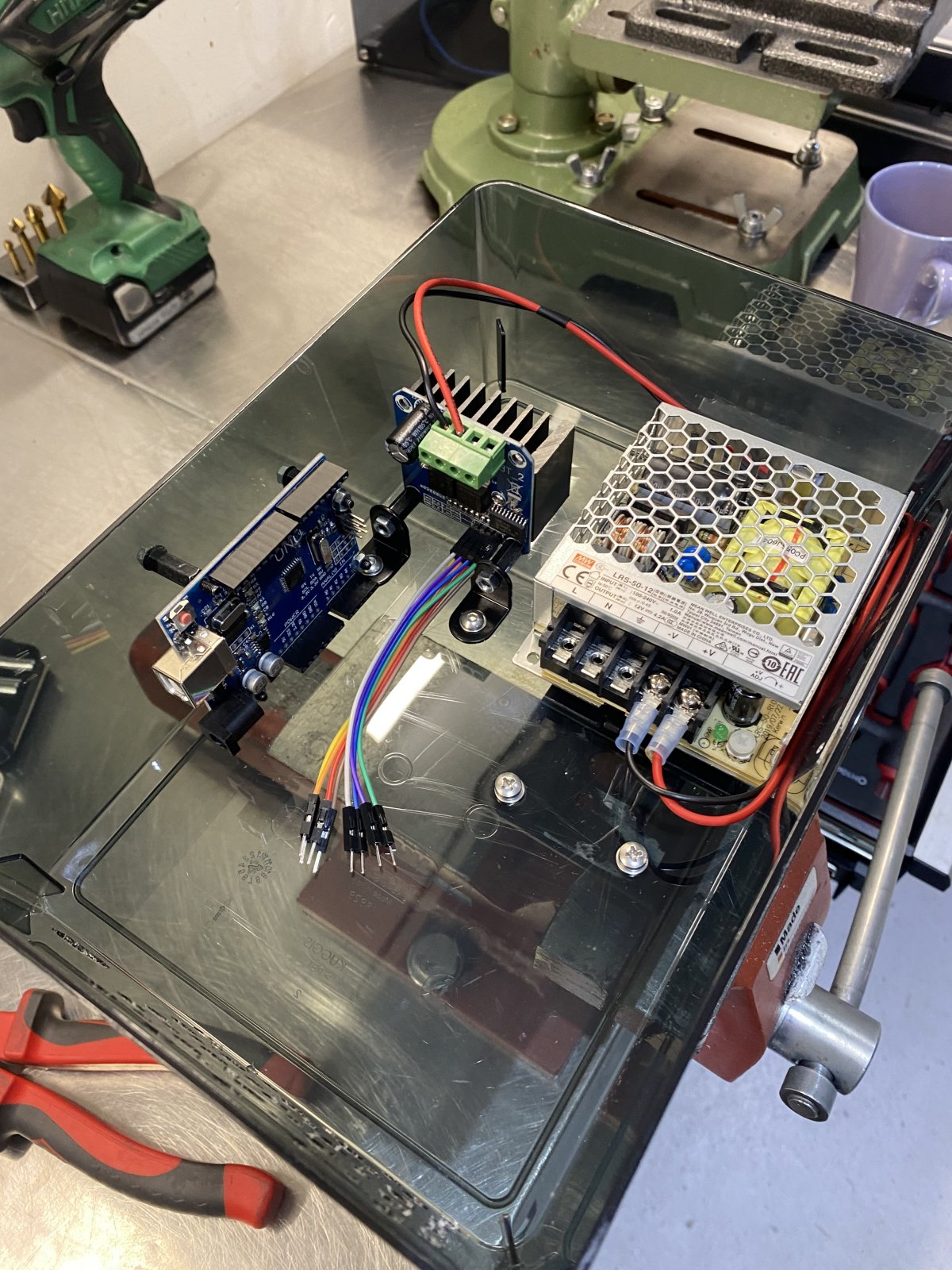

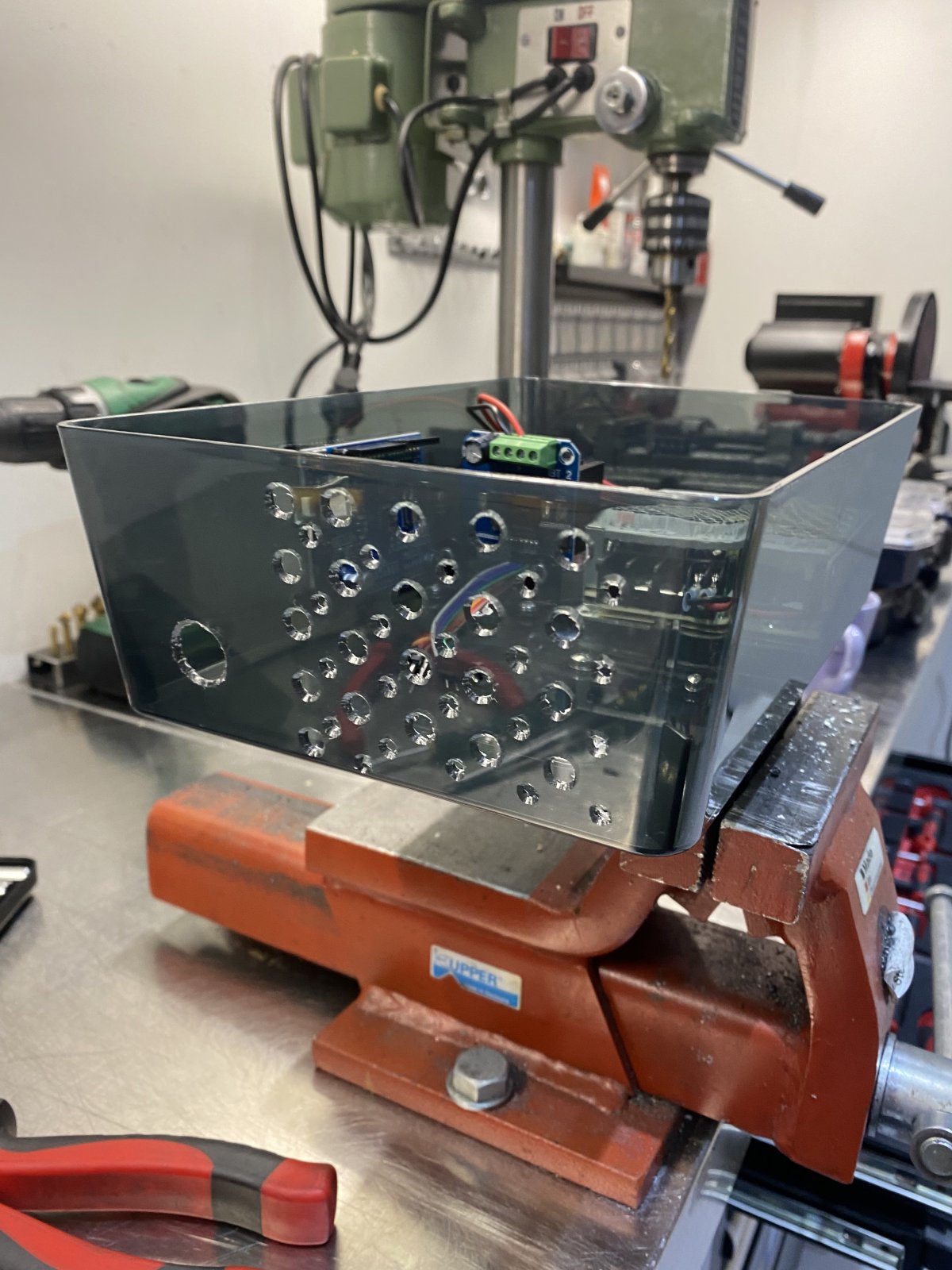

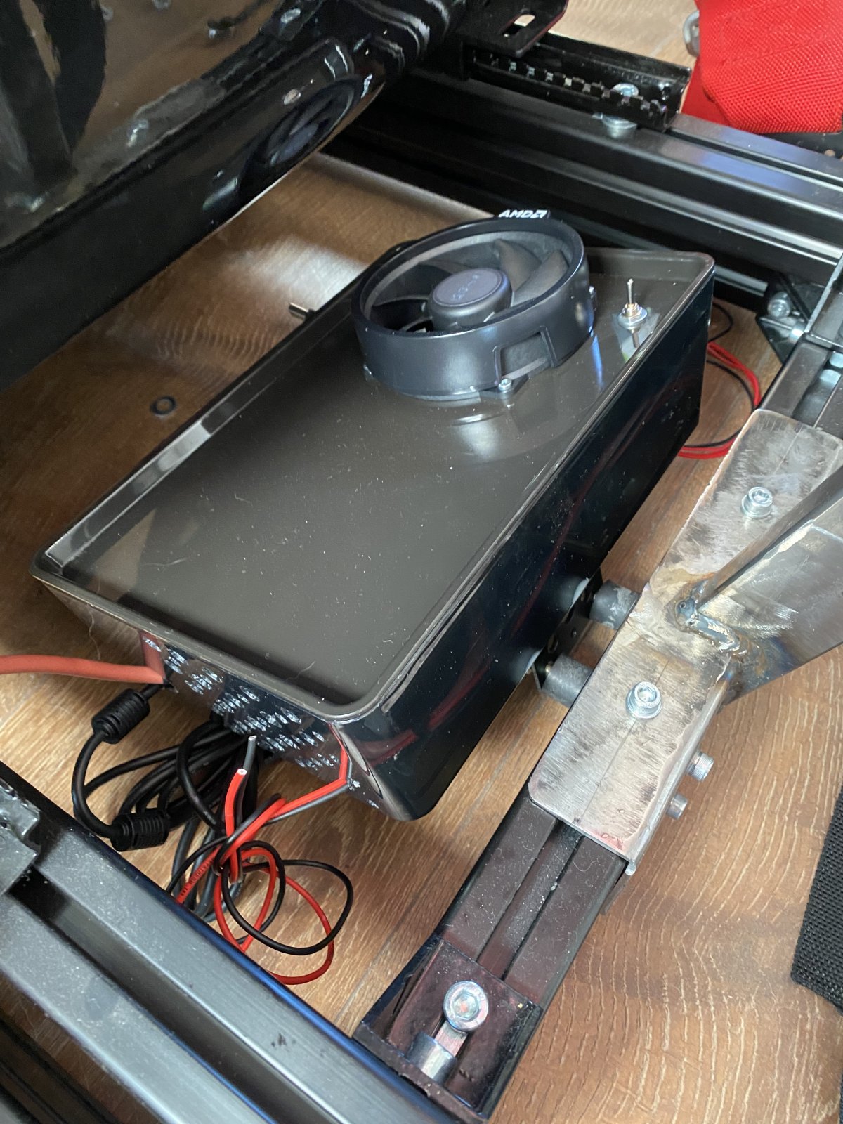

  11. psmooky2
    psmooky2 Member Gold Contributor
    Nov 3, 2022
    44
    270Coins
    +22 / 0 / -0
    DC motor, Arduino
    Little update,
    I orderd ibt 2 motorcontroller and wipermotor.
    why? Because there is way more to Found About coding and wiring so i think Its an easyer route To start with motionsimulation.
    made a Nice electronics box today C6C723D7-13F9-49C2-9E22-61F44114DAE5.jpeg FD46A4B1-49AB-49DB-BAD0-004AE3144685.jpeg 4EC9648C-EB8C-4D2A-8F80-2D2C6F564D64.jpeg

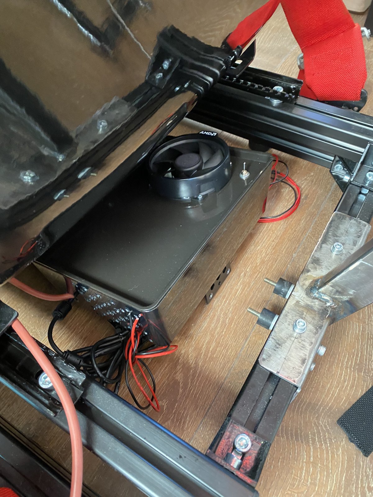

    608DA03D-678E-45E6-B1D4-B4A9347557B6.jpeg Made it possible to mount it underneat the chair D2F2B67D-E797-4478-A88D-86B9B9285EB1.jpeg
    the Wiper motor is on Its way do i hope I can do Some testing this evening.

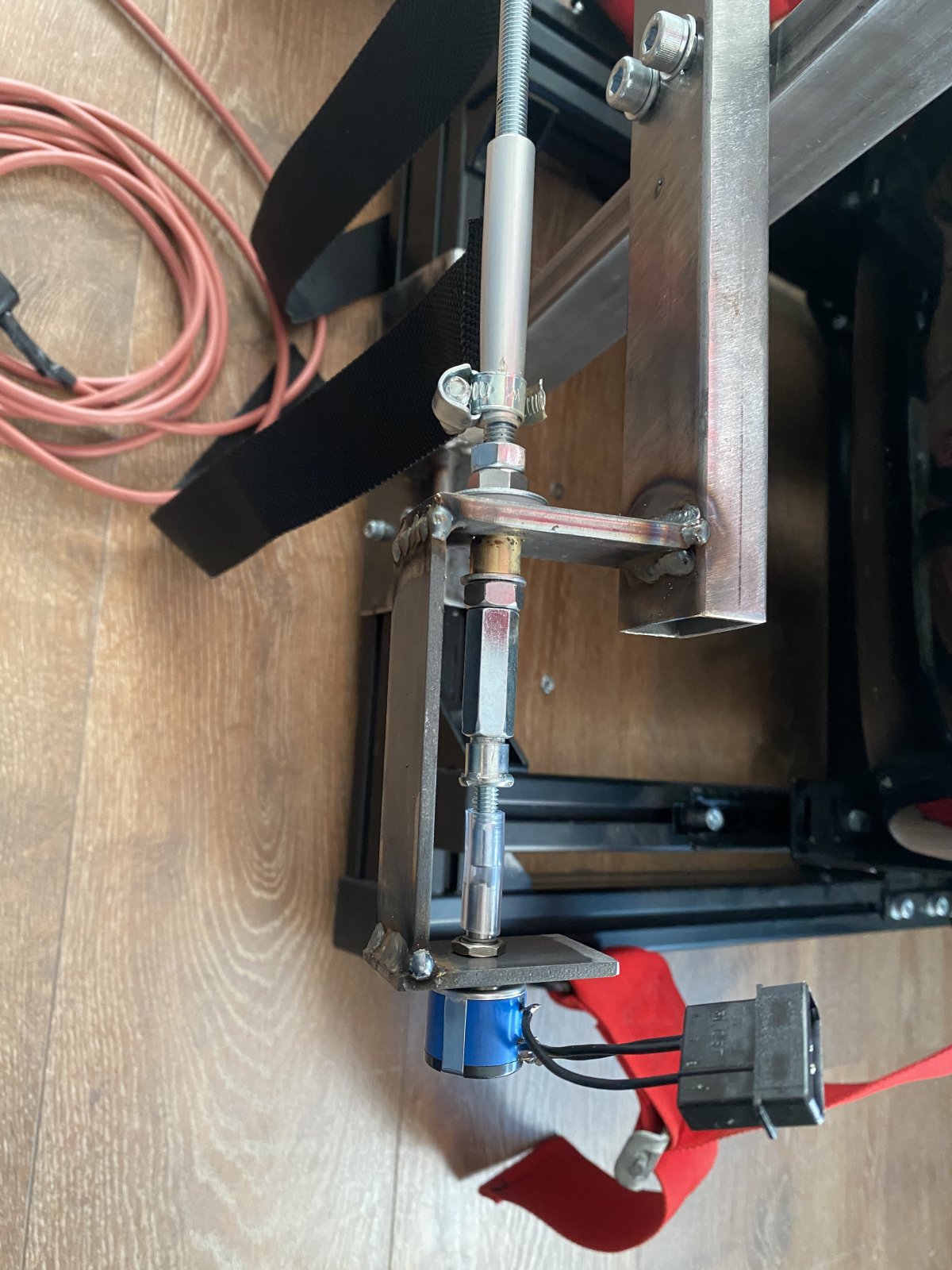

    Also Made a Bracket for mounting potentiometer D02D1F4F-9D73-45BD-AE6C-3A69FD06FF10.jpeg

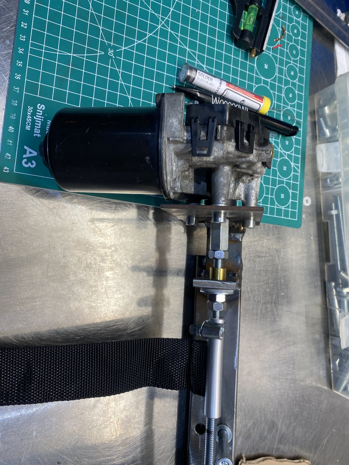

    Got the wipermotor installed only need To figure out the wiring and ground

  19. psmooky2
    Nov 3, 2022
    44
    270Coins
    +22 / 0 / -0
    DC motor, Arduino

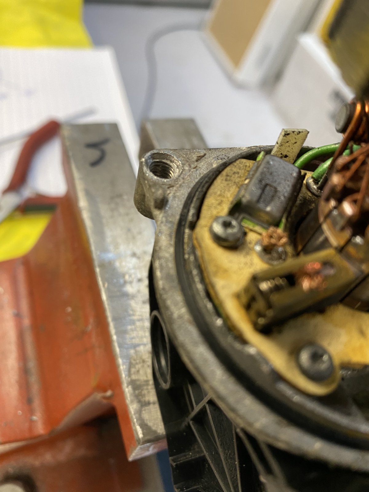

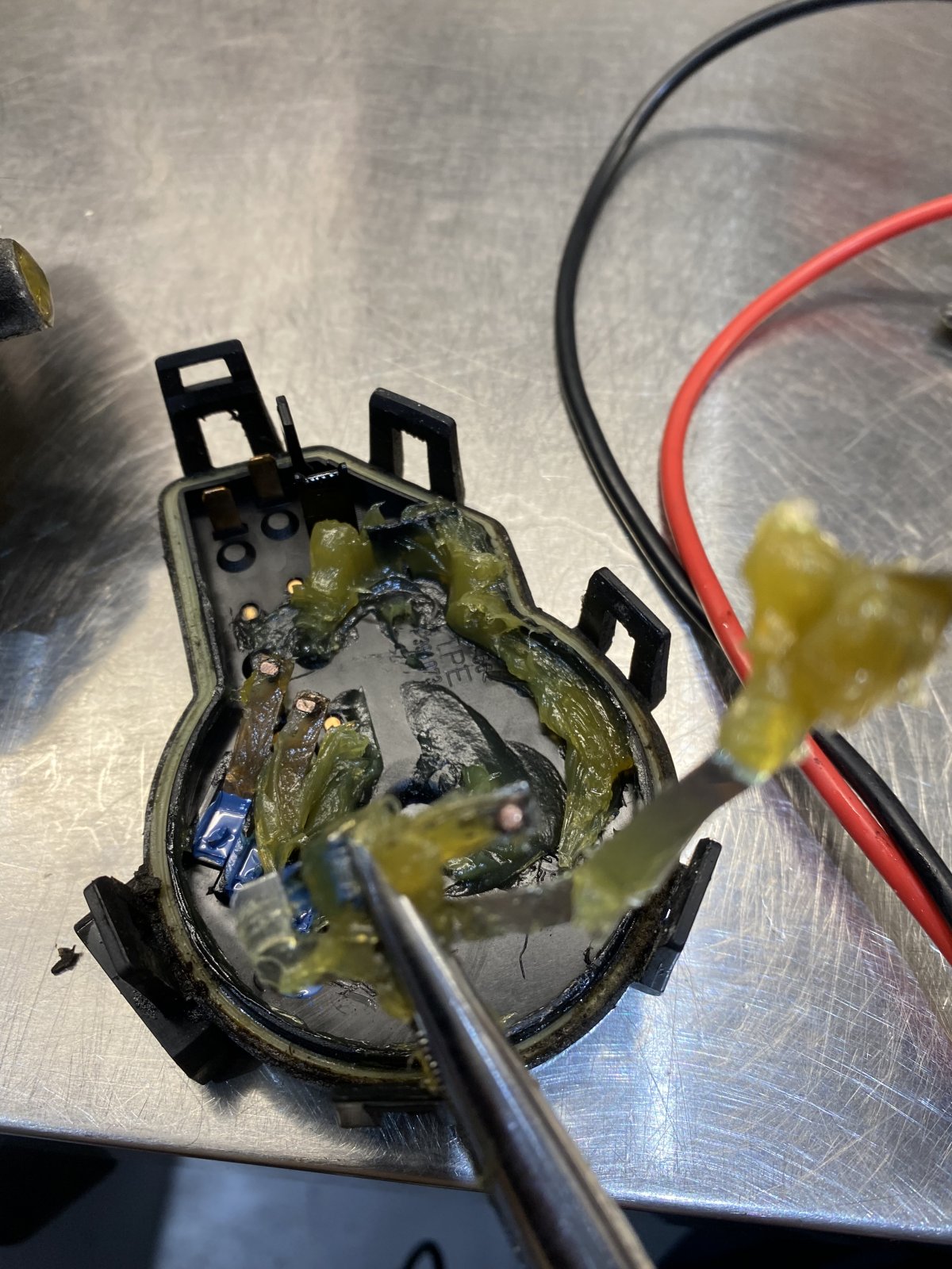

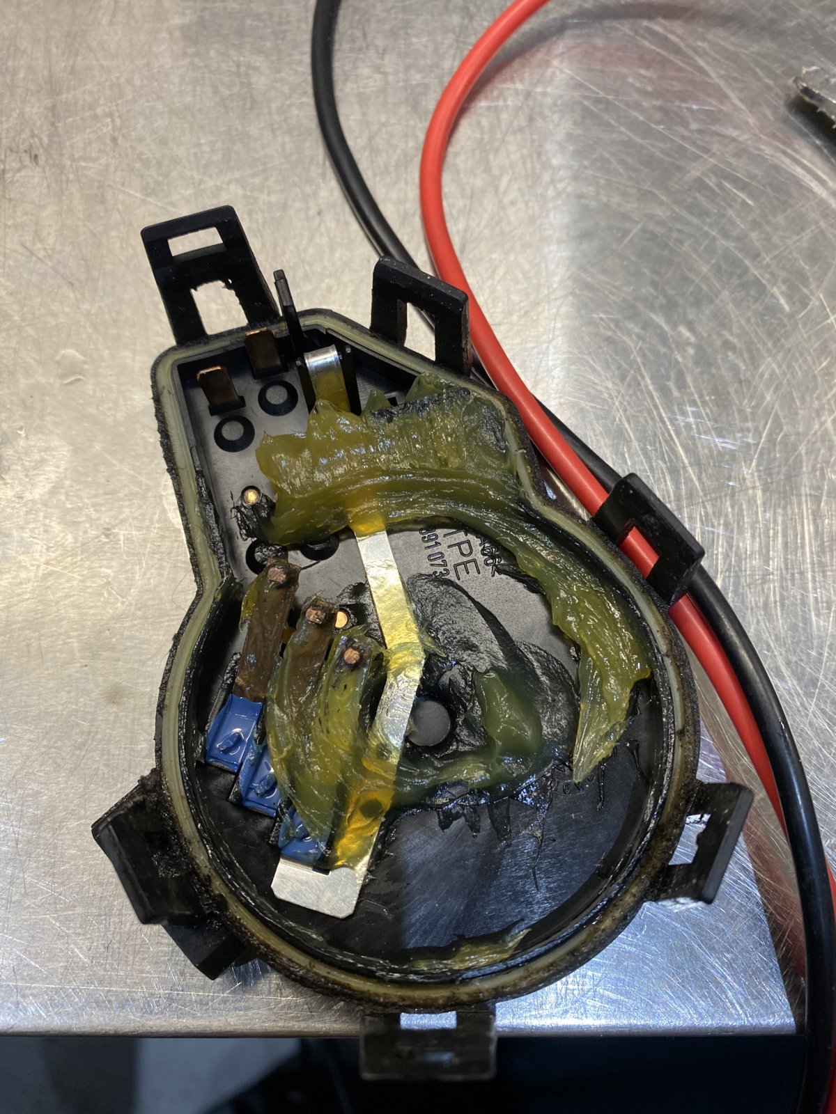

    Found it
    this is a vw polo 6n front Wiper motor
    remove the plate inside 1D229578-F87F-4E6F-8A74-77482AB28DC7.jpeg 6576E323-1229-42BF-A831-0CAB59847B77.jpeg then remove the cap and cut 1 wire the one with Some ground on the board dont do it like me i cut them al three so i had To solder 2 back 9CC74B71-A684-49FB-AA9D-C1C5A76F129B.jpeg i already cut it here CFF595A0-7AF1-486D-B7D0-03AD44E40F5F.jpeg
  20. psmooky2
    Nov 3, 2022
    44
    270Coins
    +22 / 0 / -0
    DC motor, Arduino
    i got it run in smc3 but the motor wil keep turning one way and stalls
