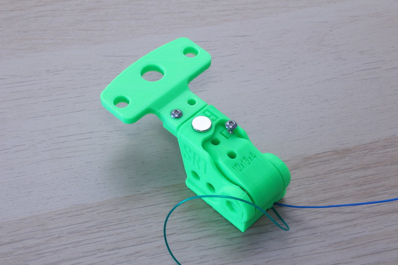

    I am mostly making these pedals a bit more fancy. But I won't release a new version soon. I am waiting for feedback from users to improve them :)
    Beside of this, I am working on my other projets. I will release my paddle shifters tomorrow :)

    That's great to hear, I did want to make them look a little more fancy, I still need a rig to place them on but the second I do I'm definitely printing this off.
    What kind of shifters are these? I'm guessing your using magnetic shifter for a better feel

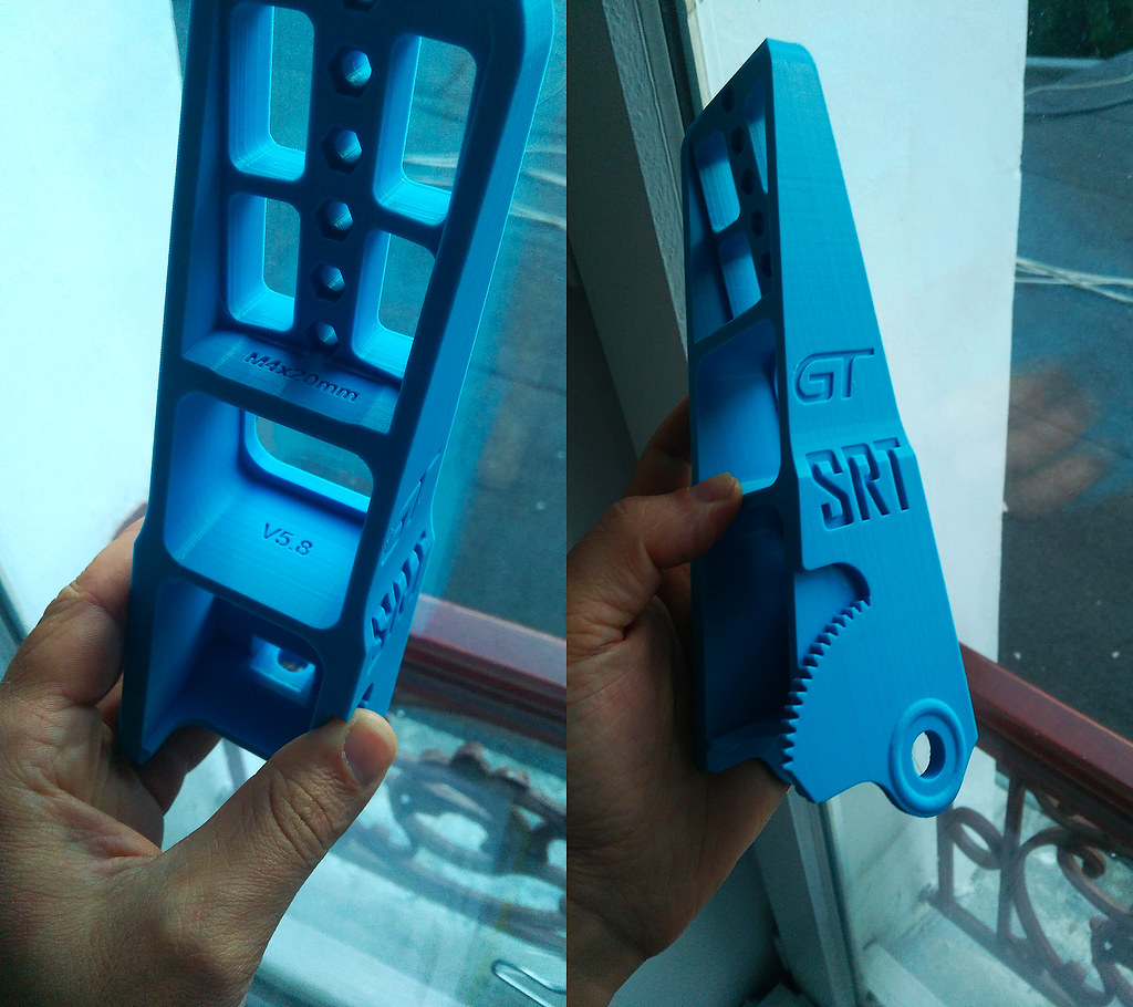

    Do any people still prefer metal pedals ?
  7. Sieben
    Sieben Active Member
    Nov 6, 2018
    395
    2,241Coins
    +115 / 2 / -0
  8. HCR Mad Bull
    HCR Mad Bull Member
    Jan 15, 2020
    57
    439Coins
    +12 / 1 / -0
    DC motor, AC motor
    Wow that pedal looks amazing! Really nicely done. I'll definitely print this once I've fixed my printer

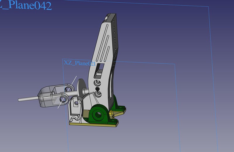

    I will now add a completly new accelerator model :
    It's a more common design, based on a compression spring (instead of a torsion spring). It will be immediately adapted into a clutch pedal. It will be a bit more expensive due to the add of 3 bearings.
    To make things clearer, the old pedal model (with torsion spring) will be named " GT" (I am still working on it). The brake pedal and new accelerator pedal will be named "P1" (because you are sure to be the first with this pedals, isn't it ?).

    you have an almost perfect hydraulic system mounted. I say almost perfect because you would only need to emulate the ABS by pulsations and no. the typical motor vibrates behind the brake pedal
  11. 7HUND3R
    7HUND3R Active Member
    May 25, 2020
    154
    1,159Coins
    +41 / 1 / -0
    the truth is that I like more that it has the soft part. then it gets tough at the end of the ride. I have always driven cars.

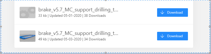

    Please take "brake_v5.7_MC__support_Heavy_Duty_M6" or "brake_v5.7_MC__support_Heavy_Duty_wood". The two other ones will be discontinued.
    "M6 "if you will use M6 screws to fix the pedal to your rig.
    "Wood" if you will use wood screws to fix the pedal to your rig.
    New version = new thingiverse page.
    But I always put a link to the newer version on the older page.
  15. 7HUND3R
    May 25, 2020
    154
    1,159Coins
    +41 / 1 / -0
    I have doubts with this piece, which of the 2 do I have to print?
  16. Lebois
    Dec 10, 2018
    353
    Math teacher
    2,567Coins
    +210 / 3 / -0
    The second one. I just removed the first one, it's not needed anymore. It's just there to help you to drill your support if you need so !
