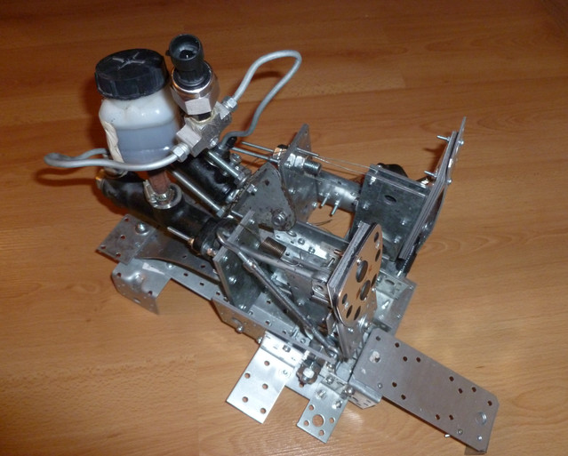

    Hello.
    This is the first variant of the pedals being build.
    Then made it on the real pedal block. Get rid of the slave working cylinder for brake, just a direct connection to the pressure sensor. Clutch with hall sensor in the working cylinder. Throttle with wire and a POT.
    [​IMG] [​IMG] [​IMG] [​IMG] [​IMG] [​IMG] [​IMG] [​IMG] [​IMG]

    Update, update, update [​IMG]
    Brake "set up" applied pressure - 40kg. Sensor itself is on 70 kg.

    I see in the video that the brake pedal has barely traveled. The truth is that I prefer that the brake pedal has a lot of travel.
  6. Sieben
    Sieben Active Member
    Nov 6, 2018
    391
    2,216Coins
    +115 / 2 / -0
    For what?
  7. 7HUND3R
    7HUND3R Active Member
    May 25, 2020
    154
    1,159Coins
    +41 / 0 / -0
    Because when I touch the brake I like to have a route, because if it doesn't have it it seems that I'm not stepping on anything.
  8. Sieben
    Nov 6, 2018
    391
    2,216Coins
    +115 / 2 / -0
    Ok I see. Yes, tastes differ then anyway) I like this move on brake, so that's ok too. Anyway it all can be set with working cylinder etc.
