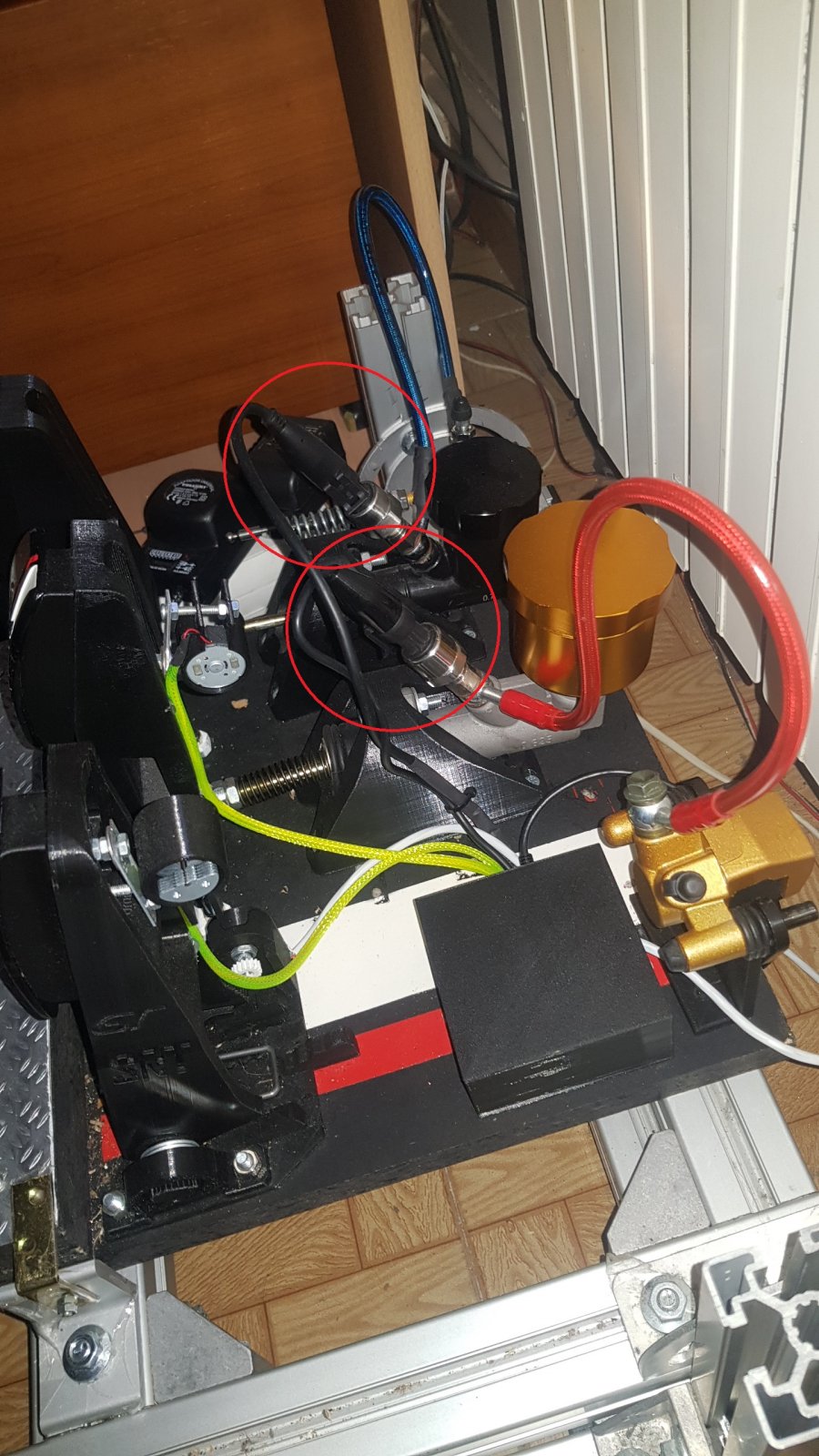

    I attach an image of the pedals. Where I mark a red circle are the pressure sensors. They are bought on aliexpress. The clutch is 500 psi and the brake is 300 psi. I put them at random, actually it would be better to put the 500 on the brake.

    7HUND3R
    Good.
    They have pretty big multipliers of applied force. With an ordinary pedal, it will be like using "brake booster", with 1000 psi sensor. But works too. So if will made up your mind to take a bigger one, like 1500 + it will be ok, for that pedal sets.
    But I switched from ordinary pedals, so that now using 40-45kg of applied force on max, with 70 kg sensor (1000 psi) with this build. By having a direct push on the master cylinder with that pedals.
    Hydraulic pedals DIY

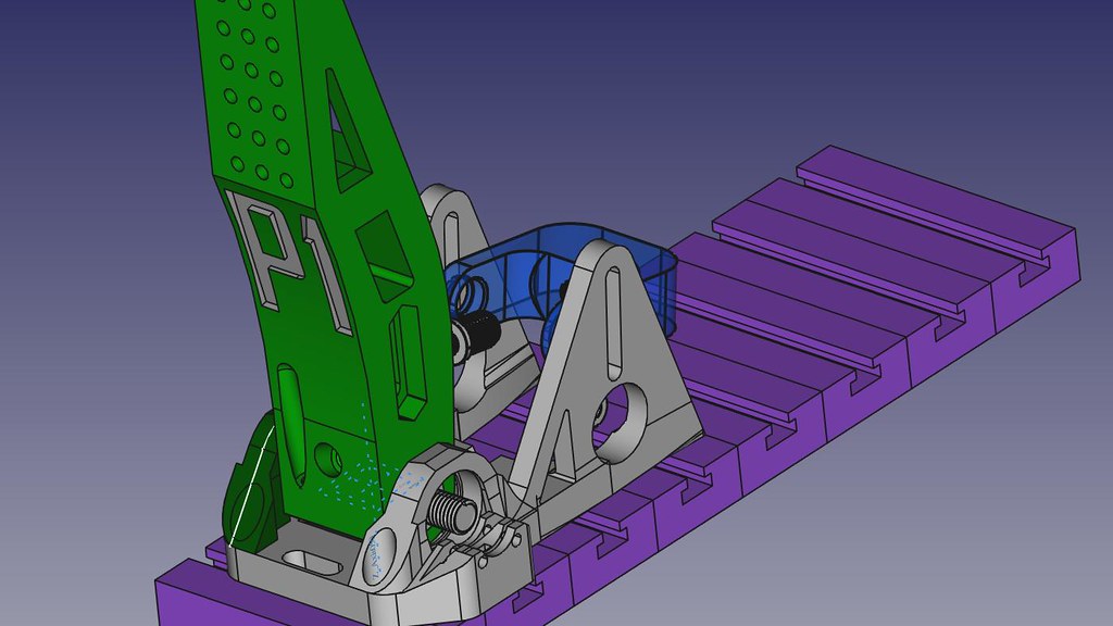

    Still working a bit on the throttle p1.
    It now gets three different positions on top of few refinements.
