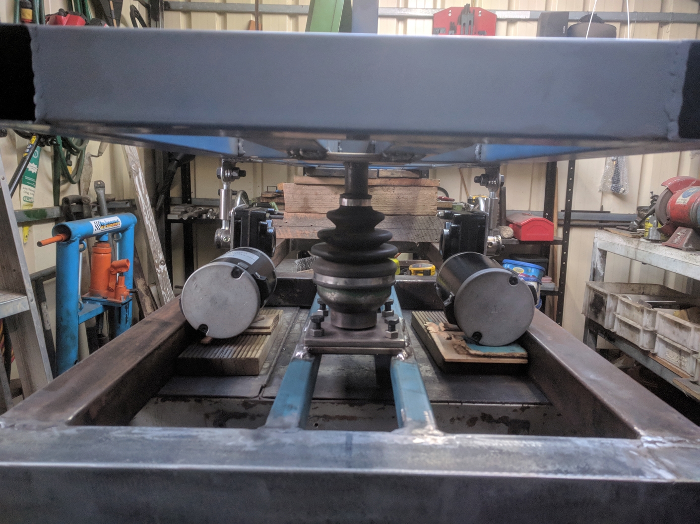

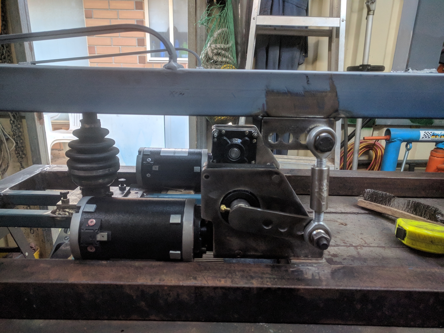

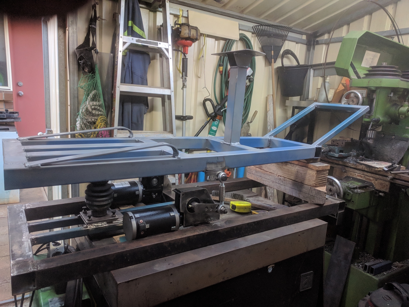

    Most of the problem was my own doing, centered on my motor location.
    So when it went over center the rig jammed hard on the motor mount, plus the gears do cop a bashing with their inherent backlash and the quick reversing of rotation
    just takes it toll on the bronze spur gear.
    I can't remember if the teeth on the spur gear are straight or angled which would determine how you might rotate or reverse the gear to use the undamaged section or you might have to cut a new keyway
    on the shaft or gear which is doable as I have a lathe and mill.
    The more heavy duty gearboxes are about $120 AUD each, which is about $1.50 USD :( and worth doing if it lives longer.
    I extended the motor output lever to clear the bottom base frame but it still jammed nose down and over to one side which is why it bottomed out on the mount.
    remember this was designed on the fly and revisions were decided on during sleep. So no CAD involved or 3D modelling.

    Ahhhh yes, that's right, yours is a full-frame mover.
    I forgot about the nose bottoming out onto the floor if you were to go past center or have a runaway motor. :(
    Mine's just a simple 2dof seat-mover style, which if such a situation were to arise it'd just break a pot and/or feel like I was sitting on a bucking Bronco until I hit the emergency shutdown switch.
    I guess you could eliminate your issue if you were to put the entire rig onto a riser, or weld on some legs with enough floor clearance.

    To gain enough clearance for over rotation events I would need to raise the top frame by about 50mm or so which would make it a lot more unstable with a higher COG.

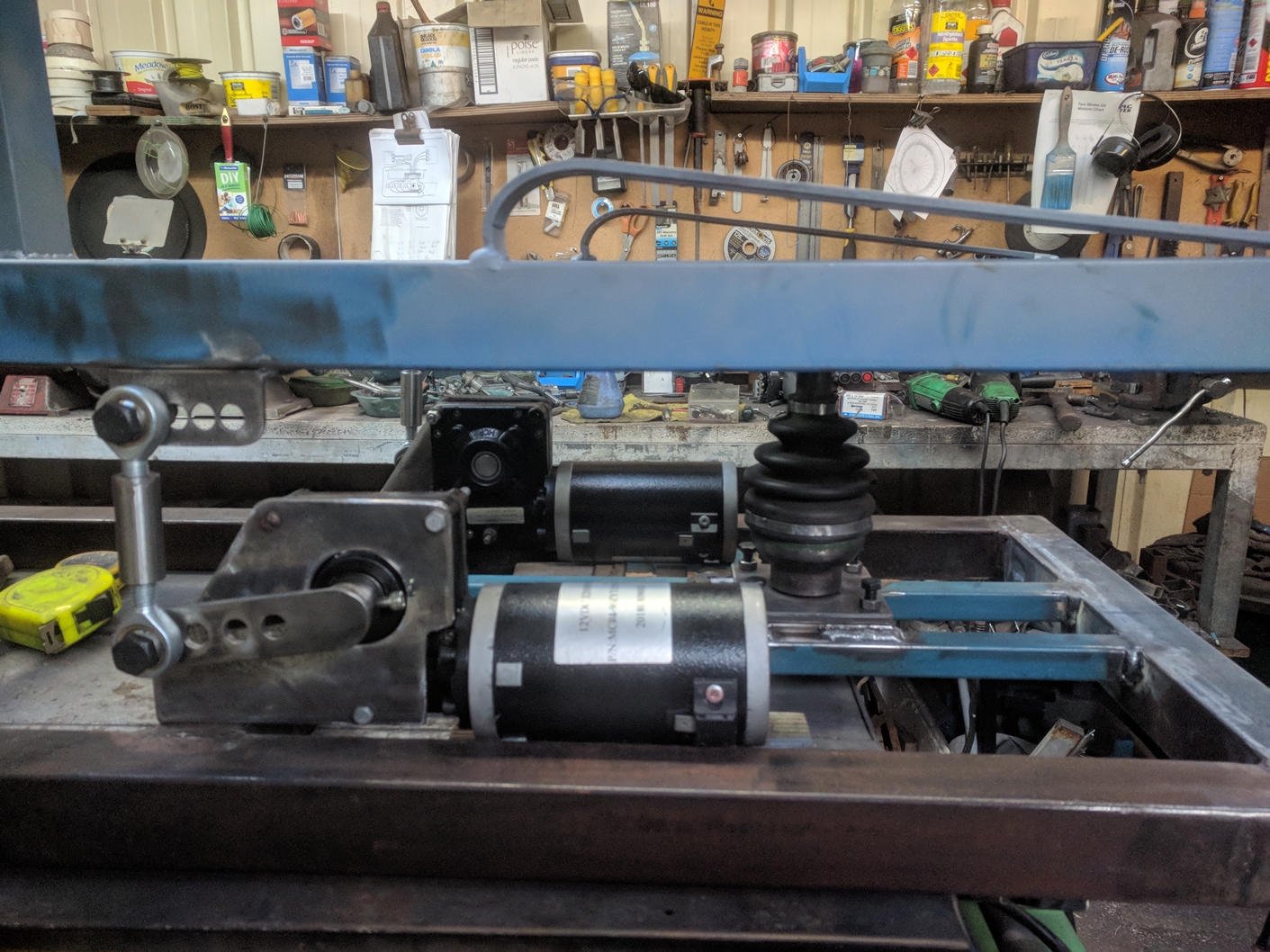

    I installed the new gearbox and replaced my rubber fuel hose connectors between the pots and the motors with some proper ally flexible anti backlash connectors
    which seems to have fixed most of my problems, touch wood.

    It's been a while but when I ordered my motors I opted for 50:1 gearboxes and from memory they did have a keyway cut I think or I may have cut it myself on my mill
    I know that I used some heavy wall tube and drilled and tapped those holes for lock screws, one of which registered on the keyway and the other for extra security.
    Then of course those were welded to my levers which started out at about 100mm. long with multiple mount holes spaced along the length, but I ended up cutting them down
    to about 75 mm. as that had ample power.
    You just have to think about your next moves when building it and CAD is fine for theorizing something but doing it in real life usually presents you with all the hidden little faults
    that the computer model might not show which is no different to a set of old school blue print drawings.
