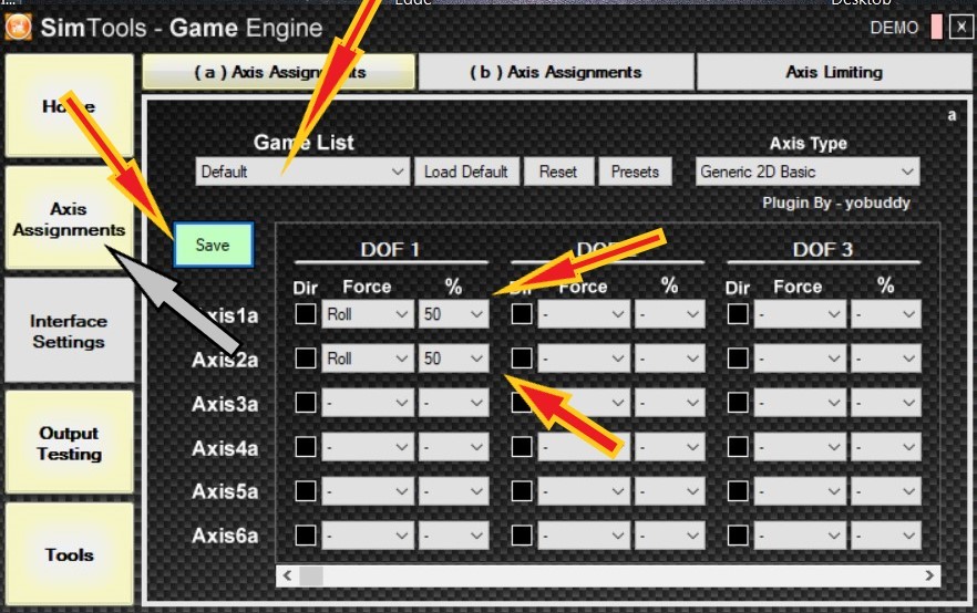

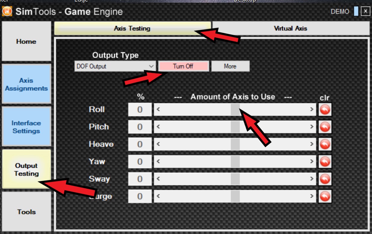

    If you go to game engine..
    Axis assignments.
    Select default..
    Enter the 50% Roll on DOF1
    Then SAVE...
    Then Output Testing....
    Then Turn On...
    And then slide the slider left and right what does your rig do???

    When i tried that yesterday with Markus B's instructions I got zip, nada, or simply SFA
    That was the frustration after it all moved in SMC manually and sine modes etc

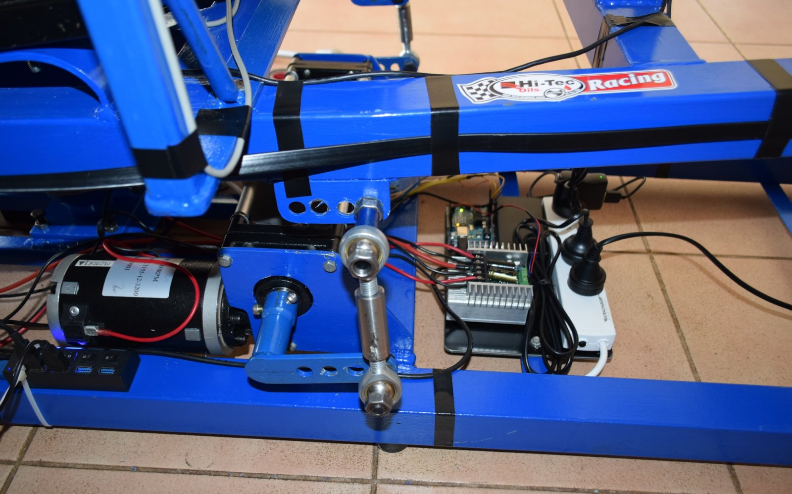

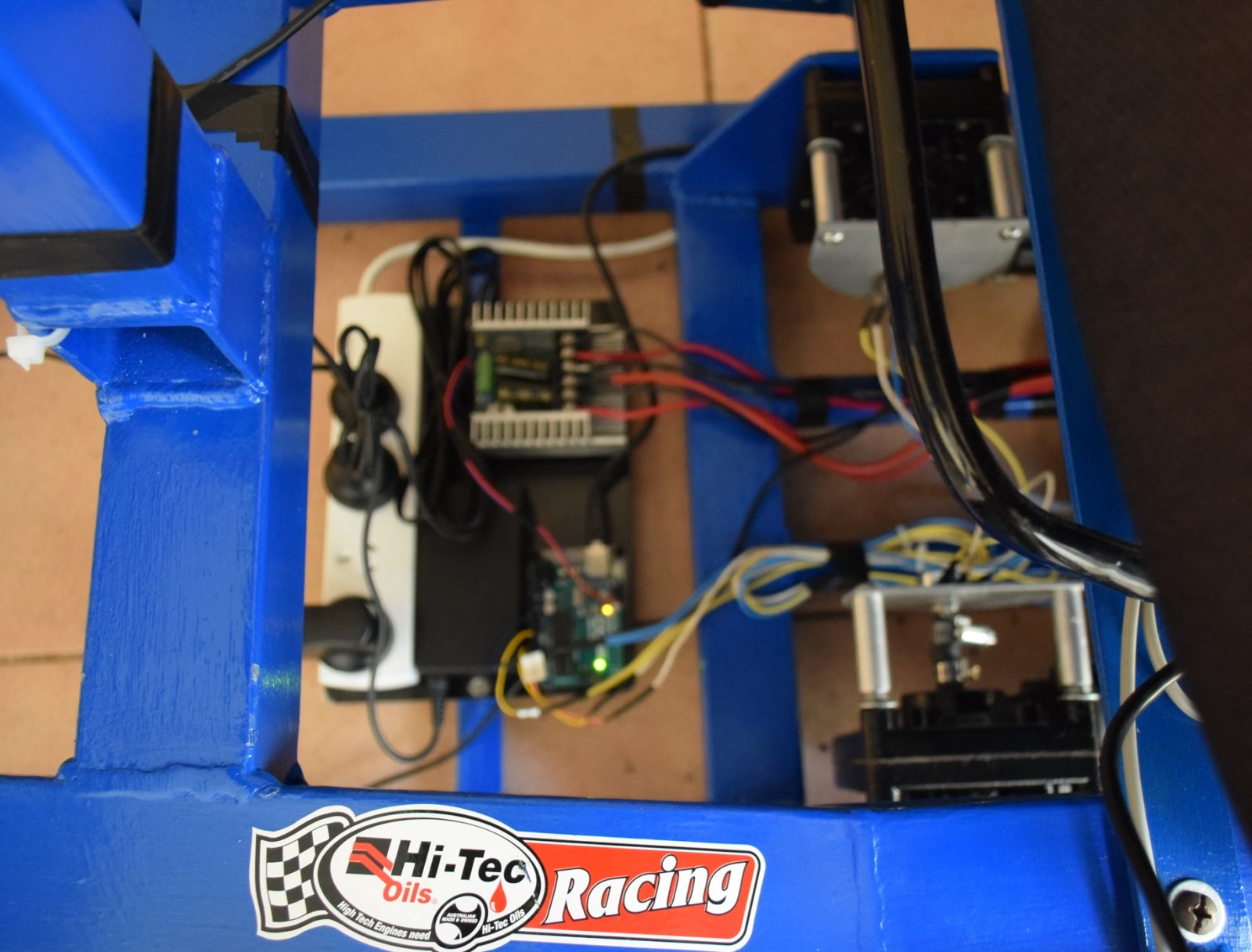

    When I was playing around last night I had the levers connected and the rig bottomed out and hit the plastic container holding the elctrickery bits and pieces
    so the motors could not go beyond bottom dead center and return on the up stroke.
    So today I have moved all the elctrickery bits and pieces further back out of that container and I moved the rig's balance point back to it's original position
    which should limit it's mechanical limit of movement.

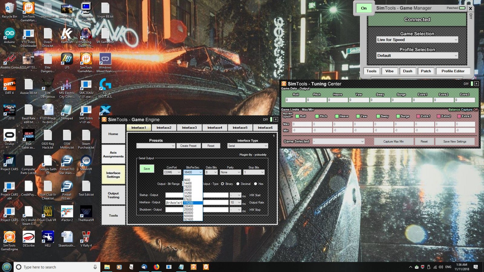

    I was just reading a different thread and ran across someone having similar issues with smc3 utilities working okay but not from simtools. They said reducing 500000 baud output to 250000 solved it for them. You will have to change Serial.begin (500000); to 250000 in the sketch too to try it. If it still doesn't work try 125000 also. Good luck.

    BlazinH so just change the sketch to those values even though the old 2X25 is baud rate set to 38400
    Or that to do with Simtools comms as that is what appears to be happening.
    I have rearranged some stuff and re positioned back to the original balance point so I know have no obstruction to full motion when I tested it in SMC in sine mode and motion mode and manual it all moves freely, so it has to be a comms problem with the Arduino as you know already.

    It doesn't have anything to do with sabertooth settings buddy just simtools to arduino. So in simtools change 500000 to 250000 and also in arduino sketch as I stated above.

    Well I just edited the sketch to 250000 to no effect, so I will try 12500 next, cross fingers :(

    The sketch and simtools mate! And utilities won't work after this change. You can only use Simtools output.

    I edited the sketch to 12500 and still no output, but I just read that you want it changed in Simtools too which I will try but when i look at the drop down menu in baud rate there is no 12500 option only 115200 ? So should I change the sketch to 115200 as well ?

    Yes that's good.

    Yippie Ki Yay that worked at the current 115200 in Sim tools

    Great. But you didn't try with both at 250000 did you? That would be better if it works too but don't go back to what didnt (500000). Just keep in mind if you need to use utilities for something again the sketch must be set back to 500000.

    Don't set anything back to 500000. Only if you need to use smc3 utilities which you shouldn't unless something else goes wrong. Try simtools at 250000 and sketch at 250000 (instead of 115200). It's like tuning a radio, the frequencies have to match or you don't here the station. If it works use it if not go back to 115200. :nerd

    I tried 250000 but it refused to move so I went back to 125000 and it moves.
