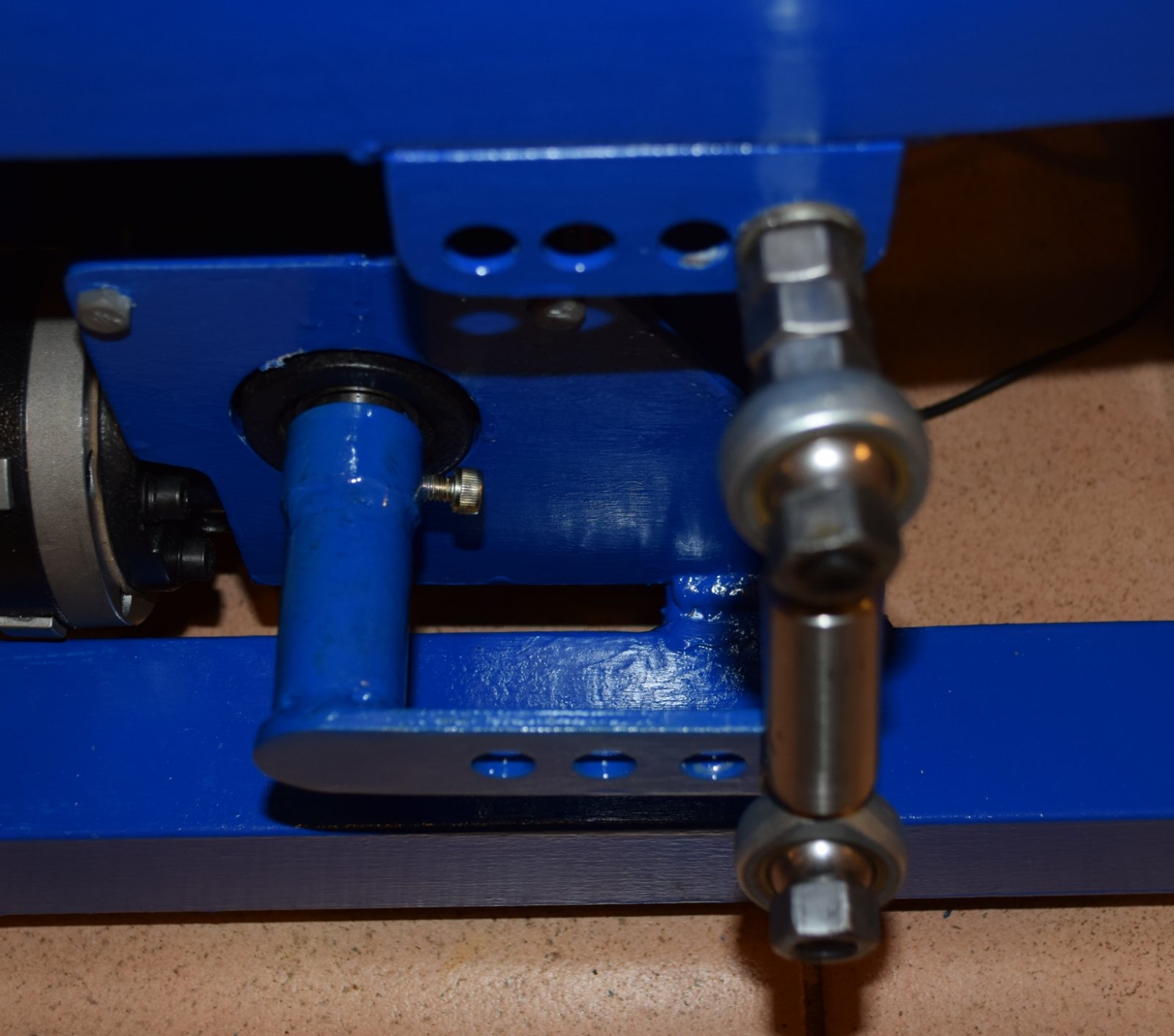

    Well I listen to what others say and I thought it advisable to extend my motors arms by 45mm. to give me some clearance if the arms travel too far down and possibly hit the frame.

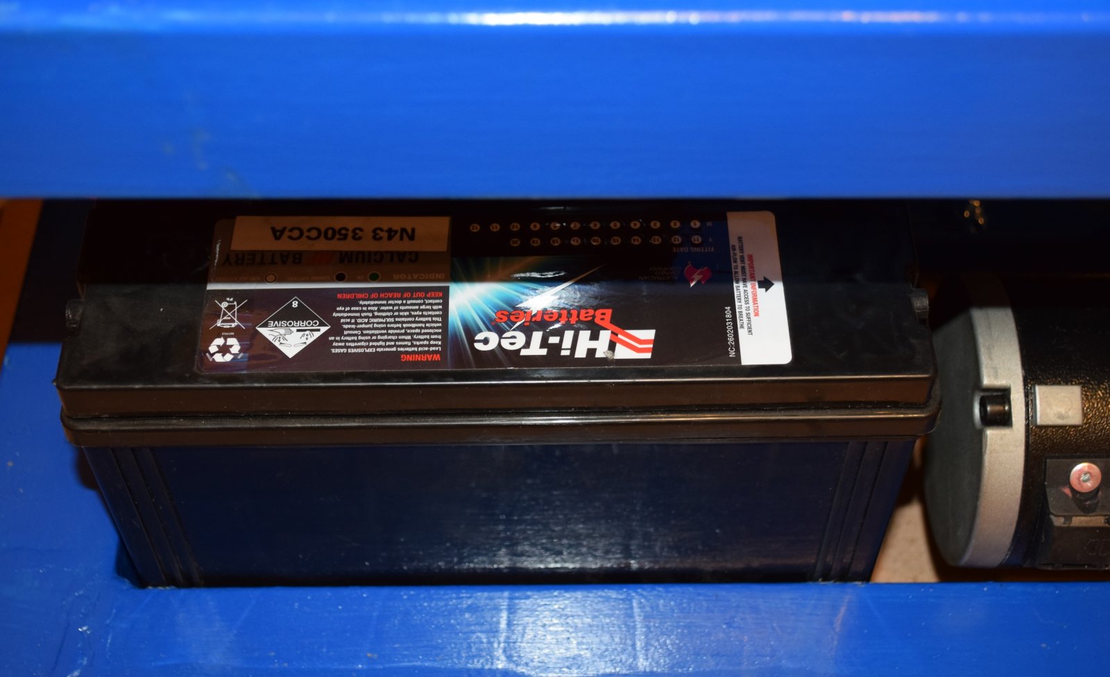

    A good friend came for a visit today and he bought me along a brand new Hi-tec 12V 350CCA battery for my supplementary power supply as suggested by the Sabertooth info ,
    My mate Paul is a manager for the Hi-tec Oils group and batteries are another line that they carry, so he came for a visit at an opportune time for me and he saved me some $$'s
    and the traveling to buy one.
    Just for the record I did pay for the battery but at a better than trade price.
    It pays to have good mates who can help you out when they can and Paul is one of those, I have known since we were both about 18, so 44 years roughly and we both worked in the same auto spare parts dealership and we have friends ever since.
    You can usually count the number of true friends that you have had in your lifetime on two hand s or less. I have many friends, but very few true friends.
    I need to extend the top mounts out a little to lessen the angle and eliminate any binding of the heim joints, so I will machine up some tapered spacers.

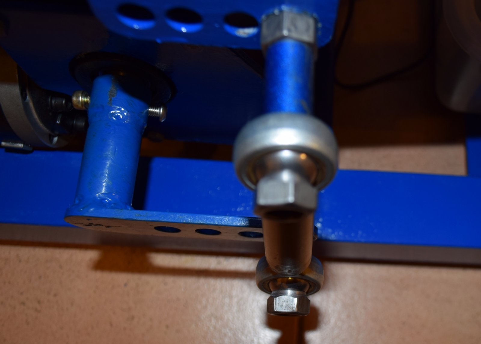

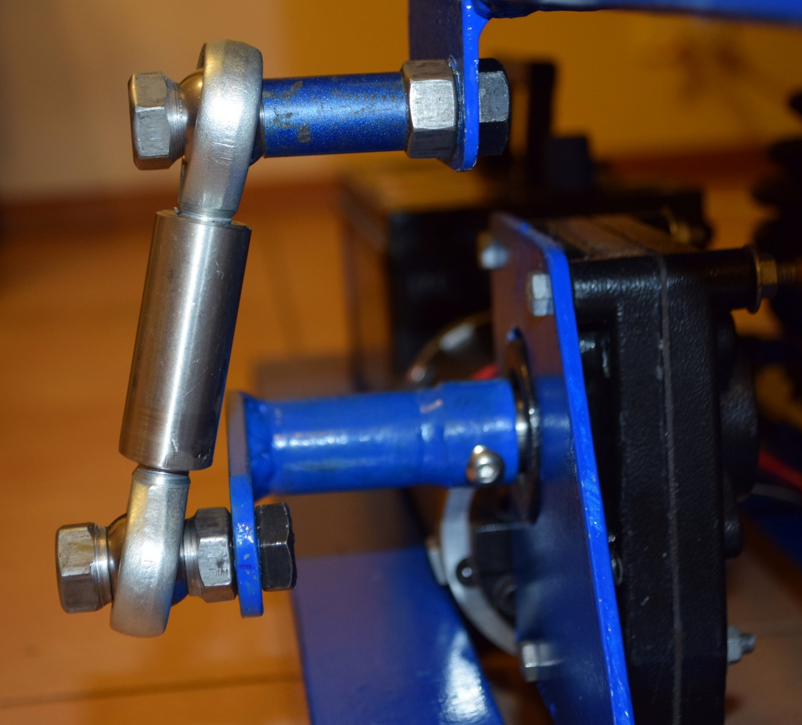

    First and foremost a big thank you for the developers of Simtools for granting me a free DIY license to use on my sim and that is a much appreciated saving for a true Budget DIY build.

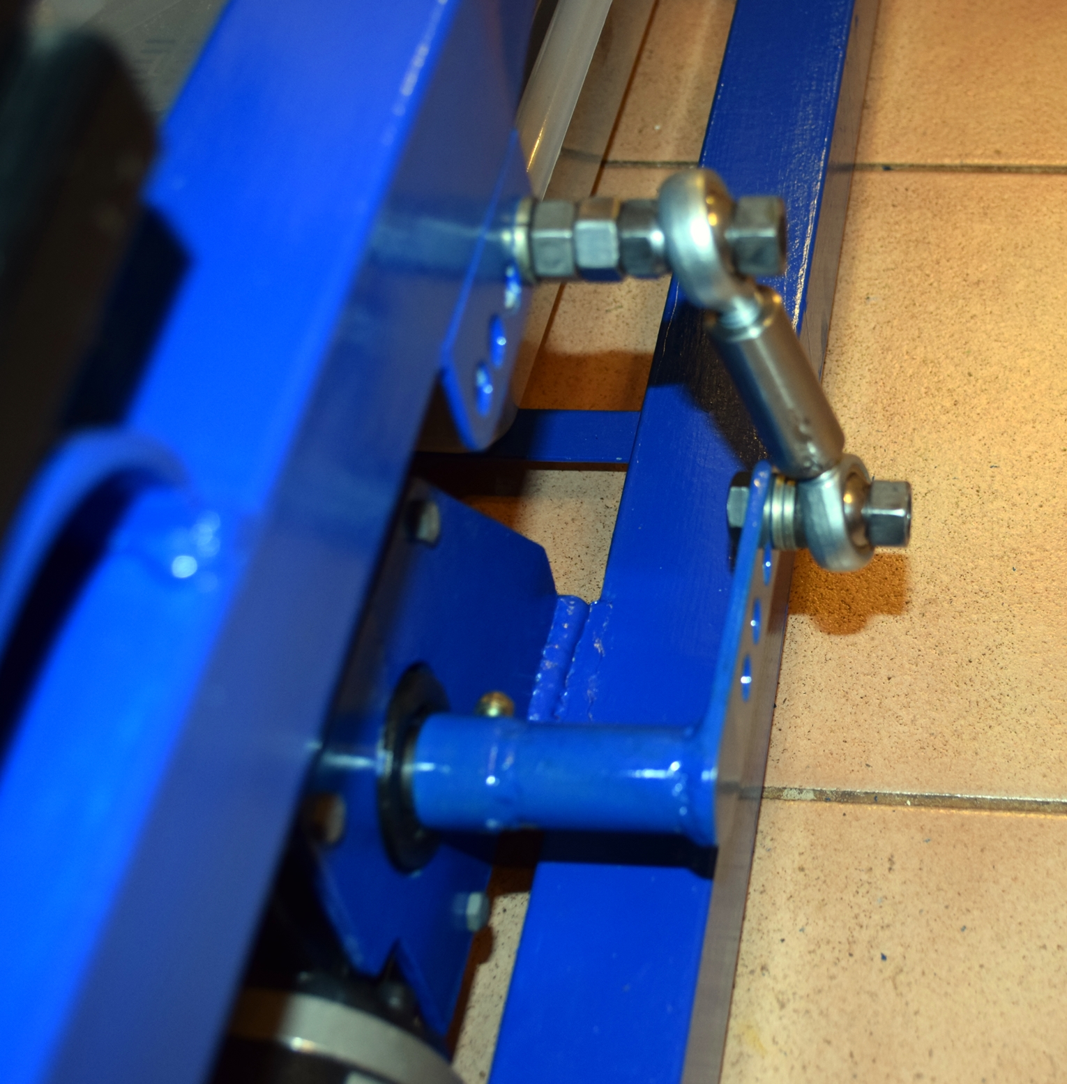

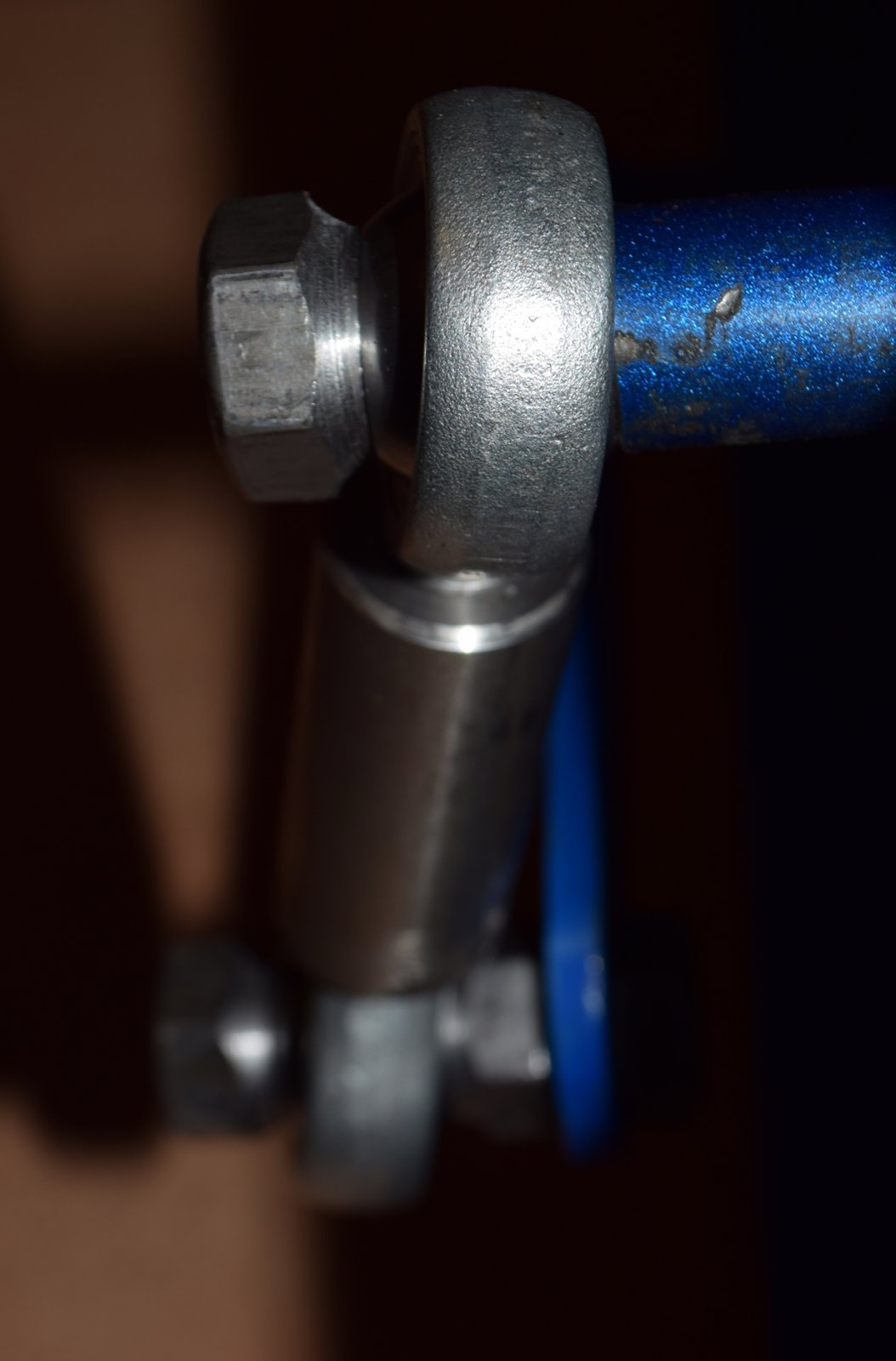

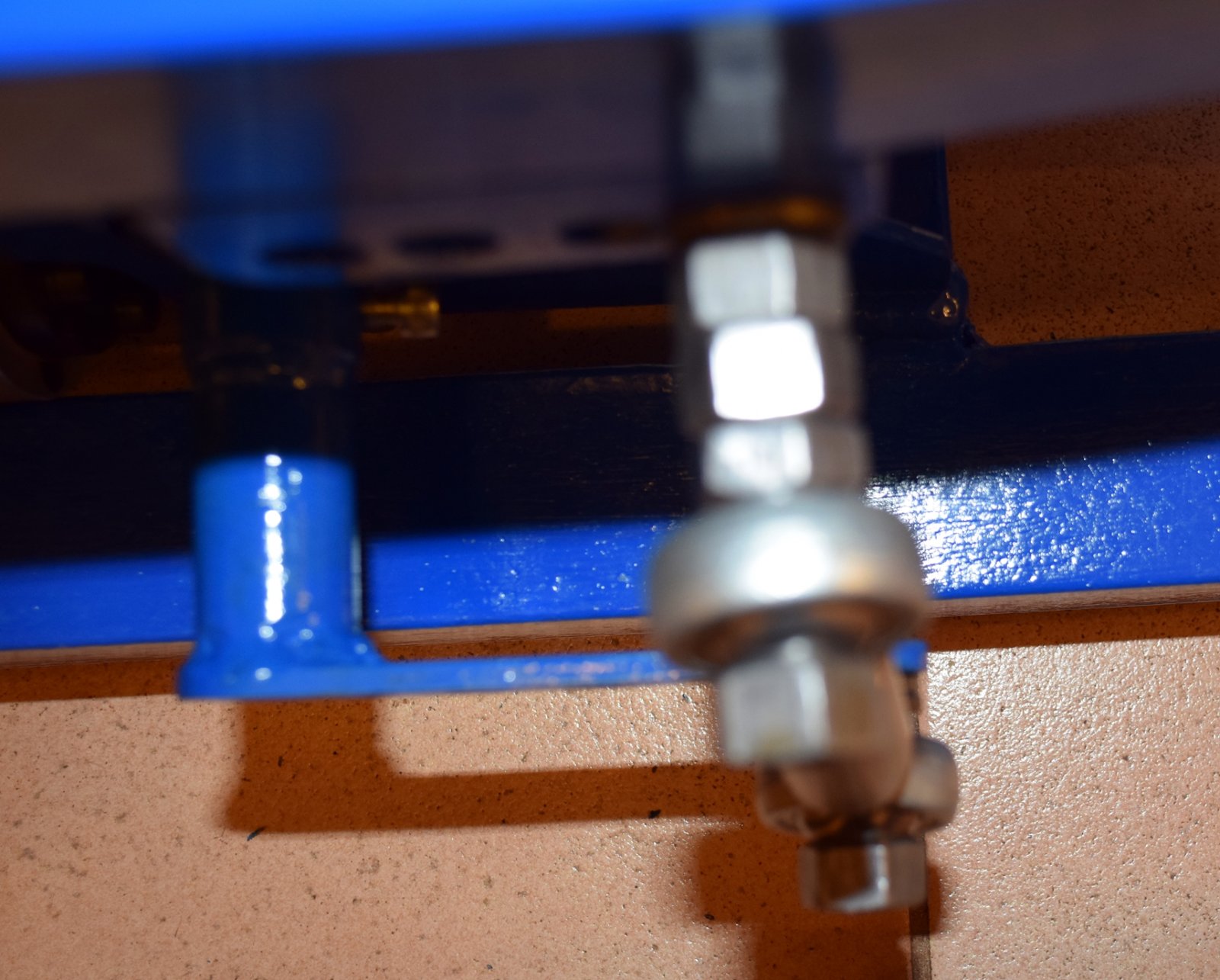

    OK, so still waiting for my farking pots to arrive so maybe tomorrow with any luck before the long weekend here in Oz .
    So I did a few mods to what I did yesterday by extending my motor levers outwards by 45 mm. to gain clearance from the base frame in case of an over-travel.
    I did away with the washers and multiple nuts and machined up some thick wall tube into spacers and also machining a nice concave radius on the lock nuts to
    minimize the heim joints going into bind which is something a lot of people overlook.

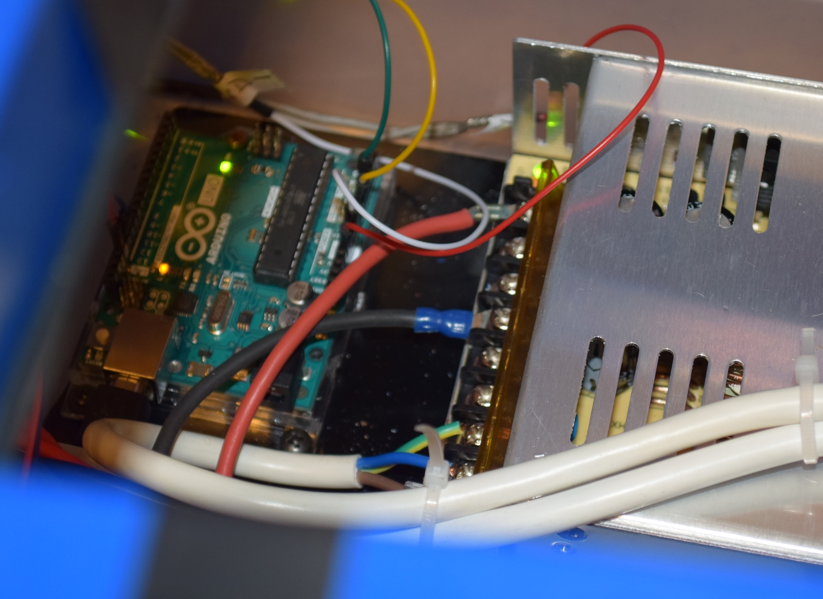

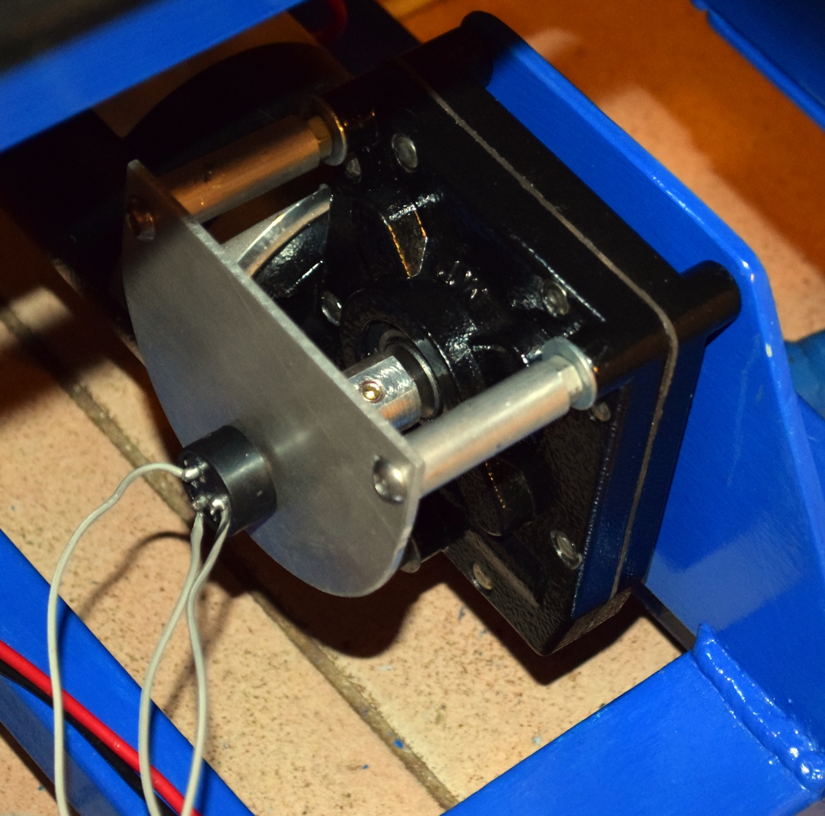

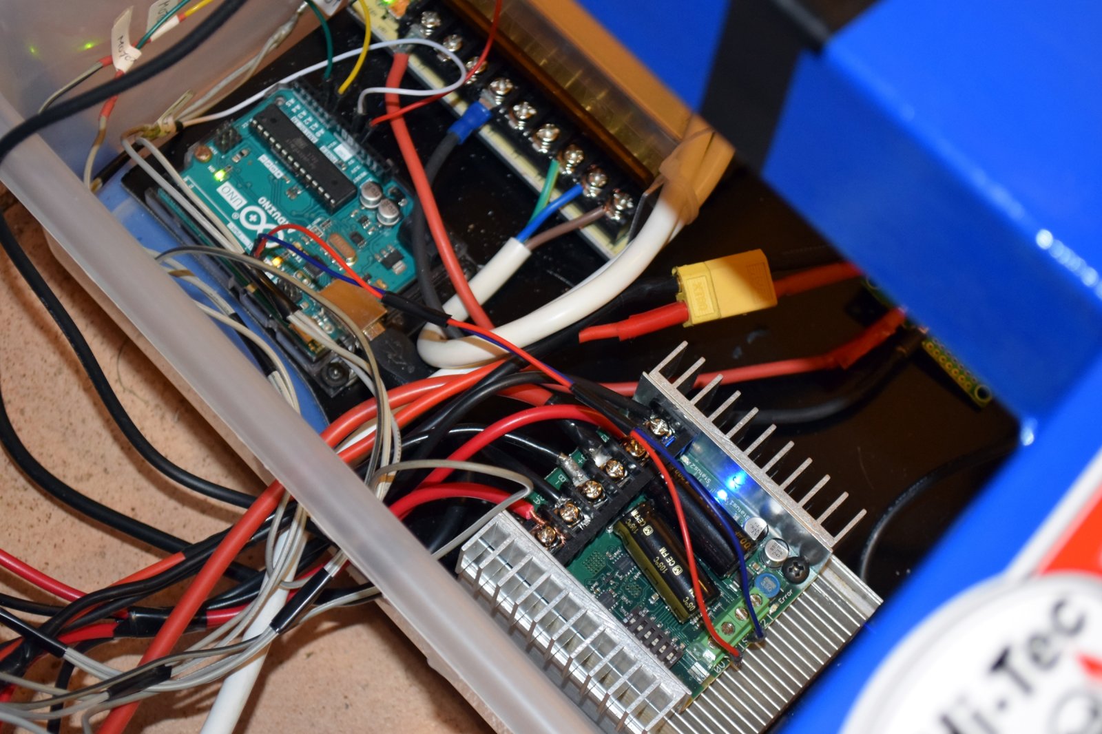

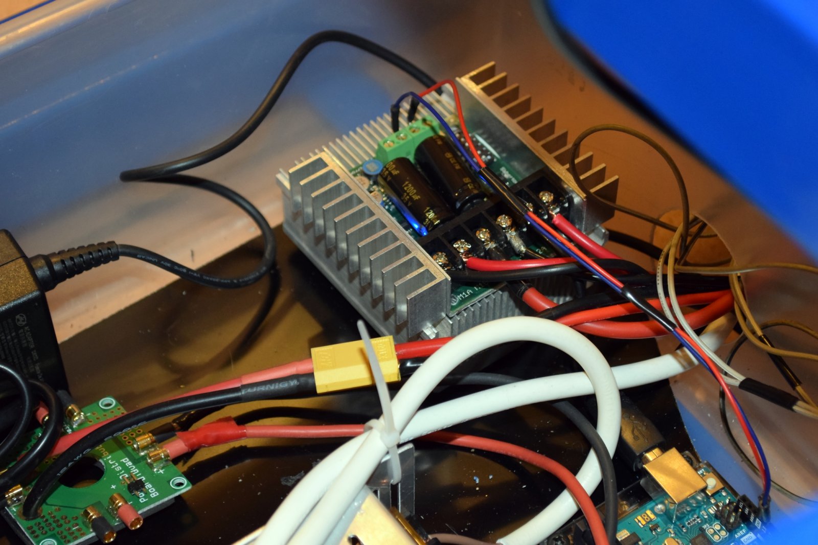

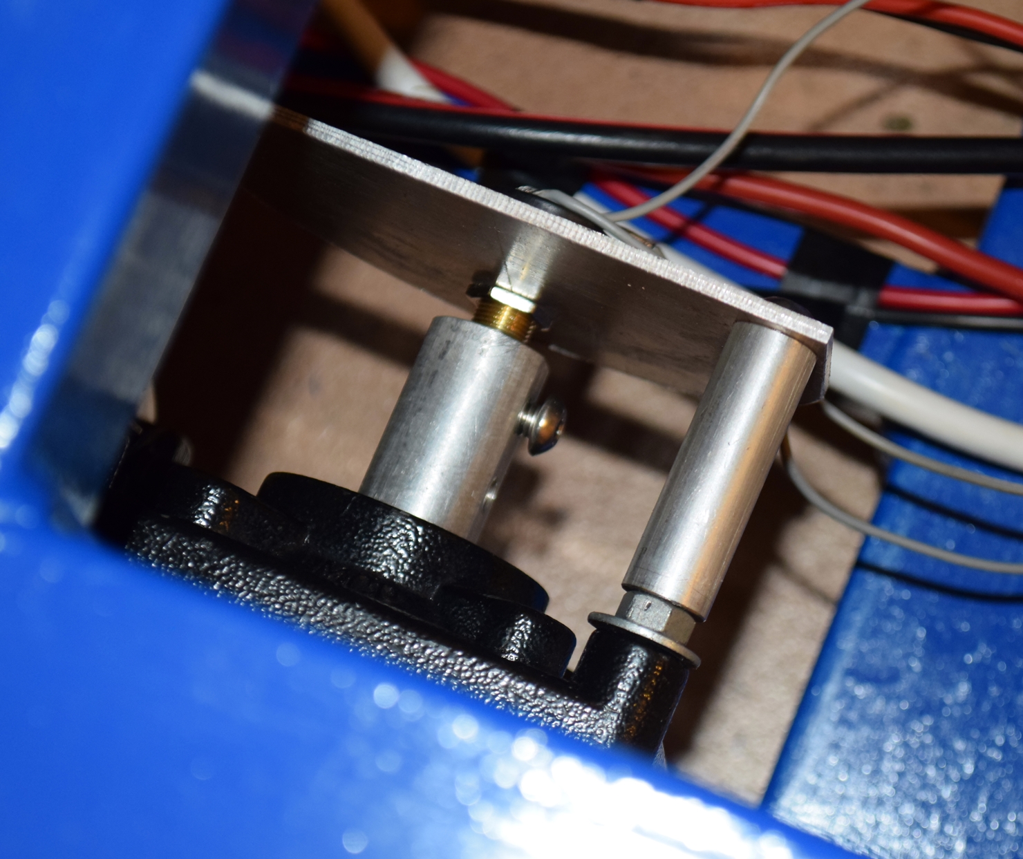

    My Hall Effects Pots finally arrived from the U.K. and I think they came on the first fleet they took a month FFS.
    Anyhow I made up some mounts and connectors and wired them up as per the instructions in the tutorial https://www.xsimulator.net/communit...ket-serial-pid-motor-driver-w-softstart.9277/
    And as I expected I have screwed up somewhere as I am getting SFA movement when I try setting it up in the Windows SMC3 Utility.
    So it looks like another day of starting from scratch to work out where I went wrong.
    My wiring is always a rat's nest so I will clean it up once it works :(
