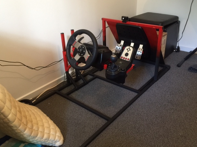

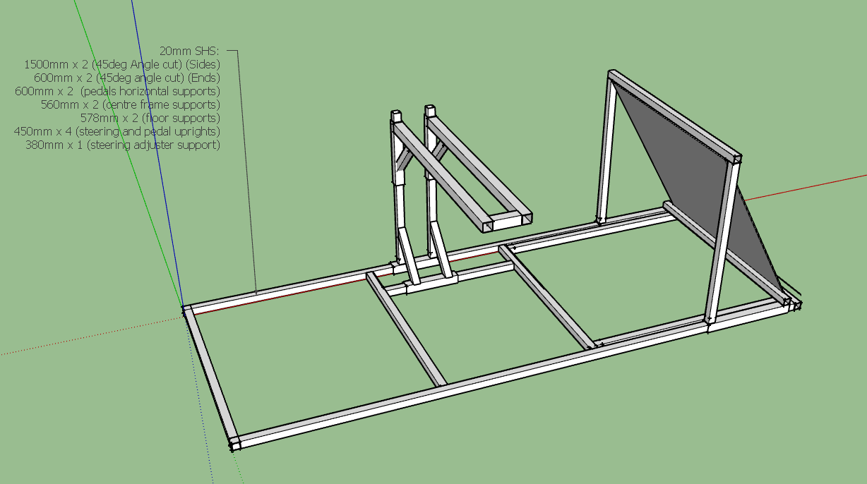

    OK, so I thought I'd start by adding a couple of my original plans that I drew up in Sketchup.
    Here is my first run at what I was going to aim for:
    The plan shows just a basic 2DOF, Arduino controlled, rear-mounted worm-gear motor and CV joint setup. Importantly for what I was aiming for, the steering wheel position is adjustable both vertically and horizontally. I would have liked to add rotation/tilt on there too, but put that in the too-hard basket for the time being. Similarly, the pedal mount position can also be adjusted. This was achieved using 25x25mm Box Steel slides surrounding the 20x20mm box steel frame.
    Shortly after drawing that up, I saw another YouTube clip that outlined how to modify the G27 pedals so that they can be mounted upside down - link
    After seeing that, I ended up re-doing the sketchup design to incorporate inverted pedals. The below design shows just the moving part of the frame, as to be honest, the macbook air that I was designing this on really didn't like the amount of detail in the first design. I also ended up removing the seat from the design, as each of my mates that I was going to make a frame for wanted to do something different with the seat, so I just left that space completely empty. The pic below is basically exactly what I ended up building 4 times over (minor differences around the pedals mainly). I also added a floor pan for the drivers feet to sit on, which weren't in the pic.

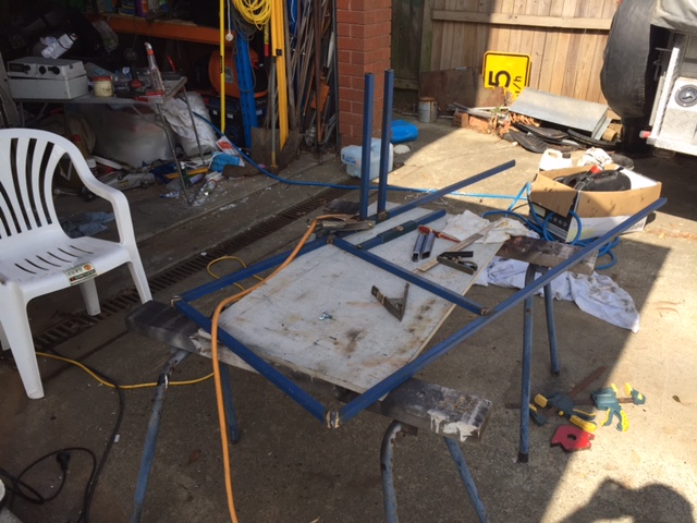

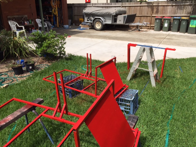

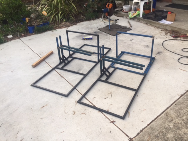

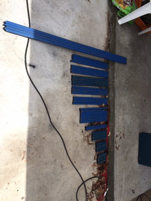

    Here's a couple of shots showing the build process when I made the third and fourth frames the same day.
    Two lots of each of the parts to make the frame all cut to size
    I had my brother teach me to Tig weld
    Here's two of the frames with the welding completed (except a few spot welds for the sheet metal for the pedal mounts and floor pans):
    And spray painting to cover the admittedly crappy welds - hey, I'm only a beginner at this :)

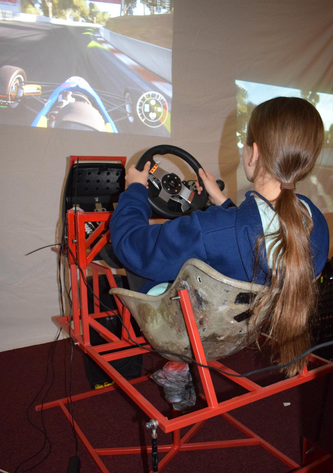

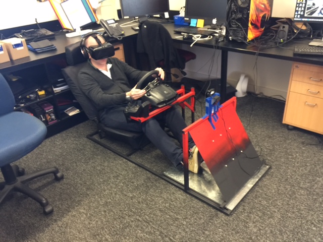

    With all that said and done, here's a couple of shots of my first frame to go to my team mate, then the first revision of my frame (more on this shortly), and then a nice pic of my boss taking the rig for a round at Monza when I recently brought it in to work.
    In the interest of my computer not crapping out, I'll leave that post here and continue below..

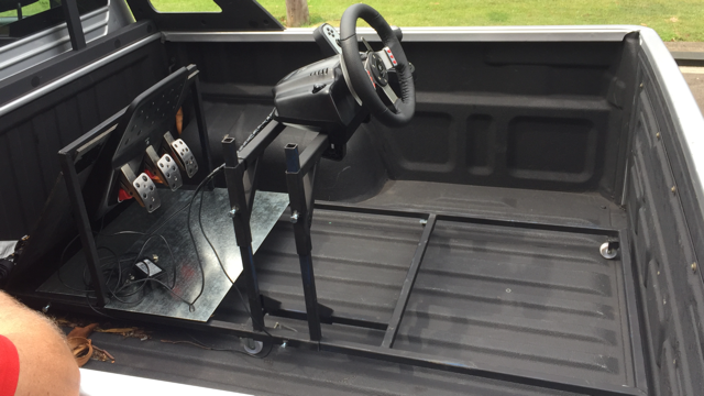

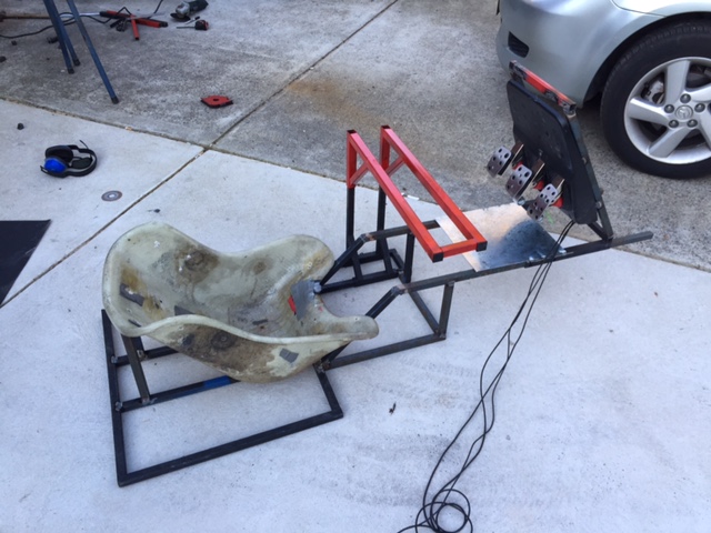

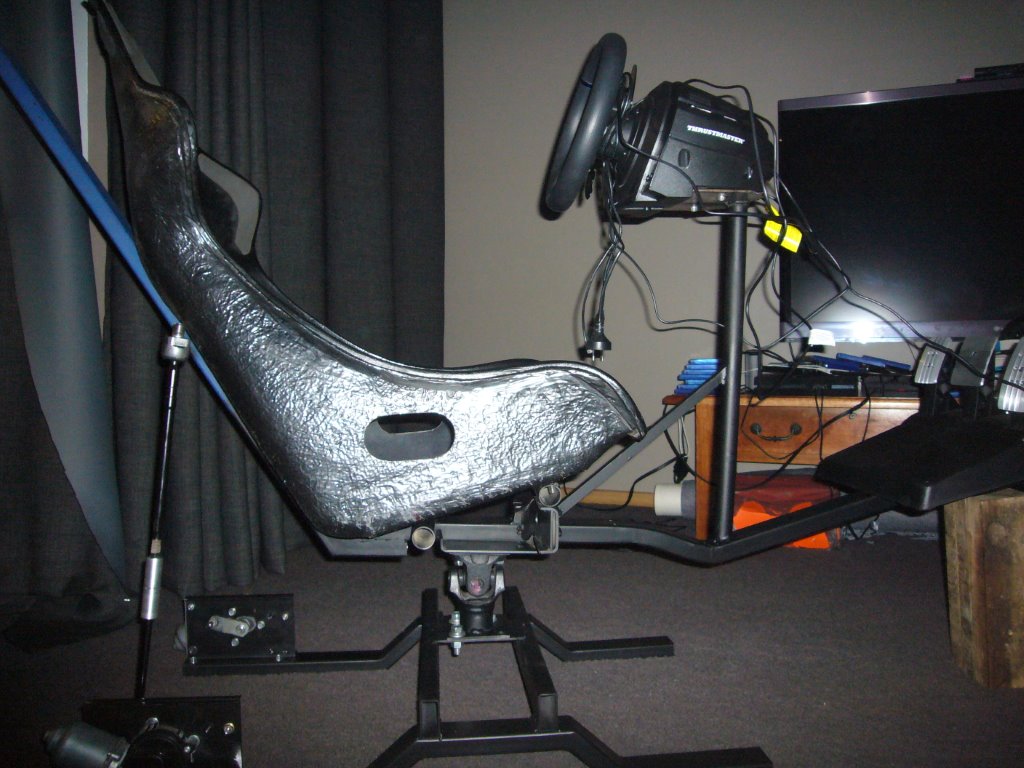

    Cool. So at this point, I've built 4 frames (no motion). I'm about to go ahead and start the motion platform part of the build on my own personal rig. But I'd spoken to my mates and we'd all talked about how we'd really like to be lying back more, a bit like in an Formula 1 cockpit (my mates and I really enjoy the challenge of racing the Project Cars Formula A cars around the Bathurst circuit). So before I start on the motion build, I'd decided I'd modify my frame further to raise the drivers feet.
    So, what I ended up doing was cutting off the pedal supports (making sure not to cut the steering supports or sliders). I then added 45 degree angles that raised up to 220mm from ground level. After taking some time to make sure everything was parallel, level, etc, I welded new horizontal pedal supports that were raised, and with the supports at the end of the steering support, it's actually far more rigid than I expected. I also decided to leave the end open, so that the pedals can slide off. My hope in this is that, even as I design and build the motion part, it will be easy enough to disassemble and fit in the back of my sedan in parts, rather than having to get my hands on a ute/truck to move it anywhere.
    With that design, I'm very happy with the feel in the seat, and also the range of adjustment to fit the size of the person in the seat. Having talked with one of my mates just yesterday, one change to this design that I would consider is to do away with much of the steering adjustment, and have a pillar in the centre (between the legs, more like a go kart) for the steering mount. This would make the rig a bit easier to get in and out of, as maneuvering your legs around the horizontal steering support can be a bit of a pain.

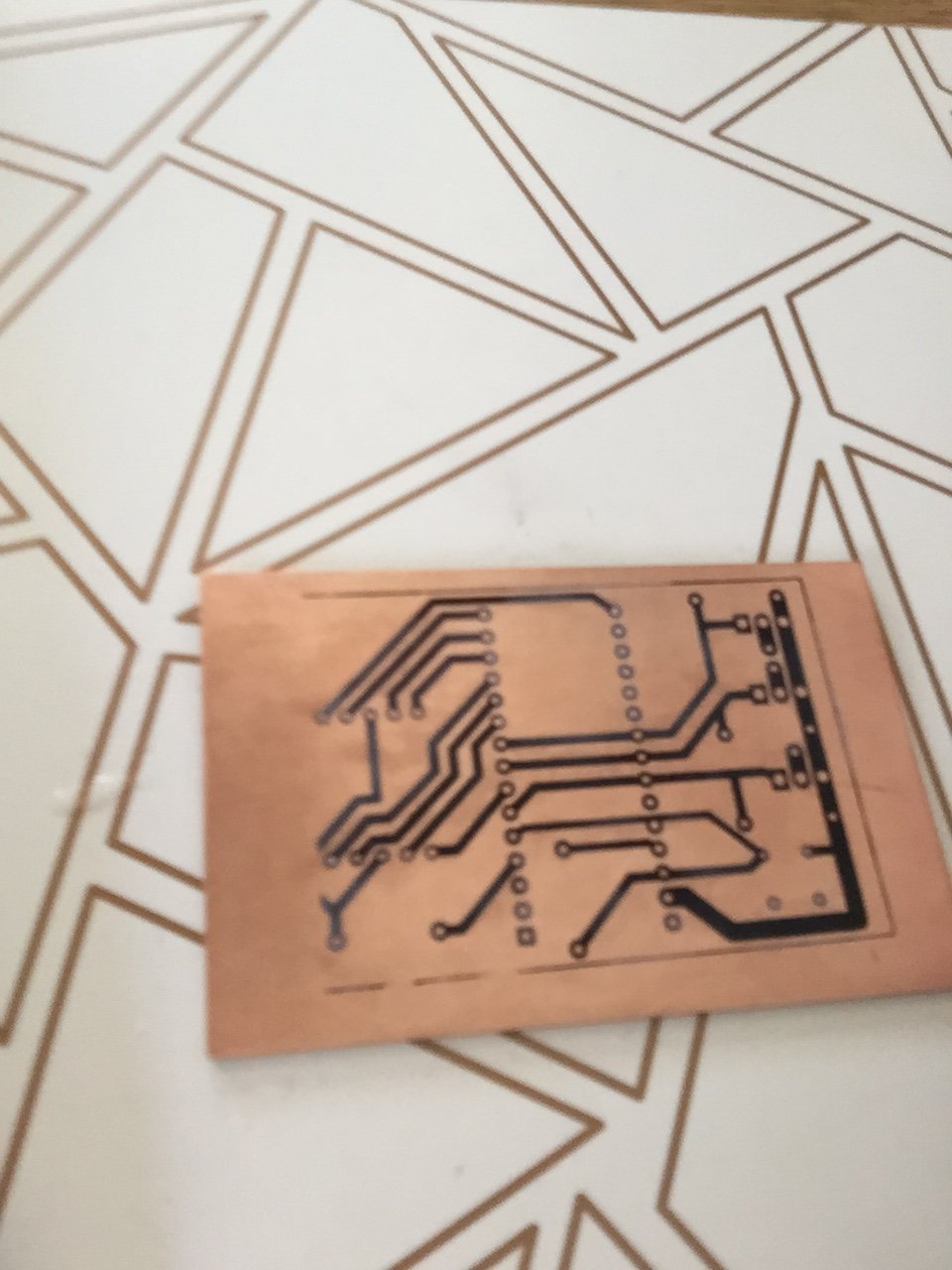

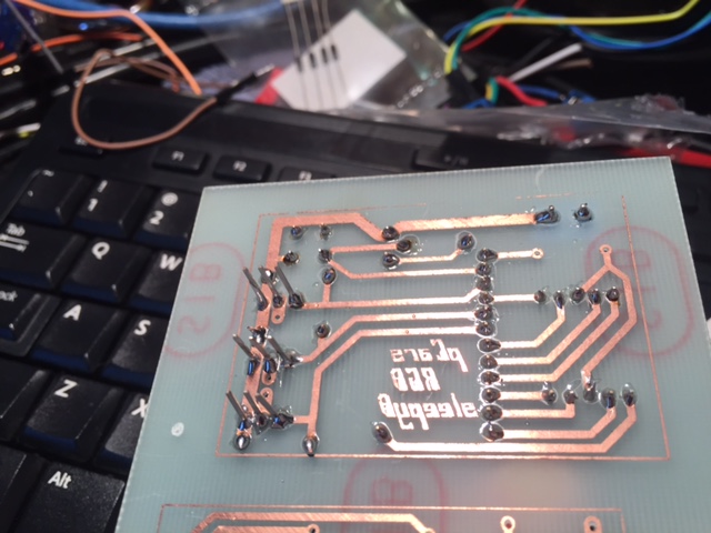

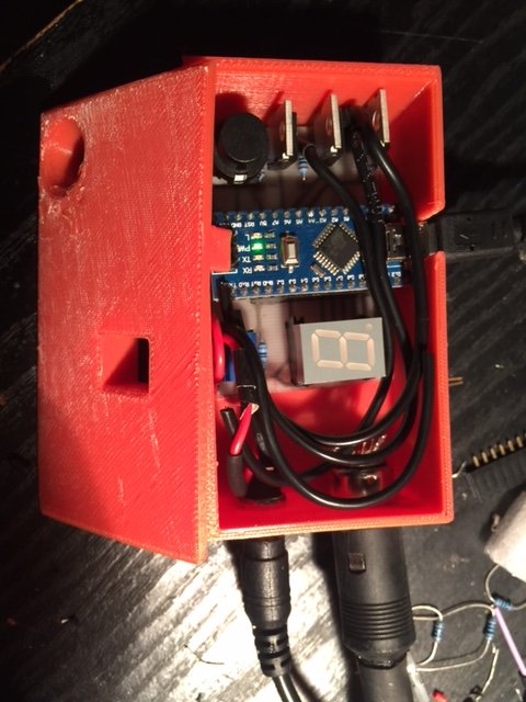

    At this point, I thought I might expand on the RGB LED light controller that I'd mentioned at the top.
    My original plan was just to have some lights that would get brighter as the driver went faster, and then would turn red when they hit the brake. This was partly a way for myself to get my head around using an Arduino, and once I (eventually) got the lights working, I ended up expanding the project to include a number of "modes", including:
    • Velocity (as mentioned, brighter as speed increased, red for braking, and also flashing red if the car was damaged beyond a certain point)
    • RPM
    • G-force
    • Current flags displaying on track
    • Rainbow mode (because why not, it's RGB after all)
    • Cops (that's right, red/blue flashing lights) :)
    To achieve all of this, I made heavy use of a great GitHub project called PCars by James Muscat - https://github.com/jamesremuscat/pcars. This hooks into the UDP stream from Project Cars, and lets you use Python to do what you want with the telemetry packet.
    With that, I created a little Python script that sent various bits of data to my Arduino Nano over the serial connection. Here's the code for that (note: this is pretty messy code, nothing really finalised at this stage, but proof of concept is working):

    And on the Arduino side, I wrote the following sketch that reads the serial data, parses it, and will play with the lights according to the current "mode", as outlined above.
    Code:

    void damaged_lights(){
      //DAMAGED!!! Pulse red light
      pulse_light_val += pulse_delta;
      //quick data check
      if (pulse_light_val < 0){
        pulse_delta*= -1;
        pulse_light_val = 0;
      else if (pulse_light_val > 255){
        pulse_delta*= -1;
        pulse_light_val = 255;
      analogWrite(MOSFET_PIN_GREEN, 0);
      analogWrite(MOSFET_PIN_BLUE, 0);
      analogWrite(MOSFET_PIN_RED, pulse_light_val);
    * Lights glow depending on the current car speed
    *    Precond: - speed_val must be 0-255
    *             - damaged_val must be 0-255
    void velocity_lights(){
      if (brake < 30) {
        if (damaged_val < 15){    //If there isn't significant damage, light up like normal
          if (speed_val <= 80){
            analogWrite(MOSFET_PIN_BLUE, speed_val);
            analogWrite(MOSFET_PIN_GREEN, speed_val/2);
            analogWrite(MOSFET_PIN_RED, 0);
          else if (speed_val <= 160) {
            analogWrite(MOSFET_PIN_GREEN, 40 + int((speed_val%80)*1.5));
            analogWrite(MOSFET_PIN_RED, (speed_val/2)%80);
          else {
            //quick data check
            if (pulse_light_val < 40){
              pulse_delta*= -1;
              pulse_light_val = 40;
              pulse_delta*= -1;
            analogWrite(MOSFET_PIN_BLUE, pulse_light_val);
            analogWrite(MOSFET_PIN_GREEN, pulse_light_val);
        else{
          damaged_lights();
      else {
        brake_lights();
    * Lights glow depending on the current engine RPM
    *    Precond: - rpm_val must be 0-255
    void rpm_lights(){
      if (brake < 30) {
          analogWrite(MOSFET_PIN_BLUE, rpm_val);
          analogWrite(MOSFET_PIN_GREEN, rpm_val);
       else{
          damaged_lights();
      else {
        brake_lights();
    * Lights glow depending on the current g-forces experienced
    *    Precond: - gforce_val must be 0-255
    void gforce_lights(){
        analogWrite(MOSFET_PIN_BLUE, gforce_val);
        analogWrite(MOSFET_PIN_GREEN, gforce_val);
      else{
        damaged_lights();
    * Lights display the current displayed track flags
    *    If there are no flags, cycle through RGB at this stage
    void flag_lights(){
      switch (track_flag){
        case 0: //no flag. Display anything?
          //quick data check
            pulse_delta*= -1;
            EORlight = (EORlight + 1)%3;
            pulse_delta*= -1;
          analogWrite(MOSFET_PIN_GREEN, pulse_light_val*(EORlight == 0));
          analogWrite(MOSFET_PIN_BLUE, pulse_light_val*(EORlight == 1));
          analogWrite(MOSFET_PIN_RED, pulse_light_val*(EORlight == 2));
          break;
        case 1: //GREEN
          analogWrite(MOSFET_PIN_GREEN, 255);
          break;
        case 2: //BLUE
          analogWrite(MOSFET_PIN_BLUE, 255);
          break;
        case 3: //WHITE (approaching slow car)
          analogWrite(MOSFET_PIN_RED, 255);
          break;
        case 4: //YELLOW
          break;
        case 5: //DOUBLE YELLOW
            pulse_light_val += (pulse_delta*2);
            //quick data check
              pulse_delta*= -1;
              pulse_delta*= -1;
          break;
        case 6: //BLACK (light up red I guess)
            pulse_light_val += (pulse_delta*3);
            //quick data check
              pulse_delta*= -1;
              pulse_delta*= -1;
          break;
        case 7: //CHEQUERED - go nuts?
            pulse_light_val += (pulse_delta*5);
            //quick data check
              pulse_delta*= -1;
              pulse_delta*= -1;
          break;
    void lights_off(){
    * Call the specific light up function we want.
    *  Input: Integer - colour mode to load
    void do_lights(int mode){
      switch (mode){
        case 0:
          lights_off();
          break;
        case 1:              // Speed with damage
          velocity_lights();
          break;
        case 2:              // RPM with damage
          rpm_lights();
          break;
        case 3:              //Gforce with damage
          gforce_lights();
          break;
        case 4:              //Track flags
          flag_lights();
          break;
        case 5:              //Fade through rainbow (no telemetry needed)
          rainbow_step();
          break;
        case 6:              //Reb-blue flashing (no telemetry needed)
          cops();
          break;
    void set7segDisplay(int num){
      //set all off, and turn on the ones needed
      digitalWrite(SEG_A,LOW);
      digitalWrite(SEG_B,LOW);
      digitalWrite(SEG_C,LOW);
      digitalWrite(SEG_D,LOW);
      digitalWrite(SEG_E,LOW);
      digitalWrite(SEG_F,LOW);
      digitalWrite(SEG_G,LOW);
       //Conditions for displaying segment a
       if(num!=1 && num != 4)
      digitalWrite(SEG_A,HIGH);
       //Conditions for displaying segment b
       if(num != 5 && num != 6)
      digitalWrite(SEG_B,HIGH);
       //Conditions for displaying segment c
       if(num !=2)
       digitalWrite(SEG_C,HIGH);
       //Conditions for displaying segment d
       if(num != 1 && num !=4 && num !=7)
       digitalWrite(SEG_D,HIGH);
       //Conditions for displaying segment e
       if(num == 2 || num ==6 || num == 8 || num==0)
       digitalWrite(SEG_E,HIGH);
       //Conditions for displaying segment f
       if(num != 1 && num !=2 && num!=3 && num !=7)
       digitalWrite(SEG_F,HIGH);
       if (num!=0 && num!=1 && num !=7)
       digitalWrite(SEG_G,HIGH);
    * Momentary push button checker.
    *    Check for state change, and cycle through light modes when button released
    void checkButtonPush(){
      // Check Digital pin to see if it's pressed.
      if ((digitalRead(IN_SWITCH) == LOW) && (button_mode == 1)){
          button_mode = 0; // Button is pressed.
         delay(100); //small delay to account for button bounce.
      else if ((digitalRead(IN_SWITCH) == HIGH) && (button_mode == 0)){
        button_mode = 1; // Button is released.
        current_lights_mode = (current_lights_mode+1)%7;
        set7segDisplay(current_lights_mode);
    *   Set up pin modes, and set up the 7seg display
    void setup() {
      Serial.begin(115200);
      pinMode(ONBOARD_LED, OUTPUT);       //not really needed - only for testing..
      pinMode(MOSFET_PIN_GREEN, OUTPUT);  //PWM pins
      pinMode(MOSFET_PIN_BLUE, OUTPUT);
      pinMode(MOSFET_PIN_RED, OUTPUT);
      pinMode(IN_SWITCH,INPUT);           //Push button switch (momentary)
      pinMode(SEG_A, OUTPUT);             //7seg display output pins
      pinMode(SEG_B, OUTPUT);
      pinMode(SEG_C, OUTPUT);
      pinMode(SEG_D, OUTPUT);
      pinMode(SEG_E, OUTPUT);
      pinMode(SEG_F, OUTPUT);
      pinMode(SEG_G, OUTPUT);
      pinMode(SEG_DP, OUTPUT);
      current_lights_mode = 0;
    void loop() {
       * Basic Program Flow:
       *  1. If there's new serial data, read and parse it
       *  2. Do a bit of bounds checking
       *  3. Play with the pretty lights
      checkButtonPush();
      //STEP 1:
      if (Serial){                                      // Only bother doing anything if we have a serial connection
        if (Serial.available() > 0) {                   // OK,something came across serial
          incomingSerial = Serial.readStringUntil('+'); // read in everything until we see a "+" terminator
           * Parse the data. We expect it in the current form:
           *    "b###s###t###d###r###g###+"
           *   = brake (0-255) speed (0-255) throttle (0-255) damaged (0-???) rpm (0-255) gForce (0-255)
          if (incomingSerial[0] == 'b' && incomingSerial[4] == 's' && incomingSerial[8] == 't' && incomingSerial[12] == 'd' && incomingSerial[16] == 'r'  && incomingSerial[20] == 'g'  && incomingSerial[24] == 'f'){
            brake = (incomingSerial[1] - 48)*100 + (incomingSerial[2] - 48)*10 + (incomingSerial[3] - 48);
            speed_val = (incomingSerial[5] - 48)*100 + (incomingSerial[6] - 48)*10 + (incomingSerial[7] - 48);
            throttle_val = (incomingSerial[9] - 48)*100 + (incomingSerial[10] - 48)*10 + (incomingSerial[11] - 48);
            damaged_val = (incomingSerial[13] - 48)*100 + (incomingSerial[14] - 48)*10 + (incomingSerial[15] - 48);
            rpm_val =  (incomingSerial[17] - 48)*100 + (incomingSerial[18] - 48)*10 + (incomingSerial[19] - 48);
            gforce_val =  (incomingSerial[21] - 48)*100 + (incomingSerial[22] - 48)*10 + (incomingSerial[23] - 48);
            track_flag = (incomingSerial[25] - 48);
        //STEP 2:
        //quick data check
        if (speed_val < 0){
          speed_val = 0;
        else if (speed_val > 255){
          speed_val = 255;
        if (brake < 0){
          brake = 0;
        else if (brake > 255){
          brake = 255;
        //STEP 3:
        do_lights(current_lights_mode);
      else { //No serial connection - best to do nothing?
       lights_off();
    The upshot of this is a pretty nifty, if I do say so myself, little light show. I then thought I'd have a go at trying to make a couple of these, so I can throw one to each of my mates if they want, or at least put one on each of the SIM rigs for the kids games night. To do this, I thought I'd have a shot at creating my own PCB for this (waaaaaaay overkill I know, but why not eh?).
    Attached are a couple of pictures of the progress. Unfortunately I pulled apart the breadboard I had the working prototype on, so no pics of that, but the general idea of it is that 3 of the PWM pins on the Nano drive 3 MOSFETs, supplying a modulated 12V signal to the 12V LED strips. I ended up 3D printing an enclosure for one - still need to alter a bit of the code to accommodate re-assigning of a couple of the pins, but not a bad first run IMHO.

    I thought I should add a couple of notes and pointers for some of the things that I've learned.
    1. As I have an Oculus Rift (DK2), I had originally designed and built this frame with that in mind. What that has meant though is that, for my mates who I've built this for, this rig unfortunately has a number of drawbacks, such as:
      1. No mount for an LCD monitor (note, not a problem for the kids night as I use projectors, but that's not really practical for my mates)
      2. No mount for keyboard or mouse controls
    2. For myself as well, I mainly use Project Cars, which has excellent VR support at this stage, so I've not needed keyboard/mouse controls. However with the recent release on steam of Kart Racing Pro, I've noticed that the VR menu controls are not as universal as I expected across the games, so I've found myself now having to think about adding some sort of keyboard or mouse mount, which I really hadn't planned for
    3. In the Sim_v4.jpg (hopefully embedded here this time), I have greatly reduced the amount of sheet metal that was in the original design. The pedals actually mount now on two strips of 20mm wide steel flat bar, and the floor pan is only about a quater of the size that the original one was. This has cut the weight of the whole rig WAAAAAY down.
    4. After having created the LED controller, adding the pedal rumble feature, etc, I'm finding that my computer is quickly running out of USB ports (2 taken for the Rift setup, 1 for the G27, keyboard, mouse, LED controller, rumble controller, soon to be 1 for SimTools). My plan now is to buy a powered USB3 HUB, and have this mounted underneath the tilt frame. If this is correctly located, it should be fast enough to handle a number of inputs/outputs through one cable to the desktop PC, and will give hopefully enough ports to give me keyboard and mouse input on the rig too.
    Also, if anyone knows if it's possible to go back and edit previous posts, please let me know :) - I was hoping to go back and fix up my earlier posts by embedding the pics where they were supposed to go, but I'm not having much luck..

    I'm in Sydney area, but happy to help out if I can. I'll be welding the frame this weekend, so starting the computer stuff in the next week, so happy to share anything I learn or to help out if you have questions.

    So regretfully one of the motors I had ordered was DOA, and my motor supply shop is glacially slow at doing anything other than taking money. So the kids games night has come and gone for this year, without the motion rig operational.
    With that in mind, we powered on anyway and at least had some fun. Here's a couple of pics of some of the older kids enjoying the night. Hopefully next time we will have a collection of these rigs going - 2 doing driving sims, and one as an oculus-powered rollercoaster (No Limits 2) sim.

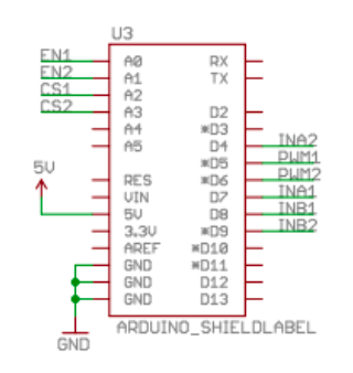

    Alrighty Mr Ned, looks like we're in a similar boat with the Arduino code from RacingMat. I've got everything wired up now, and I'm having some weird behaviour with testing.
    Basically, I'm just testing 1 pot/motor to make sure it's behaving properly. When I turn the pot one way, it kicks into gear pretty quickly. However, when i turn it the other way, it spins slowly for a second, then stops. I can turn the pot all the way to it's limit, and the motor just sits still. At that point I can't get it to do anything for a bit, then it comes back alive again.?
    I altered the code a bit in the motorMotion() function so I could read out what the actualPos, targetPos, gap and pwm variables were set at. From what I can see, the values are all being read properly by the arduino - everything there looks as expected.
    One thing I have done differently to the tutorial from RacingMat is that I've ended up having to stack my moto monster shield on top of my arduino (let's not get bogged down in who blew up what circuitry late one night...). My <ahem> replacement moto monster shield is not stacked, which means all pins are mapped 1-1 with the arduino. (A0 - A0, D1 - D1, etc)
    After doing a bit of digging through the Sparkfun documentation on the Moto Monster Shield,
    I found that pins A0 and A1 actually appear to be used for diagnostic outputs from the moto monster shield
    So, what I think I need to do now is change up the code again so I can use A4 and A5 as the potentiometer inputs. Haven't had a chance to do this yet (currently it's stored elsewhere, so I'll get on that in the coming days).
    Anyway, that's where I'm currently stuck at. Have you, or anyone else, had any luck with RacingMat's arduino setup?
