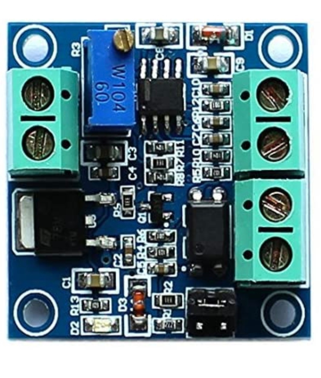

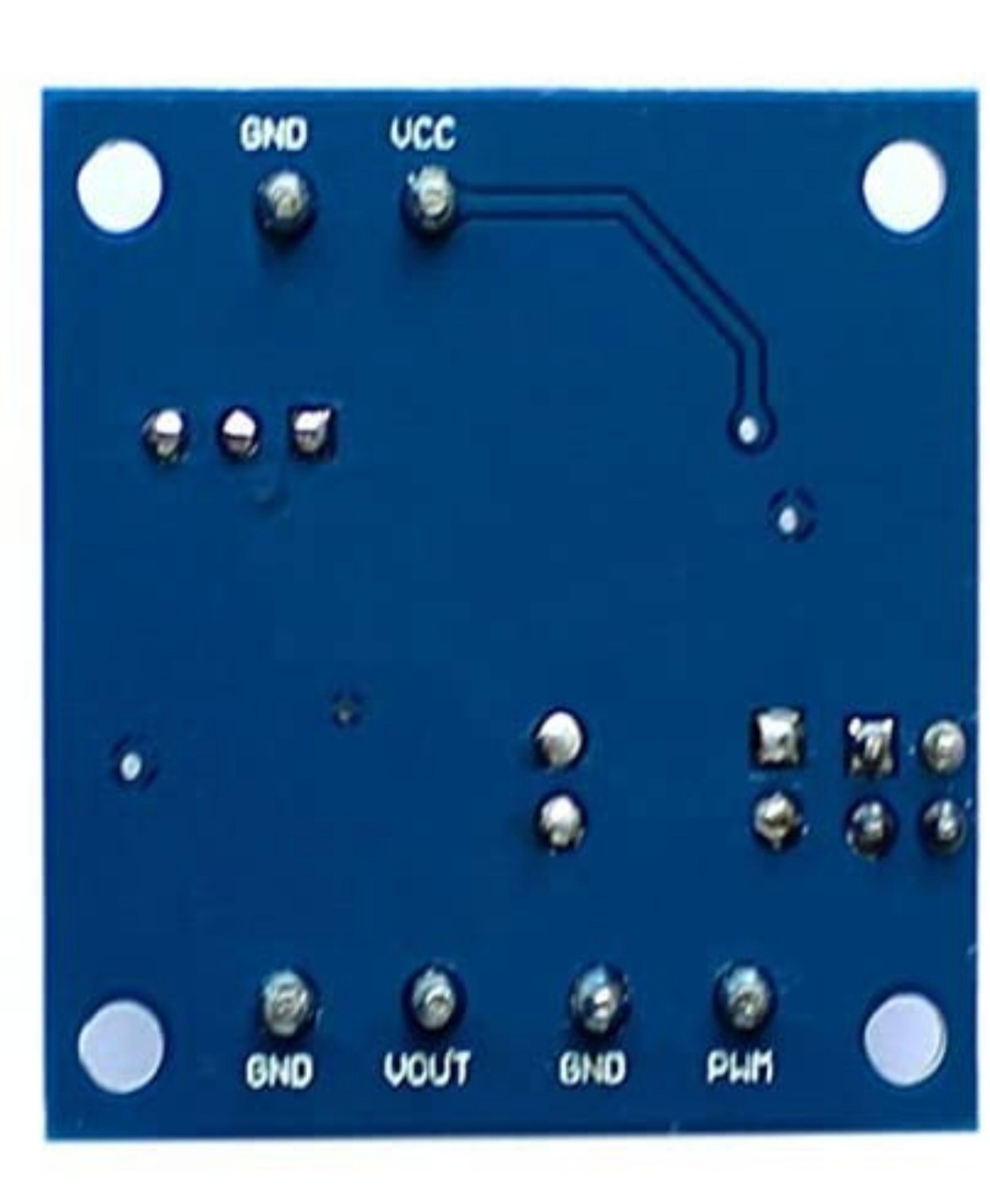

    how i can do to properly adjust my pwm 0-10v converter.

    problem solved !!
    my concern is due to a bad frequency setting of smc3Utils once passed to 5khz the speed variation has started to work correctly, I still have some overshoots on my tracking line, check if I can adjust this with the other parameters.

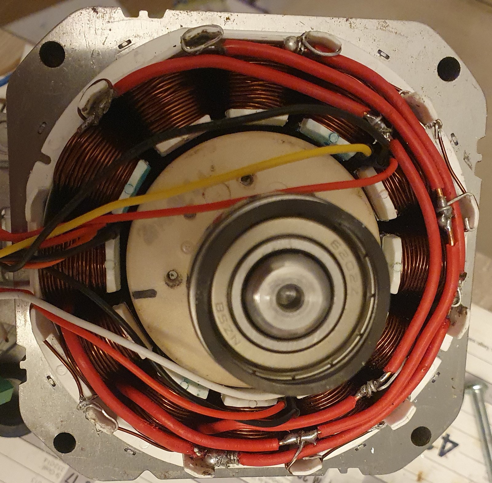

    small overview of the bldc engine modify:

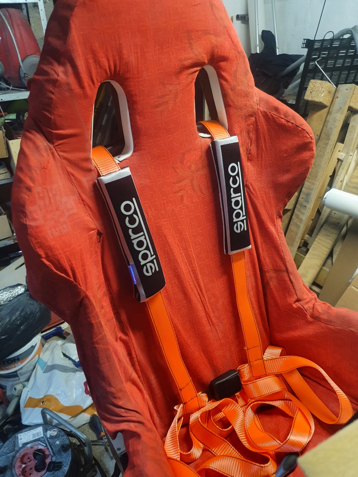

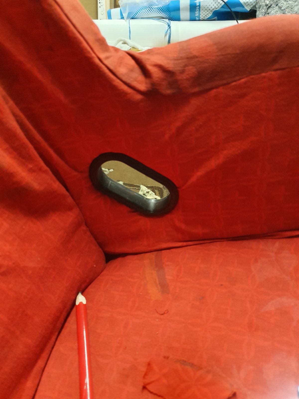

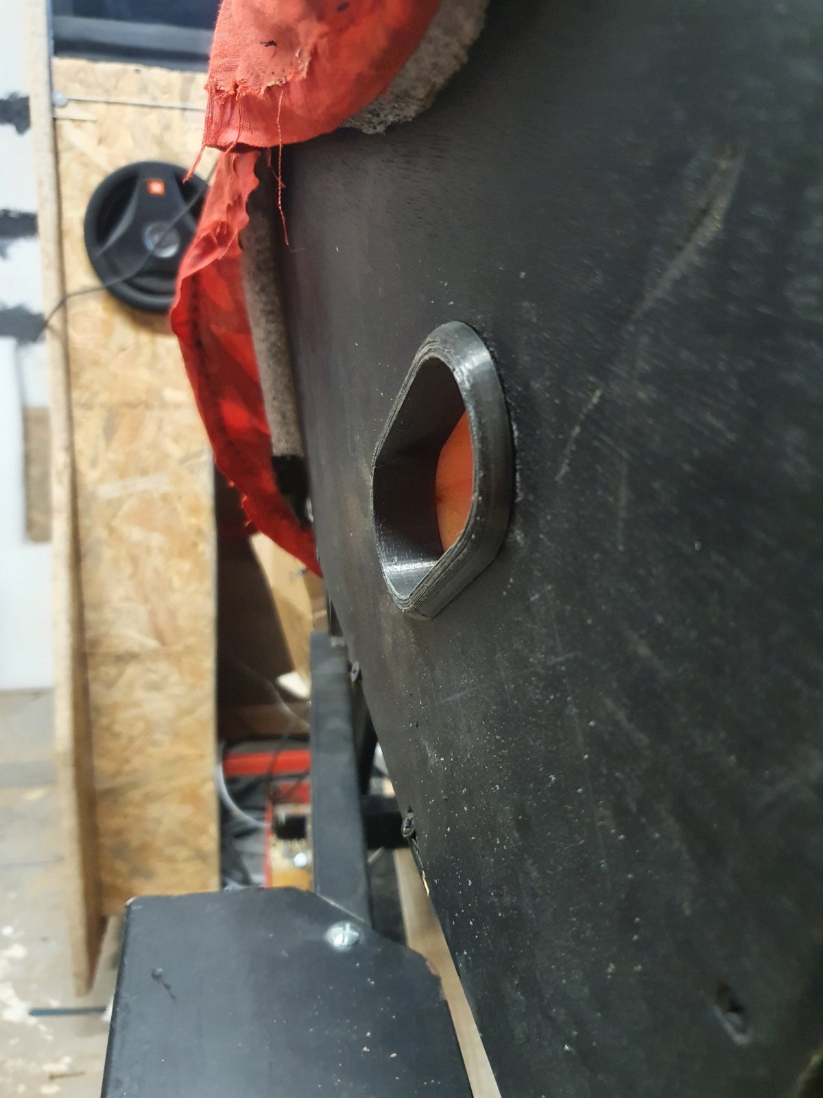

    modification of my bucket seat to add a 4-point belt with tensioner reel

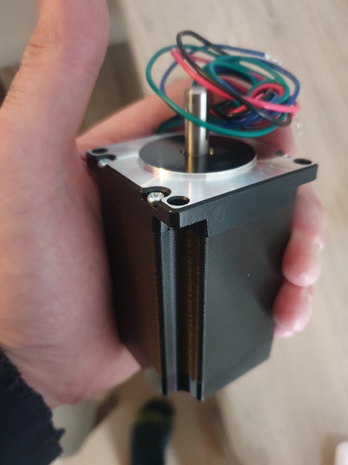

    home made 4 point belt and stepper motor for my belt tensioner

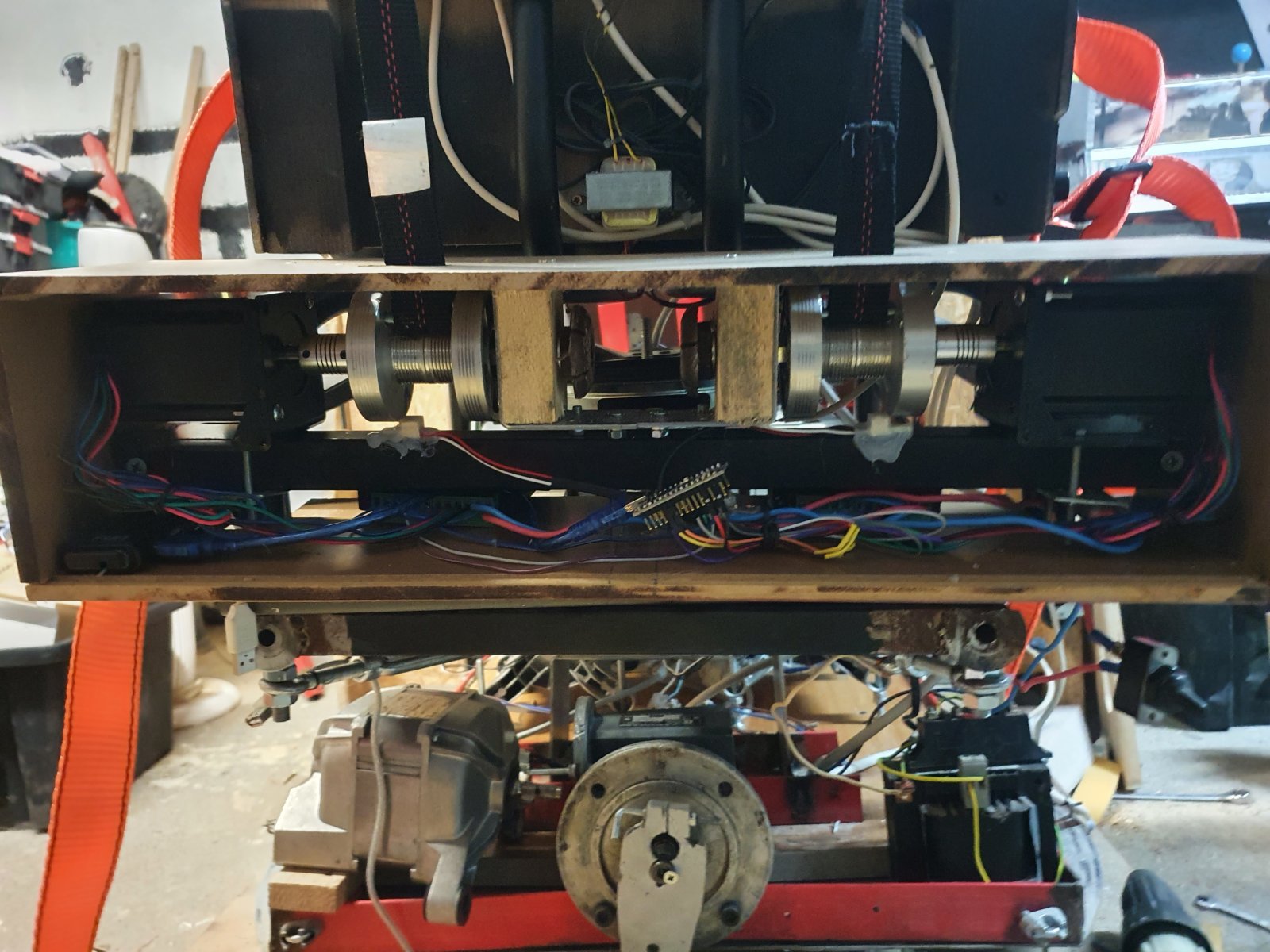

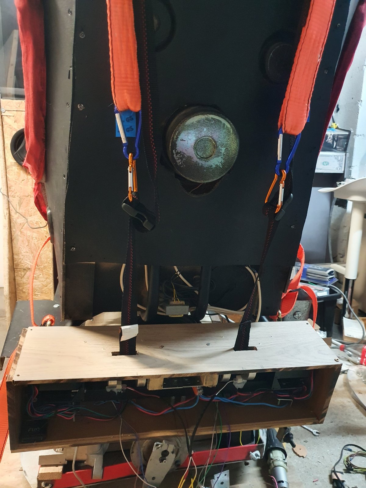

    ici, je crée un tendeur de courroie inspiré du tension-R de pt-actuator.
    après plusieurs ajustements et modifications, le système fonctionne plutôt bien (2 moteurs pas à pas nema 23 2.4Nm, 2 contrôleurs tb6600, un arduino nano).
    le code fonctionne avec tendeur simhub mais il ne me convient pas (je préfère des simtools beaucoup plus précis et souples).

    here is my belt tensioner with surge and sway effect working under simtools. 20220702_174257.jpg 20220702_210251.jpg

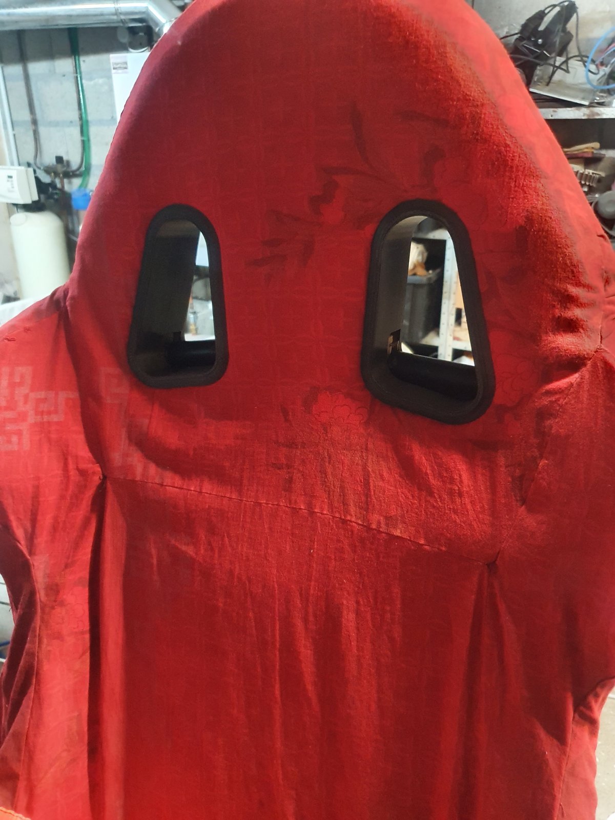

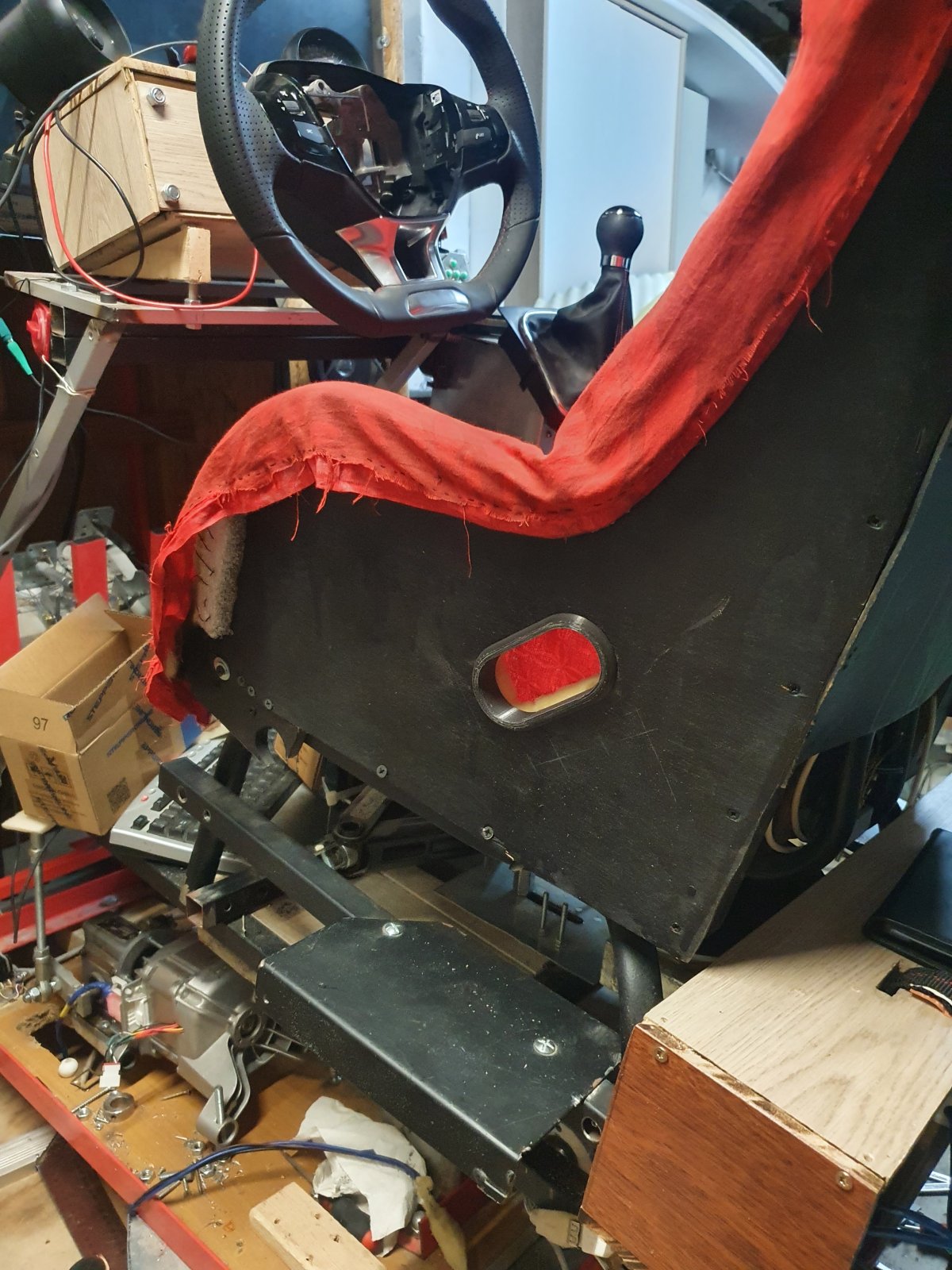

    completion of the bucket seat finishes:

    yes the noise you hear in the background is that of the nema motors, I am working on it to reduce the noise (the box is completely open).
