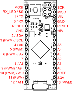

    I plugged the potentiometer on the pin A11 and +5v and Gnd of the arduino, and I used the code of Wanegain on the forum PCSHM, (he planned everything:)),
    Modify the code:
    int GlobalPowerPin = A11; //use a potentiometer to define the power of the motion simulator on pin A11 (12)
    int GP_select = 1; //1:use potentiometer 0:always 100%
    double GlobalPower = 1.00; //100%
