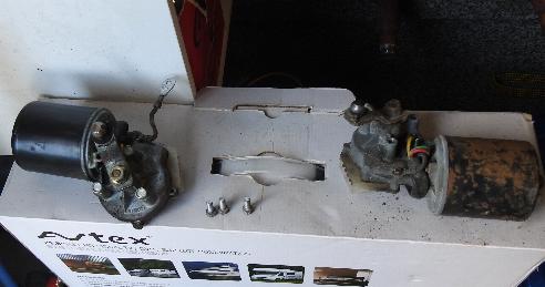

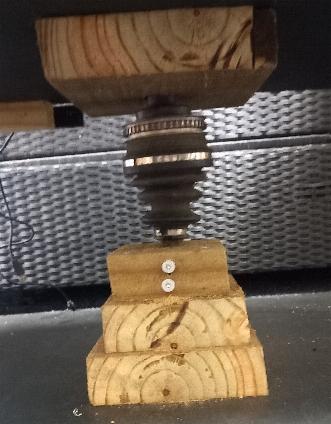

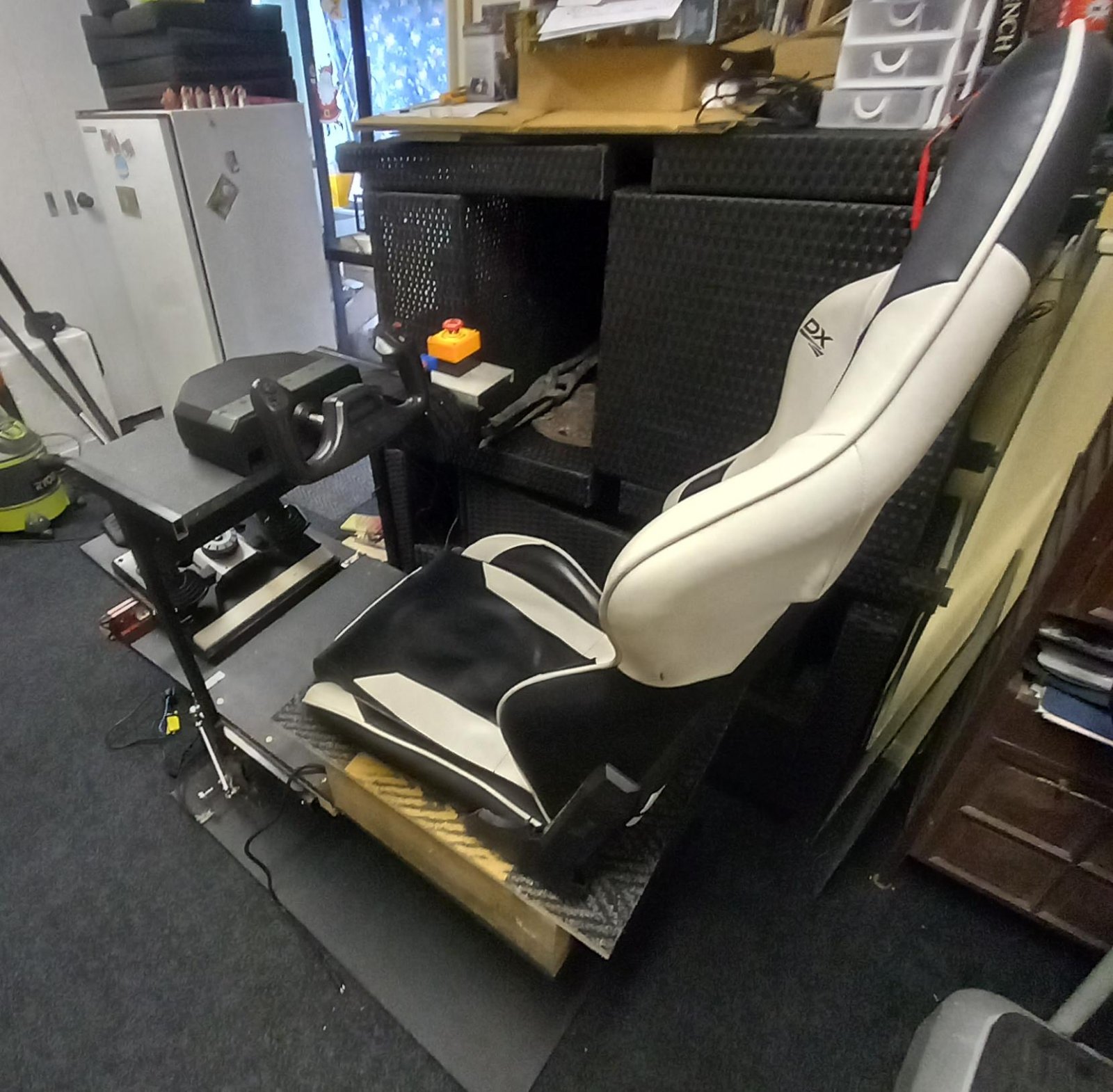

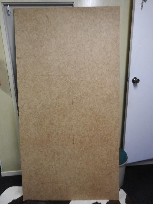

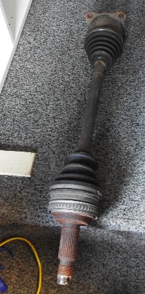

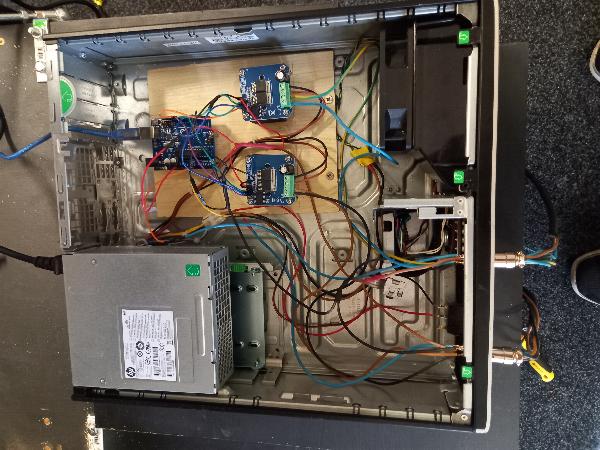

    My budget for this project was extremely small and with no welding skills I have come up with this simple motion platform. By using parts I already had along with some I have had to buy I have put together a rig for less than NZ$300.00 .
    My cost so far Timber sheet $45.00
    2 Holden Commodore wiper motors $60.00
    1 CV Joint of unknown origin $30.00
    Arduino uno $30.00
    Electrical wires plugs stop switch $52.00
    2 x IBT2 motor controllers $38.00
    Threaded rod nuts bolts ect $42.00
    Computer box and power supply $0.00
    Total $297.00
    What has not been include as I already have them are the seat, wheel ,pedals ect.
    My progress to this point has been to assemble all the parts as shown in the pictures . My only problem so far was my first 2 IBT2s were faulty a situation I resolved with the help from the members of xsimulator. I have now had the system running using the SMC3 software . Next step will be to finish assembly and move on to sim tool software for testing. I will update at that stage and let you know if the power supply cancope and the wiper motors have enough torque.

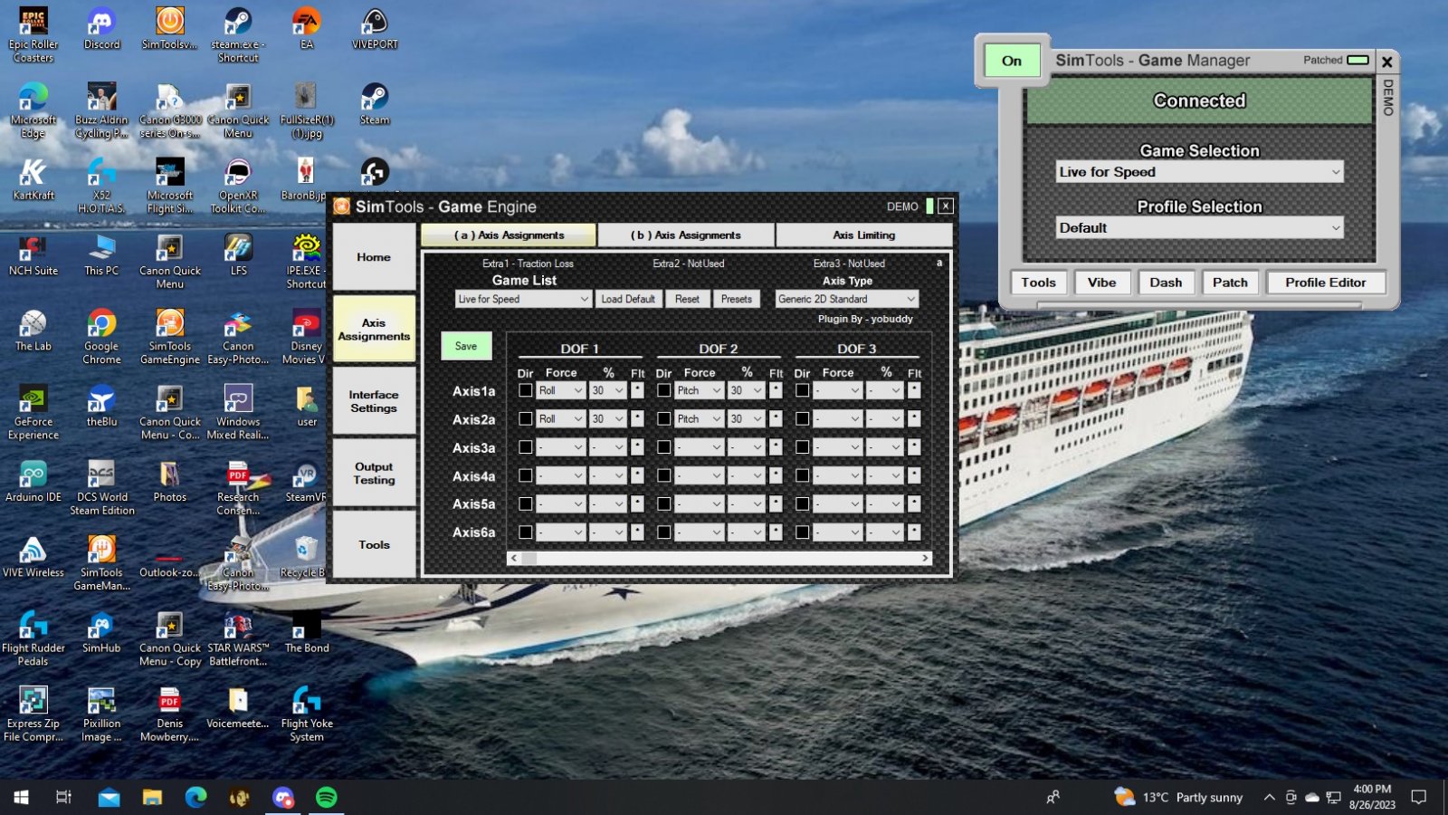

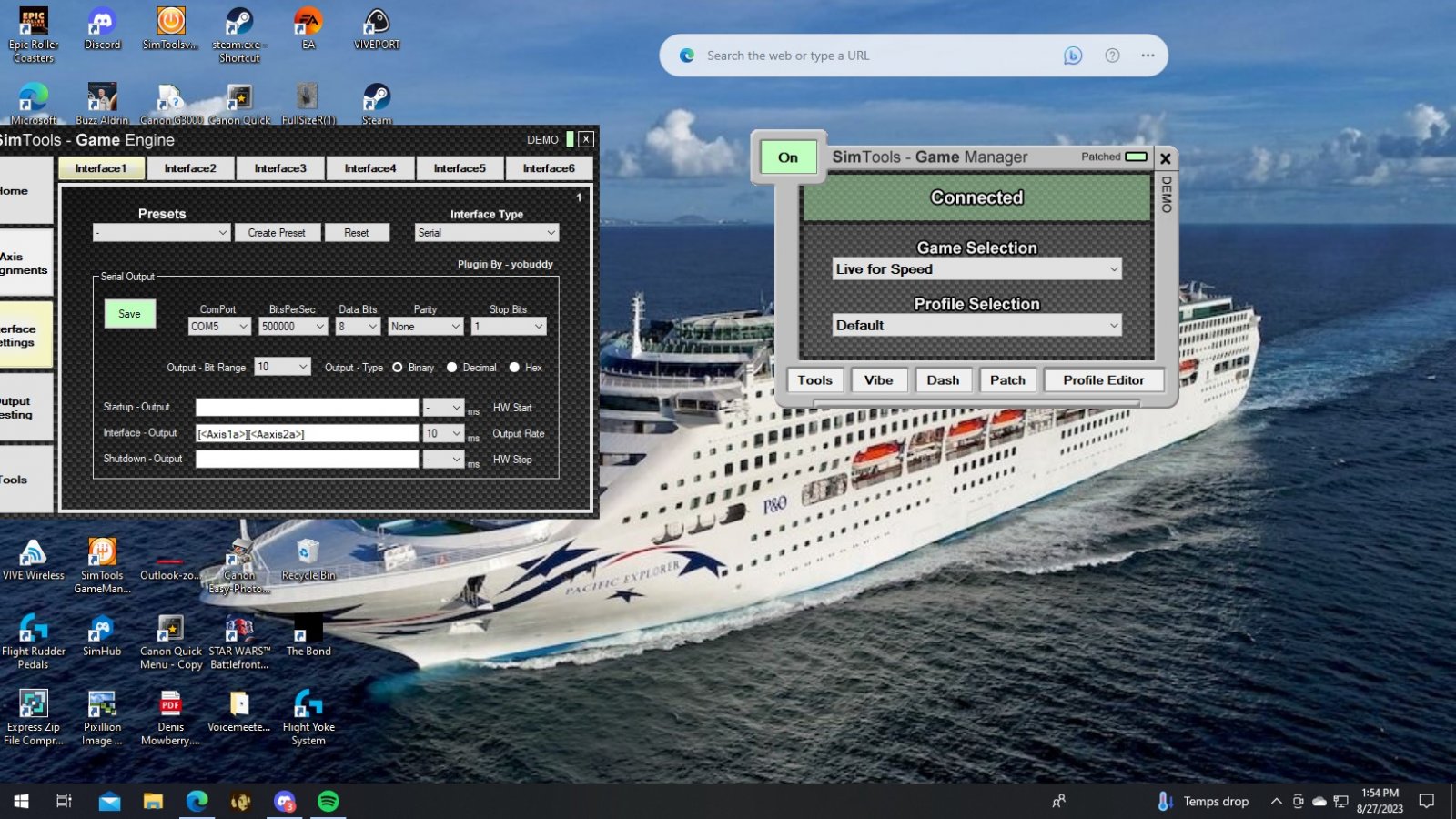

    Thanks I have found it and have tried to set it up but the game manager says not connected and I get nothing when I try output testing in the game engine
    21,595
    151,233Coins
    Can you please post pictures of all of your settings, that way members can help spot potential issues and advise on sensible settings.

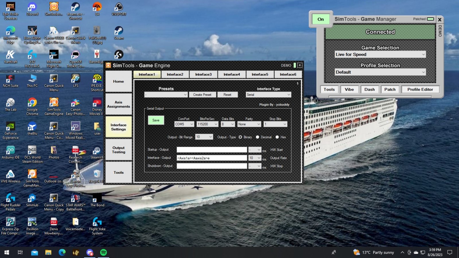

    These are the setting I am using
    These are my settings but when I go to test I have no movement

    Before testing in a game, first test in Output Testing.
    The Interface Settings are related to the code and port used. Fore example, using @BlazinH's modified SMC3 code for Sabertooth the configuration would be: [A<Axis1a>][B<Axis2a>]
    BPS: 500000
    DataBits: 8
    StopBits: 1
    Output BitRange: 10
    Output Type: Binary
    Packet rate 10ms
  12. Denis Mowberry

    I have changed the settings and tried in Output Testing still nothing but I do get a double beep when I select turn on

    When I use the SMC3 software everything works fine it is only when I move to sim tools do I have a problem . I assume a sabertooth is a motor controller . I am using IBT2 controllers will this amke a difference .

    If IBT2s work as expected in SMC3, but not in SimTools, then often it is something interfering with communication, such as antivirus or firewall, presuming everything is properly configured. Try temporarily disabling both.
    Usually, if interface settings are correct, including the pot, Axis Assignments are properly defined for the Default profile, then Output Testing should work in SimTools.
    A beep tends to indicate an error, such as a USB disconnect or similar fault, is there any actual error message?

    There is no error message and without changing any connections it works inSMC3 . Turning off the firewall made no difference . Can you please list the settings I should have using the IBT2s

    Antivirus being off is more important and if there is a chance AV has messed with SimTools then uninstalling plugins the SimTools and then reinstalling them should be done, plus initial testing, with AV disabled.
    For IBT2s the SMC3 code must be set to Mode 2 before it is written to the Arduino, like this: https://www.xsimulator.net/community/threads/problems-with-my-simulator.15382/#post-207320
    Please post a picture of SMC3 running the Sine test in Output Mode.
    The SimTools Interface Settings are:
    Interface Type - Serial
    ComPort = the Arduino ComPort, as in Windows Device Manager, should be the same as SMC3.
    BitsPerSec - 500000
    Data Bits - 8
    Parity - None
    Stop Bit -1
    Output Bit Range - 10
    Output Type - Binary
    Interface Output - [A<Axis1a>][B<Axis2a>]

    You are an absolute legend Thank you everything is now working as it should I now have to work through the fine tuning but the basics are all there Thanks again
