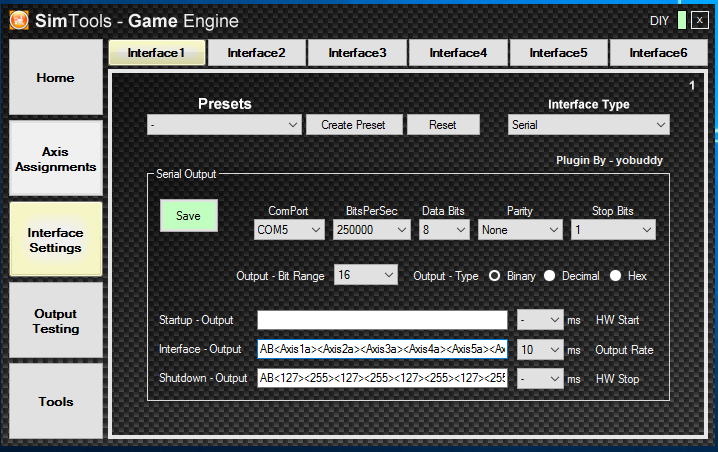

    I'm trying to setup SimTools for the first time on my Sim but I am not very knowledgeable about these things and struggling a bit.
    I think I got the right interface settings for my Thanos AMC1280USB but not 100% sure.
    I'm still very unsure of how to configure the axis assignments for a 6DOF Stewart Platform. I'm setting up for Elite Dangerous specifically.
    See my attached images, of my current settings, I'm still trying to work my way through and understand the manual as much as I can.

    No luck, maybe I'm misunderstanding something.
    Here are my current settings, copy and pasted from your post above:
    But when I click "Output Testing" and then on the "Axis Testing" tab with it set to "DOF output" I click "Turn on" and it turns green but it is not communicating with my Thanos board. The Thanos board shows "receiving data" on it's LCD screen when it's connected, and it is not doing that.
    Another motion software I used previously works right now if I turn it on, com5 port.
    Any ideas?
    PS- Just for the hell of it I tried Launching Elite Dangerous, the AMC did not connect and I got an error popup, I think it said "exception address: 0" or something similar.
    The COM port for the AMC is definitely 5

    I had already modified the settings for you in my earlier post to suit the SimTools 2 Interface Output format: AB<Axis1a><Axis2a><Axis3a><Axis4a><Axis5a><Axis6a>

    Sorry about that NoorBeast, I accidentally posted the wrong image. I did indeed copy and paste the new format from your post (now reflected in image in the post above) but SimTools still doesn't seem to connect to the AMC1280USB.

    Update: I think it's working now. It didn't work until after I rebooted my PC and started over from scratch but my AMC just went into online mode!
