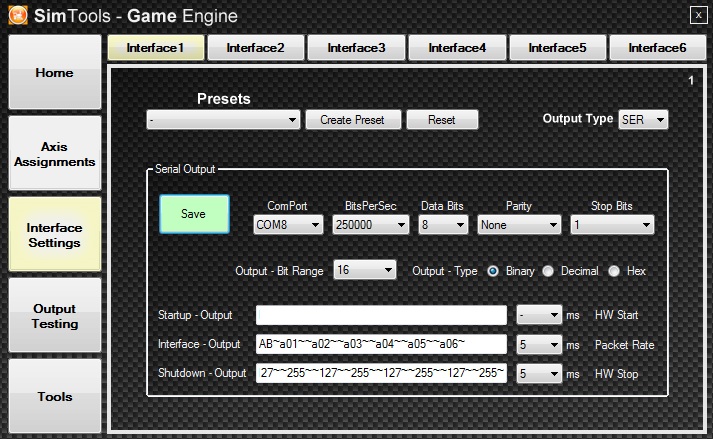

    The baud speed for AMC1280USB is 250000 bps.
    axisinformation string: AB~a01~~a02~~a03~~a04~~a05~~a06~
    simulatorstop string: AB~127~~255~~127~~255~~127~~255~~127~~255~~127~~255~~127~~255~
    All axis should be declared as Bin / 16-bit
    Should also work on @tronicgr AMC1280USB.
    Thanks Thanos for sharing this information

    SimTools equivalent
    Interface Output string: AB<Axis1><Axis2><Axis3><Axis4><Axis5><Axis6>
    Shutdown Output string: AB<127><255><127><255><127><255><127><255><127><255><127><255>

    I'm having issues getting sim tools running with my amc1280usb. Works well on x-sim and was easy to set up with the 6dof plugin but x-sim is a bit light on good plugins for space sims and flying games which is what I really want to do. Have tried the output and stop strings listed in this thread. I get a little movement from actuators when I initially turn on output testing but nothing when I try to use the sliders.
    I've built a 6dof Stewart platform with Teknic motors and 25:1 gearboxes. Lifts about 400 pounds and fast.
    Interface scree attached. May be to new to post links to videos, but will see if this works.

    Figured it out folks. Sorry. Wasn't using the Simtools equivalent. Assumed it needed to what the board needed... Duh.. Going great now, just some tuning.
