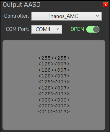

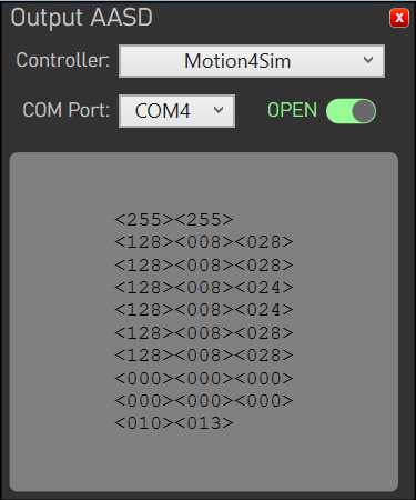

  3. loon_NG
    loon_NG New Member
    Oct 23, 2022
    13
    Biot, France
    103Coins
    Thank you @Dirty,
    I don't know what mean these 8 numbers...If this is a frame for 1 position., so approximatly:
    - rs485 rtu transmission is 11 bits per byte, so 264 bits for these 8*3 bytes.
    - with the baudrate of 115200 bps, this frame will take 2.3 ms to arrive to the servo driver.
    It's quite interressing, 436 Hz!
    Cheers
  4. Dirty
    Oct 15, 2017
    746
    All the way up front.
    7,971Coins
    +888 / 3 / -0
    I have never used RS485, so I don't know how those would work.

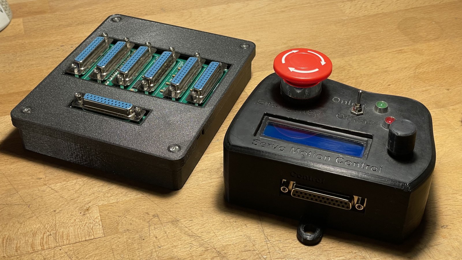

    I am using the M4S controller:
    And I can tell you, I am one happy camper :) So much so, that I have already bought enough for my next two projects to come. I'm not sure if there are any official industry standarts how to define "real-time-control", but this thing is so fast that I wouldn't know what more to ask for.

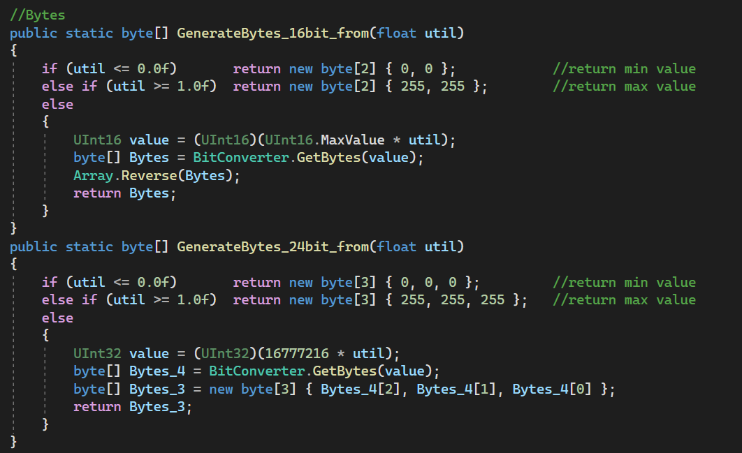

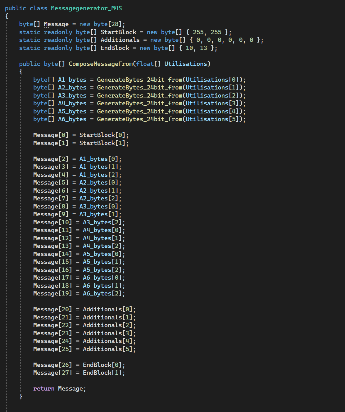

    These 8 numbers (for up to 8 channels) tell the controller where the actuator is supposed to be between fully retracted and fully extended. The M4S controller for example expects values in 24bit, so you have to specify a number between 0 and 16.777.215 using 3 bytes.
    In my own software I am internally representing the actuator position as a value between 0 (min) and 1 (max) that I call "utilisation".
    Here's how I put the message together:
    Conversion from utilisation (o-1) to bytes:
    Cheers... :)
  5. Dirty
    Oct 15, 2017
    746
    7,971Coins
    +888 / 3 / -0
    Btw, both Thanos and M4S use 250K baud. So you can send over 1000 messages/s. I'm using 500 messages/s.

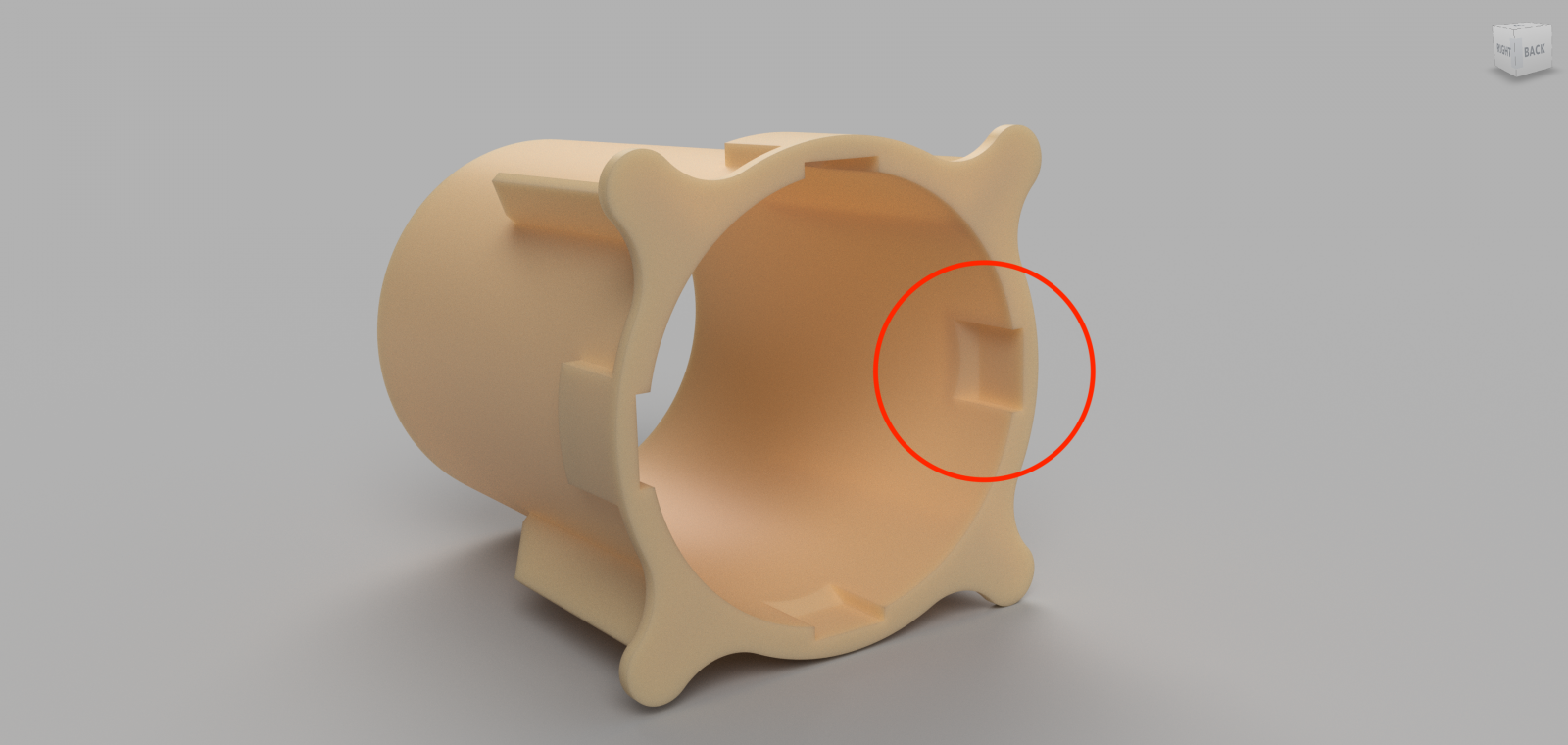

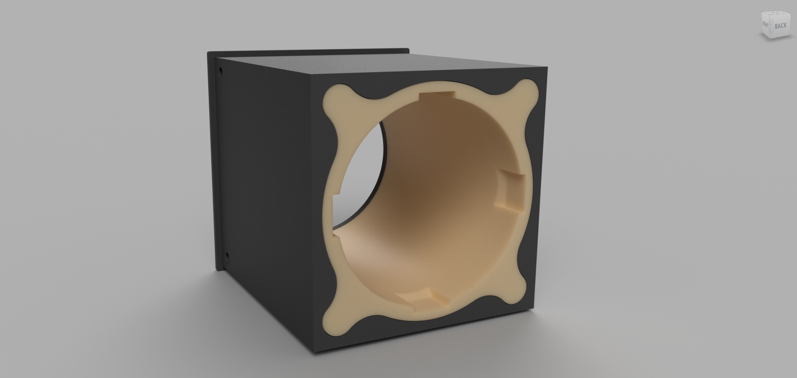

  6. twinking
    twinking New Member
    May 26, 2020
    12
    71Coins
    +14 / 0 / -0
    Hey,
    Your builds are always looking so good! Fantastic work. Did you use igus bearings at the top of the actuator to guide the pushrod?
    Best regards
    Fabian
  7. Dirty
    Oct 15, 2017
    746
    7,971Coins
    +888 / 3 / -0

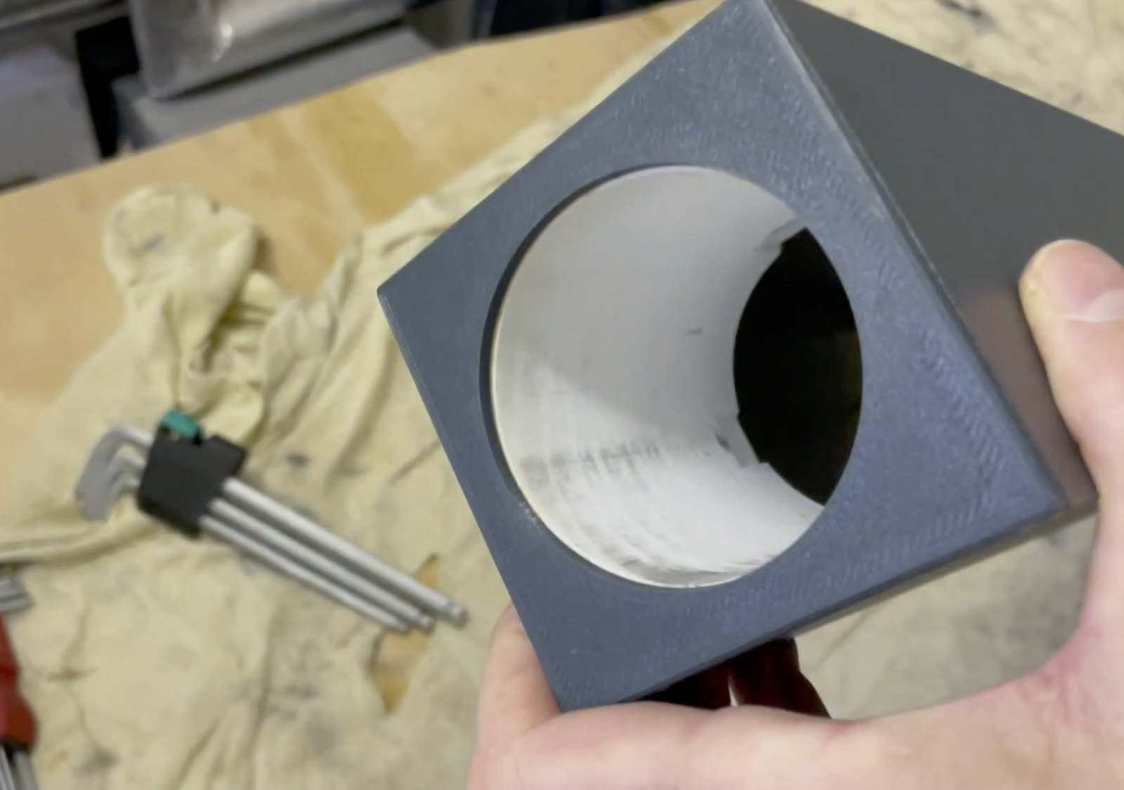

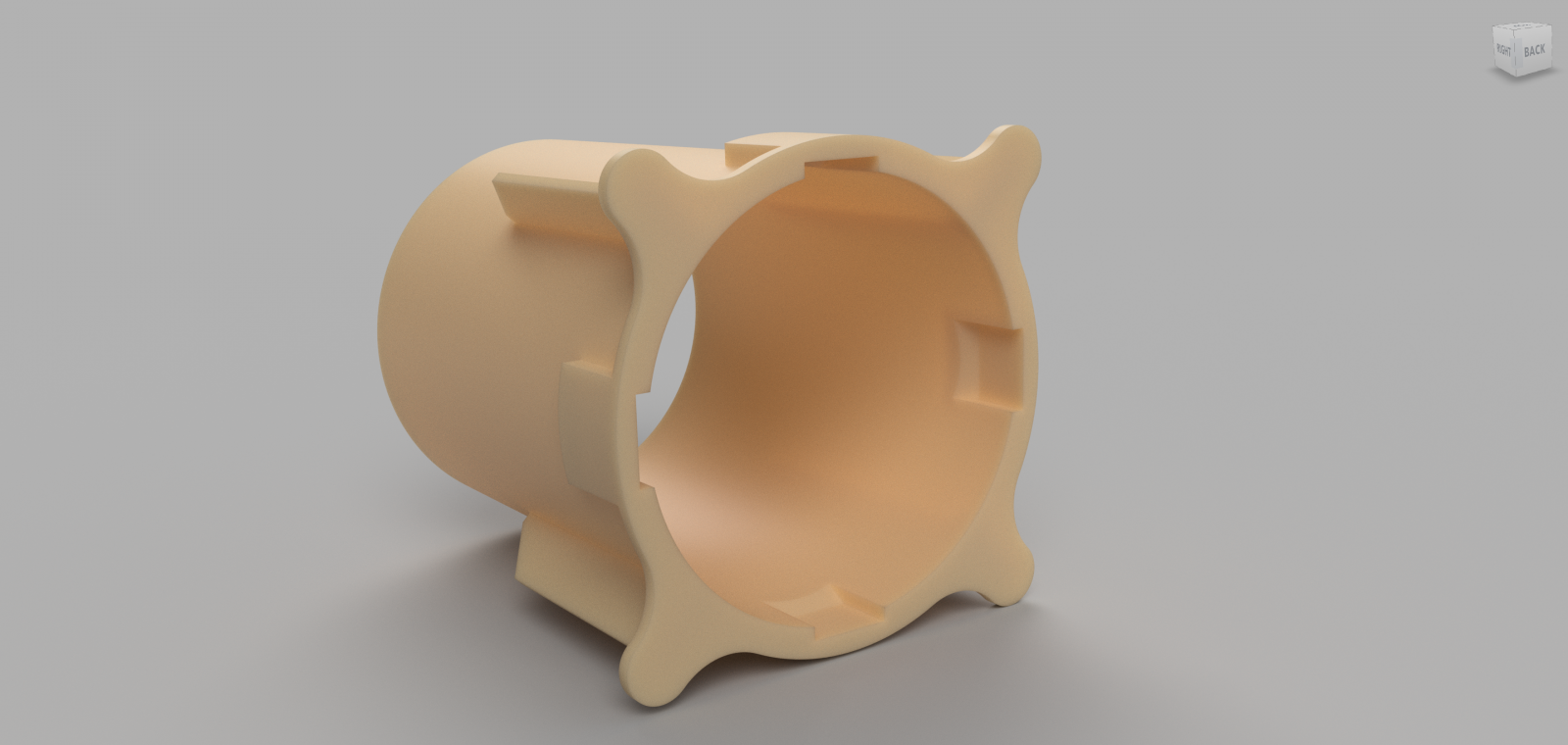

    :) Thanks for the compliment! They probably just look so clean because I prefer showing renderings instead of the real thing :) I find it often highlights the design intent much better.
    In this build I have opted for a single upper bearing which is essentially just a 2mm thick inner liner of that upper block. But that block and liner is 90mm long, so it gives enough overlap between the actuator body and the pushrod, thereby providing sufficient buckling stability.
    igus custom friction bearing.png igus custom friction bearing with block.png
    It looks nice and clean in these renderings for which I have used "iglidur i-190", while in reality I have printed it out of the slightly cheaper "i-150" filament which is white:
    I am very satisfied with it. After a year of use there was no measurable attrition. The speed and distances of the sliding motion are just so low and the surface area is so large that I am convinced this thing will hold for much longer than a lifetime.
    A tight fit of this part around the pushrod is important to give good buckling stability, so I did a few test prints to find a perfect fit. I reached a point where deviations in the manfacturing precision of the stainless steel pipe (60.3 x 2mm) were larger than the dimensional deviations of the printed part.
    I have added fins and a collar to give this part sufficient area to glue onto and also to ensure good alignment with the actuator axis.

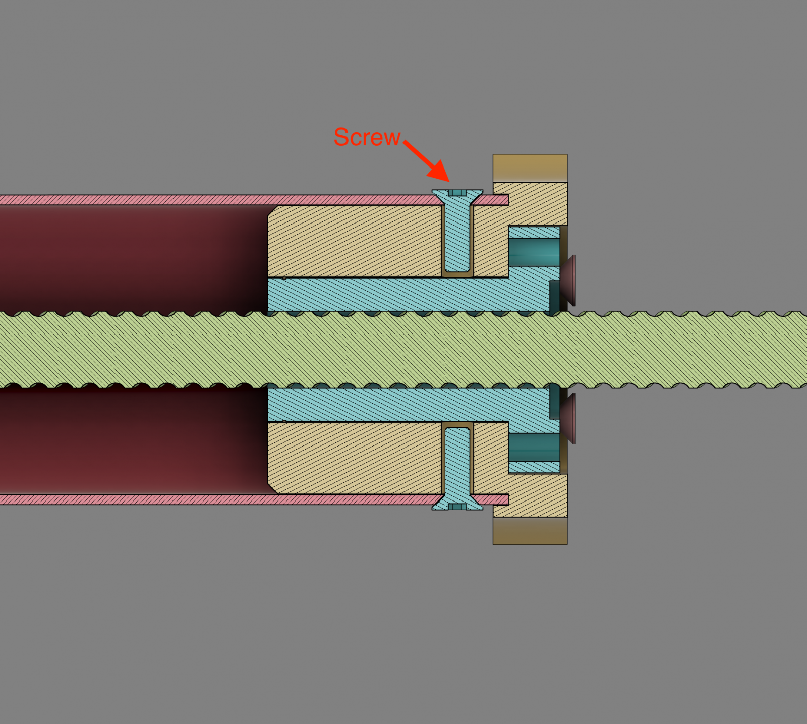

    The little pockets you see take up the screws that fix the rod to the ball nut:
    igus custom friction bearing.png Screenshot 2023-01-30 152905.png Screenshot 2023-01-30 150627.png Screenshot 2023-01-30 141417.png
    That allowed me to shorten the actutator by another ~15mm without sacrificing buckling stability. I figured if I'm going through the hassle of designing a custom bearing/liner I might as well make use of the design freedom it gives me.
    Cheers,... :)

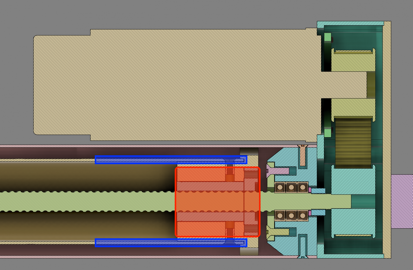

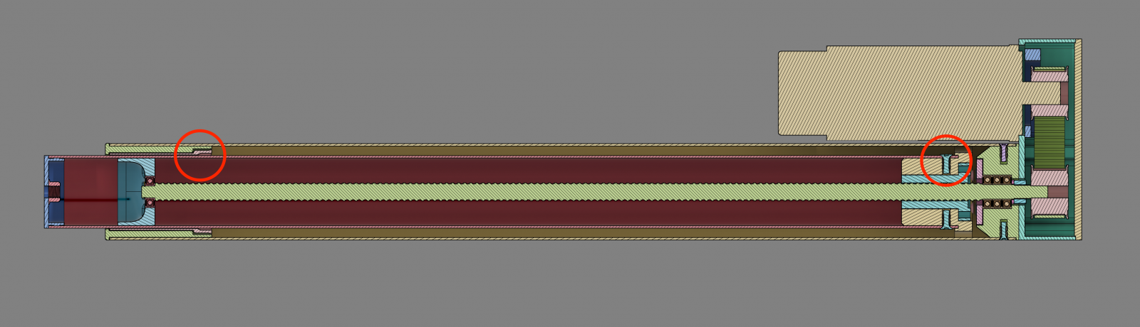

  11. Dirty
    Oct 15, 2017
    746
    7,971Coins
    +888 / 3 / -0

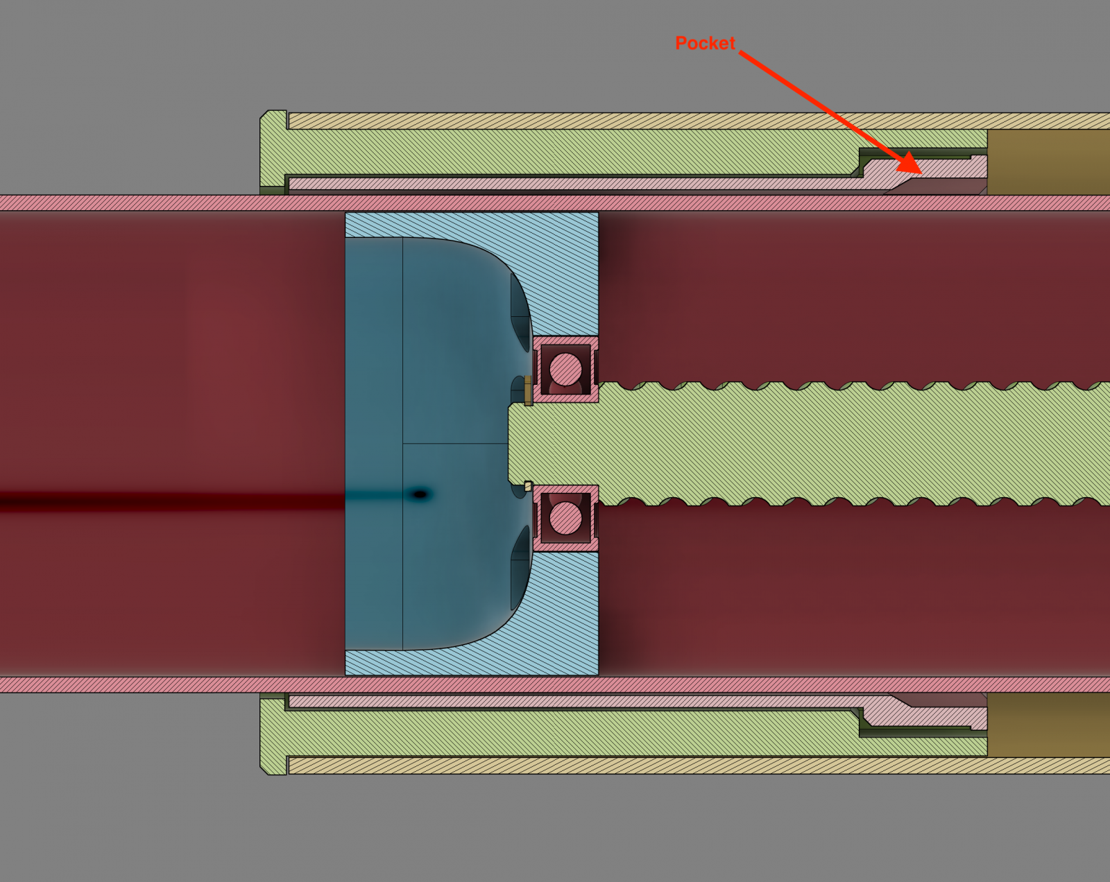

    I noticed that it's quite advantageous to have a good stroke/length ratio. I currently have a ratio of 631/895 [mm]. So, instead of craving "more stroke", like so many do, I started designing for "less overall length".
    One of the measures to reduce overall length was to put the ballnut inside the rod. Every millimeter counts and that way I could have the outside of the rod provide guidance and stability while on the inside those same millimeters(!) housed the ball nut.
    But that means that the rod diameter will have to grow with the ballnut :-/ In this build I have used a 60.3mm rod to house the SFS1620 ballnut, but my next build will use an SFY2020 ballnut, hence the insanely large rod diameter of 70mm there.

    ...similar philosophy on those pockets I talked about earlier: The same millimeters that provided guidance for the rod could accomodate those screws :)

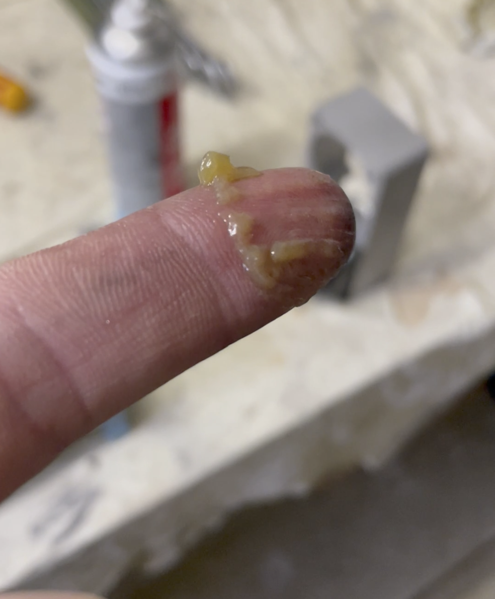

    No, in both cases I used an overall length of 750mm which gave me a stroke of ~630mm. The move to a 20mm diameter ballscrew was largely due to the fact that I found a supplier who could deliver the 2020 ballscrew with custom end machining for almost the same price as a 1620 and I just wanted to try it out to see if it makes a difference in noise and vibrations.
    If you look at the spec sheets of those ballscrews you will notice that the way we use them in linear actuators is way beyond anything the manufacturers have ever intended. I saw a table a while ago that gave a maximium RPM of 300 and a maximum axial load of a few dozen Newtons. I am spinning them at 2500RPM, loading them up to 1000N. That being said, they still seem to hold up just fine.
    Here's the grease after a year of operation:
    No dark metal residue indicating virtually no wear at all.
