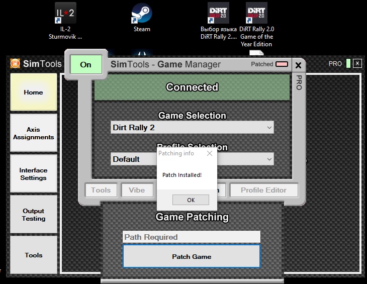

    Hello. I have Game of the year edition. SimTools GameEngine crashes every time. Project cars2 and other games are working fine. No error messages. Just crahes, while game manager is still working ((((

    GE is working for a couple of seconds and then crashes(Turning center is working and HW too).. I'm using win10x64 and Dirt Rally 2 Plugin v2.3

    Solved. FULL reinstall jf DR2.0 (Savegames and all settings were deleted). I have steam DR2.0 game of the year edition. Now it works great.

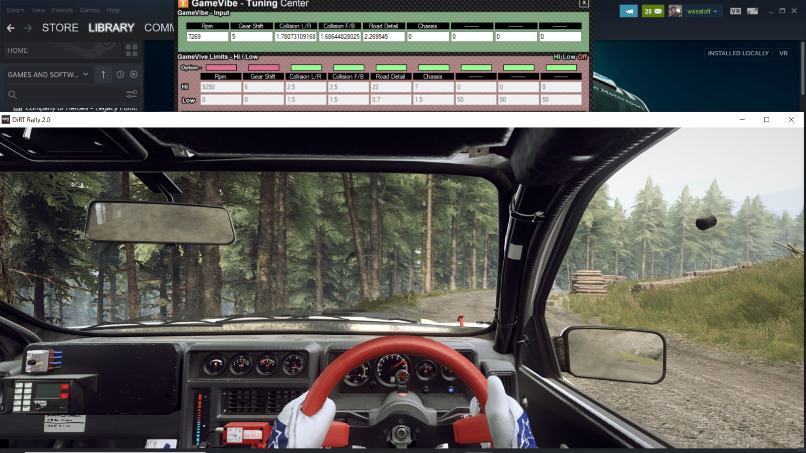

    I have an issue where the chassis gives no output for gamevibe? Is this a known problem playing in VR?
  16. noorbeast
    22,227
    154,831Coins
    +11,227 / 57 / -2

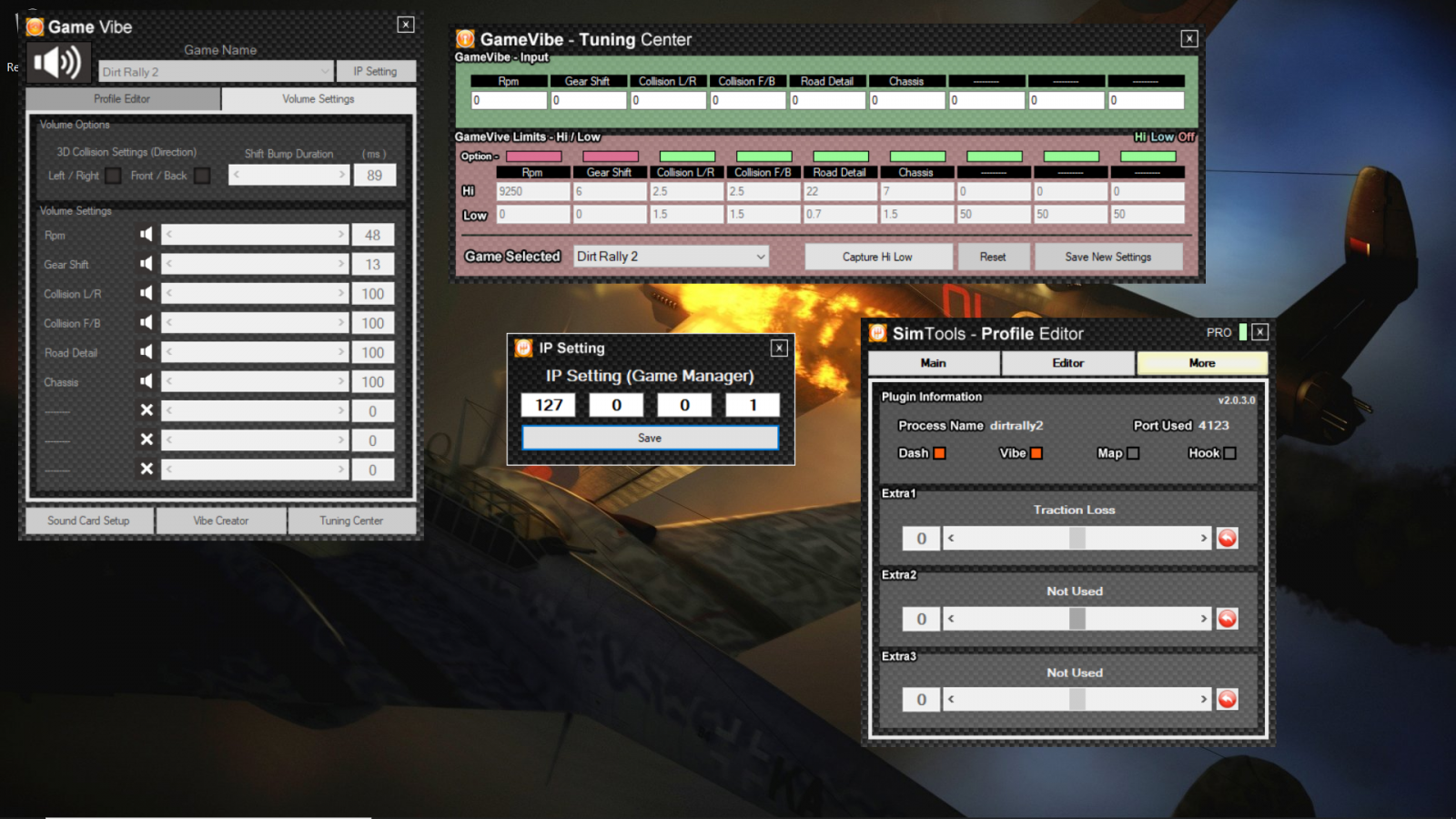

    Can you please post pictures of your settings.
  17. ParaRMN
    ParaRMN New Member
    Mar 24, 2018
    United Kingdom
    - 170Coins
    Sure, thank you for your quick reply. Which settings do you need pictures of and where would I find them?
  18. noorbeast
    22,227
    154,831Coins
    +11,227 / 57 / -2
    All your GameVibe settings.

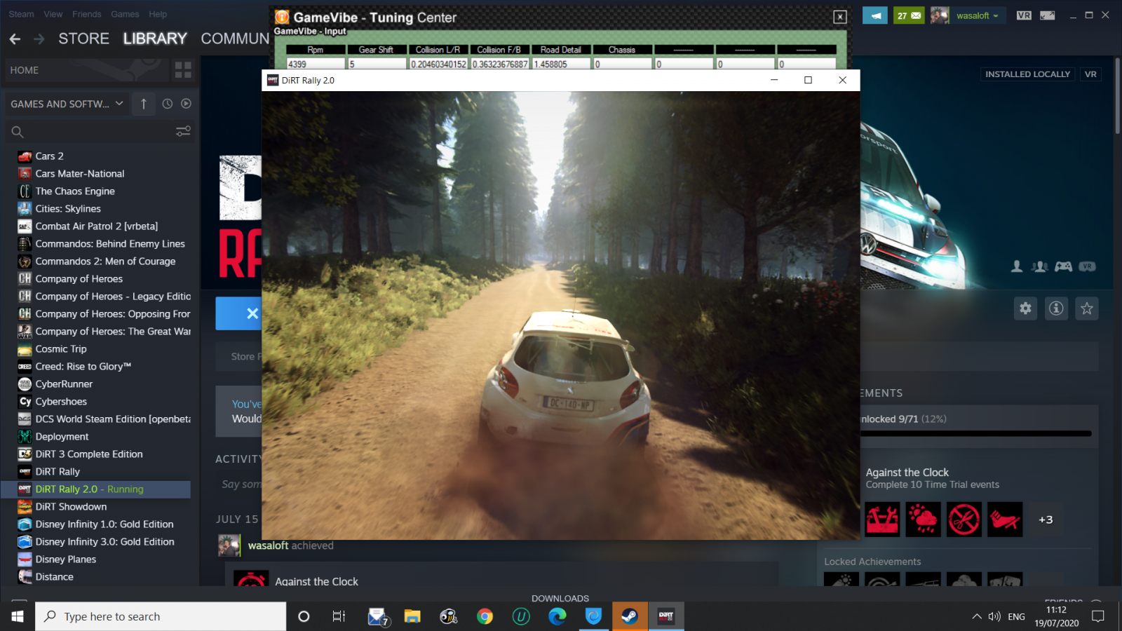

    Are there any settings I've missed? You can see there is zero output from the chassis whilst in game (and driving over the bank)

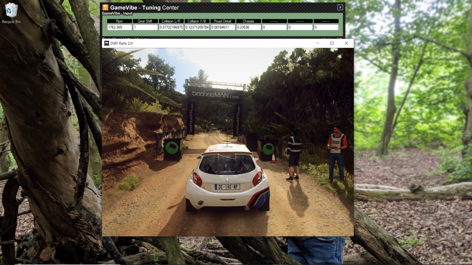

    So I can confirm this is definitely a problem with the latest plugin. I unpatched and repatched with the old (non-vr) plugin and chassis output works fine (see picture), but updating to the latest 2.3 plugin kills the chassis output. I made no other changes. Is there a simple way I can make the old plugin work with vr or activate the chassis output for the new plugin?
