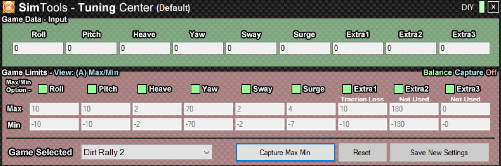

    This has me confused, so if you have a hard landing after a large jump and the heave outputs a value of say 15 but you have min/max set to -2/2 then it will completely ignore the 15 and give no heave effect at all? I'm fairly certain with my heave even as low as -1/1 I feel everything, just not as drastic on the big jumps as maybe I should be feeling. But if I set a high min/max then I only feel large jumps and little to no road details, the motion becomes far too smooth and lifeless.

    Hi @DotComRich,
    Let me help a bit...
    Anything over 2 or under -2 is maxed out in that direction.
    Or another way of saying it is 100% is used in that direction.
    The lower the numbers the more drastic it will move, but with limited range on the input. (Sense anything over 1 or under -1 is maxed out.)
    The higher numbers gives you more range, so the sims will use more range and there for react slower to inputs.
    Hope that helps buddy.

    Hello. If i understand correctly, lower the numbers in tunning center, are best or has fast response of the simulator. Is it right?
    Another thing, all the numers on tunning center are the same to take a good setup for diferents simulators (snc5, electric motors, etc...)?
    Can you give a aprox interval of every axe? Surge, have, roll, pitch etc..?

    I will post my settings tomorrow.
    Heave is working now thanks to the latest plugin-update. hug:
    Although I'm still not satisfied with the movement way.
    I have tried higher tuning center values but ended up in 2/-2 for heave is the best result for my rig.
    But then I don't feel road surface. That's only on 1/-1

    What are you using for Pitch and Roll? These can provide road surface I run them around 5 or 6 in tuning center.

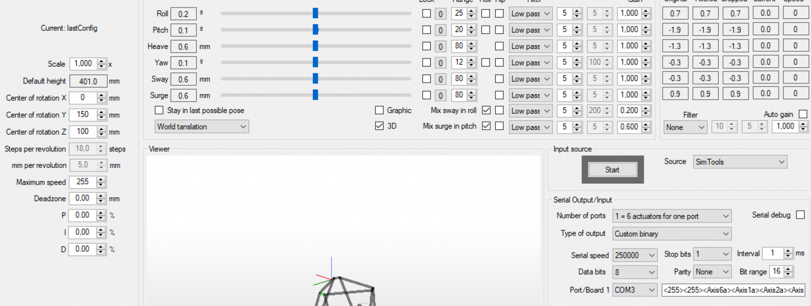

  12. Outatime
    Outatime New Member
    Apr 21, 2014
    29
    205Coins
    +6 / 1 / -0
    Here are my settings for the moment. I`m still trying to find better results.
    The Roll, Pitch and Sway axis in GE have 50% smoothing on.
    In FlyPT I have mixed Sway in Roll and Surge in Pitch.

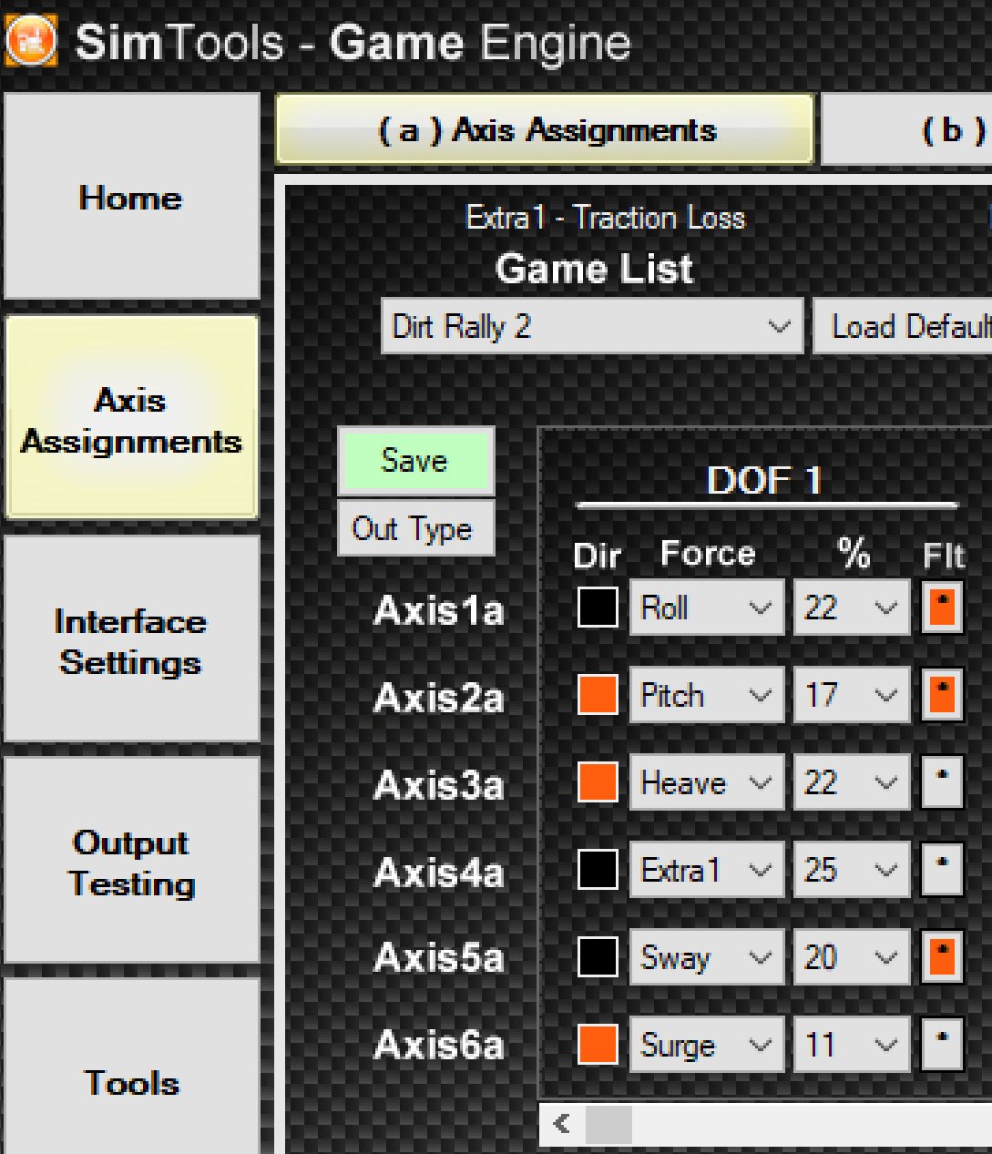

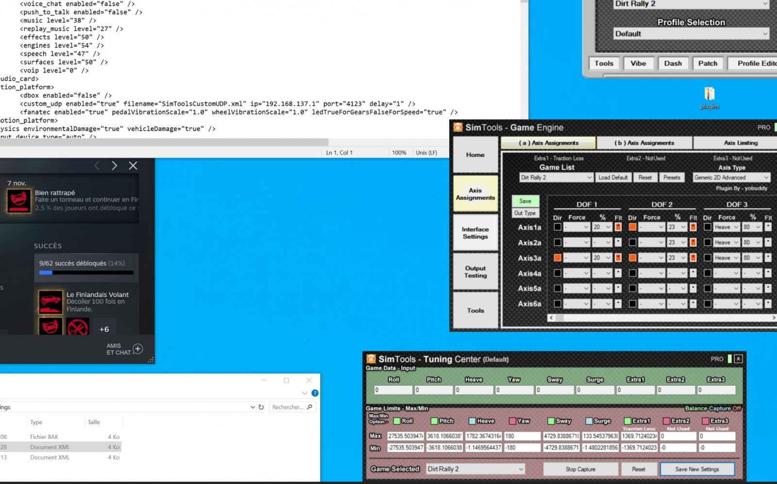

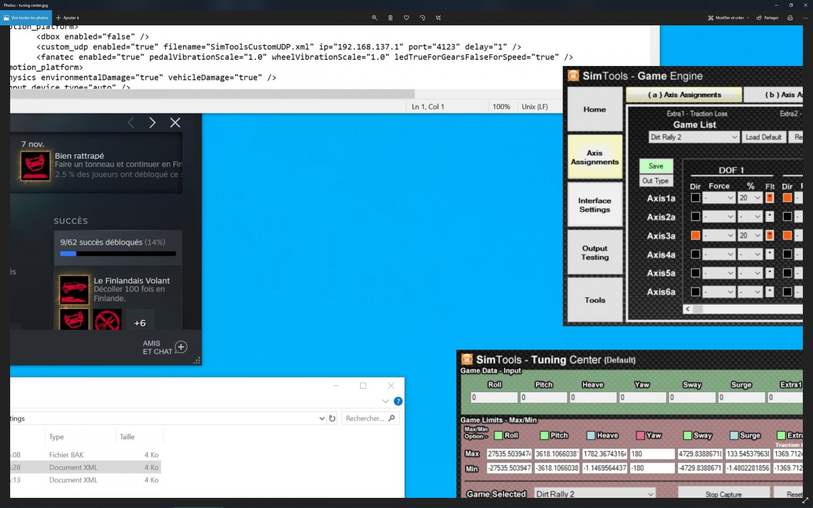

    Marcocer Member Gold Contributor
    Apr 6, 2016
    31
    France Allier Sussat
    - 262Coins
    yo everybody
    after one year (sorry one hour ) i test only for Heave effect (see jpg ) ,i never see this value in Tuning center (> 1700 ) ,and it's very difficult to have good effect (only with Heave !!)
    if i try 1/-1 it's the same with 1000/-1000 )
    have you same values ?
    thanks
    Mark

  17. Outatime
    Outatime New Member
    Apr 21, 2014
    29
    205Coins
    +6 / 1 / -0
    I always wonder why some configure it on the DOF1 (all axis Roll), DOF2 (all axis Pitch), DOF3 (all axis Heave) and some configure it like me (Axis1a Roll, Axis2a Pitch, Axis 3a Heave and so on).
    What is the difference ?

    one dof = 1 degree of liberty = pitch for exemple ? no ?
    i never try the other solution but i test now !
    for me Axis1a it's a motor ,Axis2a another one ,etc...
    what number have you in Tuning Center if you capture ?

  20. noorbeast
    22,184
    154,726Coins
    +11,194 / 57 / -2
    See here for tips on refining a motion profile: https://www.xsimulator.net/community/faq/steps-to-create-a-motion-profile.228/
    In particular how to capture Max/Min values, as yours look to be way off.
    I would also suggest not using filters until you nail down the basic motion profile settings.
