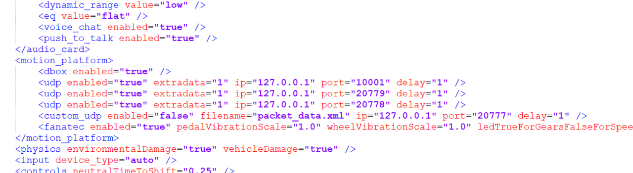

  12. HoiHman
    HoiHman Active Member
    Feb 1, 2015
    211
    Mechanic
    The Netherlands
    331Coins
    +143 / 1 / -0
    Good news is that codemasters let's us manually adjustmentin the hardwaresettings_config.xml again as opposed to F1 2018.
    This makes using 3 telemetry programs at the same time much much easier. I have massive problems getting everything to work in F1 2018
  13. Kranky Pantz
    Kranky Pantz Active Member
    Sep 9, 2018
    362
    Canada, Eh!
    1,288Coins
    +296 / 0 / -0
    That's great news!
    What sort of changes are you making to the "hardwaresettings_config.xml" file in order to run and share between multiple telemetry apps?
    Do you have any examples of which settings you are modding?
  14. HoiHman
    Feb 1, 2015
    211
    Mechanic
    The Netherlands
    331Coins
    +143 / 1 / -0
    This is when everything was sting "fresh"
    Port 10001 = Simcommander4 using Dirt 2 plug-in ( GS4 + AF + simvibe)
    Port 20778 = Simfeedback using a modified Codemasters plugin (SFX100)
    Port 20779 = Simtools using a modified F1 2018 plugin (windsim)
  15. HoiHman
    Feb 1, 2015
    211
    Mechanic
    The Netherlands
    331Coins
    +143 / 1 / -0
    The problem that a lot telemetry apps developers put the data out on port 20777.
    This is fine as long as you are only running one third party app, but when you have more then one it's not going to work. From the previous post above i already saw that simtools is using 20777, simcommander will probably do the same and so does simfeedback.
    Luckily the port in the simtools plug-in can easily be changed and i already have altered port for the plugin of simfeedback otherswise it's not working.
