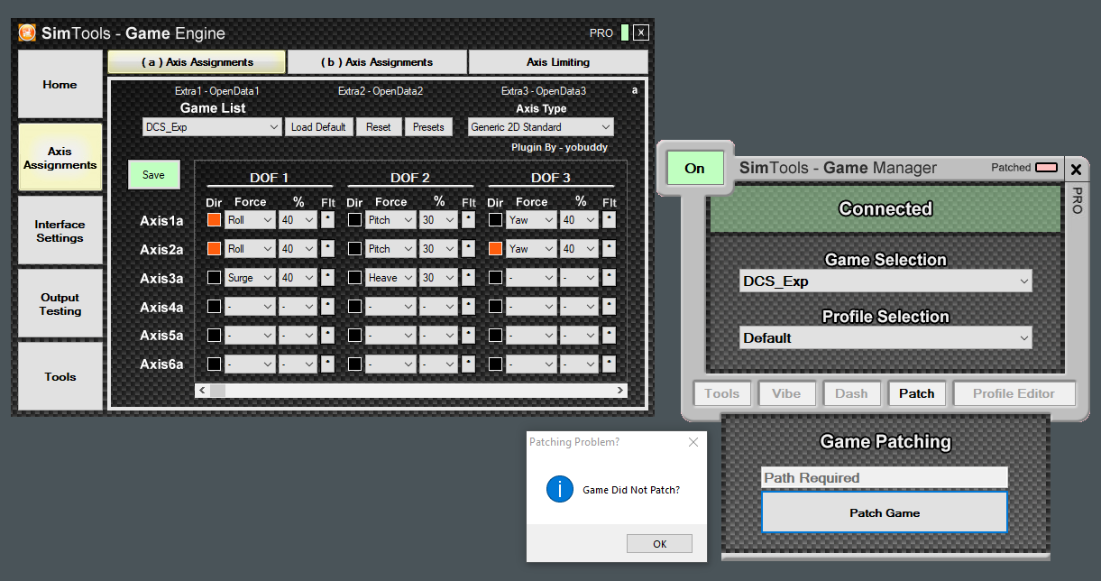

    Hi Thomas,
    no worries, we'll get this sorted.
    1. Where does the message "patching problem?" come from?
    2. When does it pop up?
    3. Do you have a screenshot?
    4. Is there a .lua file in "SavedGames/DCS.openbeta/Scripts/Hooks/"?
  14. Thomas Rabbertz
    Thomas Rabbertz New Member
    Aug 24, 2018
    28
    - 23Coins
    +20 / 0 / -0
    3DOF, Arduino
    Hi Dirty, many thanks for your quick reply!
    There was no folder called Hooks in the scrips folder. I added it and ran the patch again....and it works :)
  15. Thomas Rabbertz
    Aug 24, 2018
    28
    - 23Coins
    +20 / 0 / -0
    3DOF, Arduino
    Here is the screenshot from what I got before I added the Hooks folder
  16. Dirty
    Oct 15, 2017
    746
    All the way up front.
    7,979Coins
    +890 / 3 / -0
    Hmmm,.... that's strange.
    The patching routine should've created that folder. I guess for some reason it didn't and then the routine threw an exception. *scratching head*
    I will try to replicate it to find the source....
    Good to see it finally worked.
    Cheers,... Dirty :)

    What Path did you try patching to?
  19. Thomas Rabbertz
    Aug 24, 2018
    28
    - 23Coins
    +20 / 0 / -0
    3DOF, Arduino
    User/savedgames/dcs.openbeta

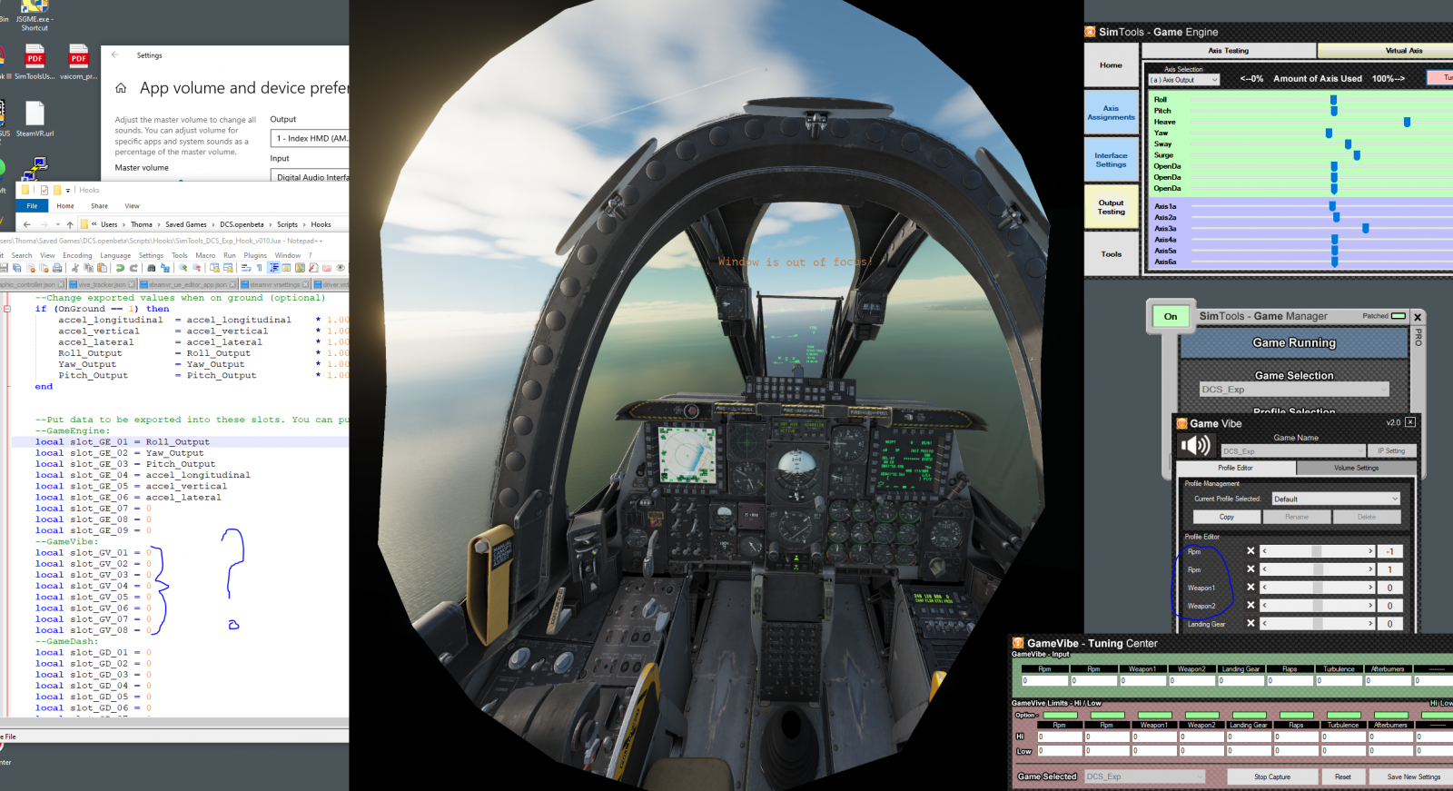

    Hi, did you try to replicate the issue already? I think I found one more little problem.
    I got Game Engine to receive the motion data as we can see on the screenshot but no vibes input. I had a look at the SimTools_DCS_Exp_Hook_v010.lua and found the vibe slots all set to zero. For testing I copied the arguments from GameEngine slots to the Vibes slots and could see the input on vibes tuning Input. Now...I just need to find the right data for vibe slots.
    I found these here in one of your posts but they dont work on my machine
    local slot_GV_01 = "RPM," & vibe1.ToString
    local slot_GV_02 = "RPM," & vibe2.ToString
    local slot_GV_03 = "Weapon1," & vibe3.ToString
    local slot_GV_04 = "Weapon2," & vibe4.ToString
    local slot_GV_05 = "Landing Gear," & vibe5.ToString
    local slot_GV_06 = "Flaps," & vibe6.ToString
    local slot_GV_07 = "Turbulence," & vibe7.ToString
    local slot_GV_08 = 0
    Am I missing something else?
