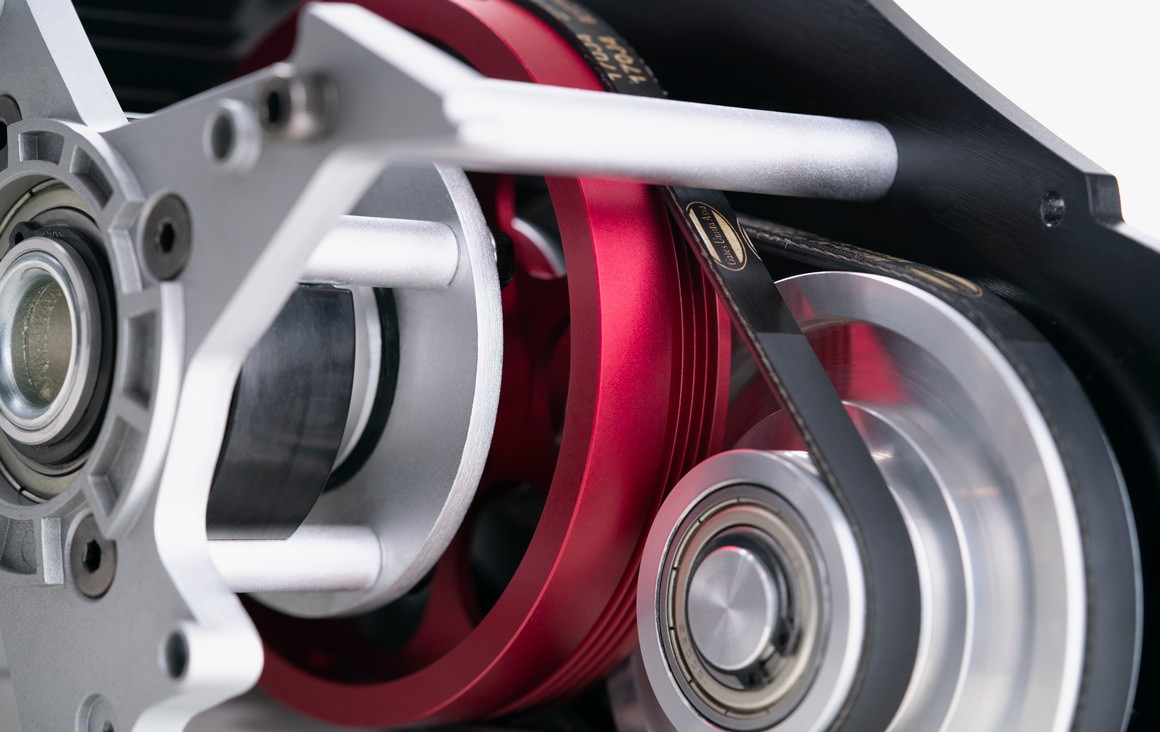

    Well ideally yes direct drive would way better but the smallest motors for direct drive shipped to me would cost $300 which would be significantly over my budget so the only way for me to achieve a good Forceand still be on budget sadly is going with a geared option
    As an example there's still lots of good commercially available wheels that aren't direct drive example for exemple Clubsport V2.5 which i'll be basing the dual pulley design of. And it uses a v belt system which is prone to slippage and i'll be using a timing belt setup that's way tougher and almost zero slip chance.
    Picture taken from fanatec's website of the V2.5 belt system

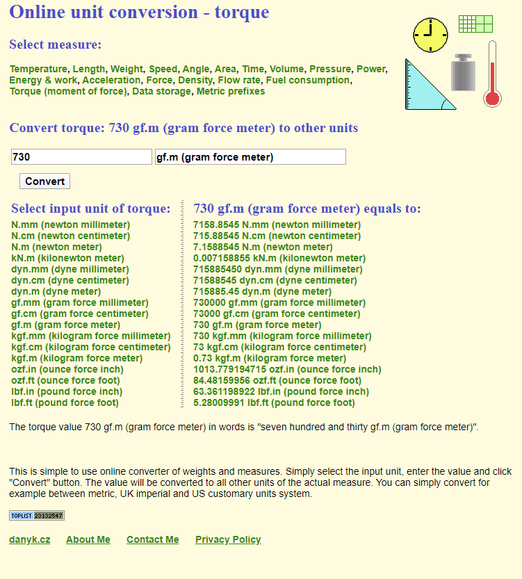

    You messed up everything or do it on purpose. Superb, if the lever arm doesn't work))
    147 N/m it's a way far a car engine already :D Good luck with RS motors to get 147 NM)
    MY1025 motor.
    7.5cm lever.~ 8kg with not a full force and PSU with 12v on a 24 volt motor. 1:3.6 gear.
    7.5cm lever - it's 13.3 times less then meter so = 600 g.m = 5.88399 N.m (newton meter)
    730 g.m = 7.1588545 N.m (newton meter) on almost full power settings but still with 12 volts but now with 1 meter lever. In EMC Gain Constant Spring 100%. And I don't use a scale bar there to double forces that EMS has also. But whatever.
    http://convert-units.info/torque/gram-force-meter/730
    https://en.wikipedia.org/wiki/Newton-metre
    So good luck with 147 NM with RS motors again)
