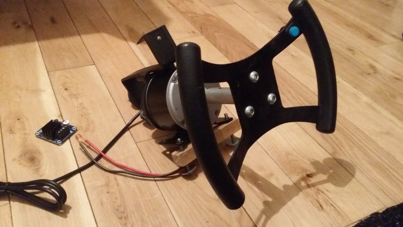

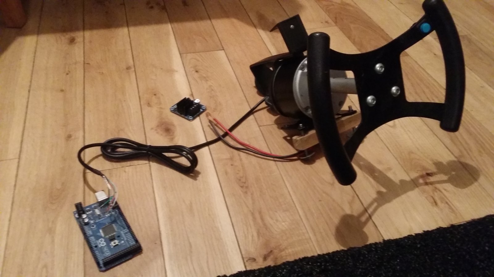

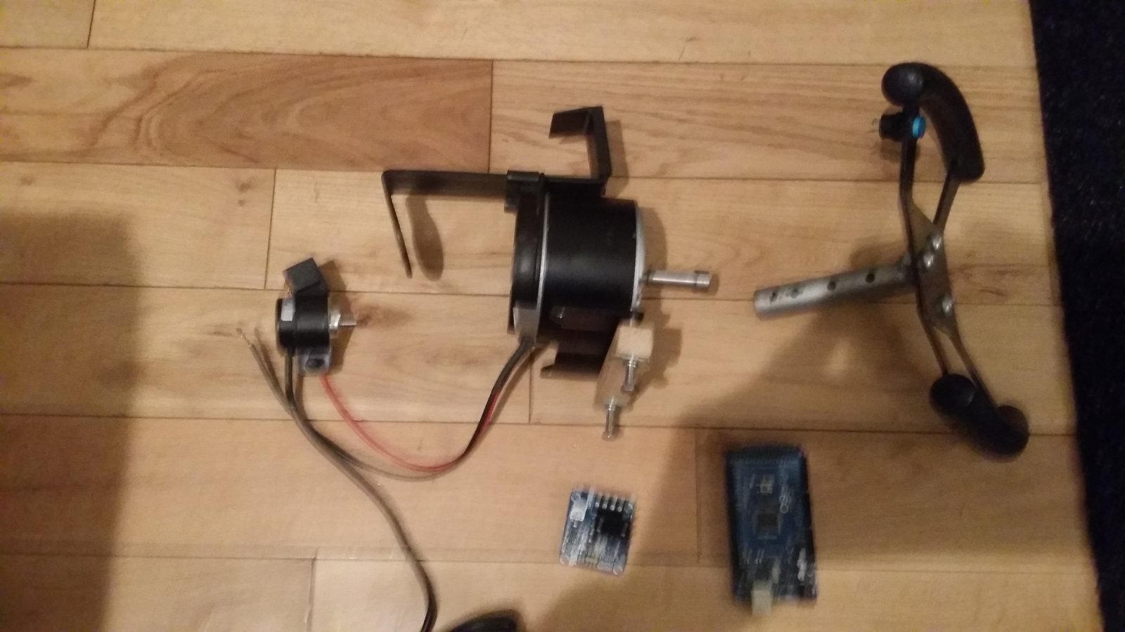

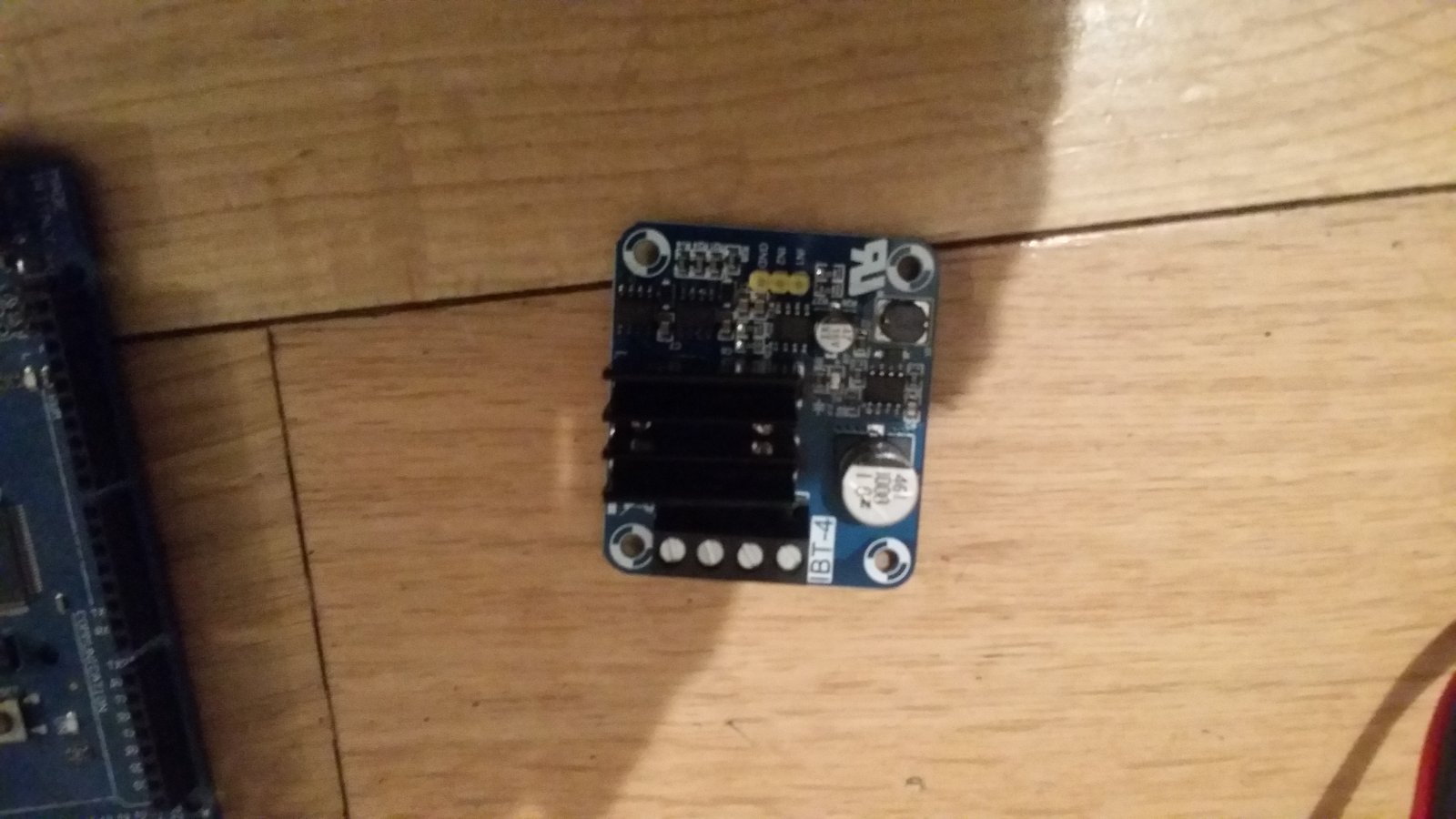

    So today i started a budget Direct Drive wheel project :)
    all of it has been built from parts i have laying about so it has cost me nothing !
    Parts List
    280W 24V DC motor (from an electric go kart) (may be a 350w motor after all)
    IBT-2 h bridge controller
    Arduino Mega
    360 p/r shaft encoder
    Steering wheel (from electric go kart)
    i have got the wheel attached to the motor and have drilled out the back of the motor to attach the shaft encoder
    hope to get it wired up tomorrow and try it out
    next job is to find some arduino code and program the board

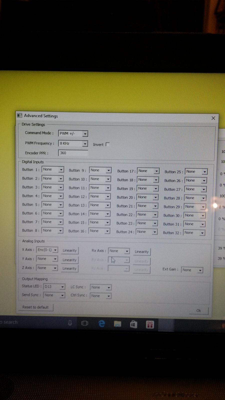

    i have made some progress with the wheel
    it turns out i needed pull up resistors on the encoder channels and the laptop i was using already had some chip programming software that conflicted with the Arduino leonardo drivers.
    it is a 24v motor that i am running at 12v and already it feels pretty powerful
    i wanted to check i have the correct settings for the pwm
    the options are
    pwm
    pwm+Dir
    pwm +/-
    vnh5019
    I am using a IGBT-2
    i have PWM selected - is this correct ?

  9. auryza
    auryza Active Member
    Jun 12, 2013
    109
    Lithuania
    4,335Coins
    +76 / 0 / -0
    2DOF, 3DOF, Arduino
    PWM+/- with NPN - Transistor

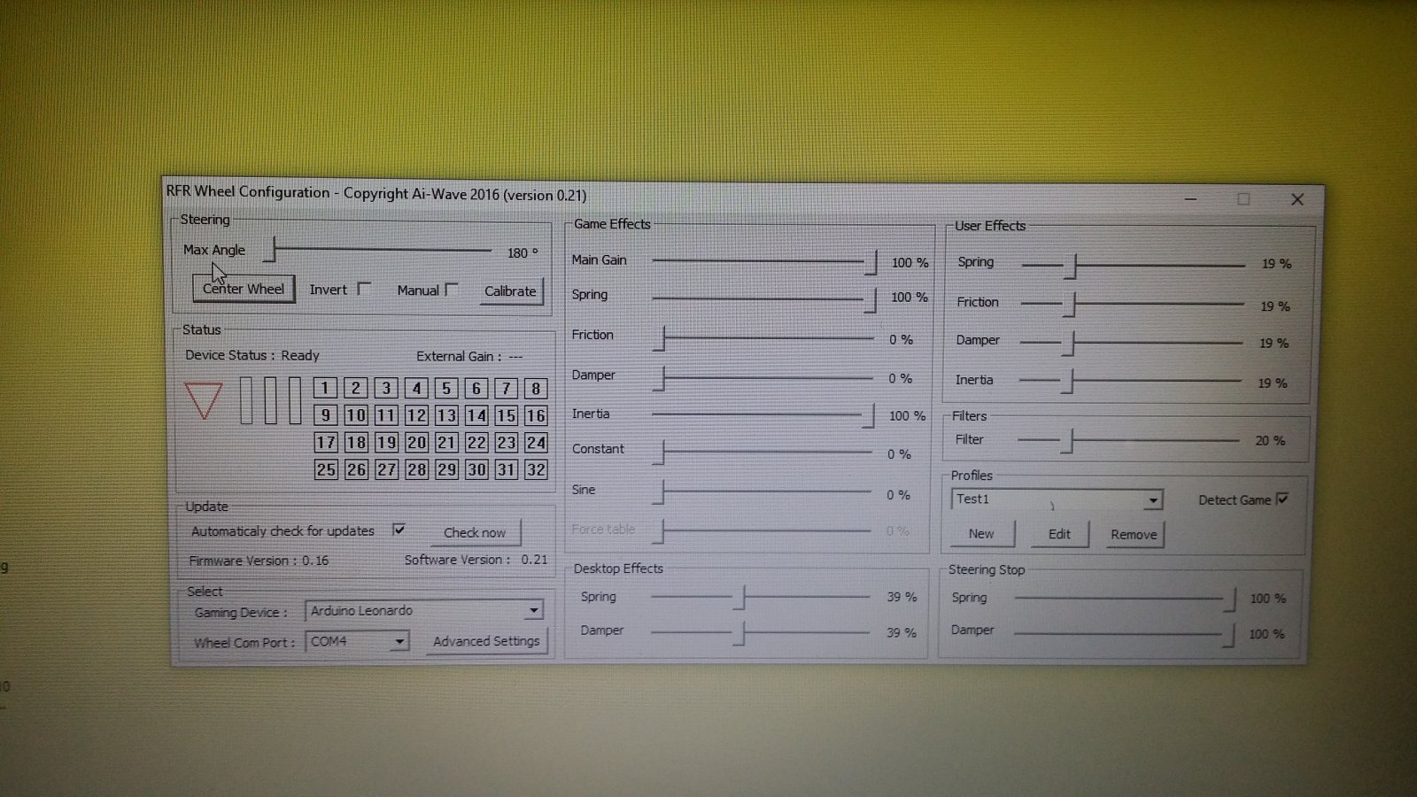

  10. Gadget999
    1,959
    11,983Coins
    +484 / 10 / -0
    Some progress :)
    The wheel is set to 180 degrees movement
    The stop is trying to prevent rotation at full movement.
    I have tried the wheel with lfs Live For Speed - but there is no feedback
    What software should i be trying ?
  11. Fernando Igor
    Fernando Igor Member
    Jul 24, 2017
    53
    Programmer
    Fortaleza, Brazil
    913Coins
    +19 / 0 / -0
    DC motor, Arduino
    Live for speed use Constant force, try using the Constant bar other than 0% (maybe 100% :grin).
  12. Gadget999
    1,959
    11,983Coins
    +484 / 10 / -0
    It works !
    It works pretty good :)
    So far i have tested it with 12v instead of 24v and at around 8 amps - nowhere near its operating limits
    You can feel quite a lot of feedback with understeer reducing force and the rumblestrips for example.
    So far its the best feedback wheel i have ever tried (i own 6 now !)
    Next step some pedals and paddles/switches etc
    Thank you everyone for your help. The biggest problem was a laptop that would not recognise the board !
